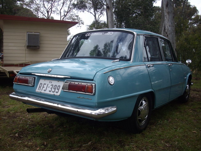

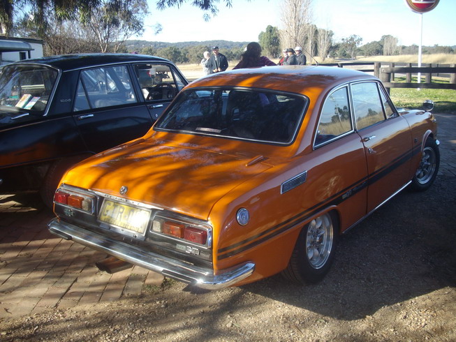

Just out of interest, are all the tail lights on later model Belletts (strip lights) the same or did they vary on different models? ie sedans to GT's.
I ask this because every photo I see of a Bellett with strip tail lights they all seem to be segmented. Indicator, brake and reverse lense seperate.....except my 69 sedan which is one single lense.
Is this just a difference due to being a former South Africa car or are other sedans the same as mine? :?:
Will post a photo when I get a chance to show what I mean.
Geoff
Thu Dec 02, 2010 1:02 pm
GT and sedans in that model are different.
GT's had 3 separate blocks for lenses, and the sedan was a single lense (actually, it's 3 separate pieces glued together, but it appears as 1 lenses when fitted.
while the 2 different types are interchangable between the cars, as the tailight hole in the body is exactly the same in GT's and sedans, the entire light assemblys themselves are different, including the metal frame itself.
also, as the GT ones were always the rarest of the 2, some GT's had sedan lights fitted due to damaged lights over the years, and a pair of sedan units were often substitued instead.
hope the helps.
Thu Dec 02, 2010 1:12 pm
Cheers mate that makes sence to me.
Just haven't noticed any others like mine.
Mind you, most of the photos I've seen of the strip lights have all been GT's.
There in lies the problem I guess.
Thanks again
Thu Dec 02, 2010 1:21 pm

Postscript...............
Sedan....
G.T. (& GT-R)....
Fri Apr 01, 2011 12:28 pm
:D Matt what a great photo,to park alongside a GTR,got to be on any Bellett enthuzast's bucket list,Gerry has learnt to down size photo's,but still needs the young one to guide you through the mine field,hope to post a few next outting 10th
