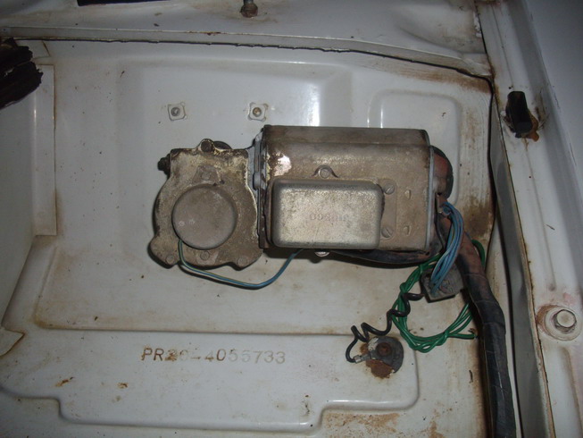

HI GUYS YOU KNOW OF MY LITTLE CAR I HAVE JUST OBTAINED THRU GRICEY A 2 SPEED PULL OUT (GENUINE) WIPER SWITCH FOR A TEARDROP DELUXE . MY QUESTION IS A CURLY ONE AND THOSE WITH A DELUXE MAY KNOW THE WIPER MOTOR DOES IT HAVE A RELAY ON IT ? I GOT THE SWITCH AND TOOK THE MOTOR AS WELL GOT IT THRU THE AIRLINES THEN CHECKED IN MY WORKSHOP MANUAL IT APPEARS THEY HAVE A RELAY SCREWED ON TO THE WIPER MOTOR THE DELUXE I TOOK IT OFF HAD NO RELAY .........WILL IT NEED IT ? IF SO CAN I FIT ONE OR HAS SOMEONE AN OLD ONE SITTIN ROUND (JOKING) FARMER ND BRETT COME ON LET ME KNOW OR ANYONE ELSE WHO KNOWS THIS SIDE OF THE BELLETT ...ITS GOT ME ... ID APPRECIATE AN ANSWER CHEERS DAVO IM STILL AT THE BLUE MACHINE MUST POST PICS SOON ...

Here's Doris' wiper motor - looks just like the standard one, but with 4 wires & the relay.
Perhaps an auto electrician could supply a relay that would work? Might be like some other thing.

Note that this is a teardrop deluxe one, the later one is different, round motor & smaller relay.
Works differently to! When you switch off, the motor reverses direction, does the part sweep, then a full sweep to park. I know, wierd as!
