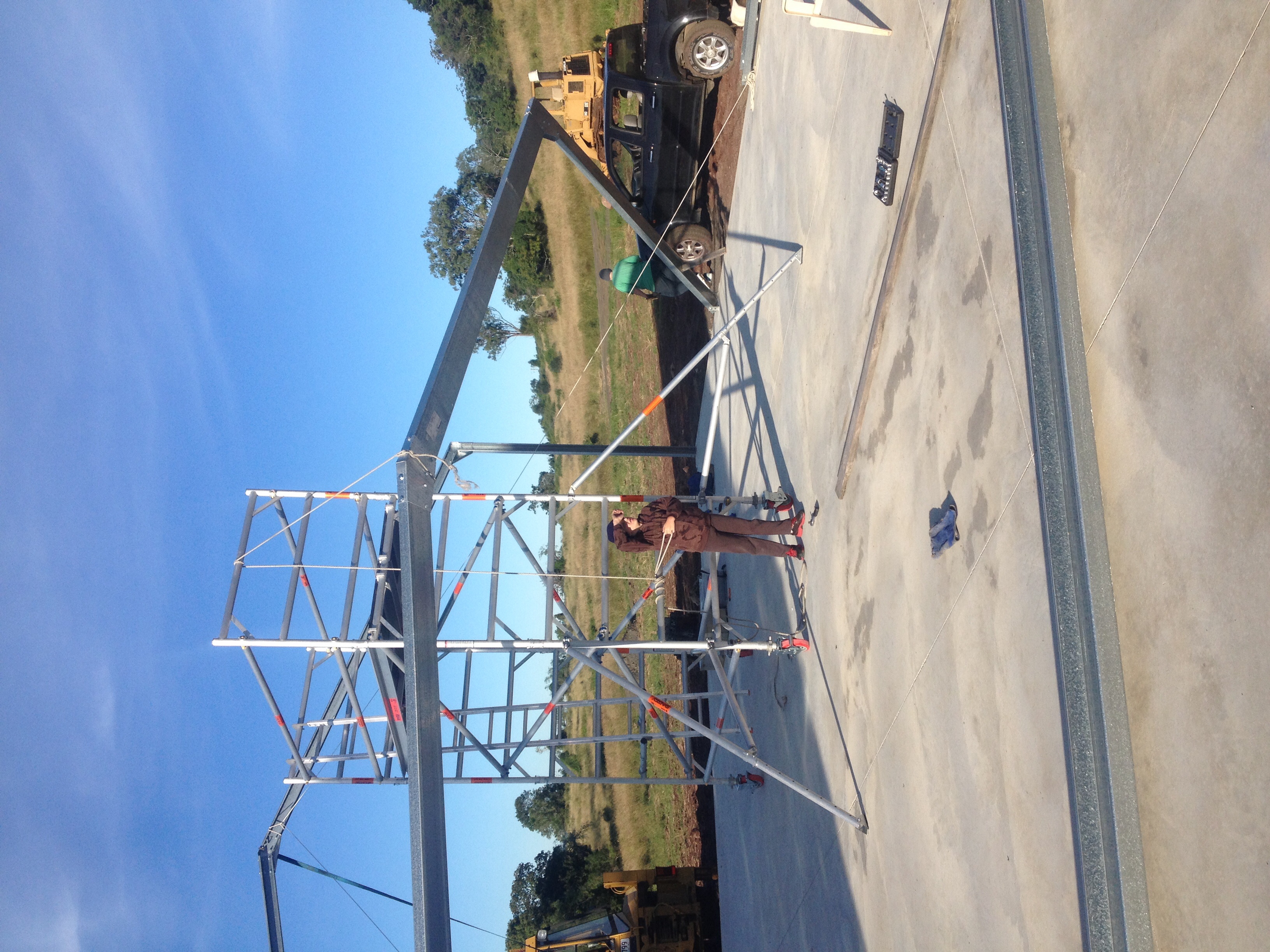

Scaffolding up. The boys voted it to be turned into some bunk beds later.

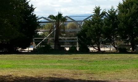

my neighbour 2 doors away is doing same thing right now. taking a while but getting there......

Glenn wrote:
I'm jealous!! Your neighbour is further on than me. All I really did today was tighten 24 bolts to heartattack ft/lb. on just one frame.
Now I understand the term "slowly but surely". :oops:

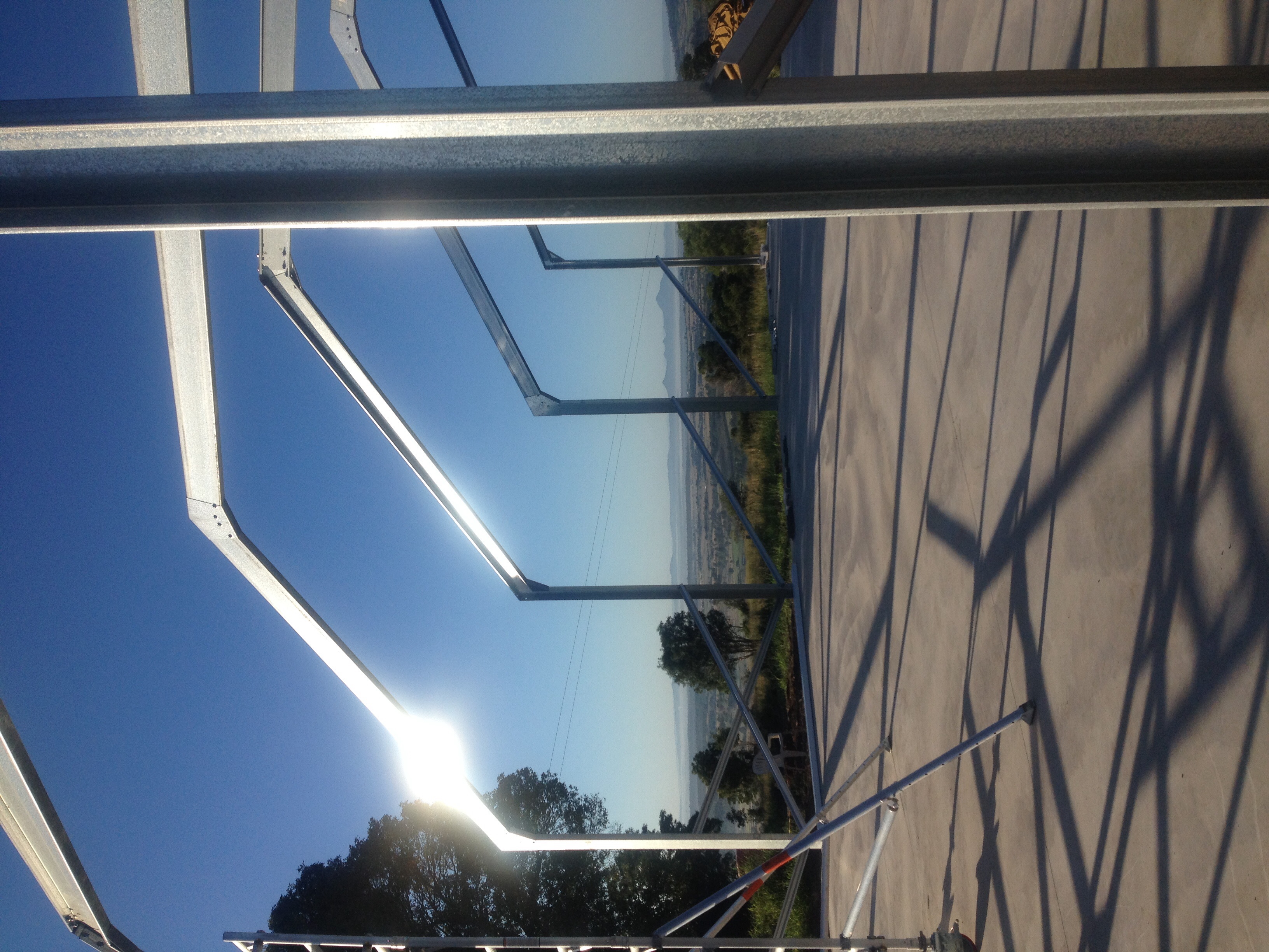

View from the top.
Wed Apr 08, 2015 8:27 am
keep em coming cheers davo

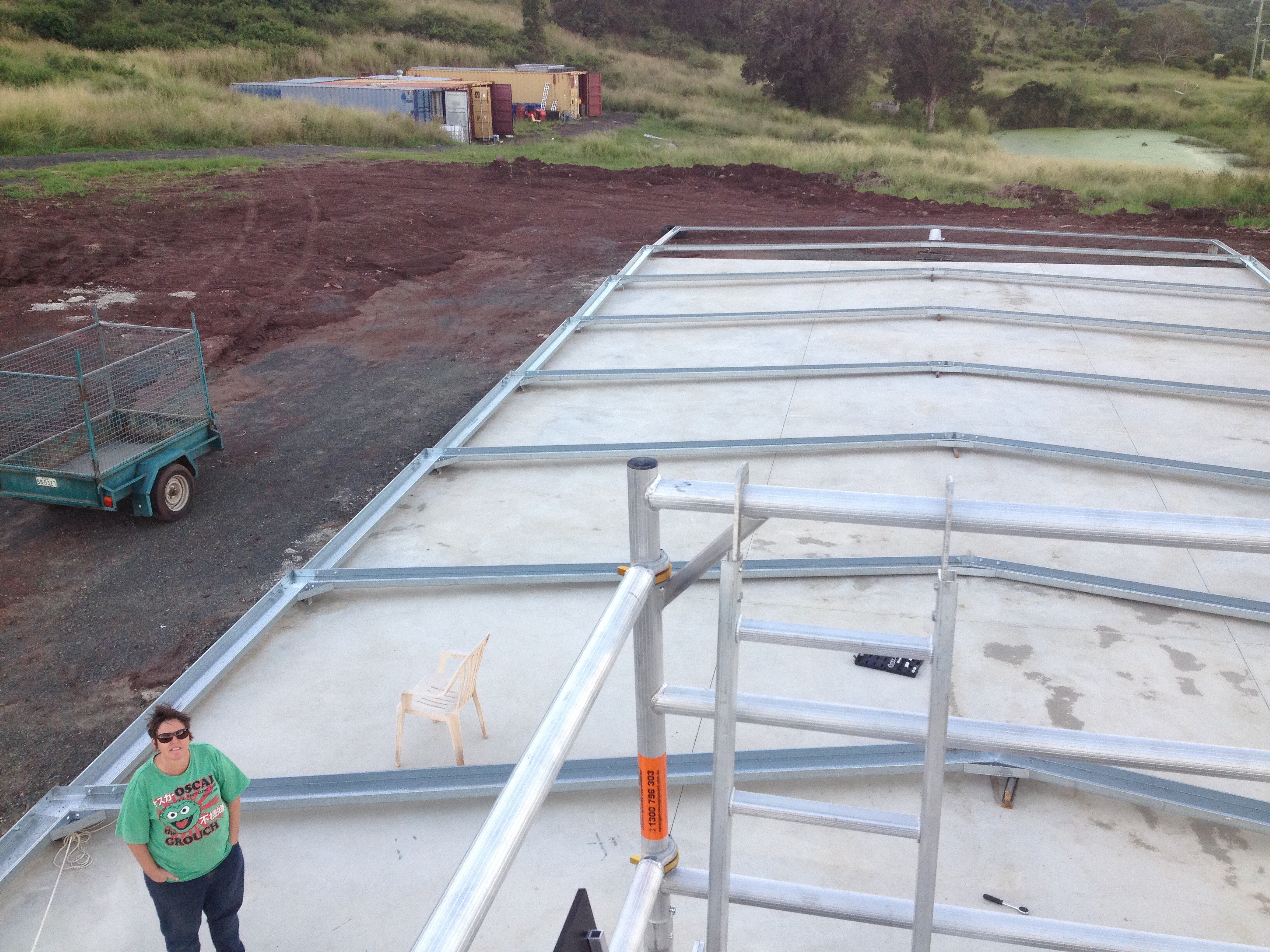

Pic of day (from yesterday). 8-)
No slaves today that I can command. So the only progress that will happen is printing out the 107 pages of instructions on "how to put up a shed".
I know! boring & no pictures nor rumours about belletts or their history. Sigh.
Thu Apr 09, 2015 8:04 pm
Keep the photos coming please - it is a "work of art" mate

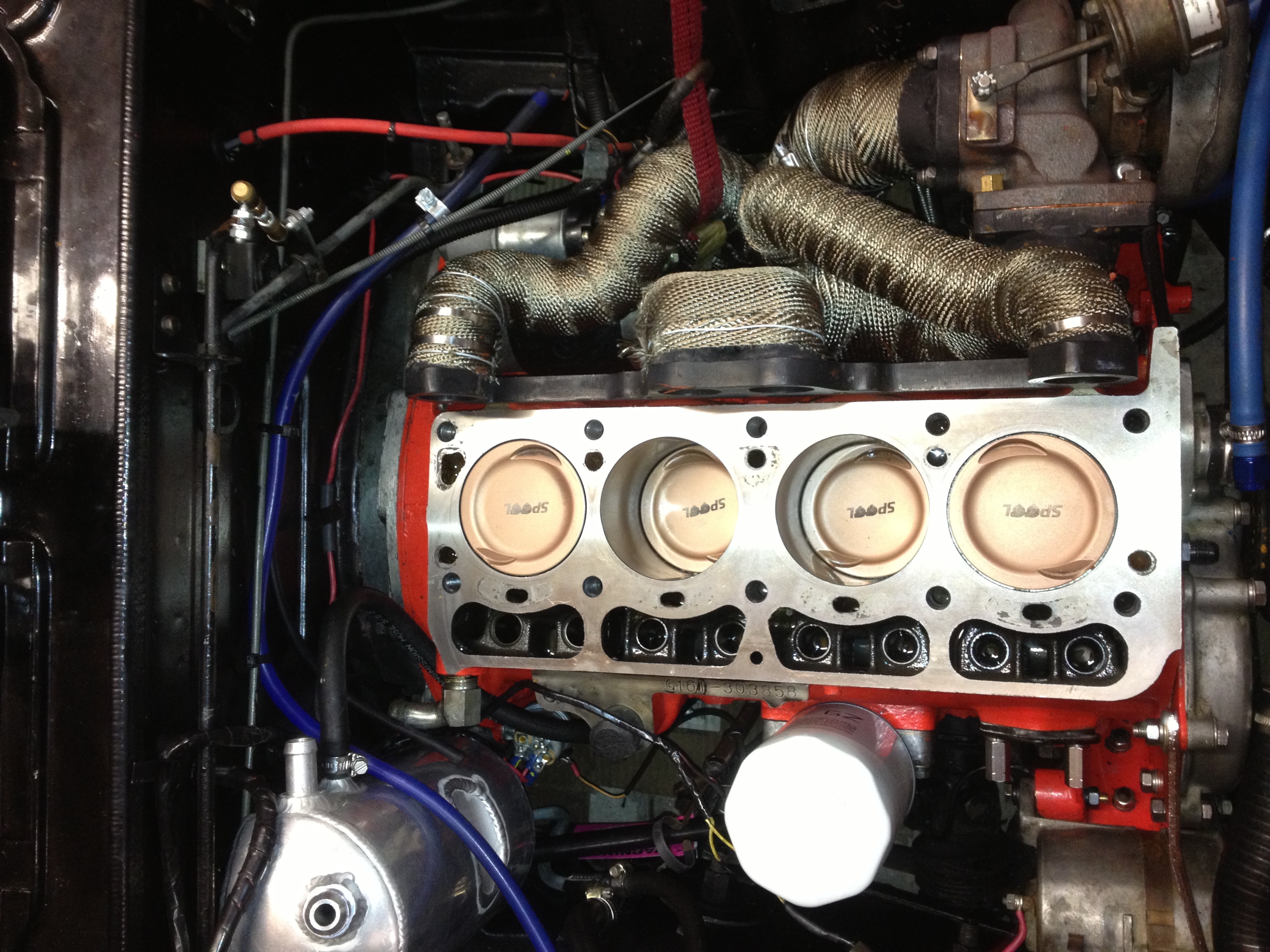

'Asroc' is a G161 block which I bored and sleeved to 84mm with custom forged pistons G180 size
Equates to 1662cc
Shift torque and power up the rev range with a decent cam
Standard 1600cc AJ150? head gasket and good to go
Only point is the rear passenger water jacket - if overly coroded then not much for the gasket to cover

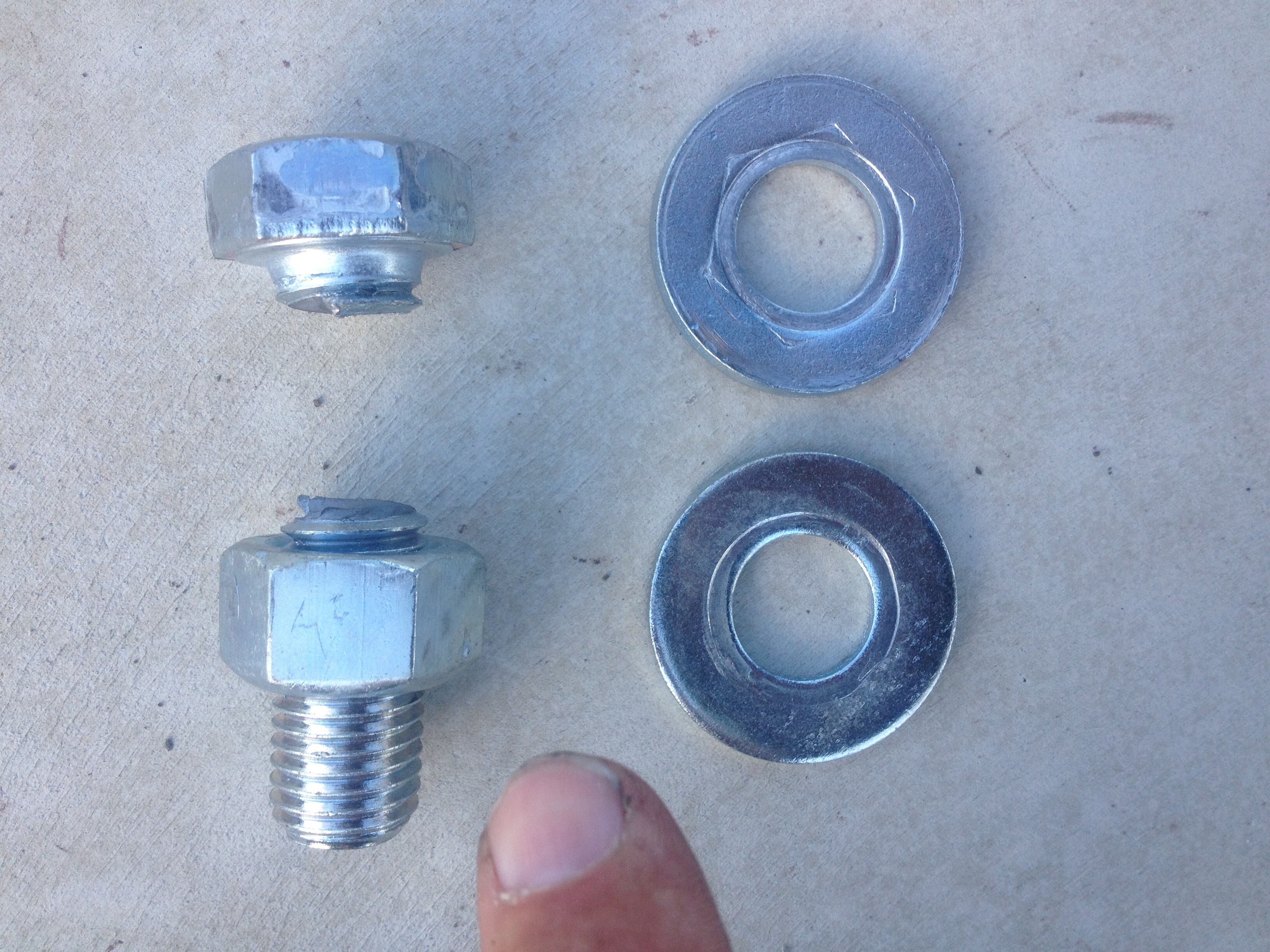

I snapped a 8.8 high tensile 16 mm shank bolt today. I now know their limits 8-)
Tue Apr 14, 2015 6:23 am
Probably dont need them quite that tight Dean!
