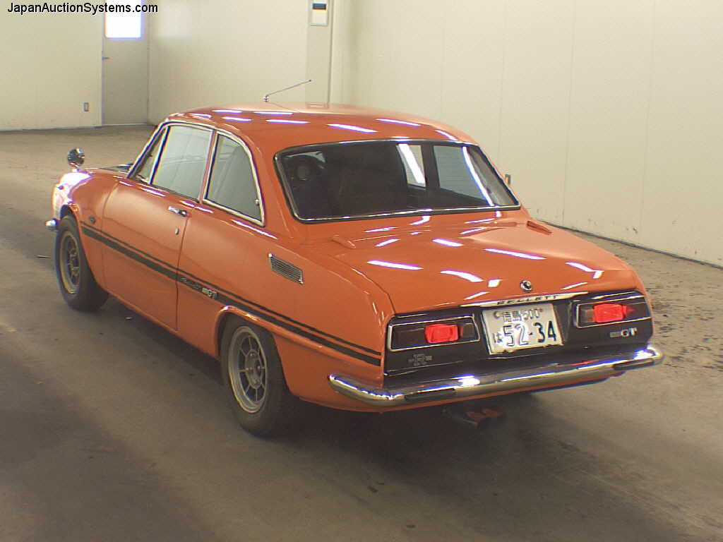

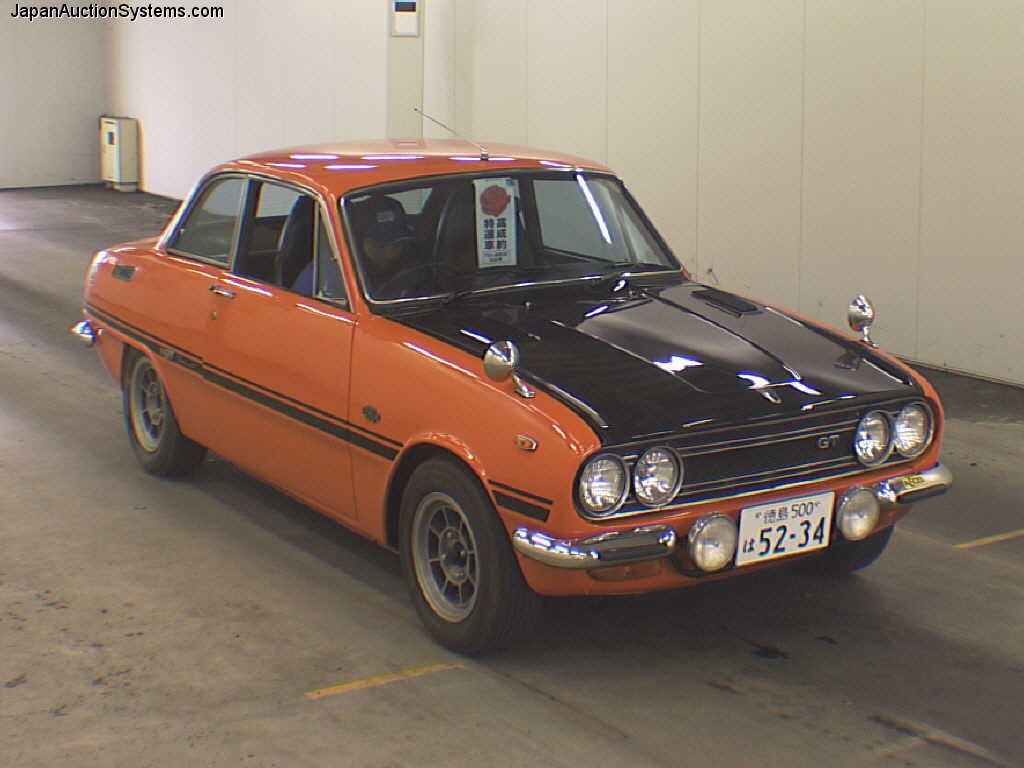

This car:

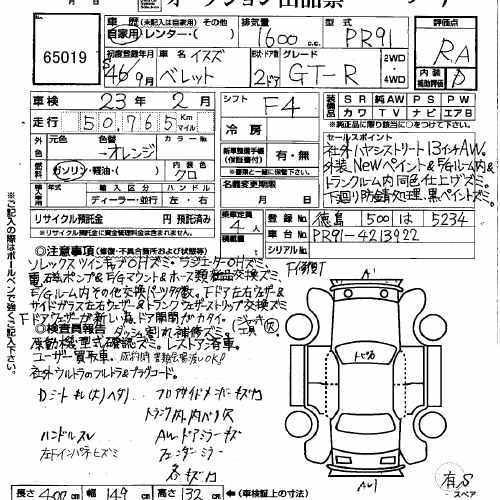

... is up for auction today, 17/12/09. The sales documentation ALLEGES it is a real GT-R, or probably more correctly, doesn't advise that it is a replica, which I understand all Japanese auction paperwork is obliged to disclose. Perhaps someone with more Japanese can interpret the auction paperwork.
The chassis number is: PR91-4213922
There is no W.

The paperwork shows that it has experienced crash damage (and, as a sidenote, is ineligible for road-registered import to Australia but can be imported for parts or racing), and that it has had a colour change from white to orange.
These things would greatly affect the provenence of the car... and also, open up the possibility that it's hit something hard when it was a GT and has been reborn as a GT-R....
So this doesn't really clarify shit.

That looks like this Goo Net listed car from the other thread:
http://www.goo-net.com/usedcar/spread/g ... 11001.html
viewtopic.php?f=4&t=681

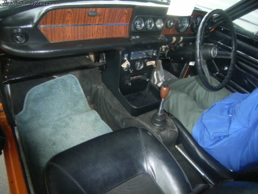

It's the wheels, lack of a DOHC emblem in the grille, chrome backed mirrors and antenna, and wood grain dash, with the shinier than shiny paint that make it really stick out.

I'm pretty sure woodgrain is normally supposed to go ACROSS the car rather than up and down.

Yeah, the wood grain looks wierd but groovy,
yep, the grain is the wrong way for a Bellett, but.......
all GT-R's had grey dash fascias anyway, not woodgrain, so it's even 'more' wrong (and i'm assuming this is what JT191 is elluding too as well).
and the black section that runs along the top of the front guards is wrong too (not wide enough).
i smell another rat...................

It's not the original paint. It would be amazing for a car to be that shiny after 40 years, but also there is a good layer of shiny clear coat in the engine compartment, which would not have been original.
It does have the black at the base of the windshield and edge of the fenders. This lends a little to the idea that the car had those areas painted black originally, or that the owner at least explained that to the painter. If it is being converted by someone who does not have good details on what the car is supposed to look like, the hood might be black but the surrounding metal might not.
I missed the vertical wood grain on the dash. But the center console is black instead of wood grain. A lot of cars seem to have that marbly or burlwood pattern instead of the tan parallel grain. Is this a common customizing item in Japan?

according to body number listed on this vehicle it suggests that it was manufactured
after October 1971 as the body no's for October 1971 start at PR91-4212552 .
Dash panering looks as if it should be on a cupboard in a caravan.
Console looks like a standard 67-69 GT.
If these people are going to attempt to make a replica or a lookalike they should
at least try to get it right
