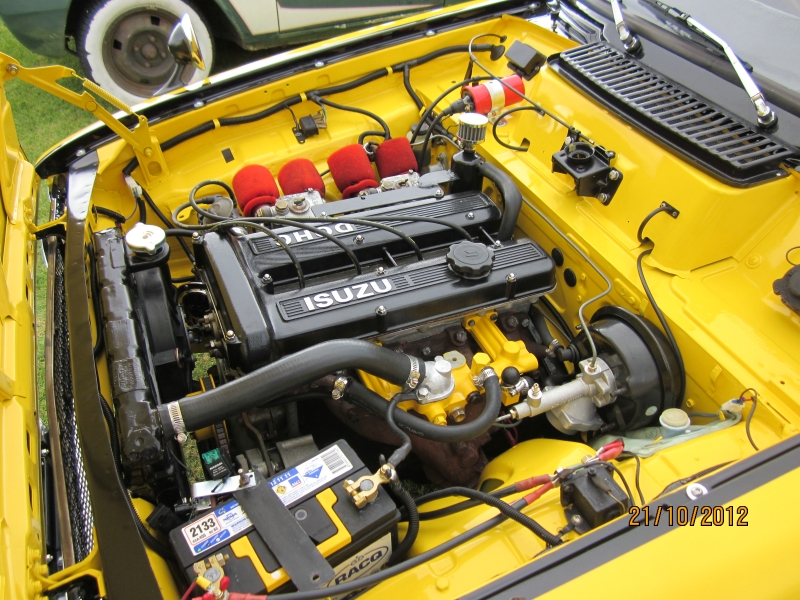

You can also fabricate a manifold for them to run webers. One example was at the nats also of this. The yellow car i think. If you know a aluminium welder mate, then it would not be that hard to do.

Them gemini wrecker is elky on the coast his supplier is me. I have a mould to make these as the ones in the yellow gt above are a set of them. Gricey has spoken to me about having a pair poured.

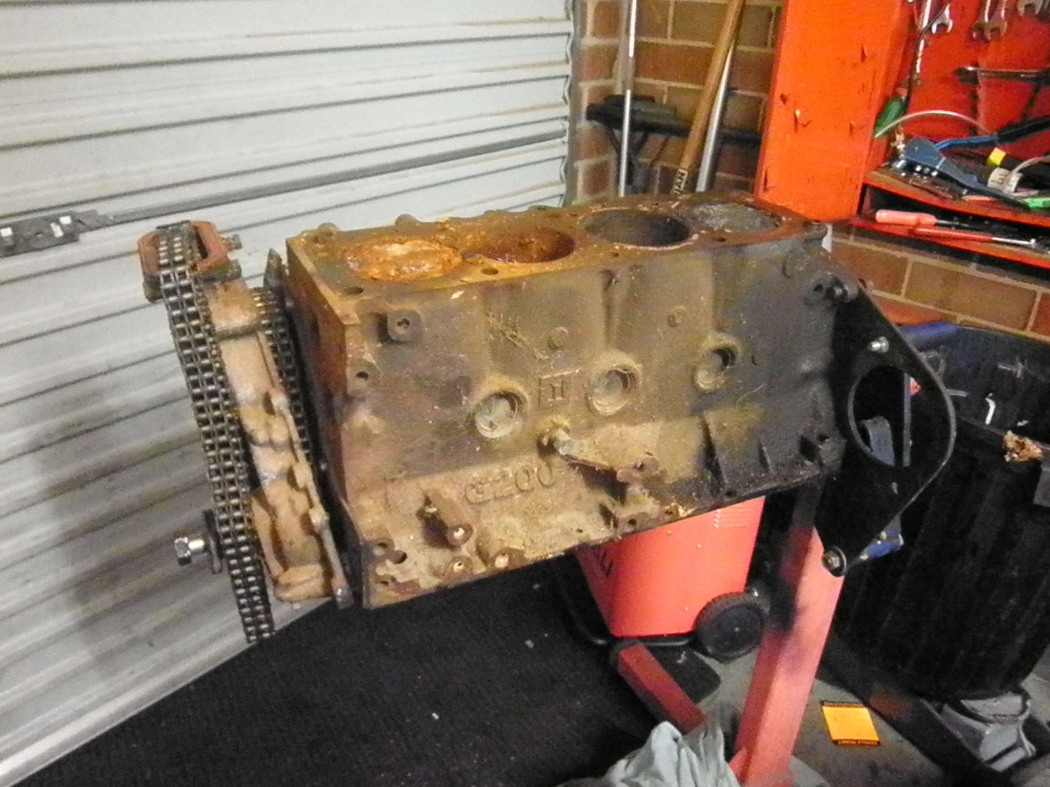

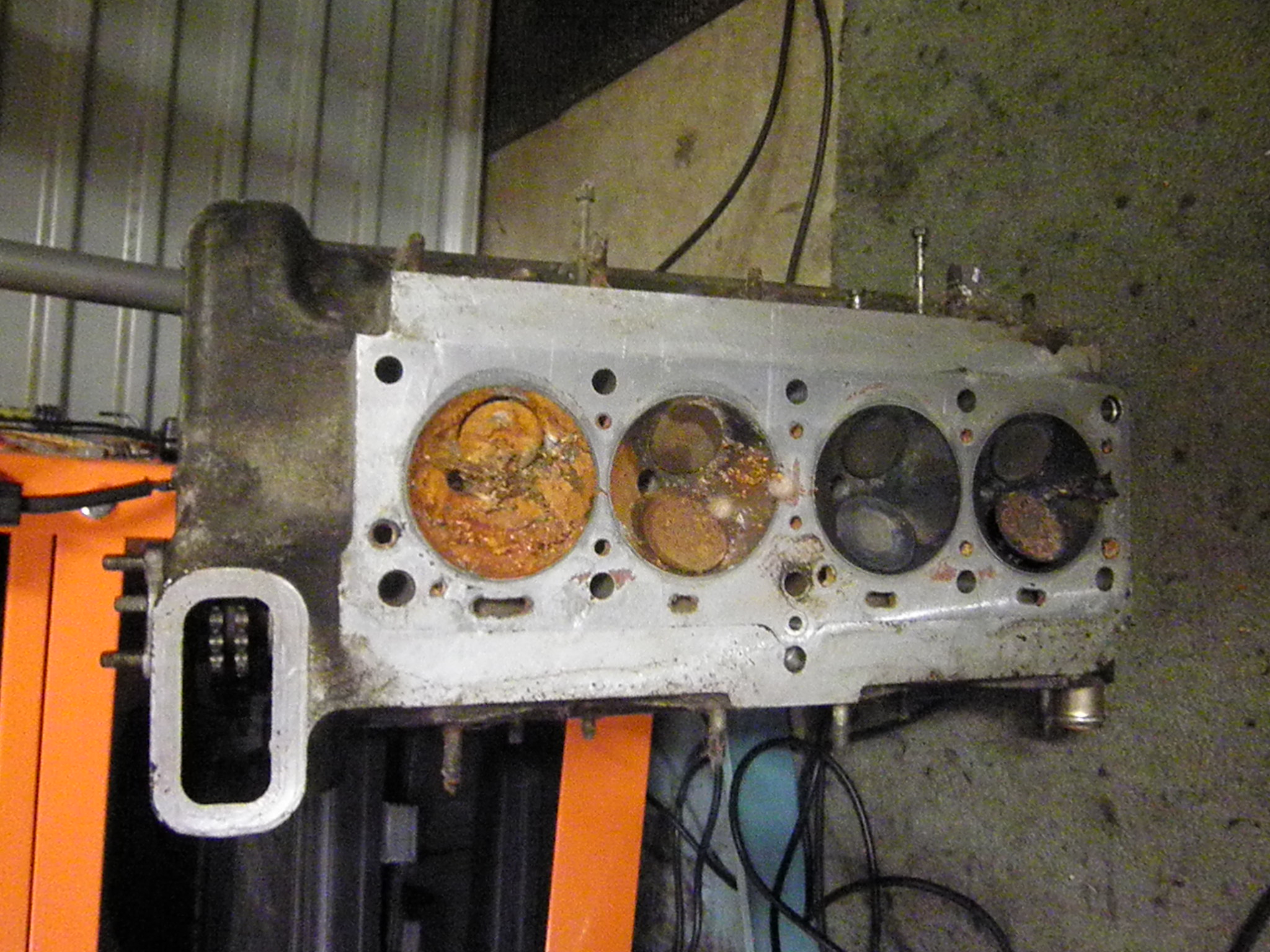

Striped the g200. Not good like the florian . Big ends little ends shot crank damaged. Bore damaged going to need a lot of work . Unless I find something major at the machine shop I still intend to rebuild it. Gricey

BLOCK IS IN THE MACHINE SHOP . I THINK IT NEEDS WORK . GRICEY
