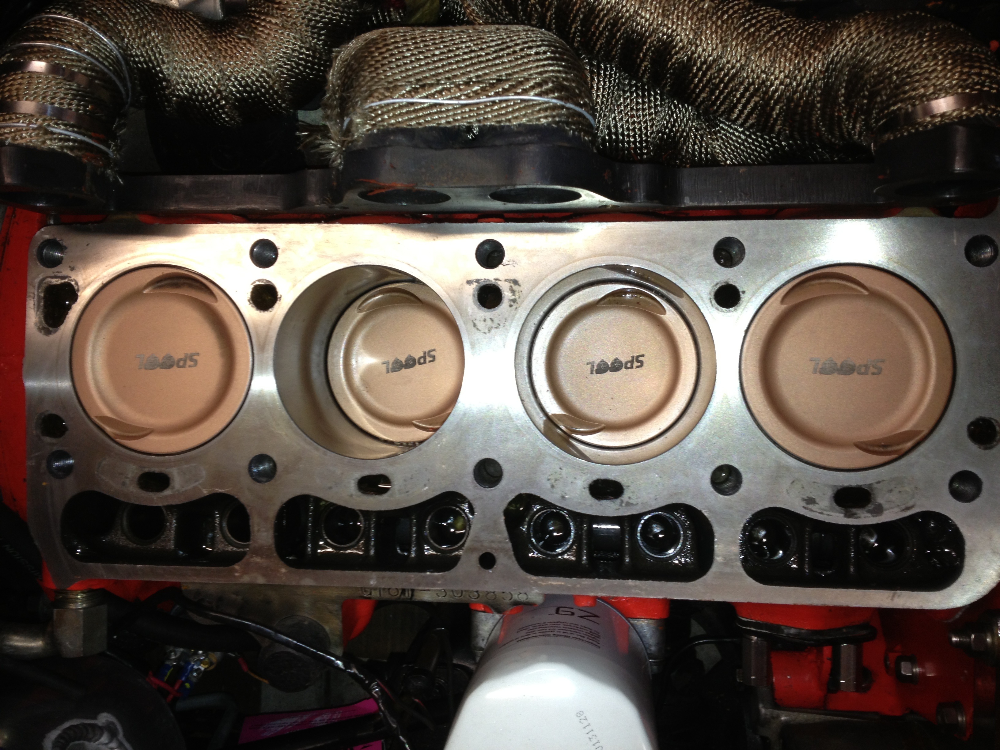

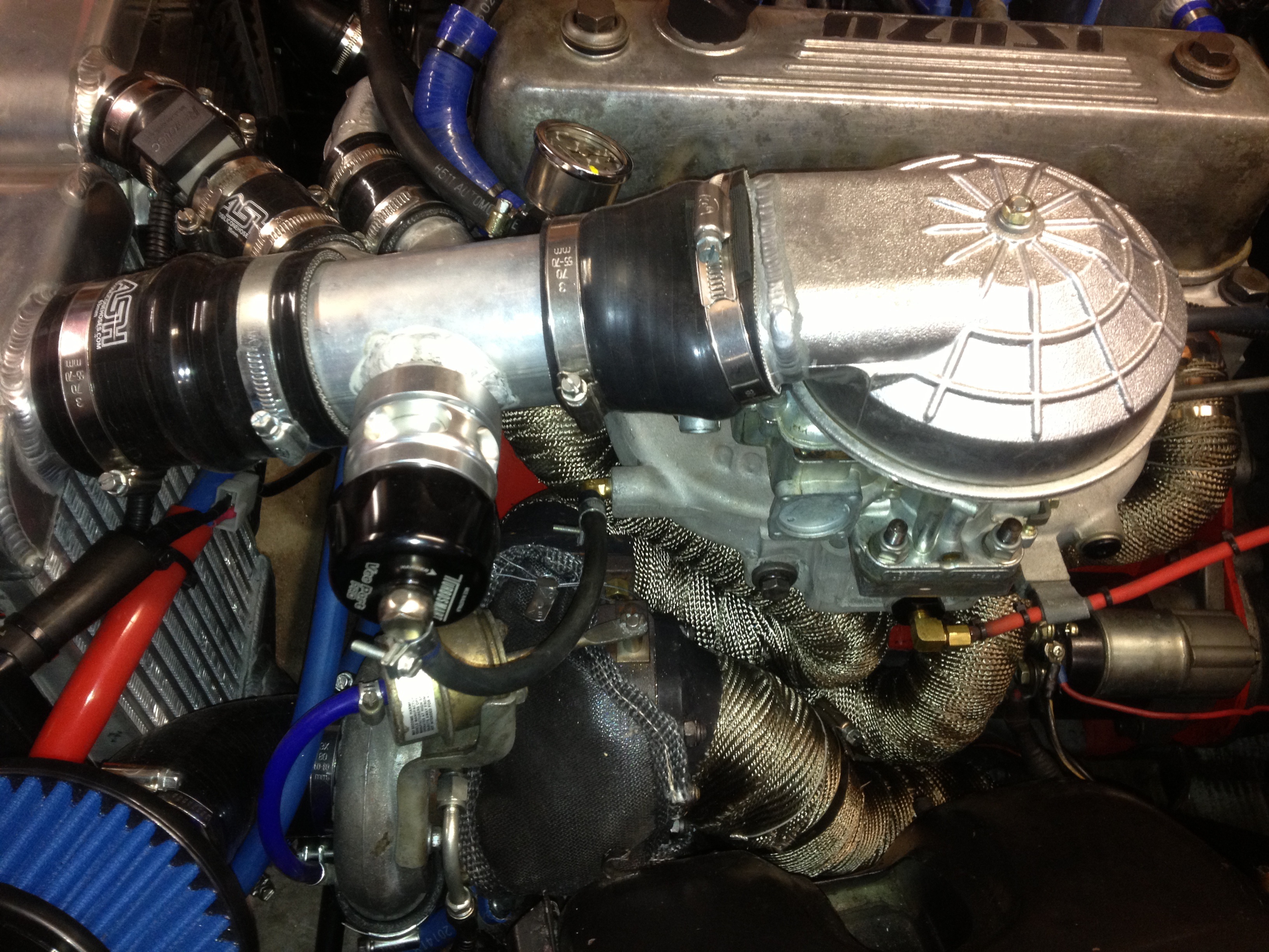

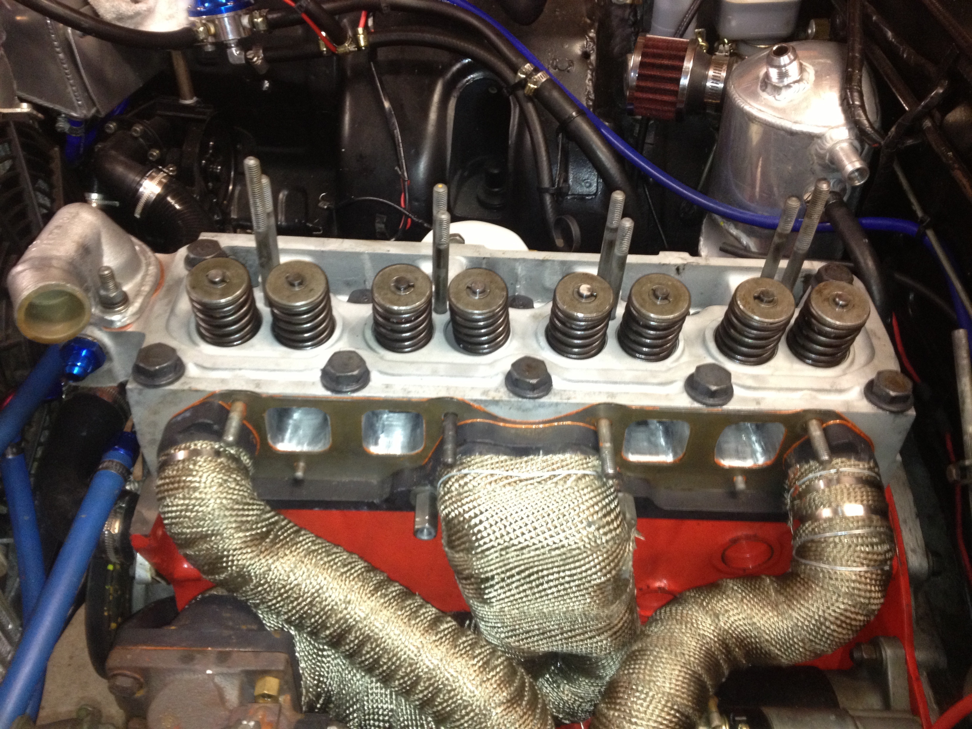

I'm happy to post some pickies so here are a couple
James

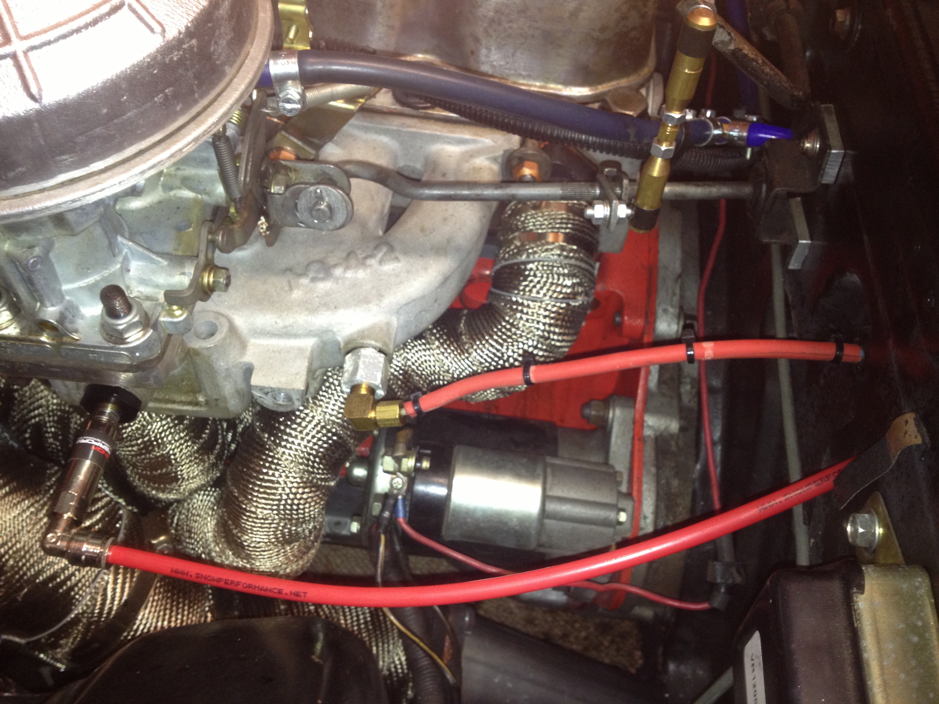

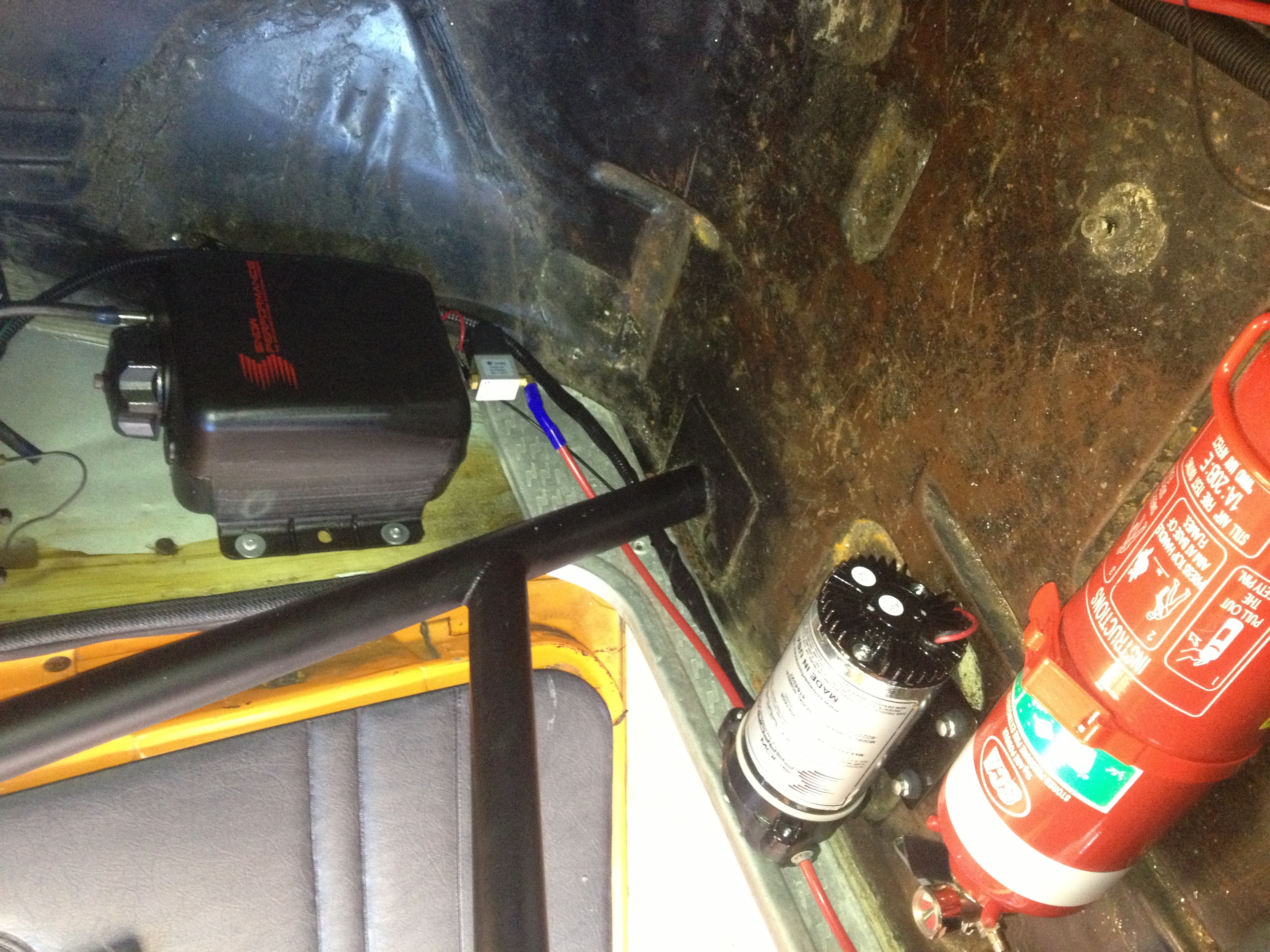

Hi All
Thought you may be interested
Final 'tweak' (for now anyway)
I bit the bullet (with all the excellent builds posted past and present) plus as a very good insurance measure against detonation
And fitted Water/methanol injector system.
I mounted the injector right under the carby in the inlet manifold for best effect
Pulls like a Malley Bull
