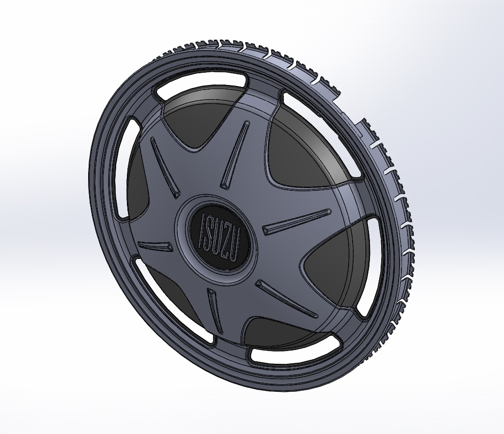

Hi all,
Just putting this one out there, as I've had to resort to recreating some parts for my Silvia, I couldn't see why I couldn't arrange to have some Bellett parts made as well. I have GT fog lamps coming, but as I've tooled up the retainer clip for the Silvia already (which I've used in this assembly), thought I might have a crack at those illusive GT hubcaps! Below is a picture of the CAD model, that's all I've got to show at the moment, although clip samples are coming and the hubcap tooling has been quoted.
SO, what I'm looking for is a show of hands, no commitment at this stage, but I'd like to know if this is worthwhile proceeding with. If I get 10 people interested, a set of 4 hubcaps will be approx. US$1,000, if I get 20 people interested it will be half that - that's with no profit for me, but I'm not fussed, as long as I don't end up out of pocket. As we know, these hubbies are hard to find and, if you find them are often damaged and can be expensive to restore.
If there's no interest I won't bother with it, so is anyone keen?

No-one? Did I over-estimate the desire for hubcaps, or are they too expensive? There's been lots of talk about unobtanium and all that, so I thought there would be more interest at this point.
US$500-600 is realistically as cheap as these would ever get, so if I can't get 20 tentatives I'll drop it and move on to 'Part 2'. I've got fog lamps on the workbench, GT horn button planned too, anything else people may want?

Thanks for the feedback - lots of people have read, but hadn't got much back from anyone. I had so many comments about the hubcaps on my car (which were actually pretty ratty, but looked fine from a distance) that I thought they'd be a good part to focus on to help people get their cars back to looking their original best (if that's your thing). Given I'd tooled up the clip already I couldn't see the harm in throwing a few hours at it and putting the question out there. There's far too much focus on the value of parts these days, it should be all about getting our cars looking great and using them IMO! Originals are originals, repros are expendable to some extent, get 'em while you can and put the originals in safe storage.
Cost wise, basically I've been working pretty hard to keep the price of tooling below US$10k, which is extremely cheap (US$30k-US$40k in USA or here), and my supplier is happy to do small 'prototype' runs (anything less than a few thousand parts), which is almost unheard of. However, to ammortise the tooling cost I'd need 20 orders (80 hubcaps). Of course, the more I get up front, the cheaper the cost, but I simply couldn't see there being the demand...as this post has proven. Additional costs include shipping, customs and duties, GST (for big order) and local postage. US$500-US$600 is in line with restoration costs these days, but finding the hubcaps to even restore is the hard part, as we know. That said, if people can't afford to pay that much for the repros then fair enough.
So basically, if there's 100 out there who want hubcaps we can get it down to US$100/set...spread the word! ;)

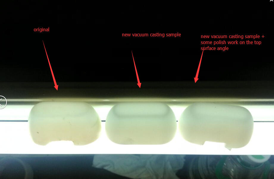

Lets have a look at that badge, there won't be any tooling involved so could be had at the right price. E.G: I have Mazda R360 interior lights coming early next week, cast acrylic (same as production material) made from silicone tooling, I have ordered 15 lenses at US$11ea. So, the process is pretty cheap (if the Aussie Dollar wasn't dropping like a rock), just requires someone to take the time to scan, CAD, produce the production drawings and project manage.

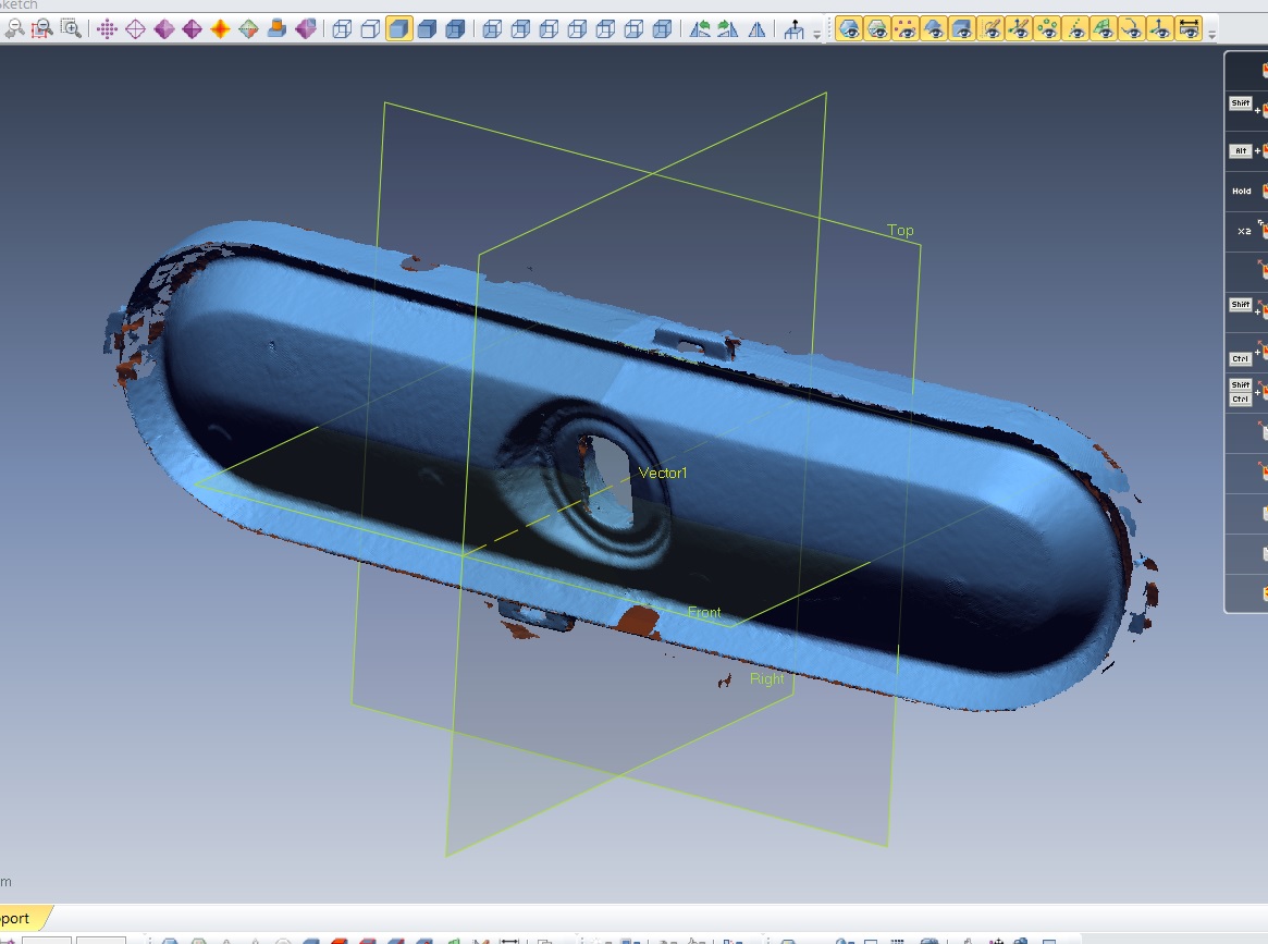

Certainly can do Matt. I've attached a scan of a Silvia replacement lens I'm working on right now - when finished the CAD from this scan will make the lens. These days they have excellent cast acrylics that mimic the properties of injection moulded plastics very well, so if you do your homework you can select the right material to make a part just as good as, or better, than the original. I'm currently testing several materials in the UV tester at work to see how they hold up under extreme UV testing.

The guys up in China sent me some pics tonight, so I've attached the Mazda R360 lenses; original (L), off-tool cast part (M) and final part with light sandblast to replicate the light dissipating rough surface (R). L & R would be pretty hard to tell apart had the plastic not aged on the original and gone a bit yellow. I reckon the little 'snail' front indicators that were on my GT would be perfect for this method - might cost maybe US$20ea, but would look all glossy and amber just like the real thing, with excellent UV stability and impact strength, not fragile like resin.
