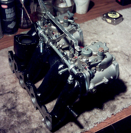

im currently started my complete rebuild of my bellett. but am unsure on which path to take with the motor, its currently g200w turbocharged with a haltech f3, but im thinking i have to rebuild the motor and spend alot of money on it to makeit go fast and slap on a set of brand new 45mm webers, i look at the car as it is it only makes 145rwhp turbocharged, and think it would sound much nicer with webers on it with 130mm trumpets. but the good thing is that the engine is fuel injected and its probably pretty rare being turbocharged and all. But being turbo just doesnt suit the style and era of the car, and lets face it webers do sound great. just give me your thoughts on what i should do to the engine....To keep turbo or not to turbo??

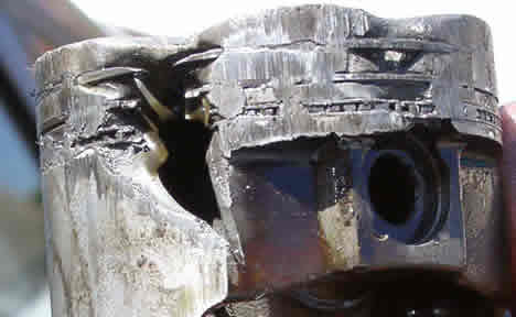

Im for fitting webbers. Webbers dont melt pistons.

Yeah man I'm with Oz. The turbo is a novelty, but those carbies sucking down juice at full throttle would just be cool.
My GT has an EFI DOHC and I'm thinking of carby-fying that too, or at least something along those lines.

i could probably go a injection perfection style quad throttle body setup and keep it fuel injected still would sound nice with the trumpets and quads
Sun Aug 23, 2009 10:54 pm
I have to say there is nothing like the sound of carbies... just such a unique noise and definitely an era setup.
That being said if you want to sell the turbo/manifold and swap parts i've got a N/A g200w that i'm looking at turboing ;) It's in an '84 gemini so it's a bit more era... kinda... not really. Would suit me anyway :D
Keep us posted on your mods.
