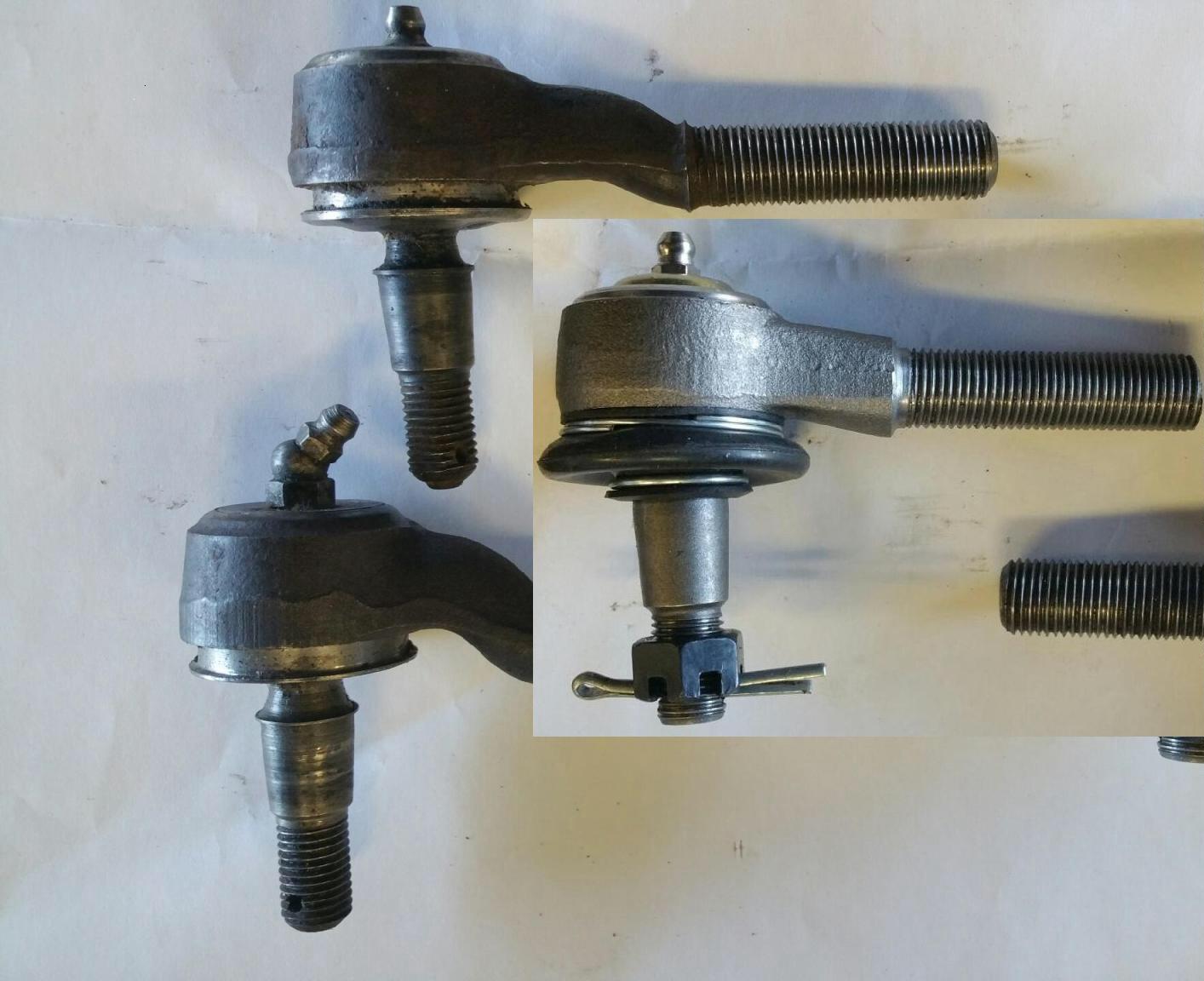

We are pretty damn sure all will be good though for early models as I supplied 66-67 rod ends as in picture as well as steering arms off the spindles
Bulk order would be welcomed though
That's up to you guys from here

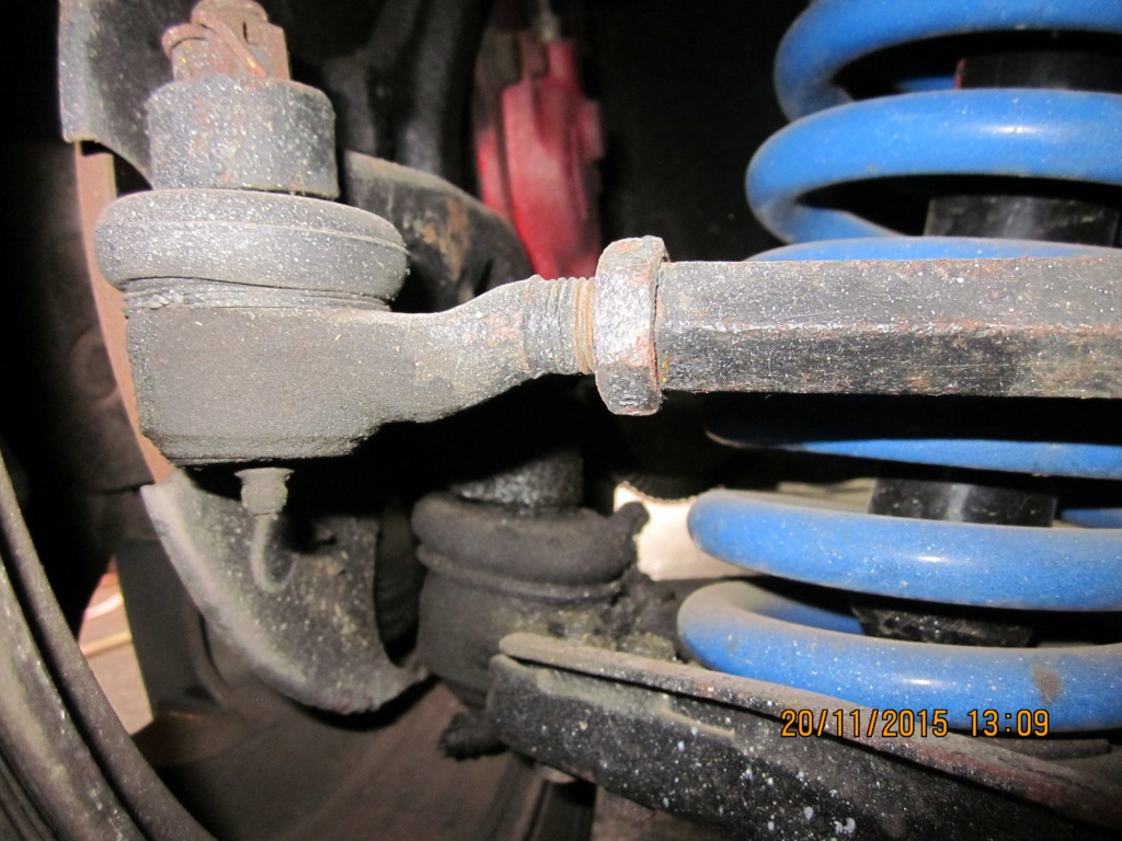

I assume they will be left and rh versions? I 'think' one side has left hand thread ?
On appearance it appears my Sport is the same. anybody confirm ? (pictured)
Is he happy to tell us what they are off ??? Rough costing?
I am guessing that bump steer 'might' be affected with the different offset..... although Belletts have it already, could be better or worse.

I couldn't get my head around the pic so flipped around the new part.... this makes it appear it has LH thread though.....it does not.
Hi Kerry, yes i think you might be correct. Although i wonder why they (Isuzu) put the bend in it ?
Are the Bellett ones two different years in the picture? early/late ?

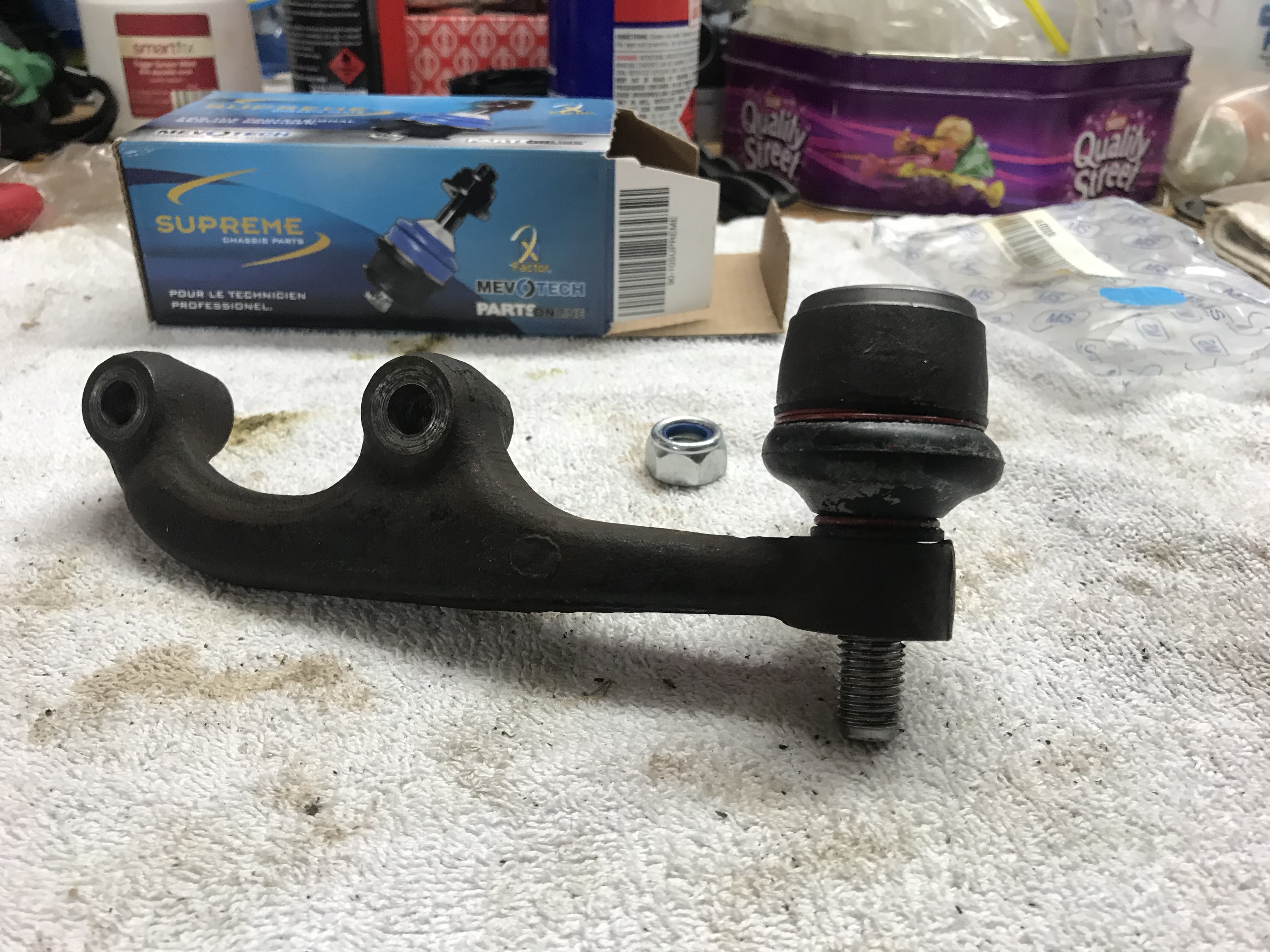

Has anyone fitted these yet?
I have ordered a pair and would like a spare pair, but don't want to outlay that sort of coin only to find out they don't fit.
Tue Nov 24, 2015 7:44 pm
Hi All

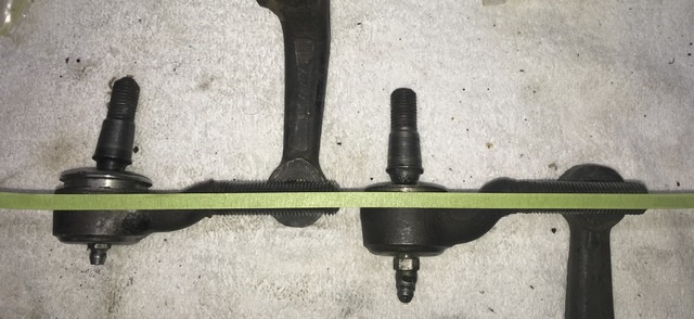

No responsibility taken as have not fitted to my cars but have been busy beavering behind the scene and finally found these, they seem to be a good tie rod for lowered vehicles,
Has been a real challenge to find with a right hand thread

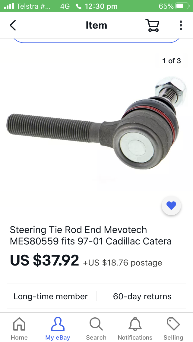

That's very interesting and they hopefully fit, but would early Cadillac or any for that matter, have Metric threads ? (one assumes Bellett is totally Metric)
Tue Nov 24, 2020 3:11 am
The Cadillac Catera is based on the Opel Omega built between 1996 to 2001. This vehicle has the "V" series
platform the same as the Commodore in Australia.
Which leads us to the assumption that if the Commodore (not entirely metric) tie rod ends may fit the Bellett
and be readily available in Australia.
Tue Nov 24, 2020 11:34 am
Be VERY CAREFUL.
Those looks like the ball is located slightly higher than the original in relation to the threaded section. Any change in things like that can give problems with handling, especially bump steer.
Might not look like much but believe me.... 3mm can make a huge difference.
Tue Nov 24, 2020 11:40 pm

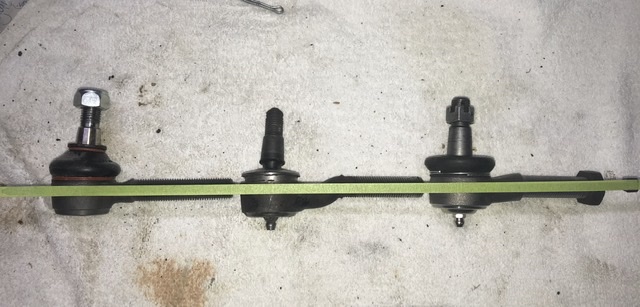

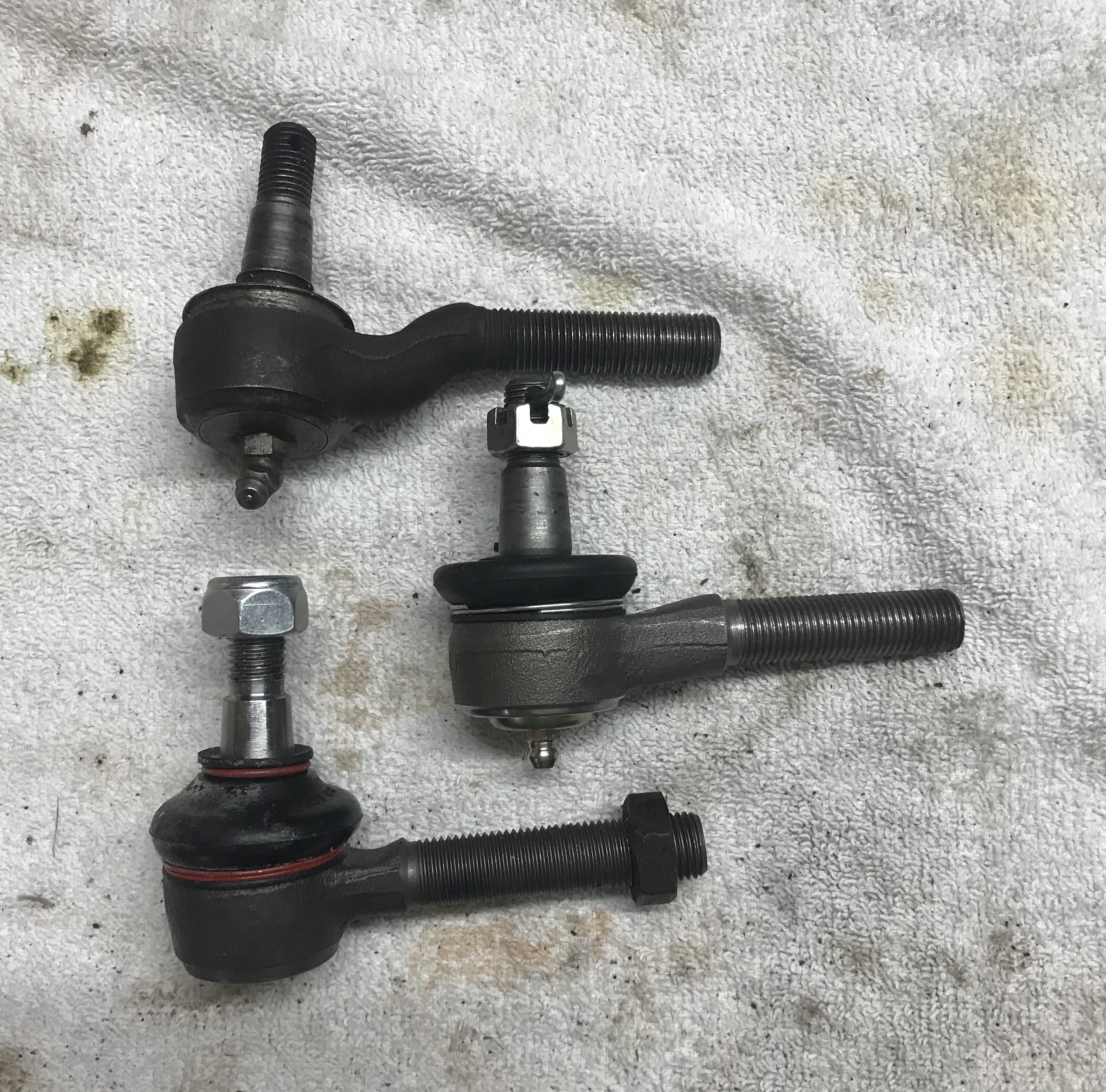

As I said I take no responsibility - investigate with your own merits
Arrr the black art that is Bump steer
For those with keen eye sight amongst us......
The tape is 6mm
