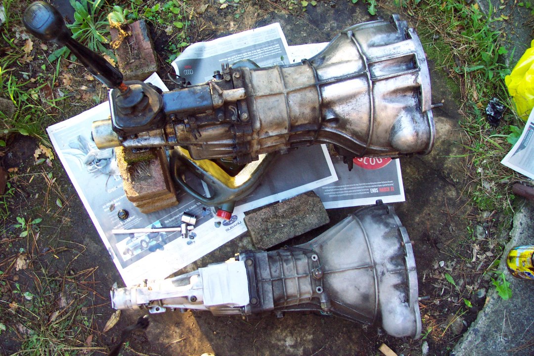

Rodeobob on ozgemini.com wrote:
Shifters
The MSG gearbox has a shifter mounting face that slopes toward the rear of the box.
The MUA gearbox has a shifter mounting face that it parallel to the main shaft in the gearbox.
The shifters are not interchangeable without modifications.
Heres a pic of an MUA box next to an MSG box:
