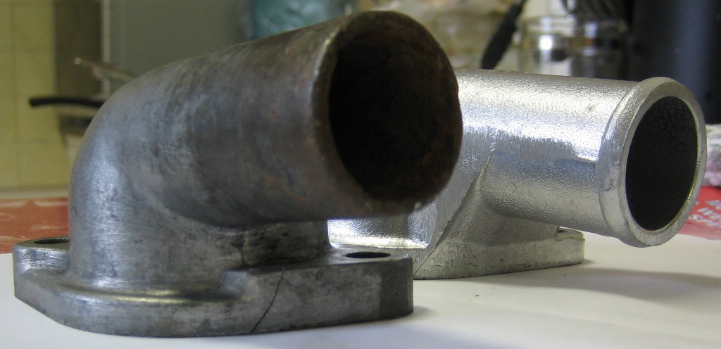

OK, here's the follow up for the thermostat housing. As you can see from the first photo they are not a 100% match but the bolt pattern is identical and the angle of the outlet is right. Attachment:
The next pic shows that the oulet's angle is again slightly wrong but in this case beggars really can't be choosers! Attachment:

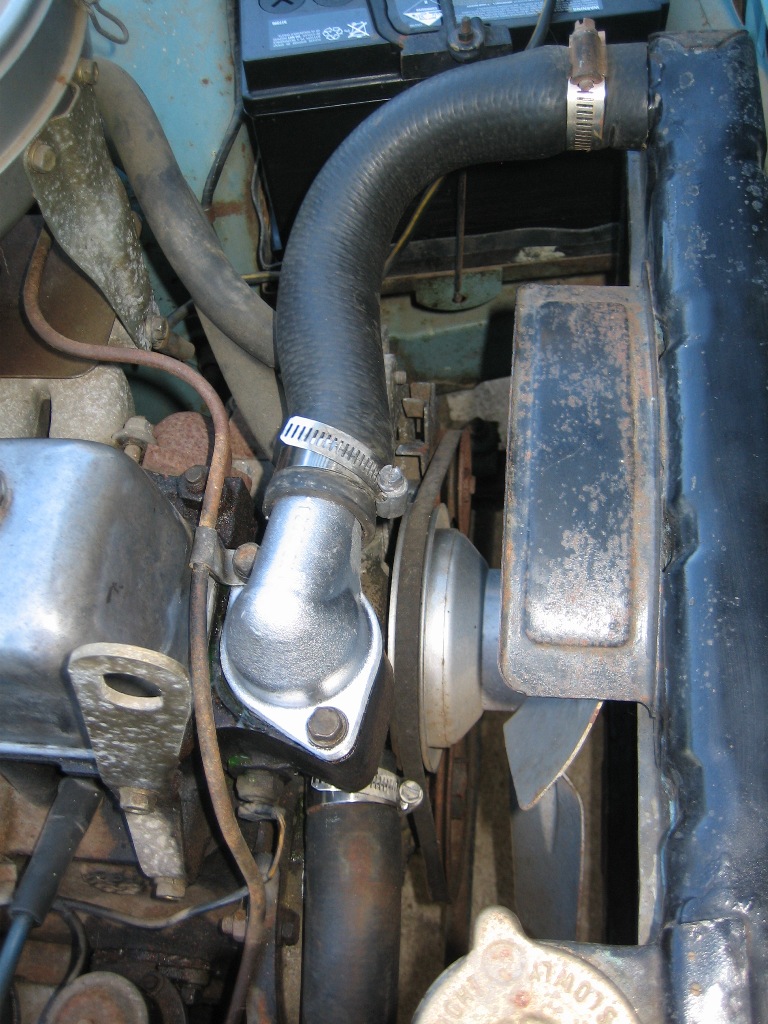

And lastly, the finished product. I had to use two gaskets when I put this back together but this was mainly because I was worried about breaking a second one plus the block wasn't particularly flat! As you can see the outlet pipe is noticeably bending the top pipe but I don't think this will effect anything Attachment:

Looks like it'll do the job. You could probably cut about 2cm off the radiator end of the pipe and get it fitting straighter, though.

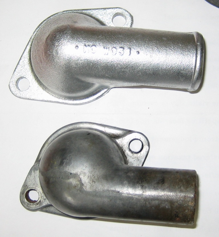

Reference to thermostat housings - Not too many years back, I was able to buy the Genuine part from ADELAIDE TRUCK SPARES. Evidently the same part is used on a small Isuzu truck - model unknown. The label reads ISUZU GENUINE PART ; ISUZU Pt No. 9-13713064-1; P No. 94021888; Des PIPE;WATER Fig key No. 031-049
However, putting all that aside, I am currently running a WO33 from Killkenny Castings which is to suit an RT18 four cylinder engine from a Toyota 1977 RA28 Celica. A housing from an RT18 engine in a Corona does suit but pipe exit is at slightly different angles I believe.
