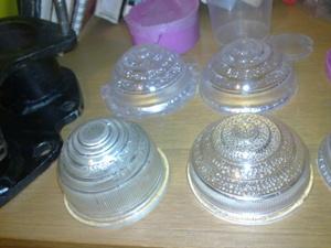

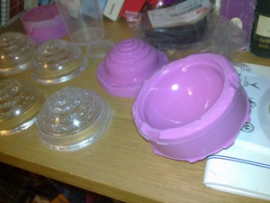

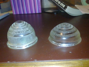

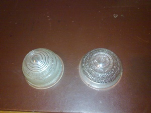

Hi Guys
Here is a picture of the Lucas Lens l594 on the left and an Original Bellett 67 gt glass on the right
and my bellett copies in the backround

I was looking at the one with the taller dome. I found a link that said there were three or four different lenses on the Lucas equipped British cars:
http://www.triumphspitfire.com/frontlights.html
This in the shallower clear lens (1950's):
http://www.ebay.com/itm/200877593935
But it looks like the early GT might be halfway between the two.
Finding which one is the closest match might also trace what was the inspiration when the GT was designed. It sounded like they took a smorgasbord approach, a little of this car, a little of that, and mixed them up. And whatever the inspiration, it would have to predate the car's introduction. The shorter 1950's lens might be it.
