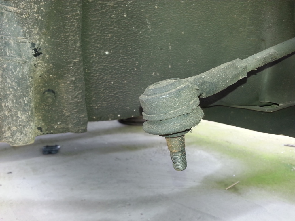

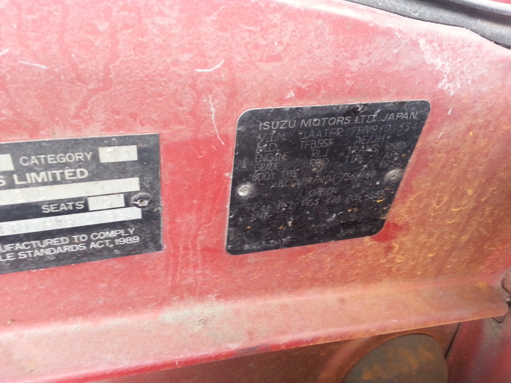

I was in the wreckers the other day and saw a couple of tie rod ends.......... CAUTION, i have no idea if these actually fit but they look similar in size to Bellett. Info given as is... ! Might be worth checking further if one has a spare steering arm ( I don't) to try the fit, and if ok, measure up length, thread size etc.

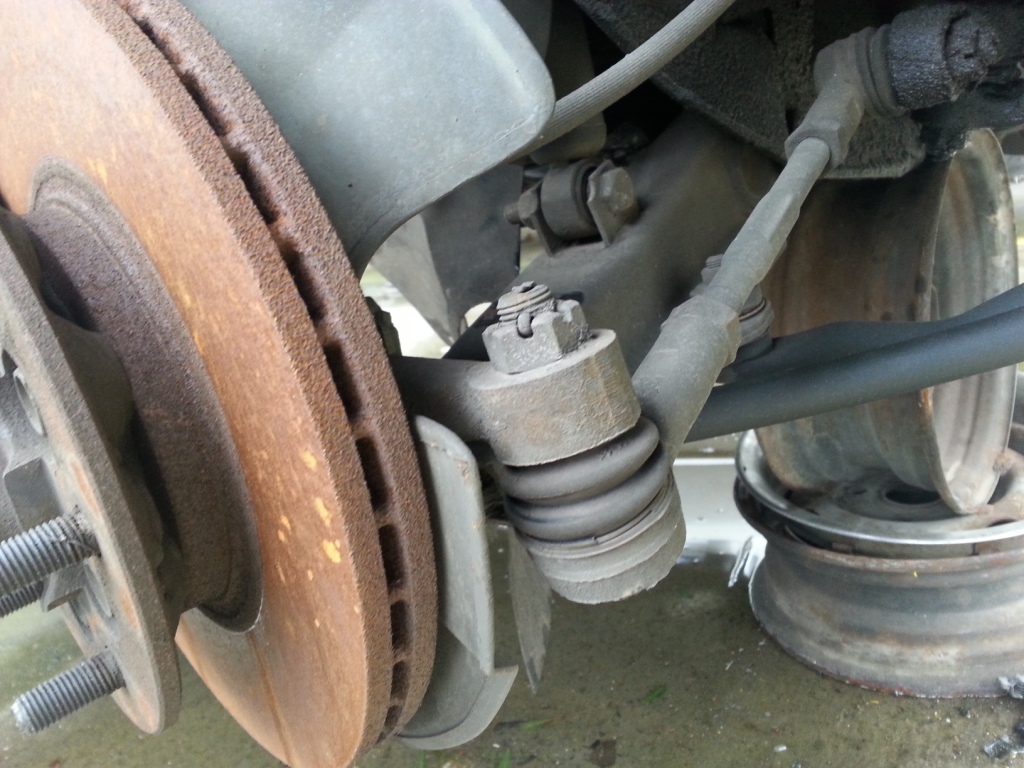

Kia...... forgot to check actual model.

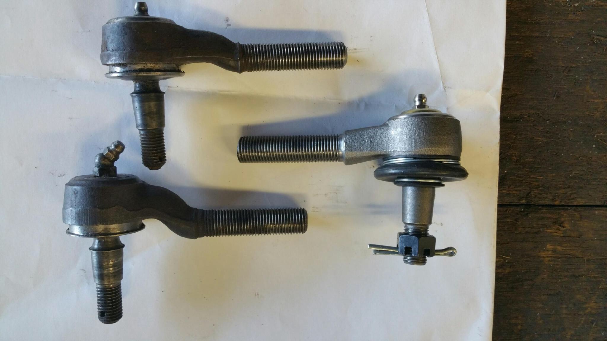

this is the ones ...in japan ...on yahoo
Thu Nov 05, 2015 8:13 am
Yep
They Could be the ones....
I'm trying to find a longer solution for all by finding cheap readily available alternative.....
Much like the brake upgrade....
Thinking long term so we can keep enjoying our little cars

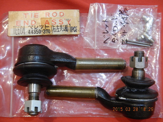

Finally found the add in Japan
$388 + Postage is the starting bit.......
So my point wasn't specifically relating to the brake upgrade as such rather to find a cheap, readily available alternative to the NOS Bellett tie rod ends for standard vehicles....
Thu Nov 05, 2015 9:01 pm
The part number 44350-370 is the genuine number for sedans and GT's up to '66.5.
After that date it is 44350-418. According to Isuzu there is NO interchange.
They changed the steering arm at the same time. If I had a used arm and end off of a
vehicle I would use both to be safe. But. Before I do. I would check the history of the donor
and also check dimensions.

Alright boys and girls
Hard work is done
Place your orders
Mike Quinn Precision Engineering
Unit 32/788-798 Marion Rd
Marion
SA 5043
08 8298 7066
