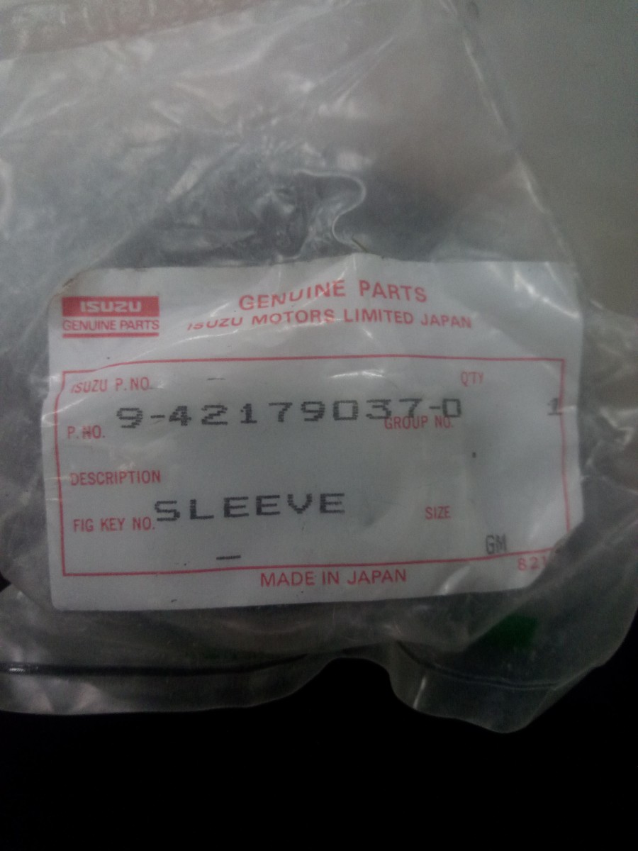

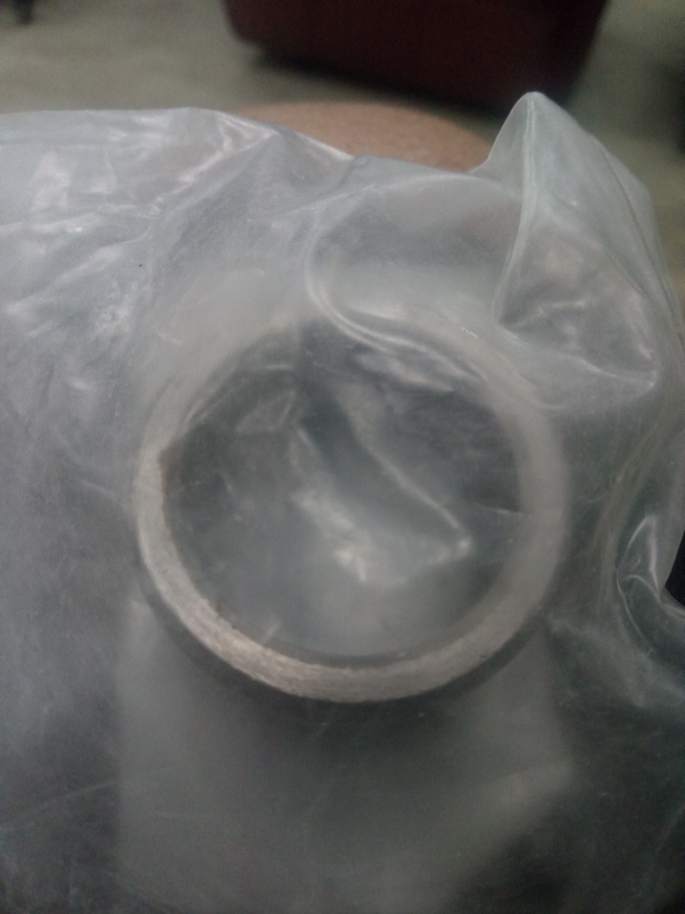

Sleeve
Posts: 76
What is a 9421790370 Sleeve? (Edit: they are the retaining ring for the rear axles to hold in the Main bearing.)
I'm having a bit of a clean up/out and found four (Edit: 5) of these deep in a box from PA's collection.
Don't want to loose/ chuck if its made of unobtainium. ;) (Edit: Yes they are for sale, at the right price)
Edit: 2x sold pending. 3x still available 19/02/2019.

Hi Dean,
I've nearly finished the process of rebuilding the diff on the GT, and thought about checking the rear wheel bearings. Just as well - there's a bit of wobble in the axle shaft, so the bearings definitely need replacement after about 350,000 km and over 50 years!!!!
Do you still have 2 of these sleeves in your collection? There is a good chance that the originals will get destroyed trying to remove them. Have tried 4x threaded rods and a gas torch but only managed to strip the threads. Need to find someone with a decent press and make up a collet to get the old sleeve off.
