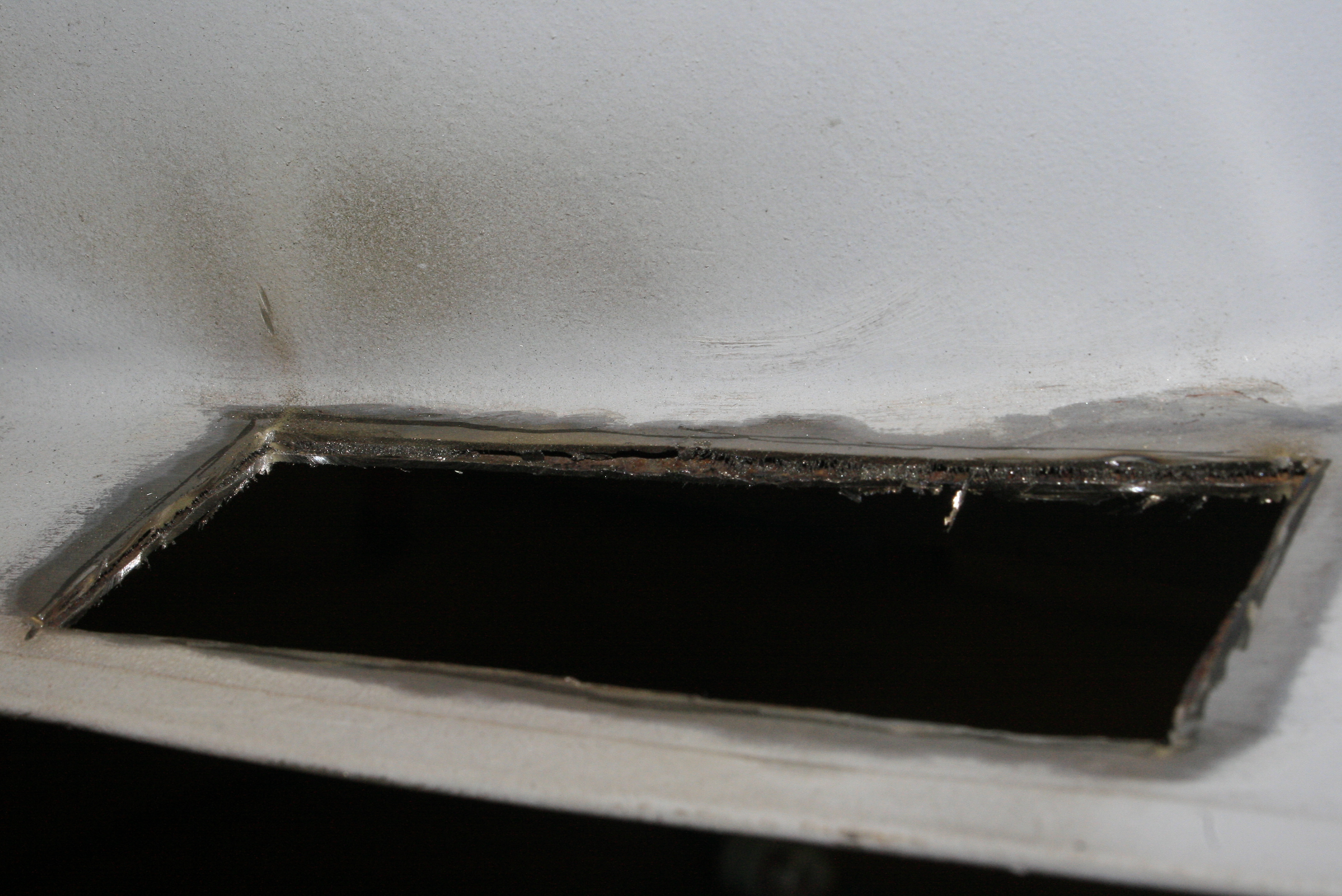

..I Paid Close Attention To The Depth I Was Cutting As I Was Unsure If The Outer/Inner Skin Was Good Or Not..

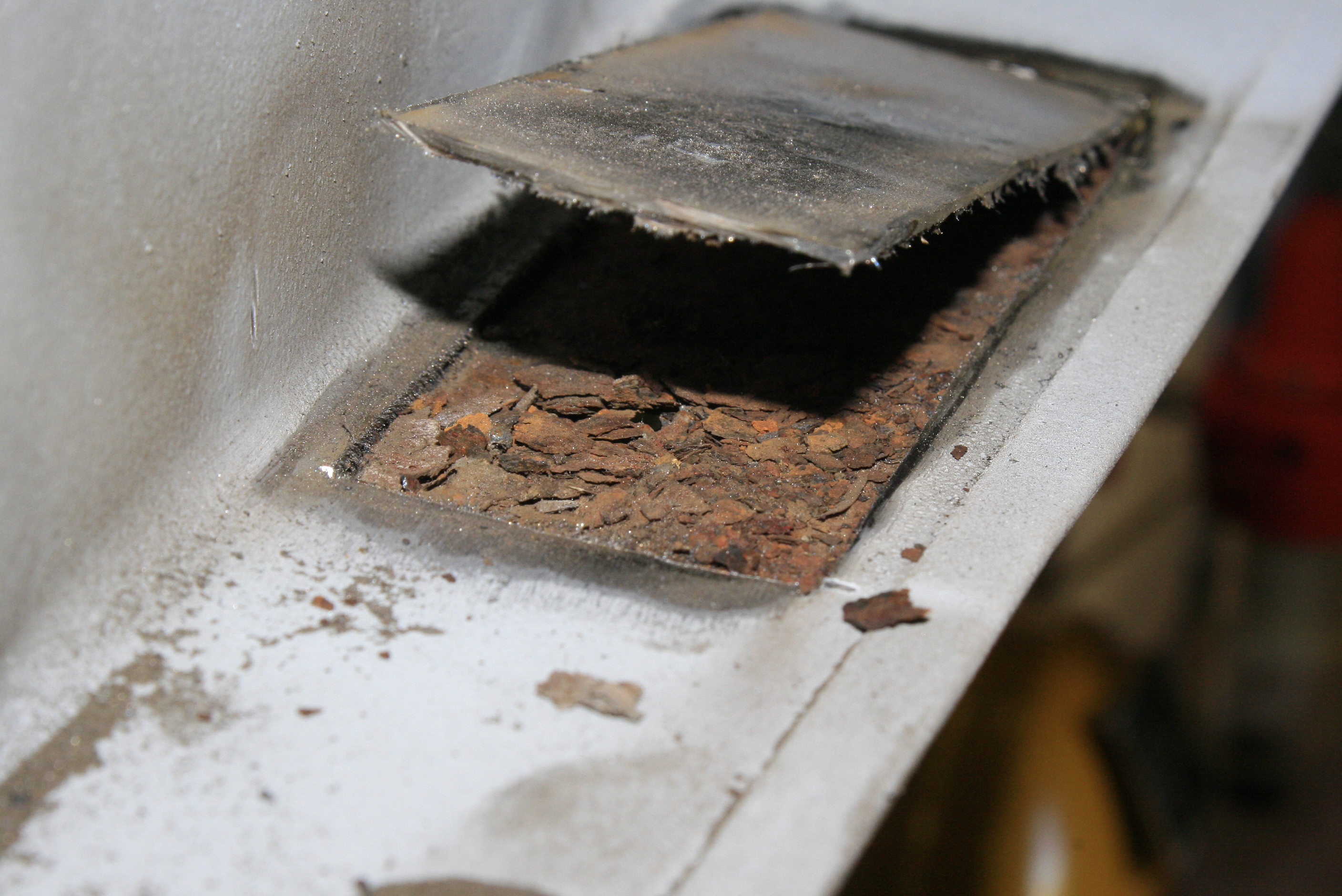

Posts: 368
...Once Cut & Pried Apart I Was Able To See Why The Bulge Was There, Plenty Of Rust Within As I Expected...

....Quite The Mess....

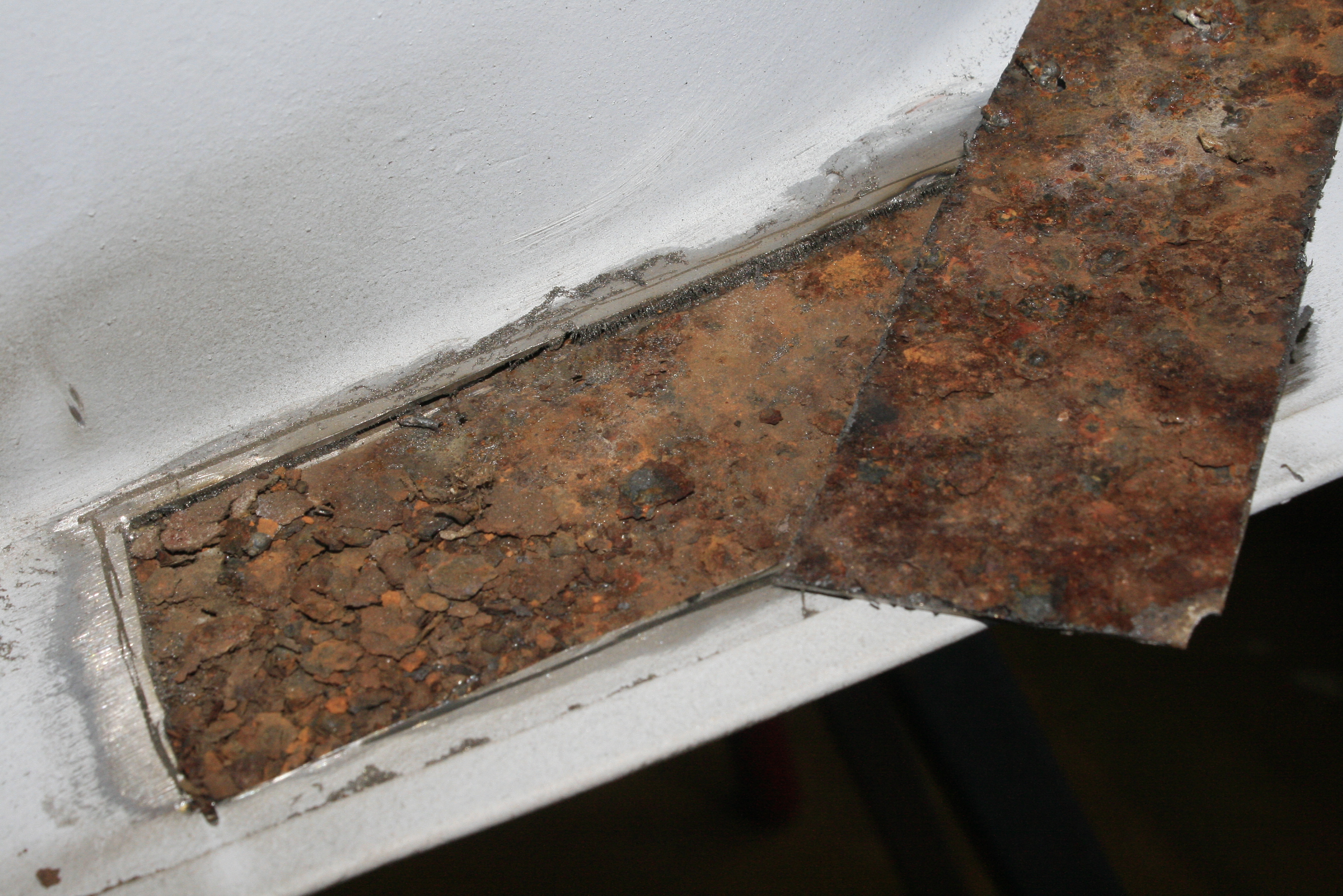

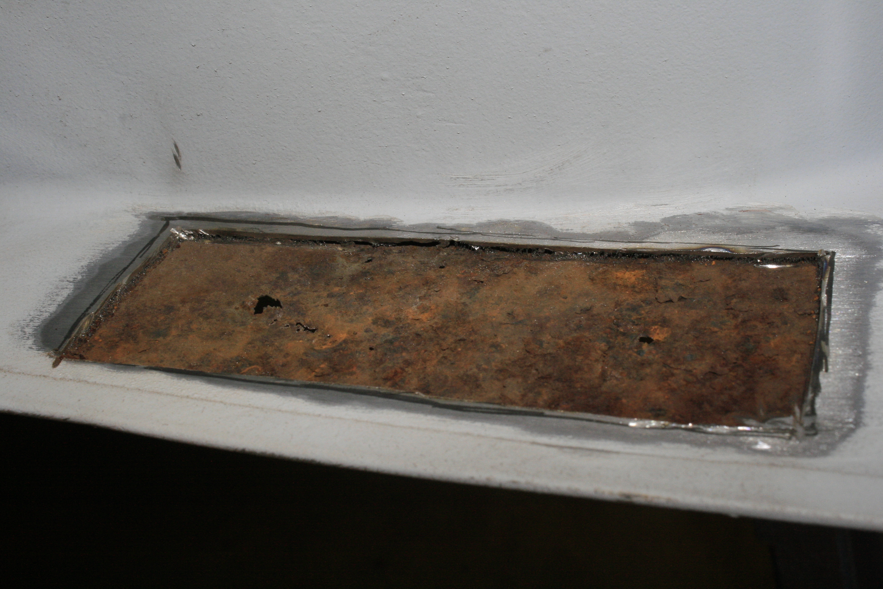

Posts: 368
.....After I Cleaned Out All The Rust Shards I Was Then Able To See Just How Bad The Surface Rust Was On The Inner Faces & Made The Choice To Continue Cutting My Way Through To Continue On With My Original Plan Of Replacing Both Sections.....

......Rough-Cut......

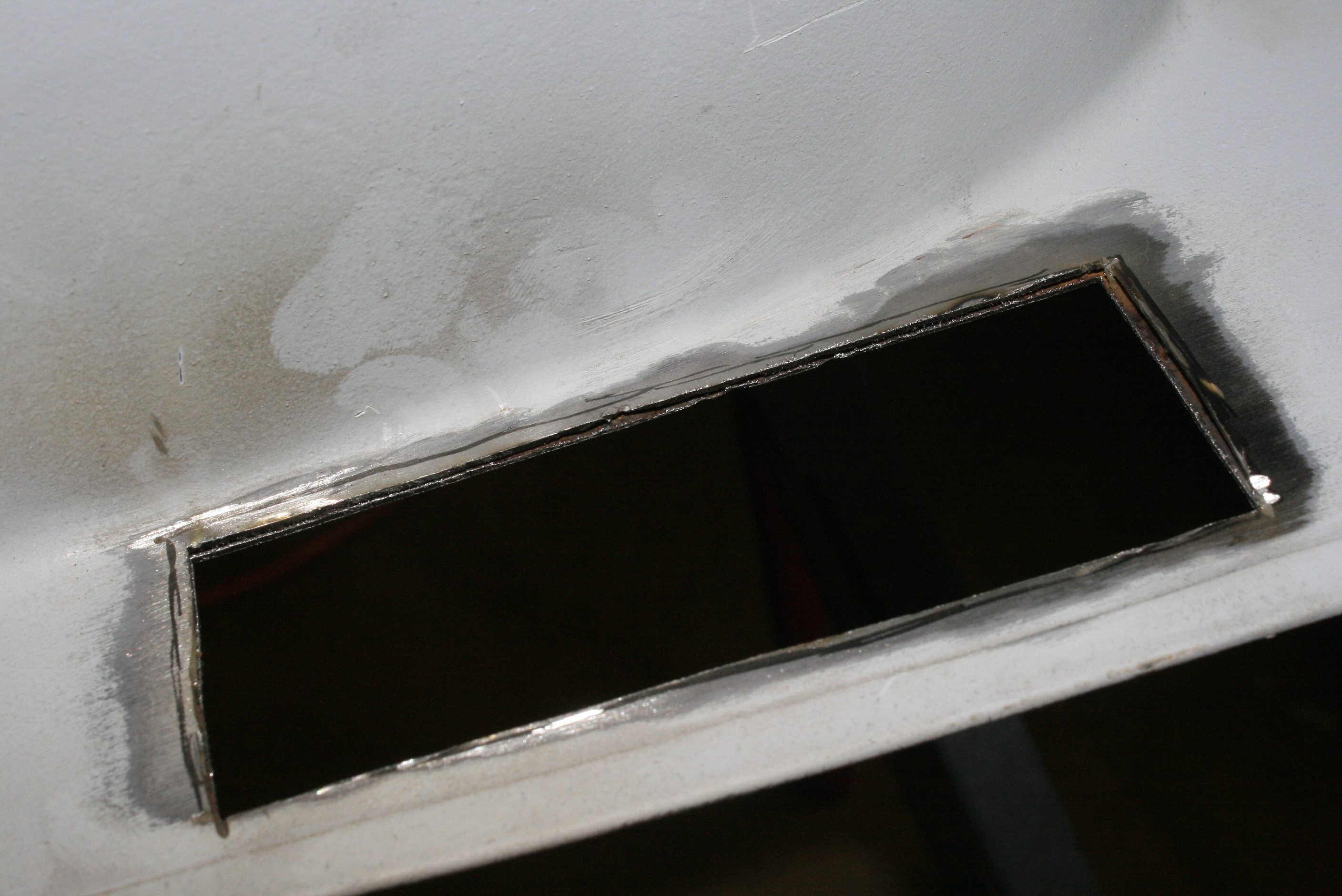

Posts: 368
.......File & De-Burr All The Surfaces.......

........I Would Of Loved To Do A Skin Off Restoration Given All The Potential Rust Between All But Maybe Later On In Life, At Least She Would Be A Good Base To Do So After This Restoration........

.........A Closer Look At The Exposed Sides.........

..........& Now A Closer Look At The Unexposed Sides.(Scary)..........

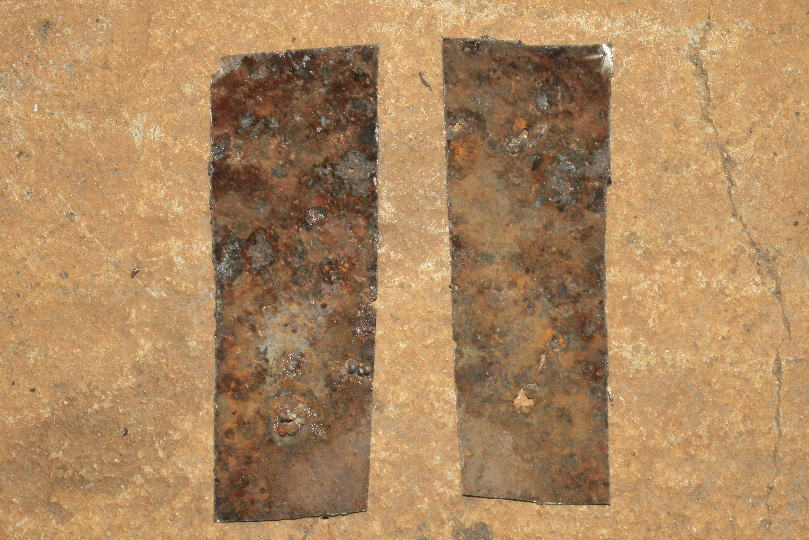

Posts: 368

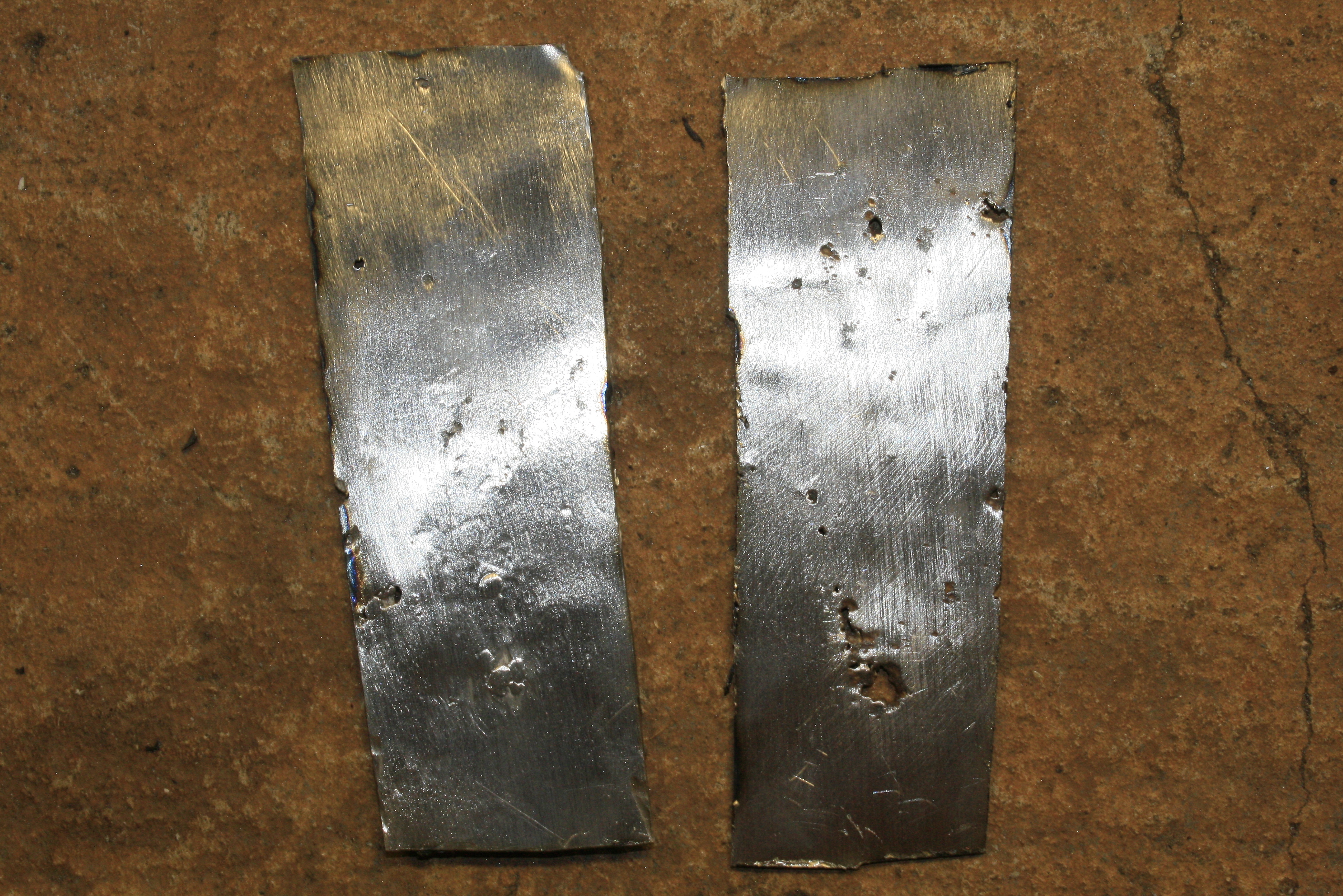

.Back At It Again.

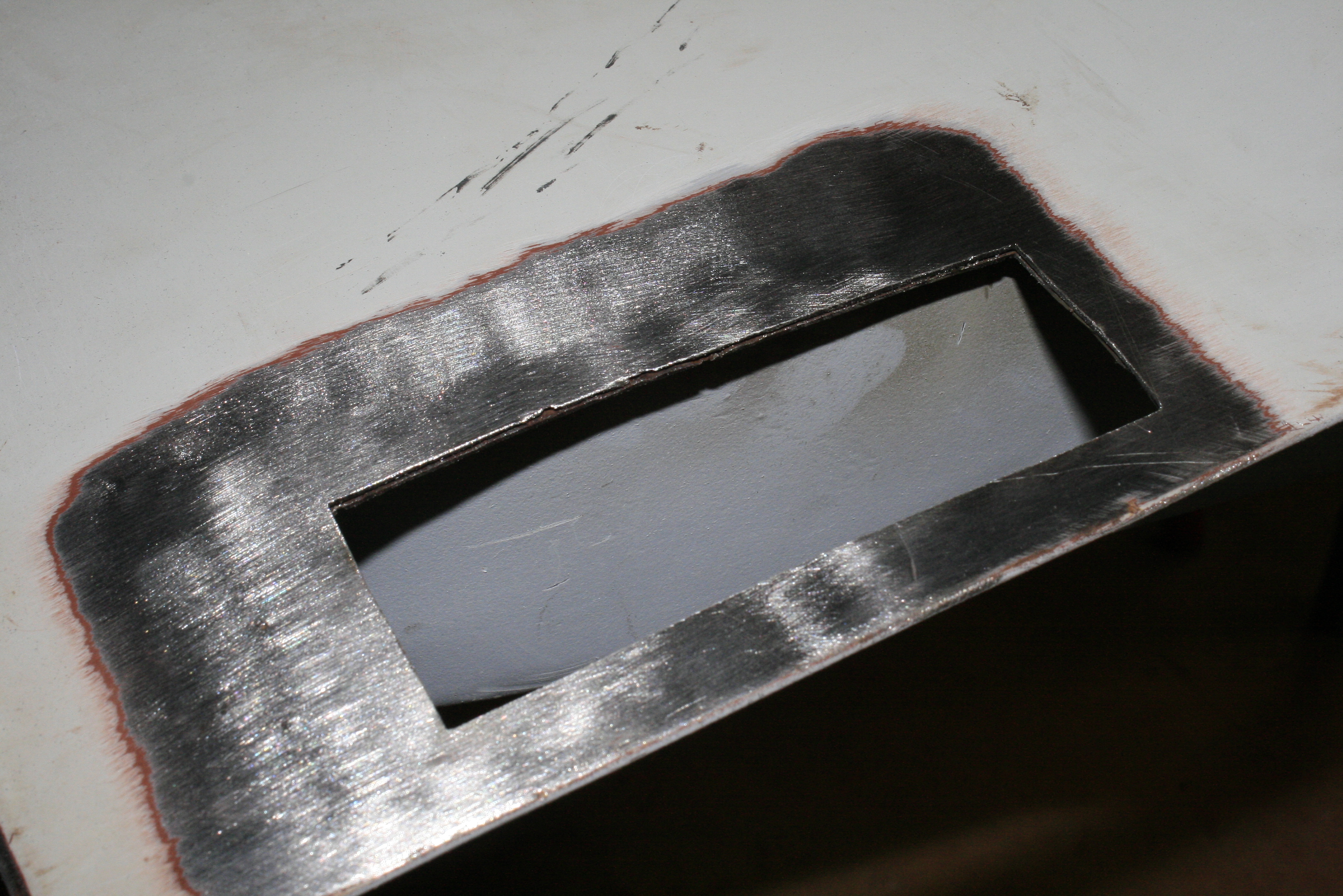

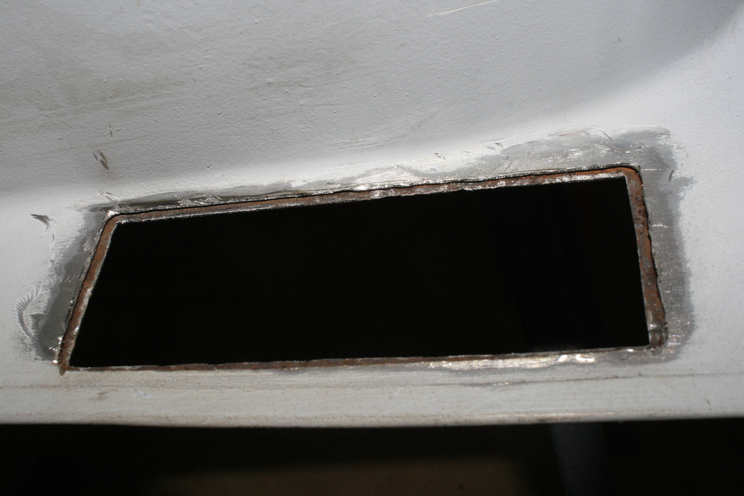

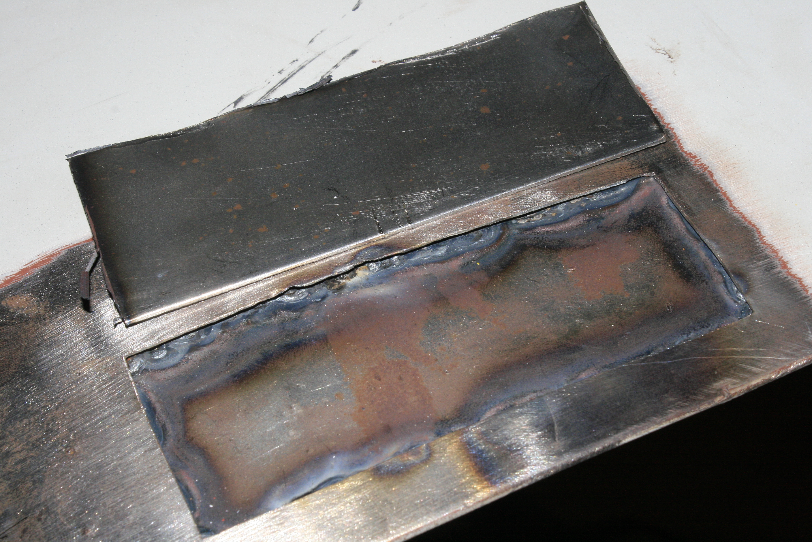

Posts: 368
..Dad Suggested To Grind The Inner Sheet In A-Bit So To Create A Step All Way Round Which Will Help Absorb The Heat When Welding & It Works To, It Greatly Lessened The Chance Of A Blow-Through When Welding (Thanks Dad)..

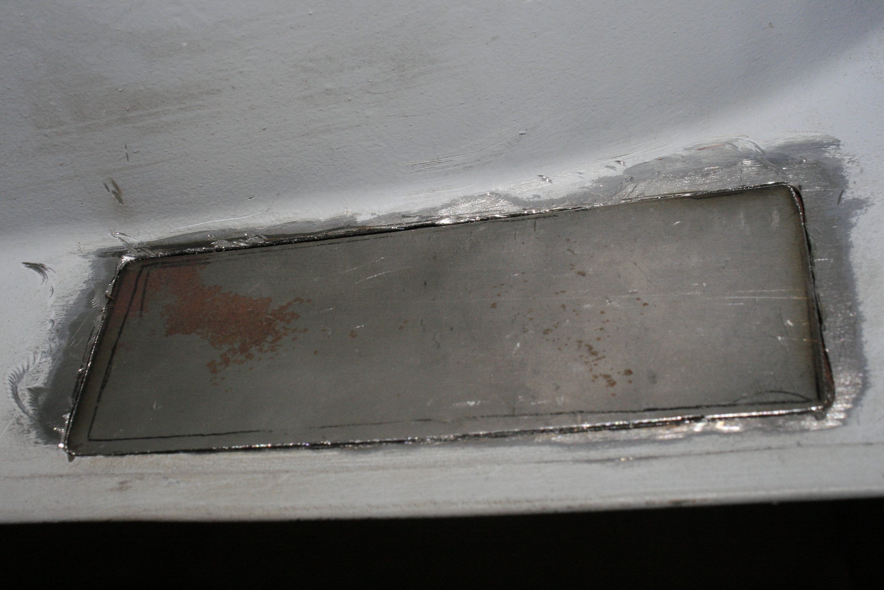

Posts: 368
...A Few Dummy Fits & Fine Tuning Before Welding, It's Easy To Get Ahead Of Oneself Sorry...

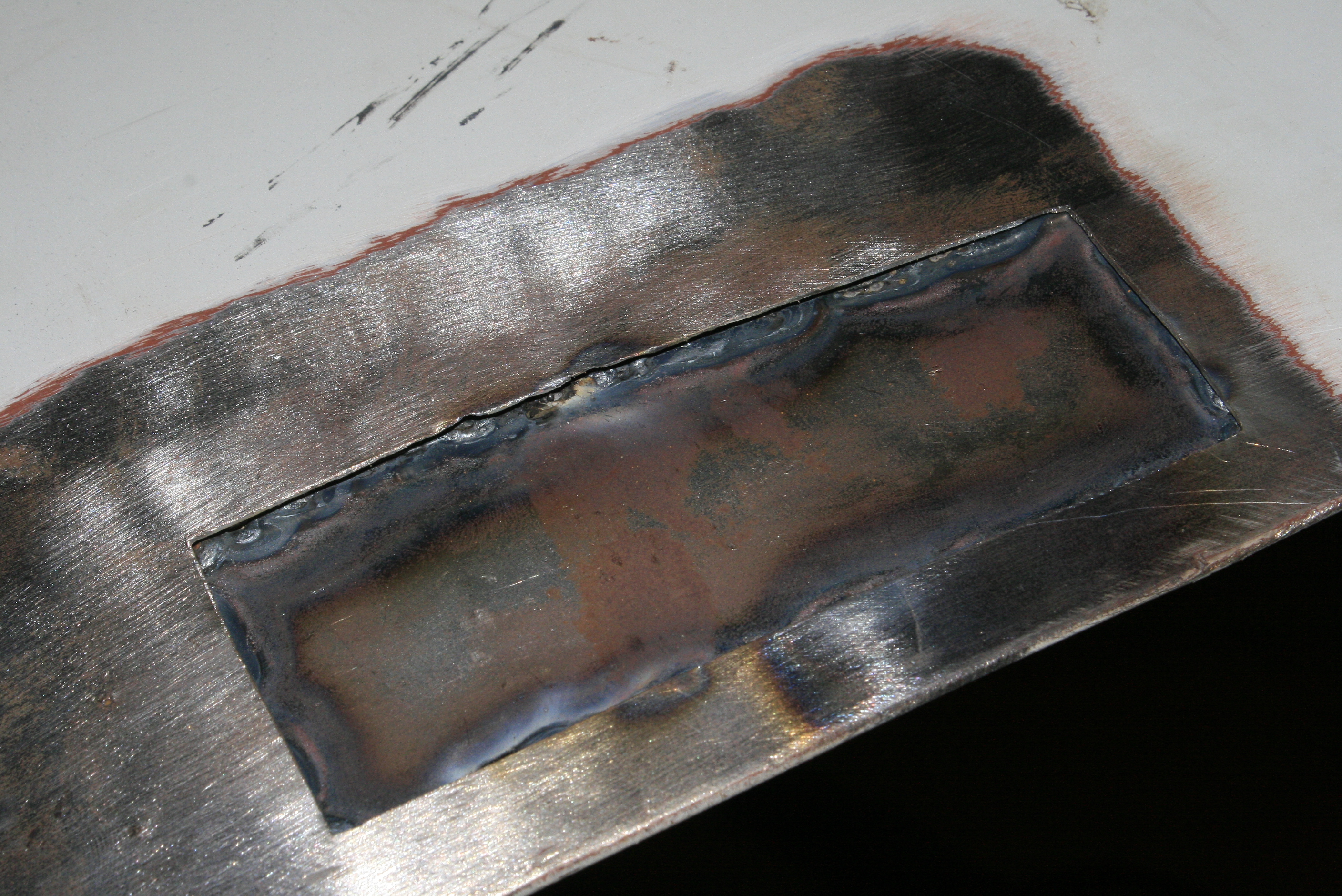

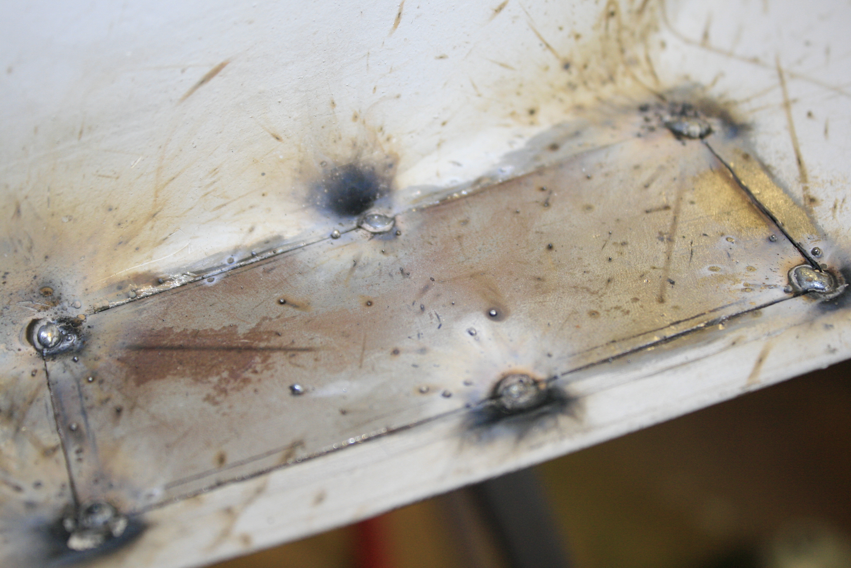

Posts: 368
....I Hit It With A Few Spot-Welds So It Won't Distort When Welding It In....

Posts: 368
.....& Away I Went!

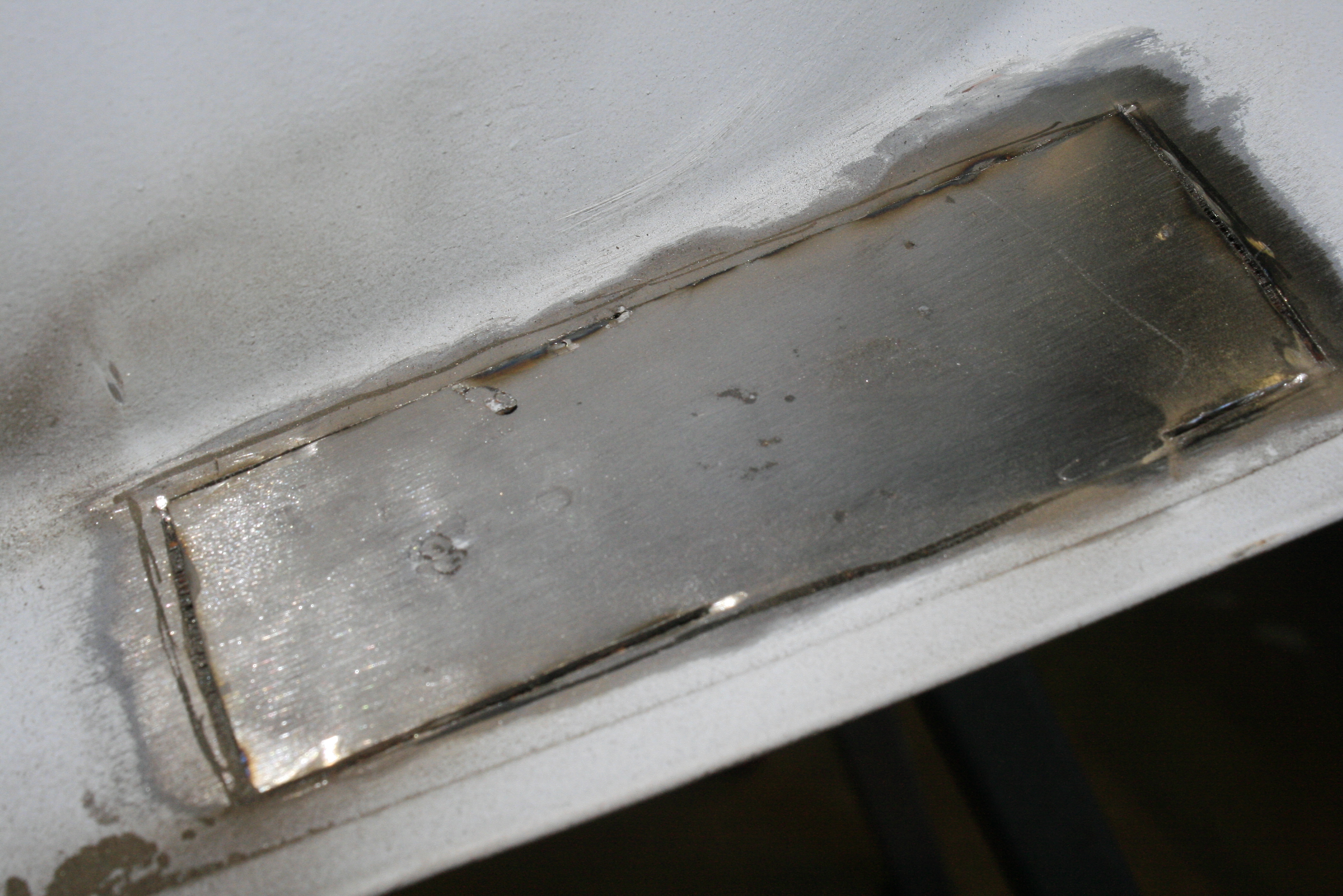

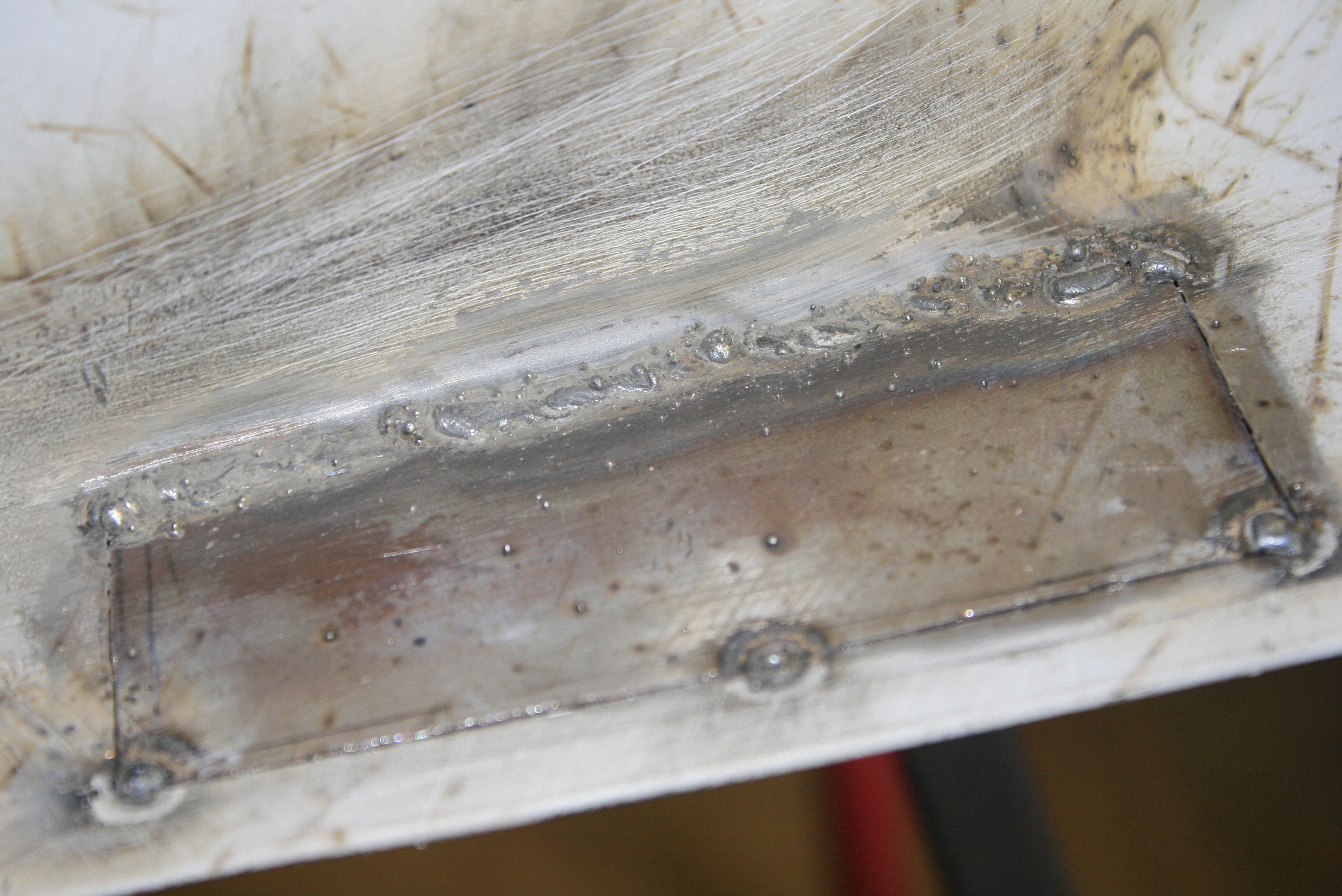

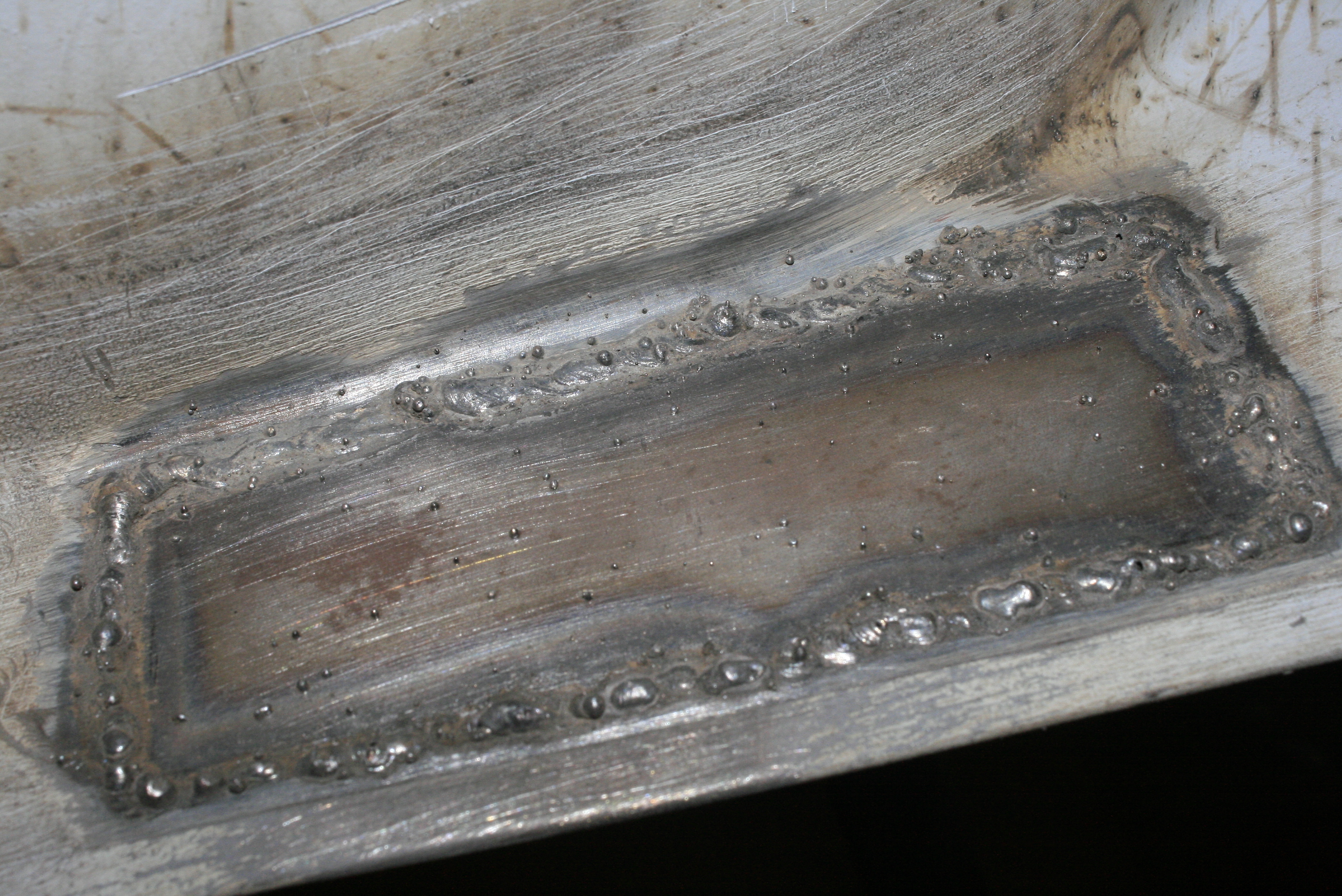

Posts: 368
......Not The Best Job I Know, It's Quite Hard To Weld & Work With Half Rusted Sheet Metal (That Being All The Bellett's Metal) But Dad's Step Idea Helped Dissipate A-Lot Of The Heat & Most Of The Welds Were Fused Correct From What I Can See But I Can Also See A-Lot Of Bad Welds (More So After The Clean Up) & A Need To Go Back Over It Again Haunts My Mind......

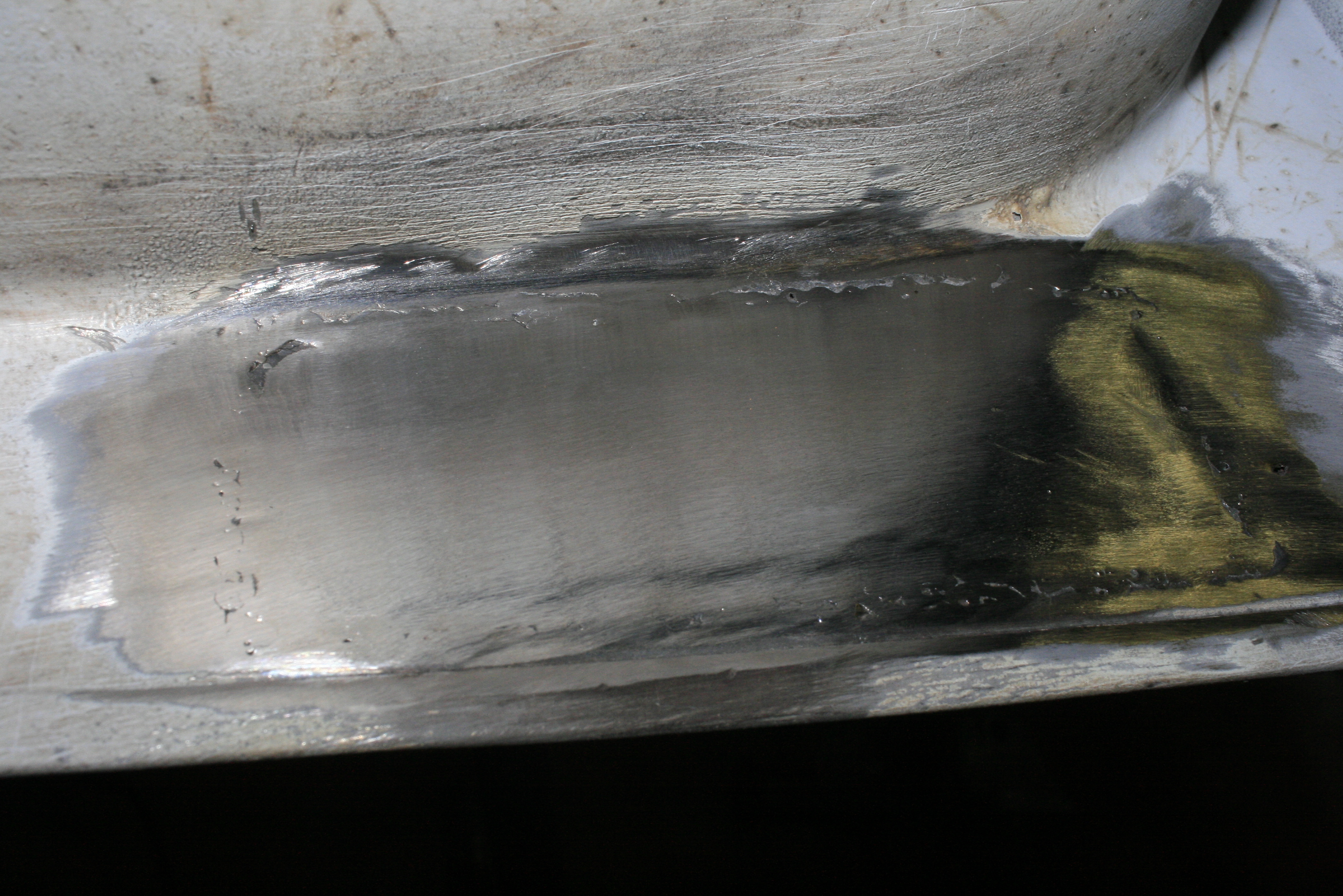

Posts: 368
.......After The Welds Are Sanded Back Is When I Get To Check & See If Its All Fused In Or Not, (?).......

........From The Other Side........

.........Sizing Up The Next Bit.
I forgot To Say That On The Inside I Should Have Stripped The Paint Back Further As It Got Burnt.........
..In-Put--Techniques--Methods..Knowledge.. All Welcome ..

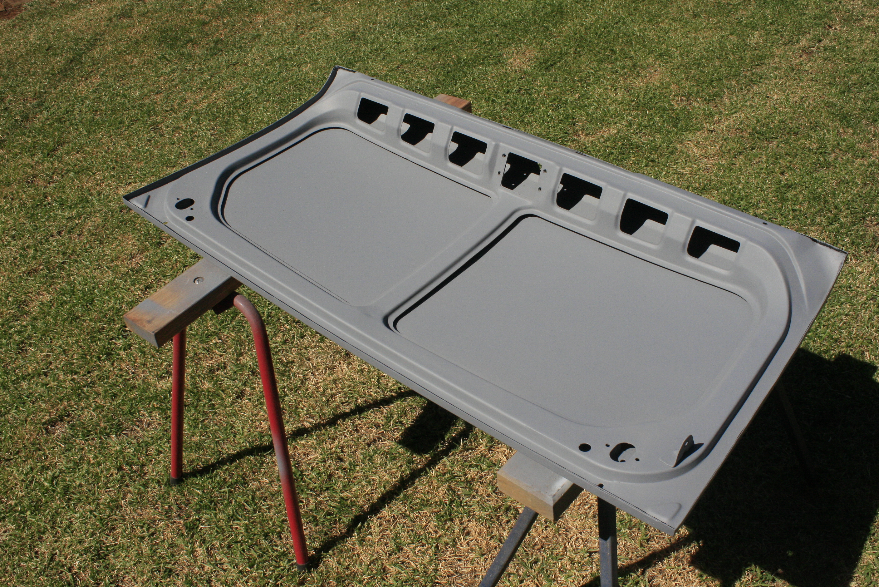

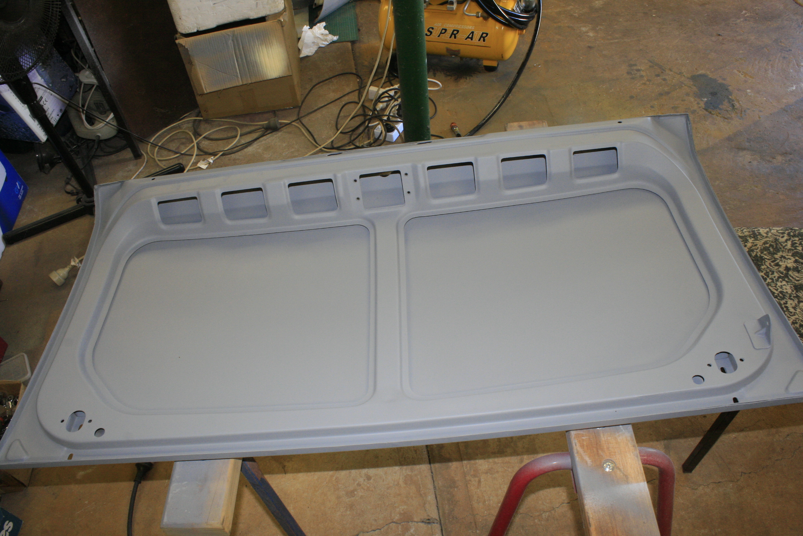

.The Boots Inner After A Coat Of Etch Primer.
