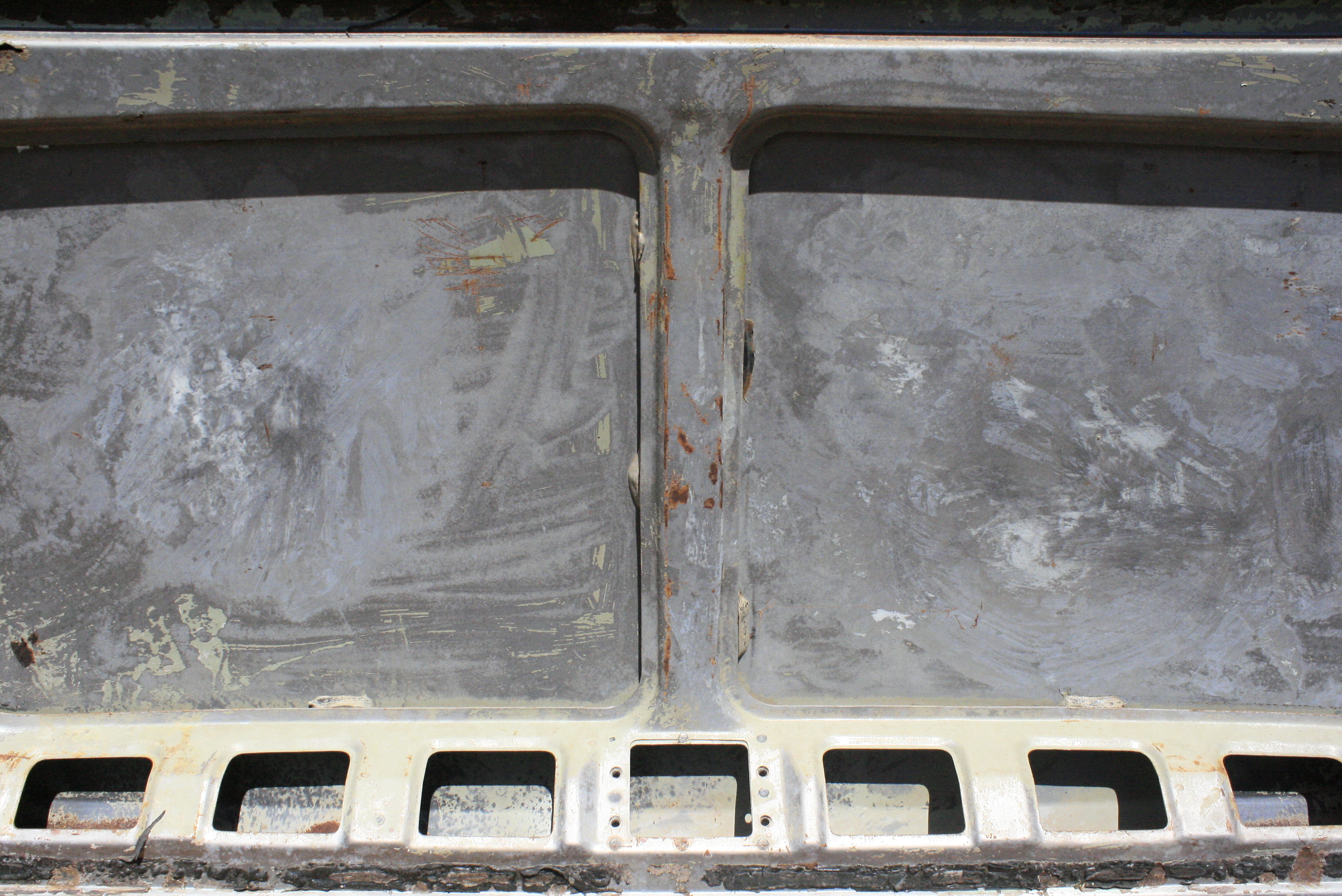

..After One Good Coat Of Stripper..

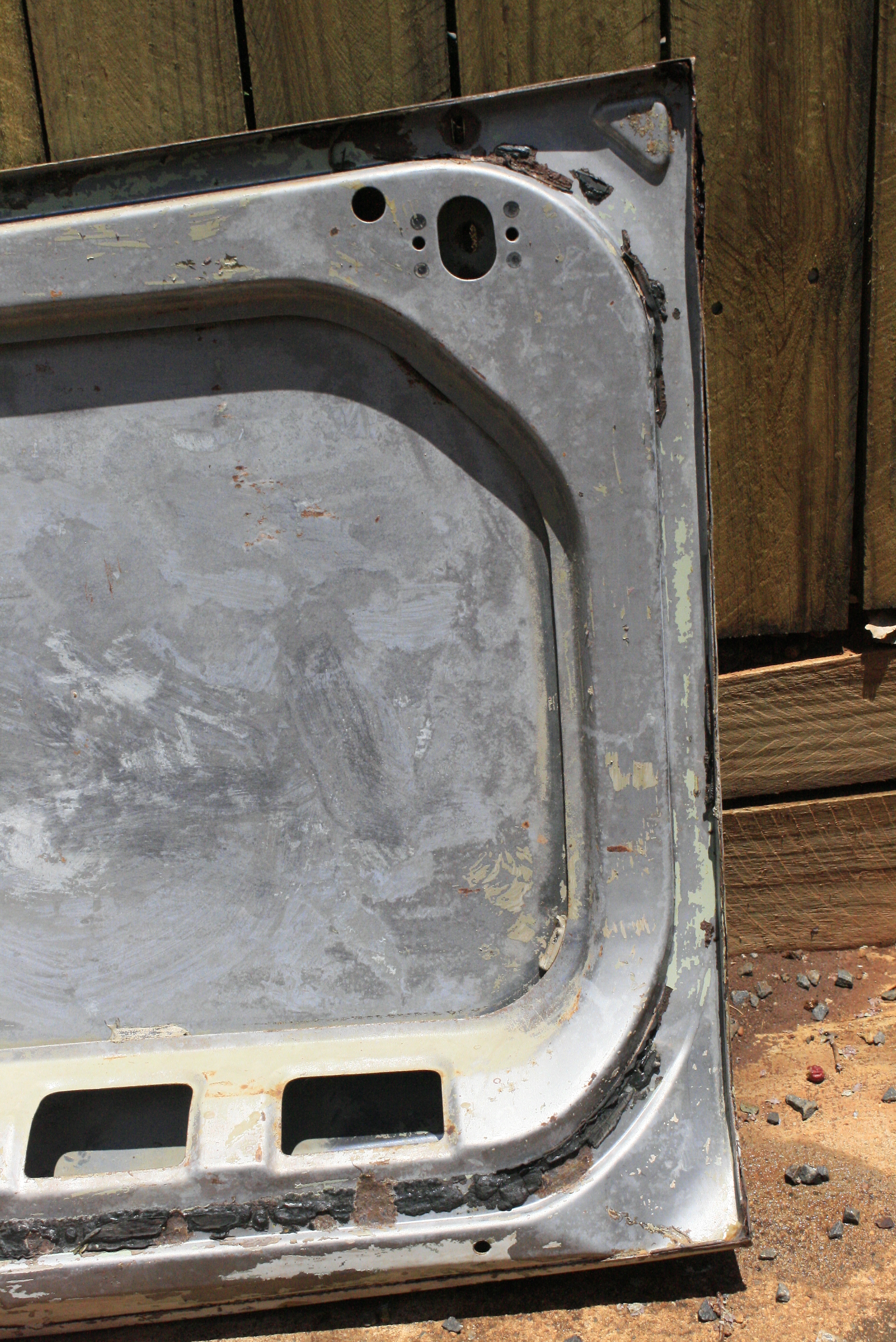

Ted Freeman
Sun Jan 24, 2016 3:51 am

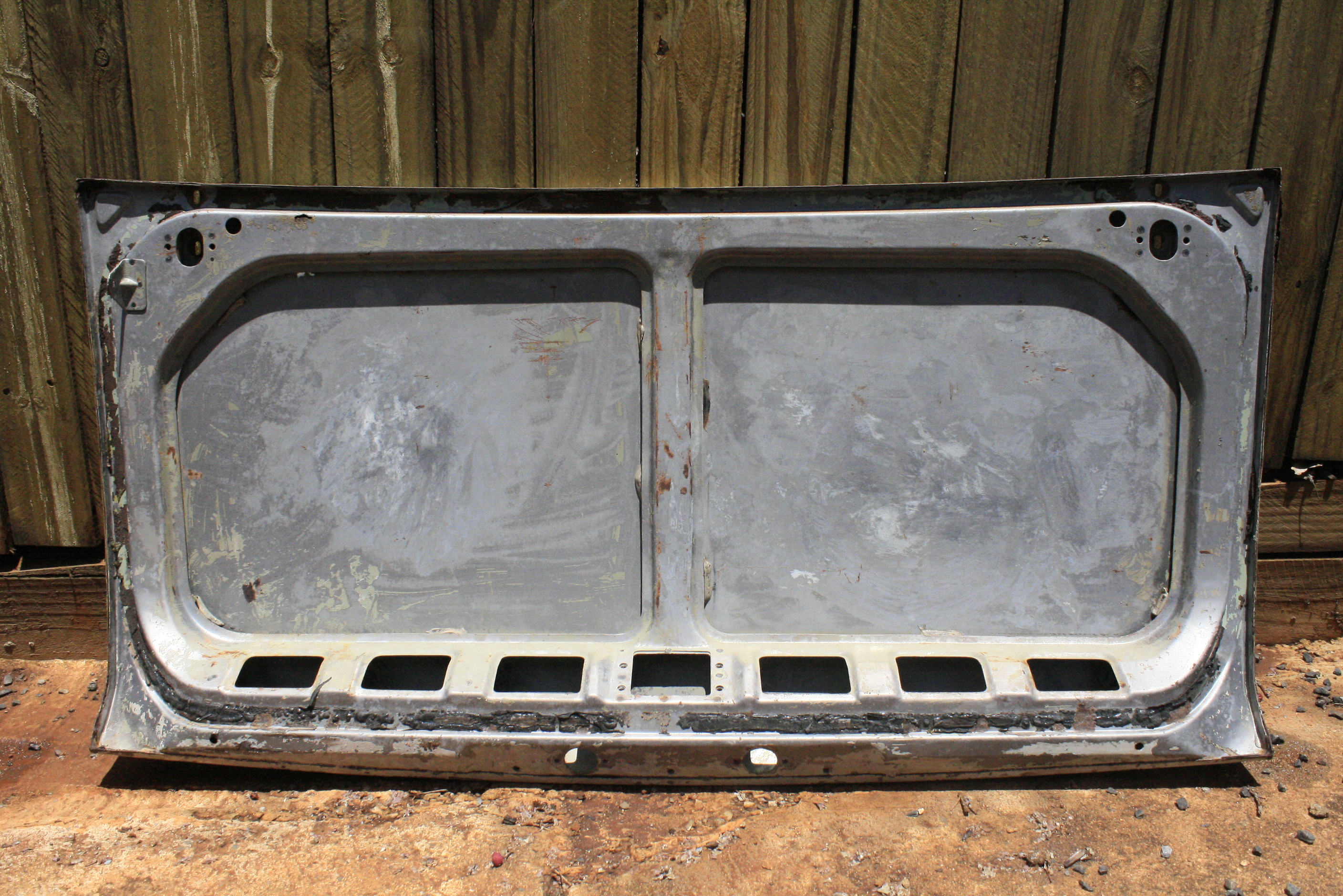

Posts: 368

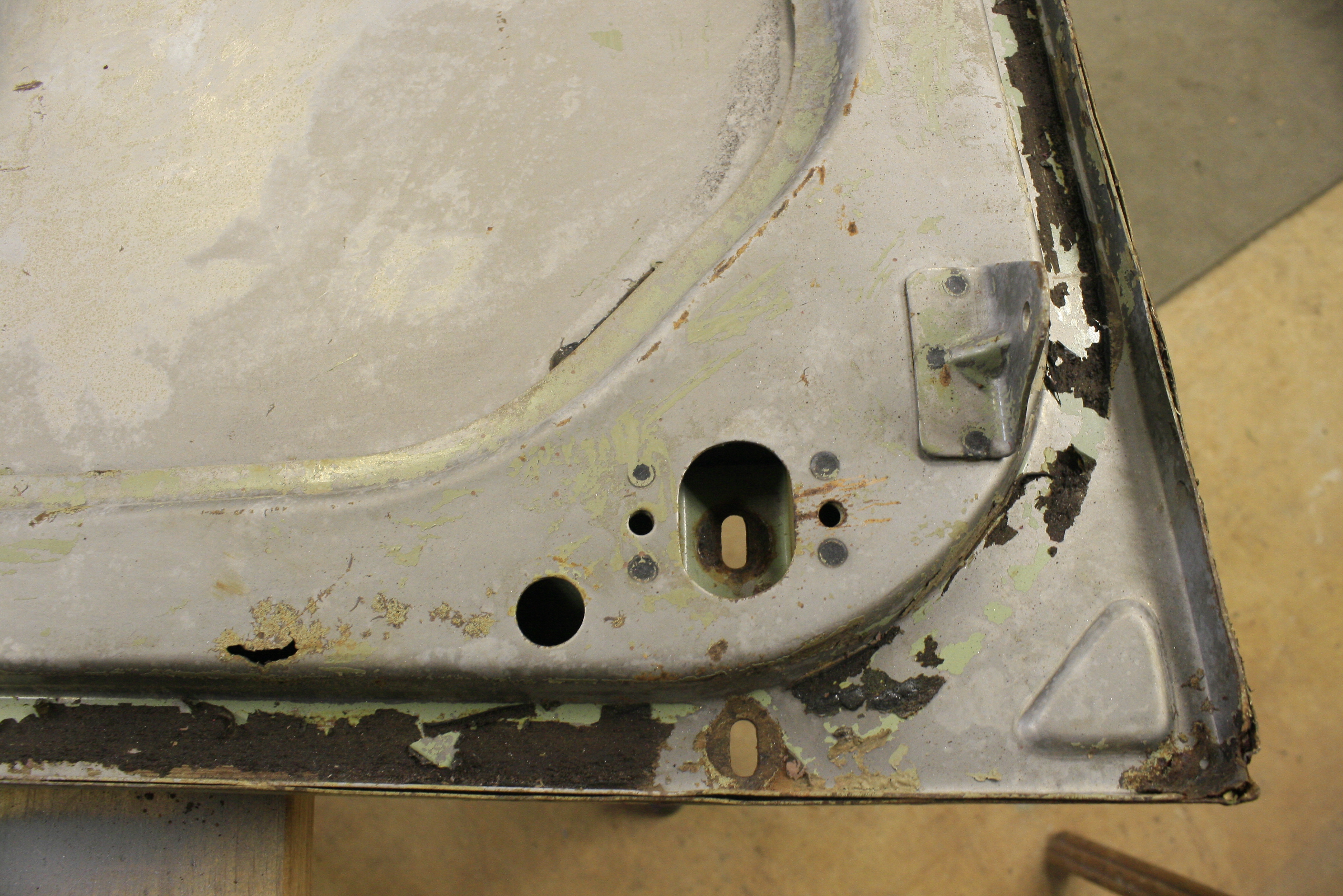

Ted Freeman
Sun Jan 24, 2016 3:53 am

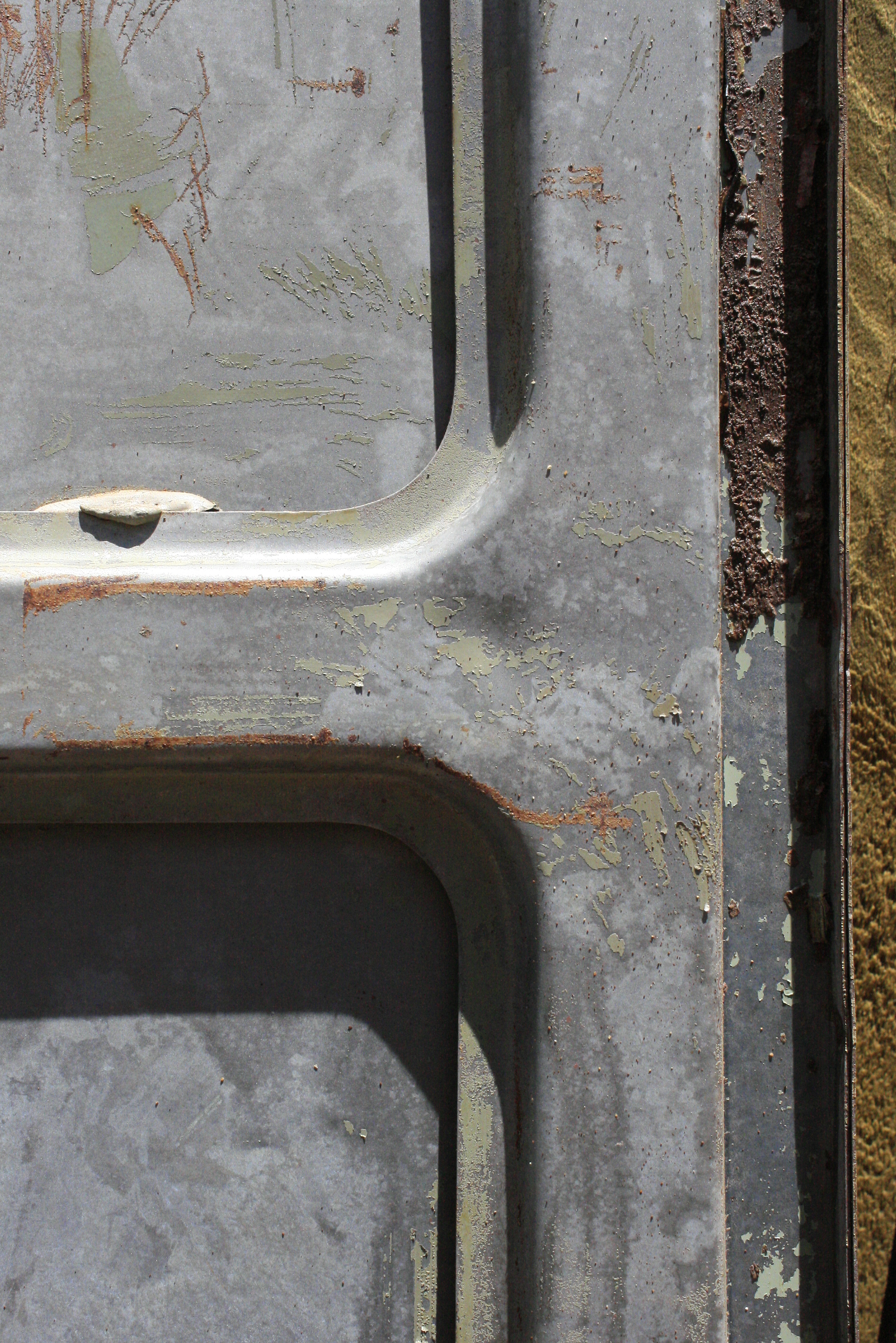

Posts: 368

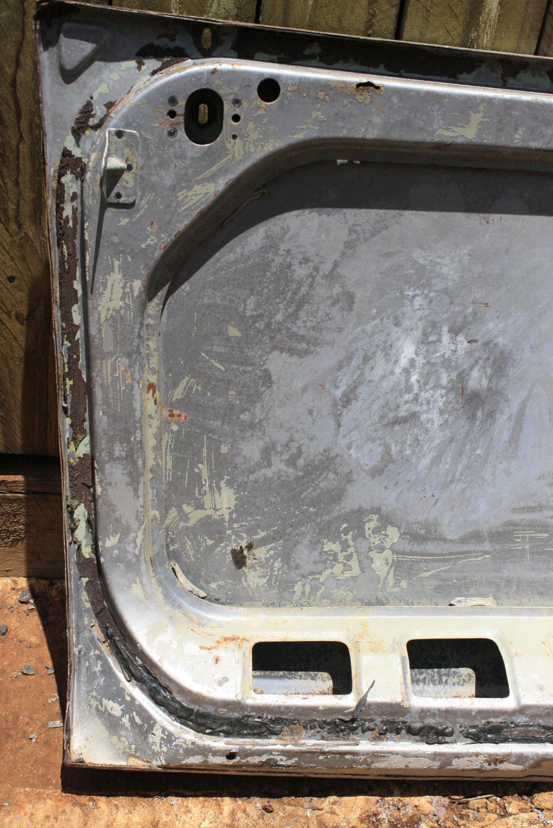

Ted Freeman
Sun Jan 24, 2016 3:55 am

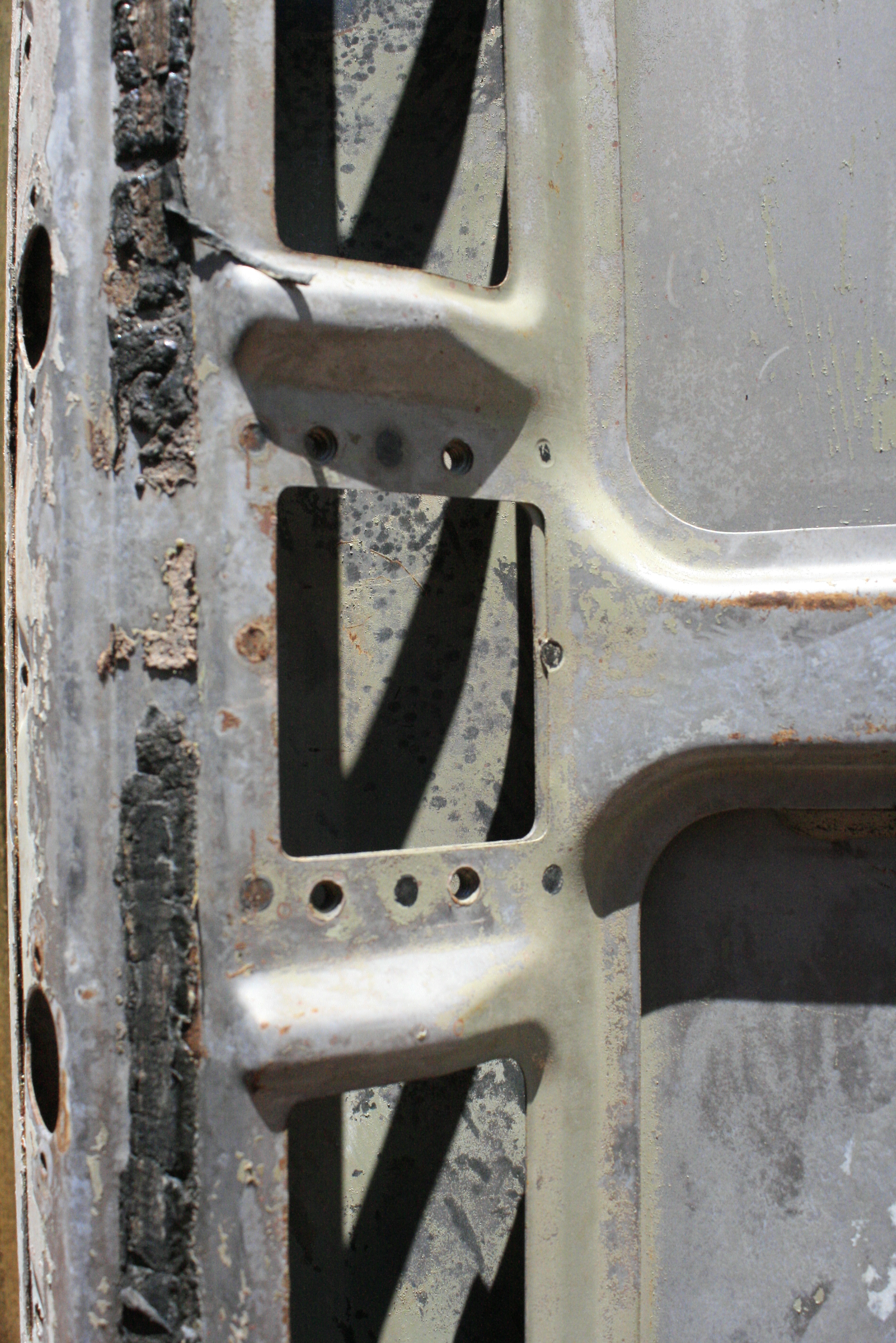

Posts: 368
Ted Freeman
Sun Jan 24, 2016 3:56 am

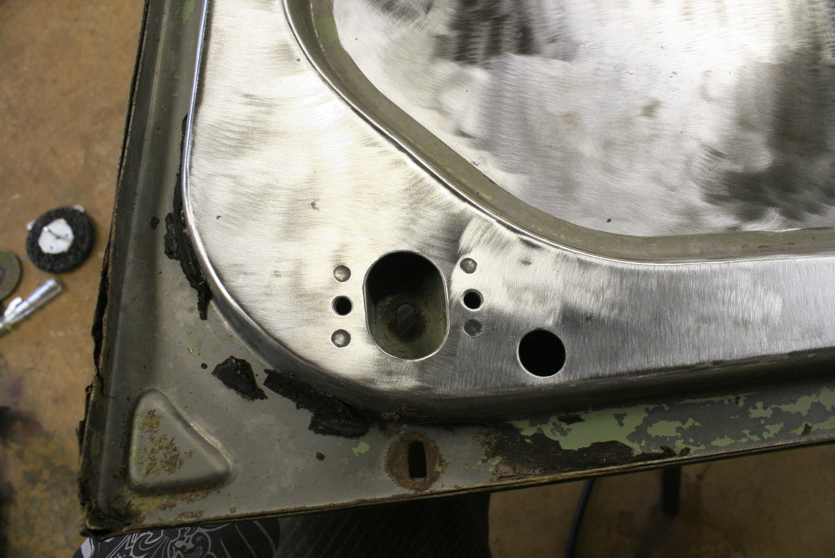

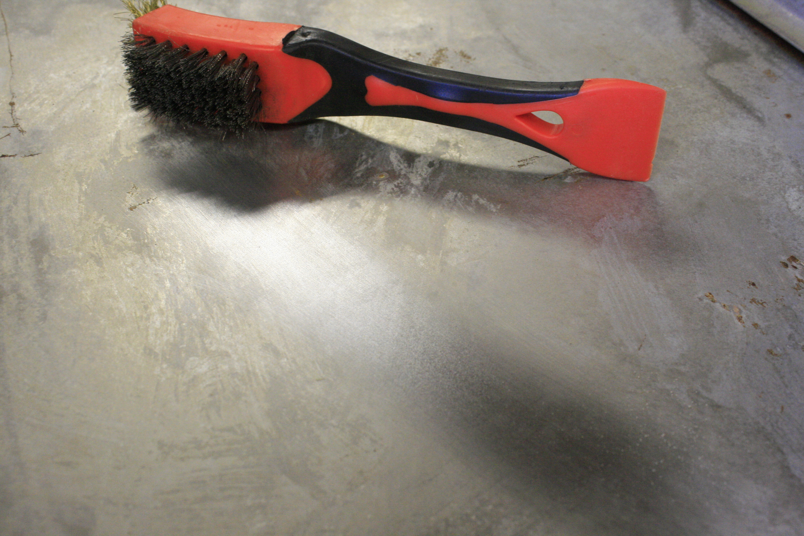

Posts: 368
.........After The Paint Stripping Most Of The Final Bare Metalin' Will Be With The Air Dremmal, I Have A Small Wire Brush Wheel Displayed Here, Others Such As What I Call (Carpet Disc's) Will Give A Far Better Result, Initially I Used The Wire Brush Wheel To Get The Inner Left Door To Bare-Metal Without Using Paint Stripper, So Methods Are Constantly Evolving.........
Ted Freeman
Sun Jan 24, 2016 4:19 am

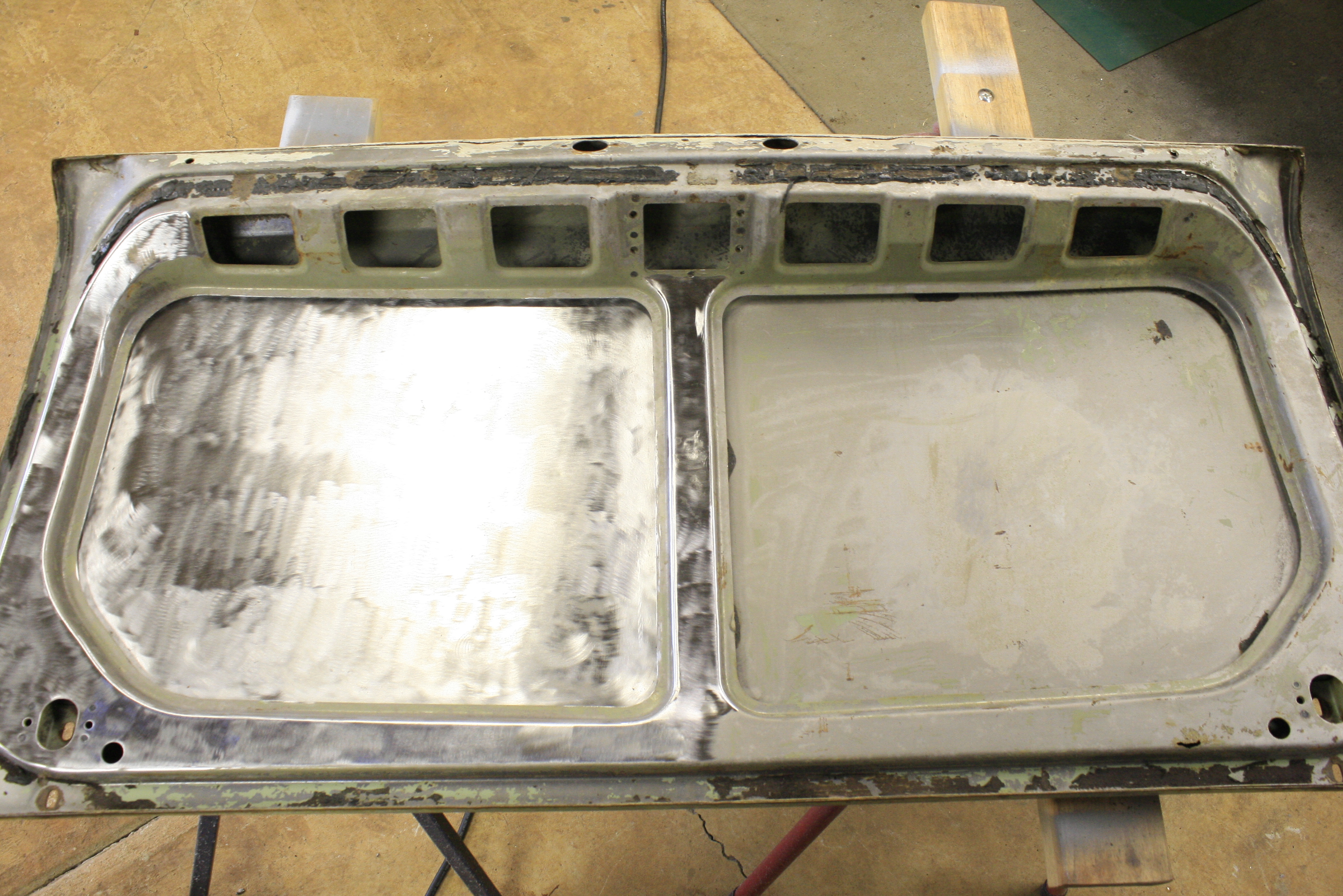

Posts: 368

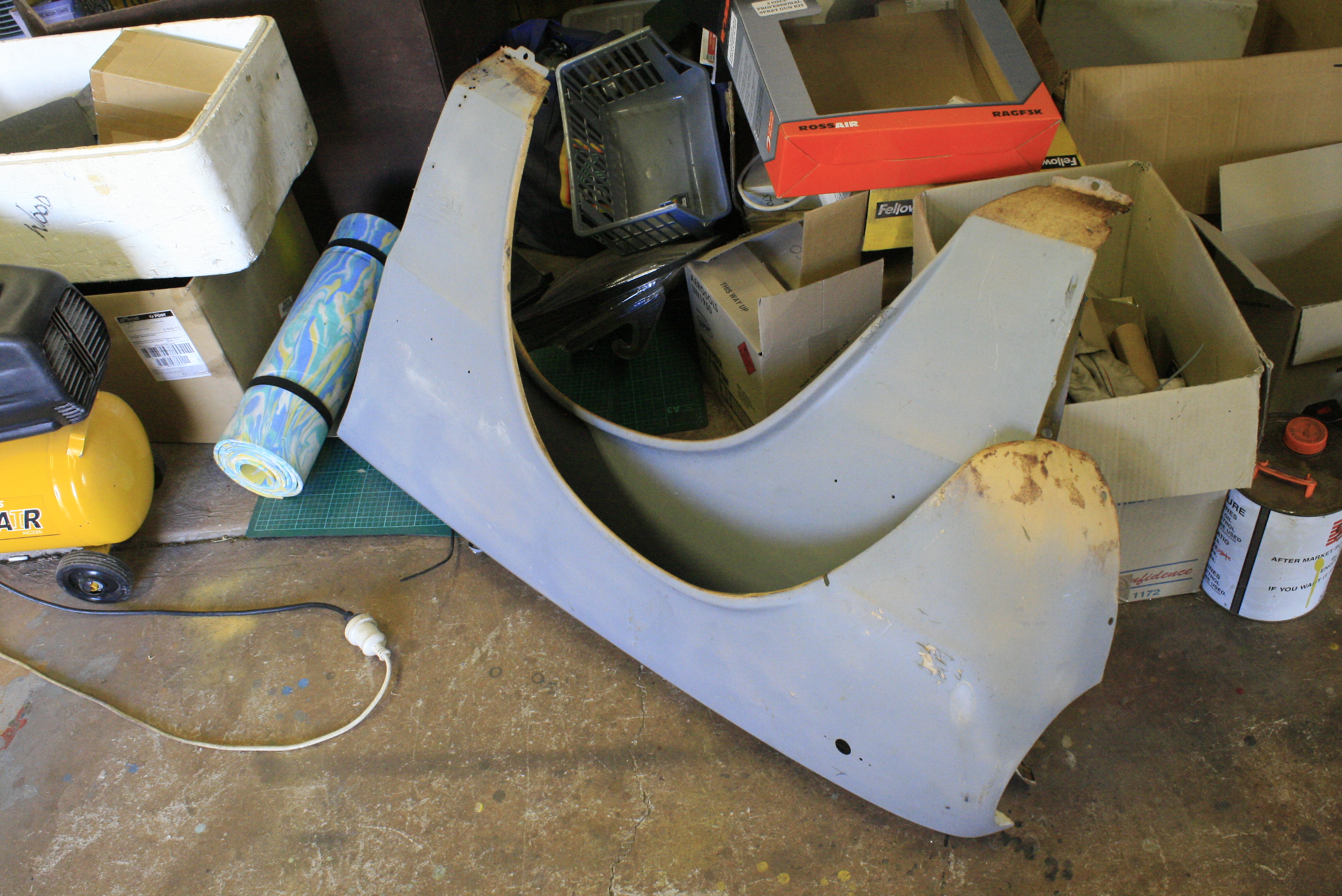

..........The Two Front Guards Needing A Fair Bit Of Work To Get Them Both Up-To Par..........
Ted Freeman
Sun Jan 24, 2016 4:23 am

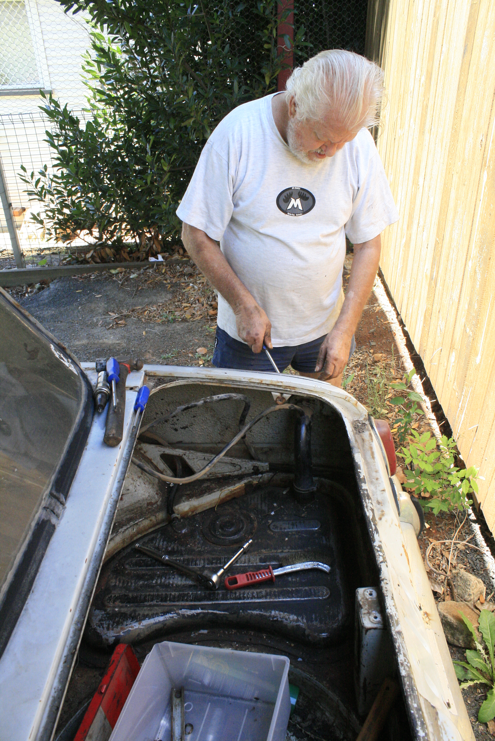

............Dad Is Prepping For Fuel Tank Removal............
Ted Freeman

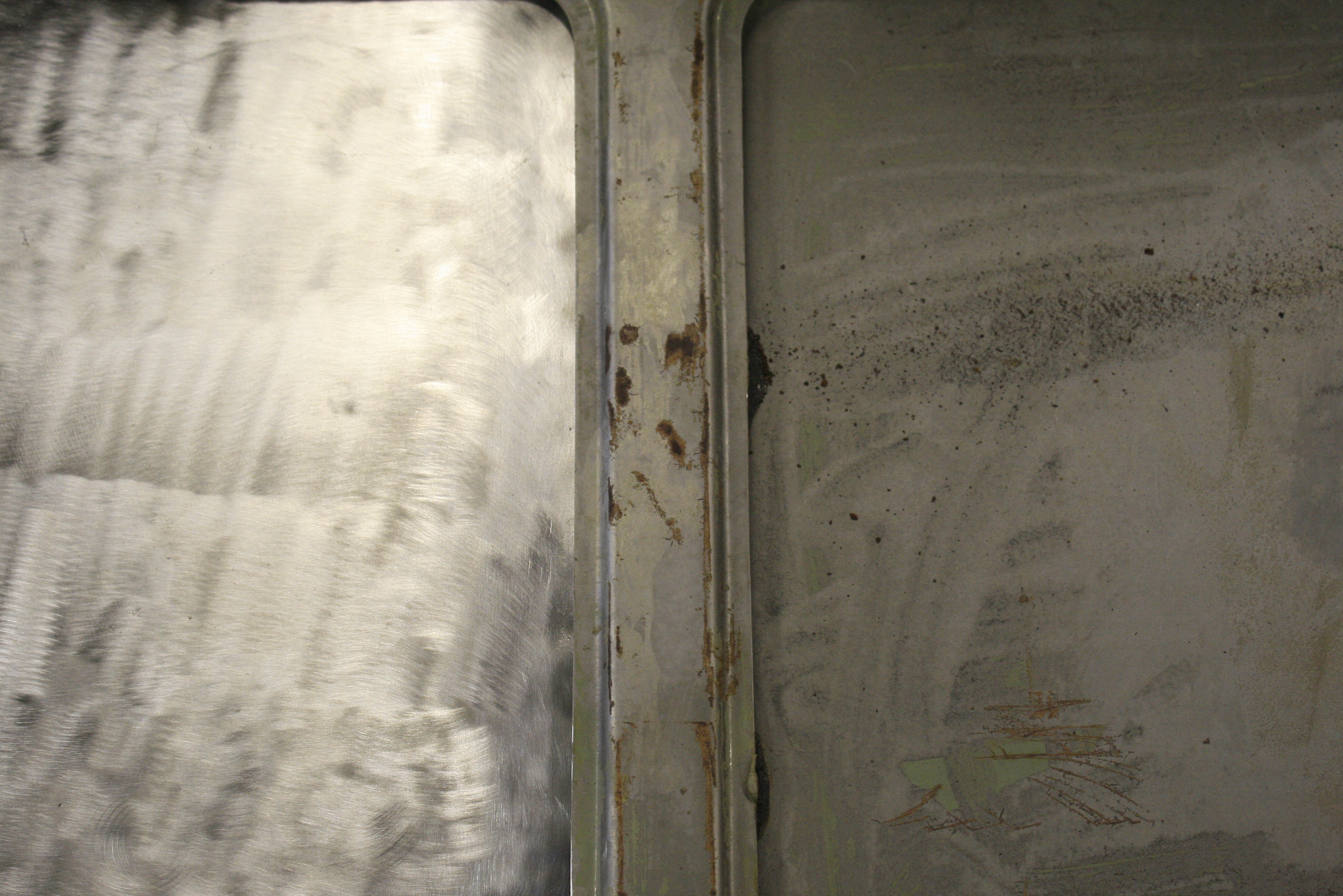

Posts: 368

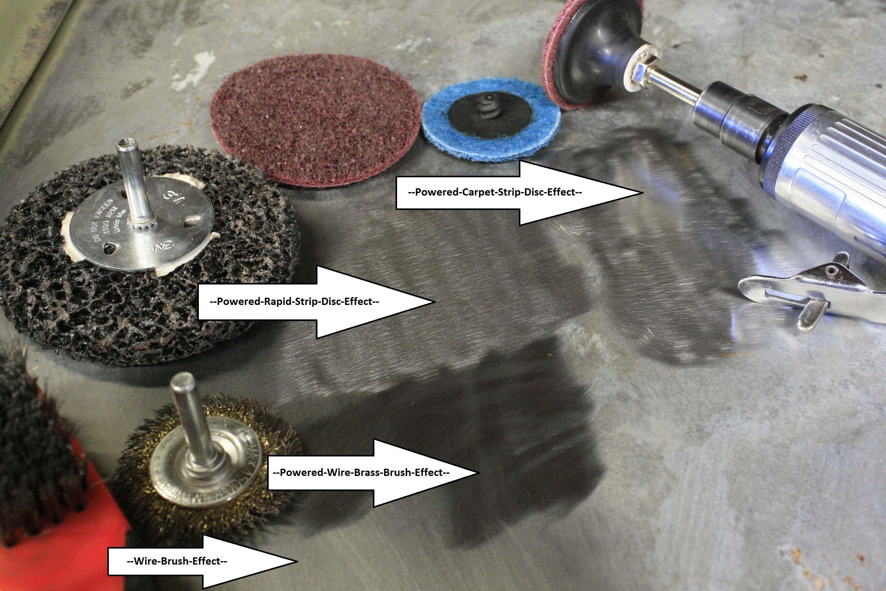

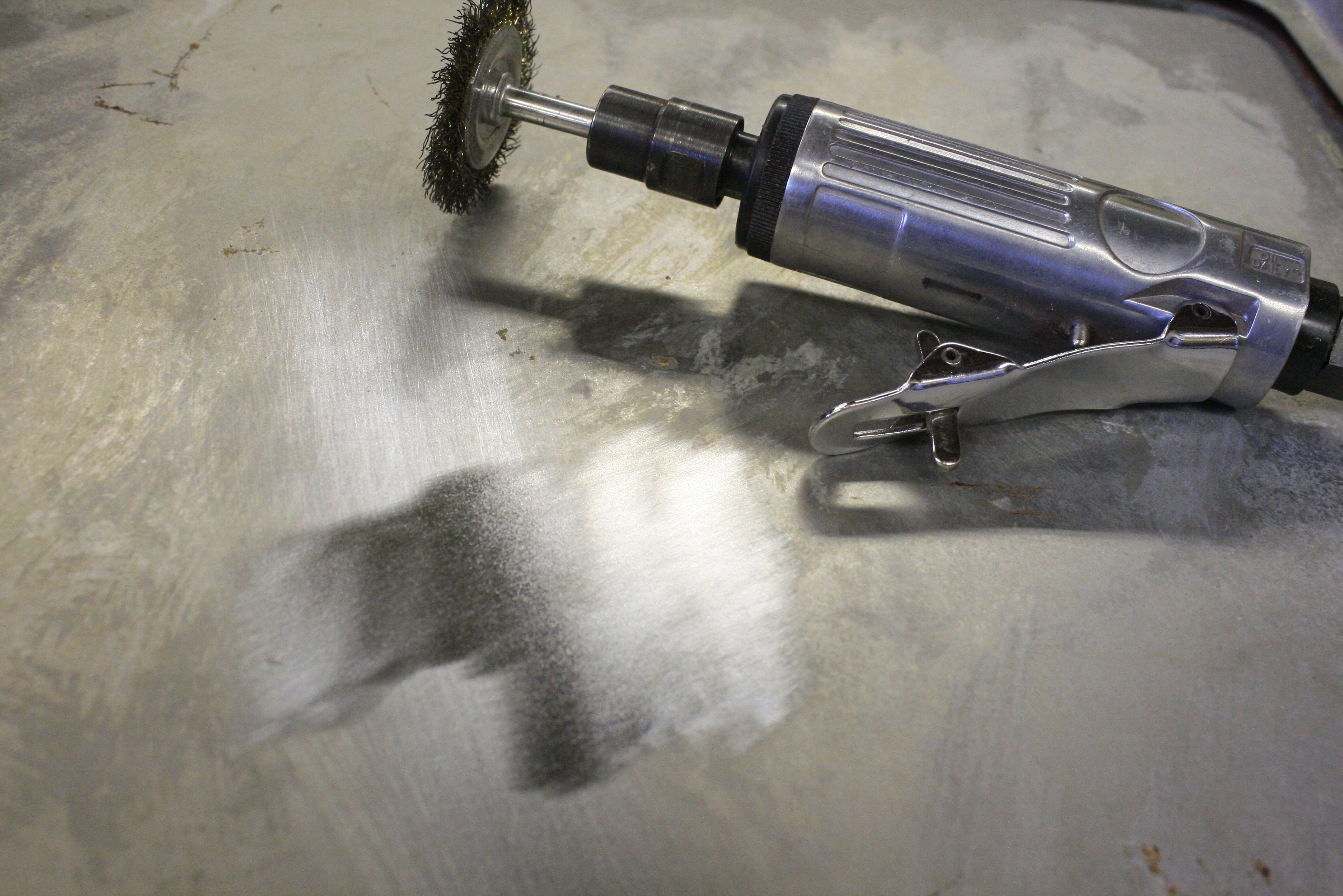

.The Various Ways Of Achieving The Desired Bare-Metal Results, I Now Opt For Paint-Stripper First Then The Rapid Strip Wheel & The Carpet Strip Discs For The Tight Spots, These Three Methods As I Have Found From Personal Experience Will Get The Results Desired & Then Some But Not Saying That This Is The Only Way, But A Way That Works For This Particular Application,
In The Picture Provided One Can See The Different Effects From The Various Products..
Ted Freeman
Mon Jan 25, 2016 12:44 am

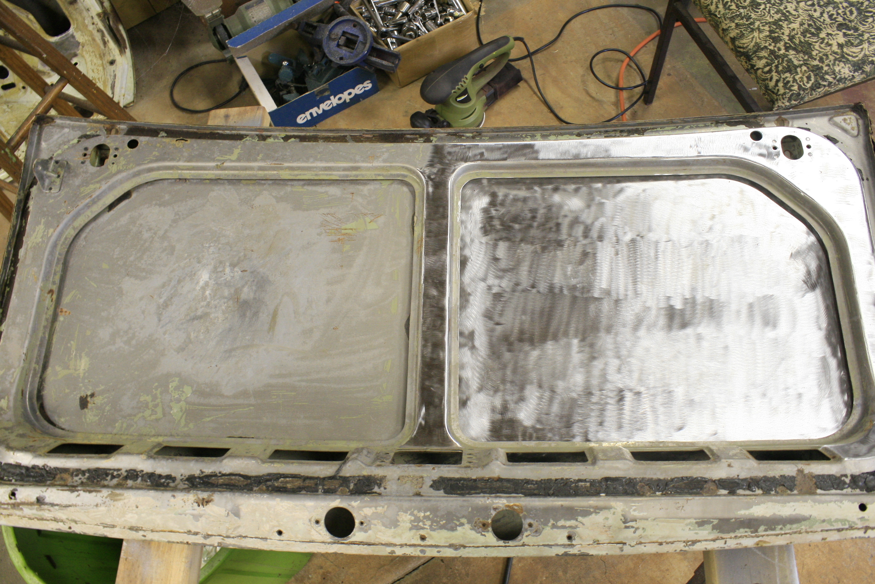

Posts: 368
.Inner Boot Preparation.

Posts: 368
