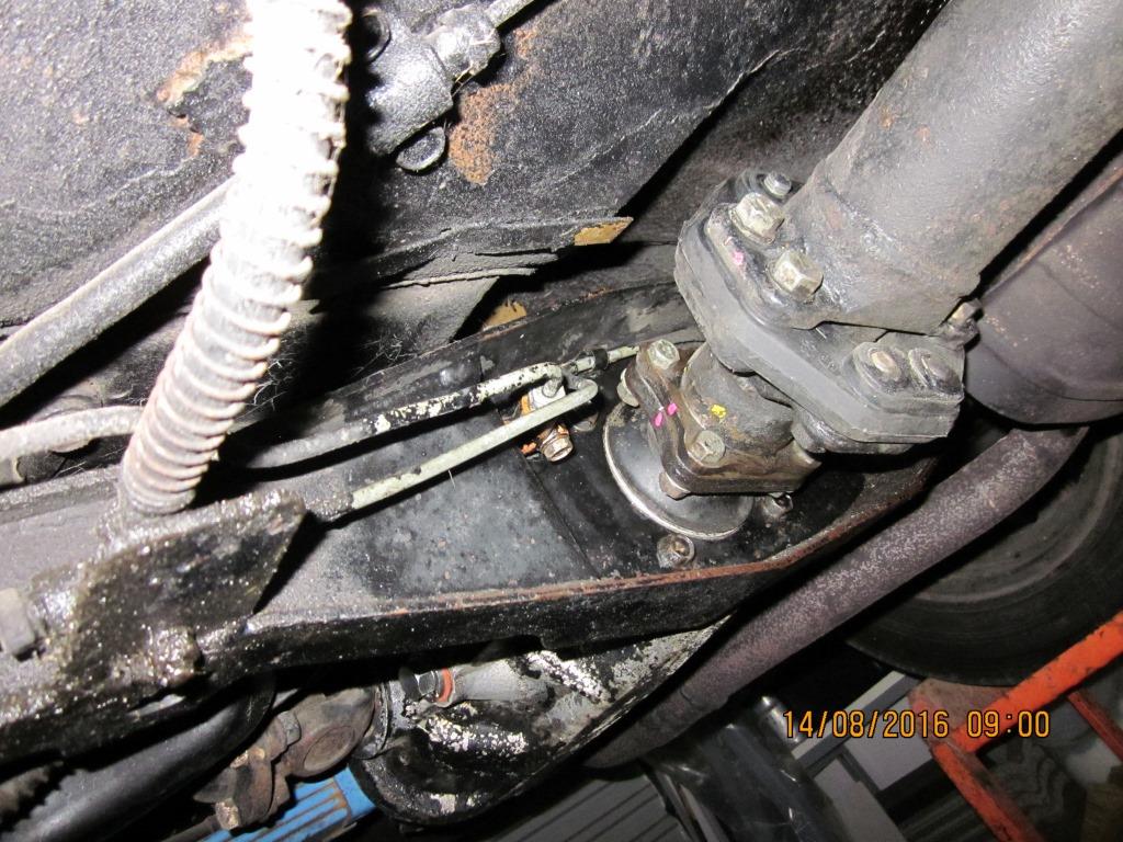

PR91 wrote: The diff in my GT screams its head off. Has ever since I built it..... But seeing as a "special guest" is driving it to the Nats this year, I'll change it. Glenn, I've got a couple of spares at home if u need yo get out of a bind til yours is reco'd that you're welcome to borrow. I really don't like giving them away as good ones are bloody hard to find now, and noisy ones I keep ad spares for the race car. The grease nipples on the wheel bearing blocks are underneath, hidden in near the drum backing plate. The breather is on the top. Also check to see if it has greasable unis on the axles and tailshaft. The diff is an easy swap over. 4 bolts on the tailshaft, 4 on each axle, 2 on the handbrake mech, 2 nuts on the front bracket and 2 bolts on the rear bracket. From memory..... That's it. Brett, been under the car and it appears that i need to leave the diff front cross member in place as there are brake lines going thru it. So, i need to remove 4 bolts in behind the rear uni/rubber and pull the diff and yoke through the big hole in X member? Which means i think there is little room at the back to do it so i have to remove the spring also.? edit, looks like the yoke won't pass through that hole so will have to be removed first....... i think there's a big nut holding it on I jacked up the car on left side and turning the wheel you can hear lots of terrible noises like a gear with a tooth missing, feel to it
| Sat Aug 13, 2016 10:59 pm |
PR91
Joined: Tue Sep 16, 2008 11:54 am Posts: 2544
Well that's a totally different set up to normal as u don't need to a touch the brake lines in earlier cars.... I would strongly suggest against removing the yoke on the pinion shaft. It needs to be done up to some crazy amount of tension, but is also critical its done right for the pinion bearing and meshing on the crown wheel. I'd be just undoing the brake pipes and rebleed them afterwards so u can remove it all as an assembly without stuffing something up.... And remember that if u removed all of the front of the diff, it then has to be reassembled in the car itself later.
| Sun Aug 14, 2016 6:58 am |
PR91
BTW the actual yoke on the front of the diff itself is the same as a normal one. Its just the tailshaft that is different.
