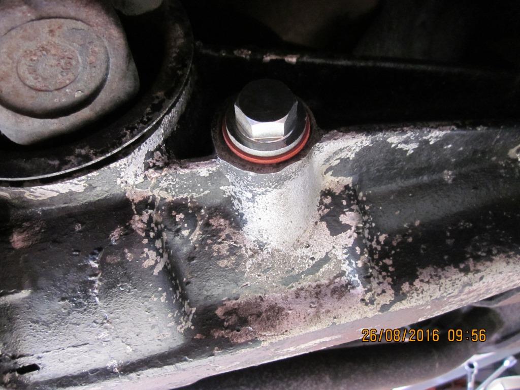

Numbers are stamped into the vertical rib under the fill plug.
Thu Aug 25, 2016 10:40 am
We have also got a couple of auto wrecks so will have a look Brett (after Nats Prob)
Thu Aug 25, 2016 11:28 pm
no rib or numbers here Brett.

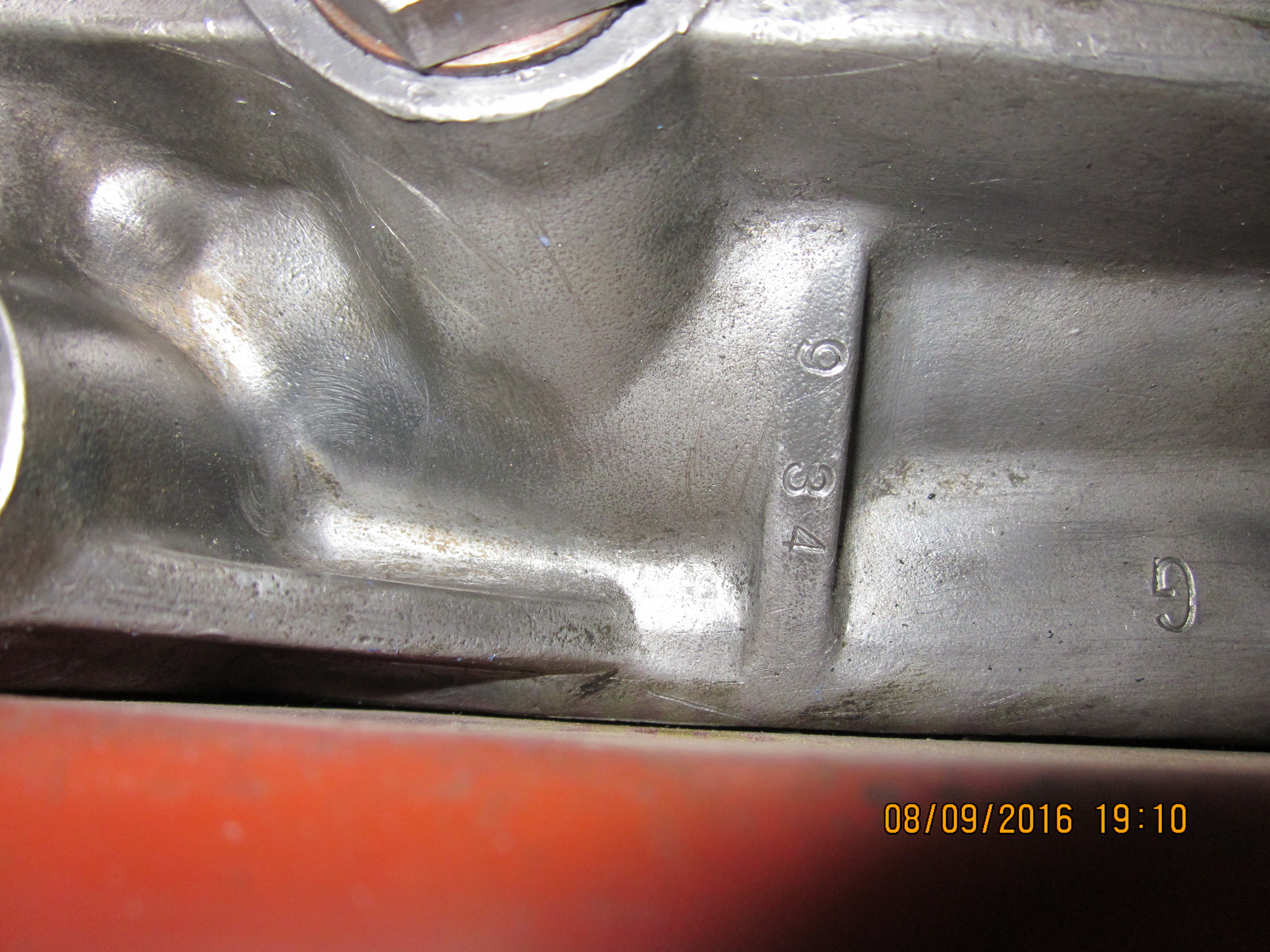

I got my reco'd diff back today. (Thanks Dean) It has the numbers on the casting as you suggested Brett. Slightly different sequence. You can see that the late model diff is totally different in the casting. The reco guy said he in his Bellett search, there are four different ratios listed. Obviously not in Oz though.
For the info of others, he got maybe the last of the carrier bearings available. The bearing is wider than any other that might fit. That would required spacers to be made etc. Driveshaft seals are not available.
Its weird, the differences. Change for change sake or are they improvements? The late diff has the drain on the rear. Obscured by the leaf spring so thats a backward step!
