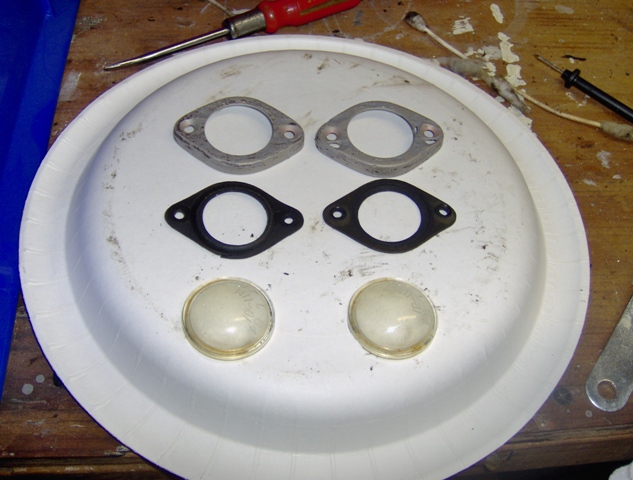

Do your GT'S look like these from a sedan?
Mark

im pretty sure thats what they are!
Fri Mar 16, 2012 10:28 pm
yep, one in the same.
Fri Mar 16, 2012 10:29 pm
Thats them and they look as good a sample as you will find.

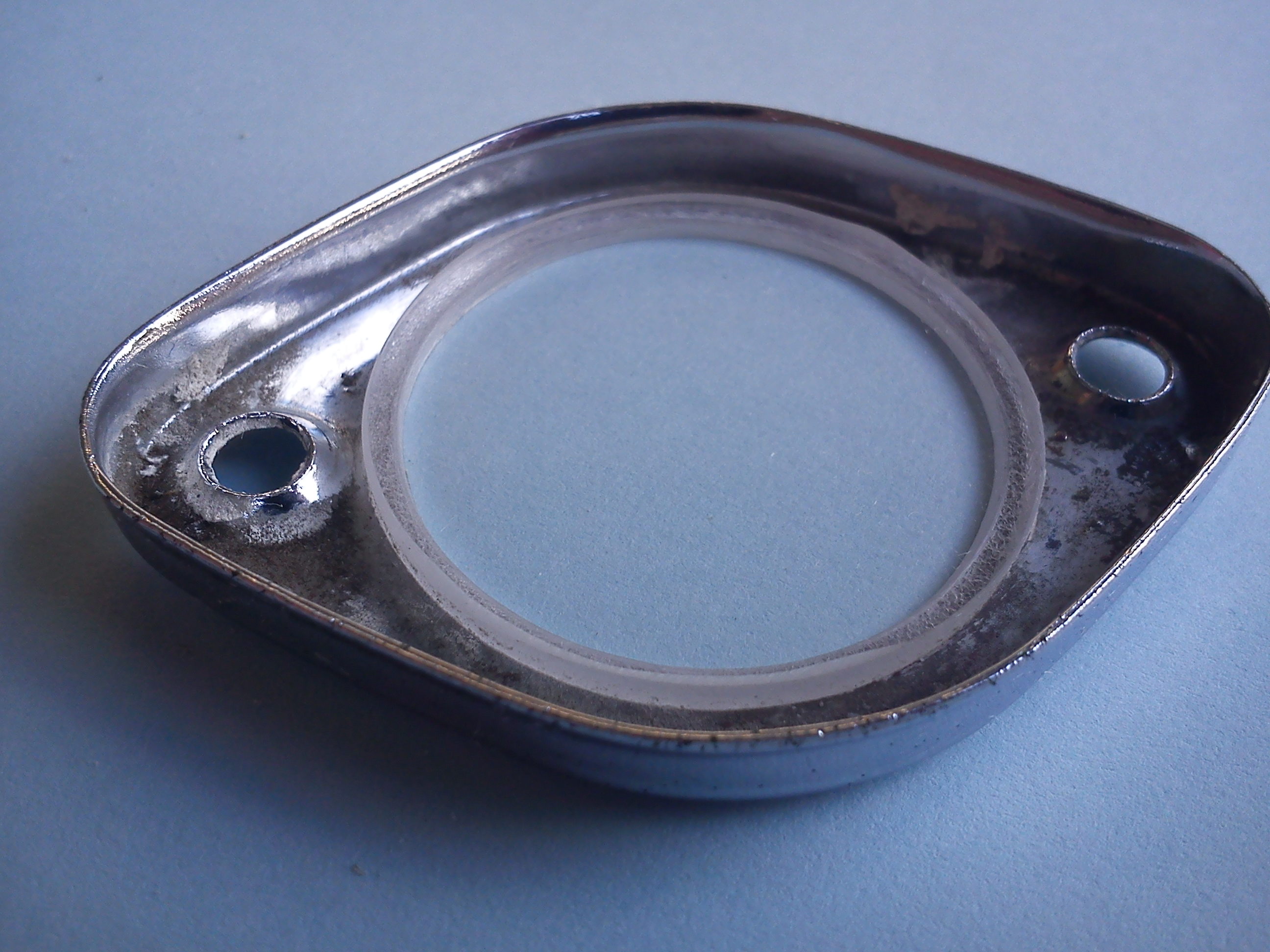

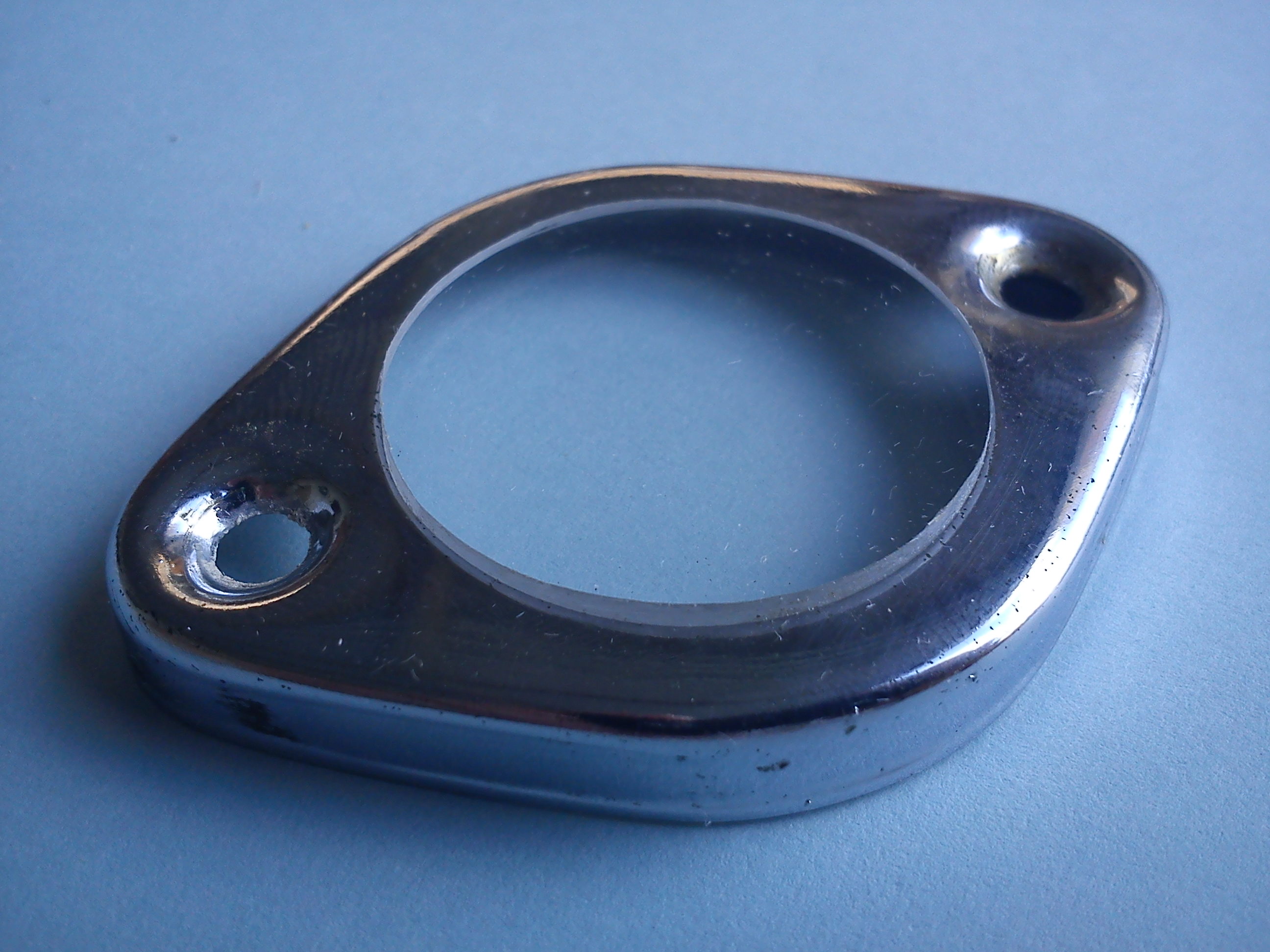

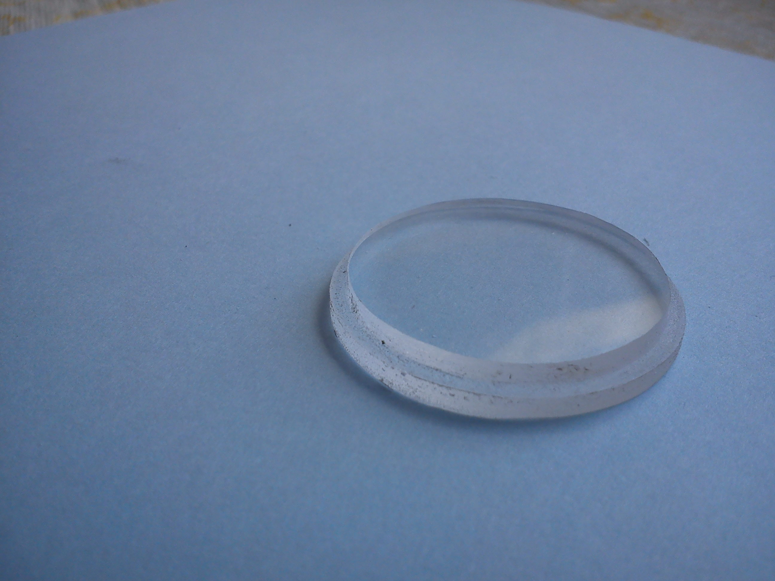

The holesaw method works pretty well.
I just made one from 4.5mm polycarbonate sheet as it does not dis-colour like perspex. (and i had some)
Took the centre drill out of the hole saw, then used the smaller one to make initial cut about half depth. Then next size up, cut the disk out. The 1st hole saw is not exact size so had to run a file round the edge to make it fit through the metal cover.
Used a drill press. You must clamp the material down of course. There is no dome to the made up part though. Since i don't have the rest of the lamp fitting, not sure if there is an issue with the bulb being too close or touching the 'new' lense.

I don't have anything but the cover plate pictured here, so can't look at that side of things. Mind you, no Bellett either !
I have another idea in mind also, to put a chamfer around the outside edge to make them look a little better.
