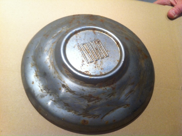

Not sure ,but I think they are standard hubcaps ? I have shown the worst one.
I also have a '67 Bellett ,and the hubcaps are the same ,but some of those have a slightly sharper outside edge on them,so looks like there may be 2 types .

Hubbies are often dented or rusty now, but can be re-chromed.

If only they designed the gutters of today 30 to 40 years ago. No square face to grind off the tops of your hubcaps. Most of caps around these days dented or scratched. Have a look on Ebay for some sets of Gemini full covers. They're 13 inch, same as Bellett and they're ISUZU. That's if want to have some originallity about your car. Holden Torana Sunbird are also 13 inch and are also ISUZU. I' ve got them on my car. Looks good and sets it off.

they are standard Bellett hubcaps. the deluxe ones are a full cover car and much fancier.

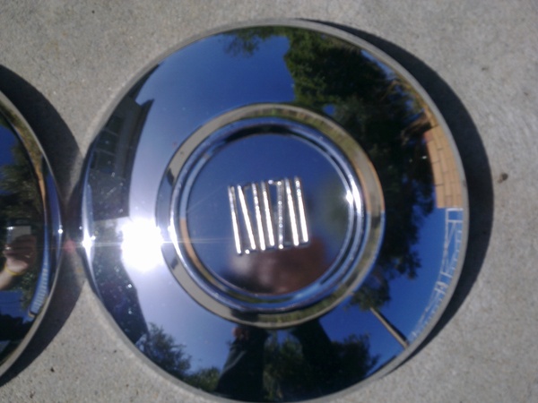

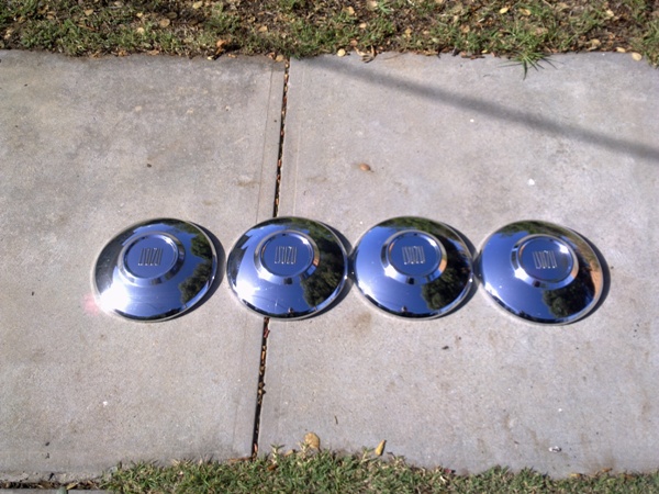

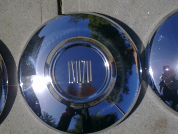

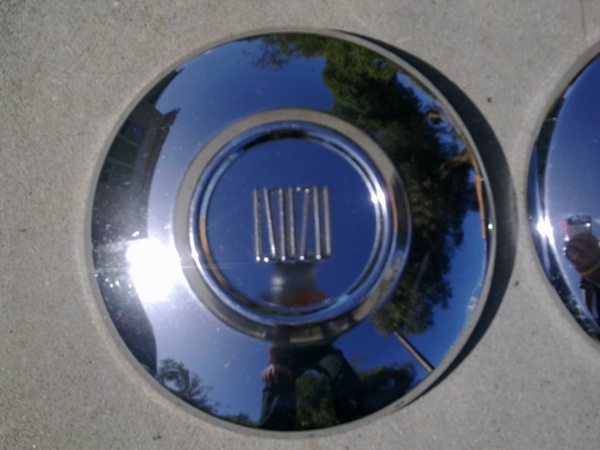

I have 4 of these -- been stored in the shed since 1979 when I replaced with mags
Not in bad nick
PM me if interested
File comment: slight sctratch

File comment: pitting plus dent

File comment: all

File comment: best 4 almost the same

nice one .....just what the man needs .... lets get all these little cars up and about my caps would be a waste of a photo after looking at these cheers davo
