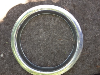

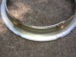

Looking for one chrome wheel rim (see pic) for 67 Bellett as one came off and gone :cry:
Maybe after market or extra fitting available at purchase. Anyone know :?:
I need the chrome rim as well as the 6 holding clips (see pic). Note it also has special cut for tyre valve.

gday Marvo, and welcome.
they are definitly aftermarket.
Bellett's never had chrome dress rings from the factory.
"standard" sedans like yours had just the chrome hub caps you already have.
"deluxe" sedans had a full cover cap. rare these days.
and GT's had a different full cover cap. VERY rare now!
get into autobarn, super cheap, one of those places for a some new ones. $20 should get u a set of 4 newies.
cheers.

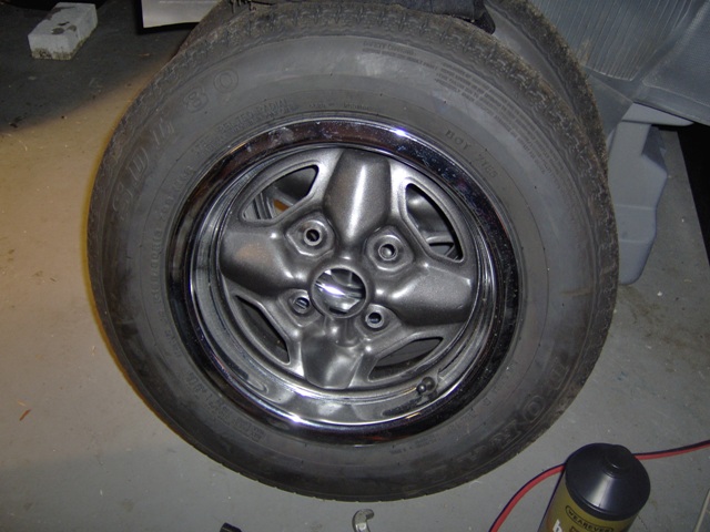

For what it's worth, this is the set of mag style wheels that came on my car, and interesting enough they are from a 67-69ish Toyota Corolla, and I got the chrome trim rings on ebay.
Regards
Mark

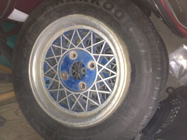

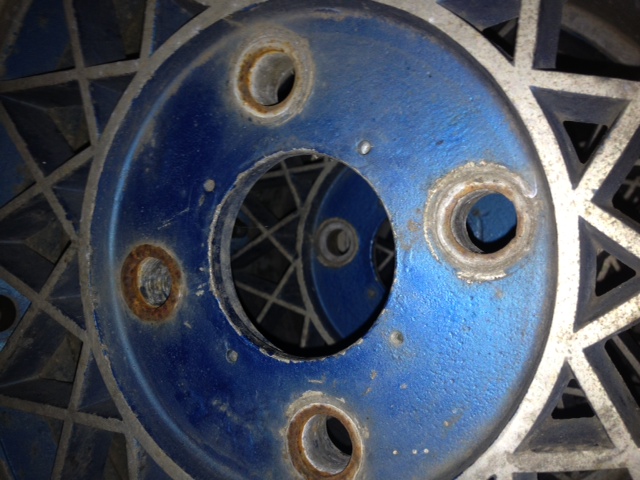

Thanks for all the advice found 4 mags 13" x 7 paid $100 for with tyres full tread but yet to see if they fit. Looks to me they are too wide for the 4 studs unless I can get longer studs to replace the originals. The depth of the wheels at the hub is around 28mm where bolt comes through.
Seem to be 114.3 offset. Tyres 185/65R13 84H
Any ideas? 8-)

Hi Marvo
They look like Magnum Hotwires very similar to what I had on my GT
The Mag nuts for these rims are a long collar type and meet the studs -- no need for longer ones
have a look on the inside of the rims it should have the offset stamped on it somewhere between 19 - 24?

Sorry but the back of each Mag is pretty dirty so where would I find the offset stamp hopefully somewhere between 19-24? If that is all good where do I get the Mag nuts for these rims with a long collar type to meet the studs? I can see that the holes are larger than normal so they would need a long collar type to work.

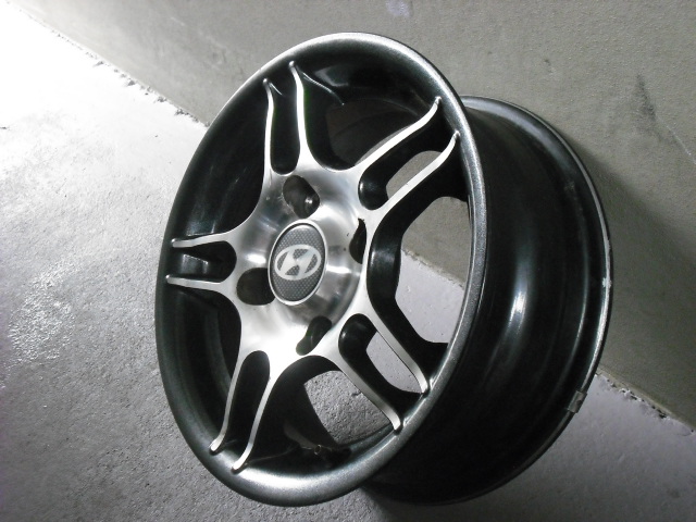

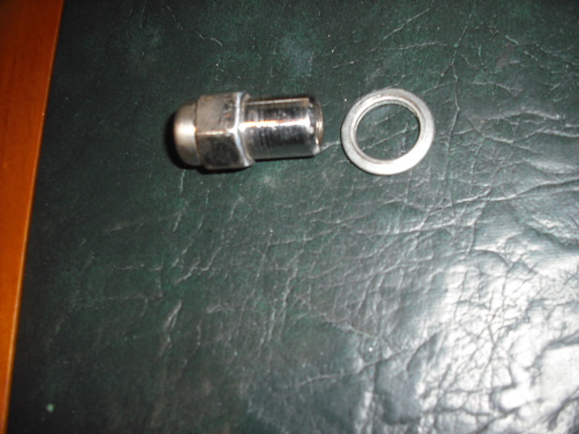

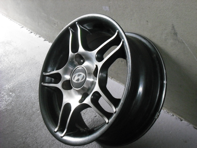

hry greg were they like these these are pretty mint asking $150 SET too much but they may barter these are from a place on the coast that wrecks cars they have various sets come and go ...also marvo a shot of the tapered nuts needed for those mags of yours or most in the design cheers davo ...anyone want the mags ??email me

Those wheel nuts are available from Super Cheap, $15 pack of four 12x1.25 thread, will have to make sure that washers have a taper to match wheel.
Have you had those hy and dry wheels on your car Davo? May need spacers.

Davo. Geoff could be right in the pitch of the thread that he has had , but all the studs that I have got are 1.5 thread pitch.
Hyundai and Toyota are same. Nissan and some Fords run 1.25. Supercheap up here only keep at the moment 1.25. Have been trying to get some for the set of mags that you gave me and I'm willing to wait.
Mark. There are different depths for the wheel nuts. Make sure that they are not too short as they may "bottom out" and don't actually lock the wheel securely. And. Must use washers on that type of mag.

You are right, they are 12 x 1.5, I should check my facts, Had to replace one on the caravan while away, at Christmas, and it was 1.25, and I think it has Falcon Mags on it.

I reckon those Hyundai rims would look brilliant on a Bellett!! 8-)
Mon Mar 04, 2013 5:33 am
mate they would look fantastic ,they have another set alloy instead of the gunmetal black ....not as mint ...ah well they go back tomorrow cheers davo
