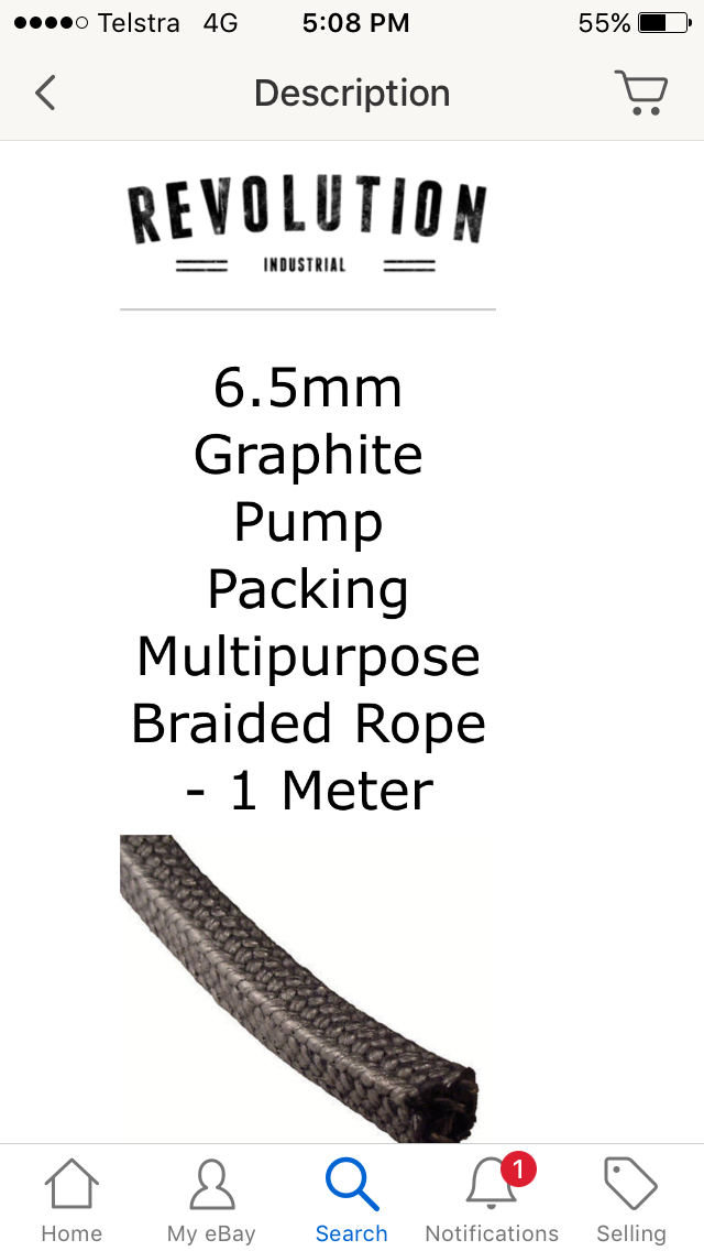

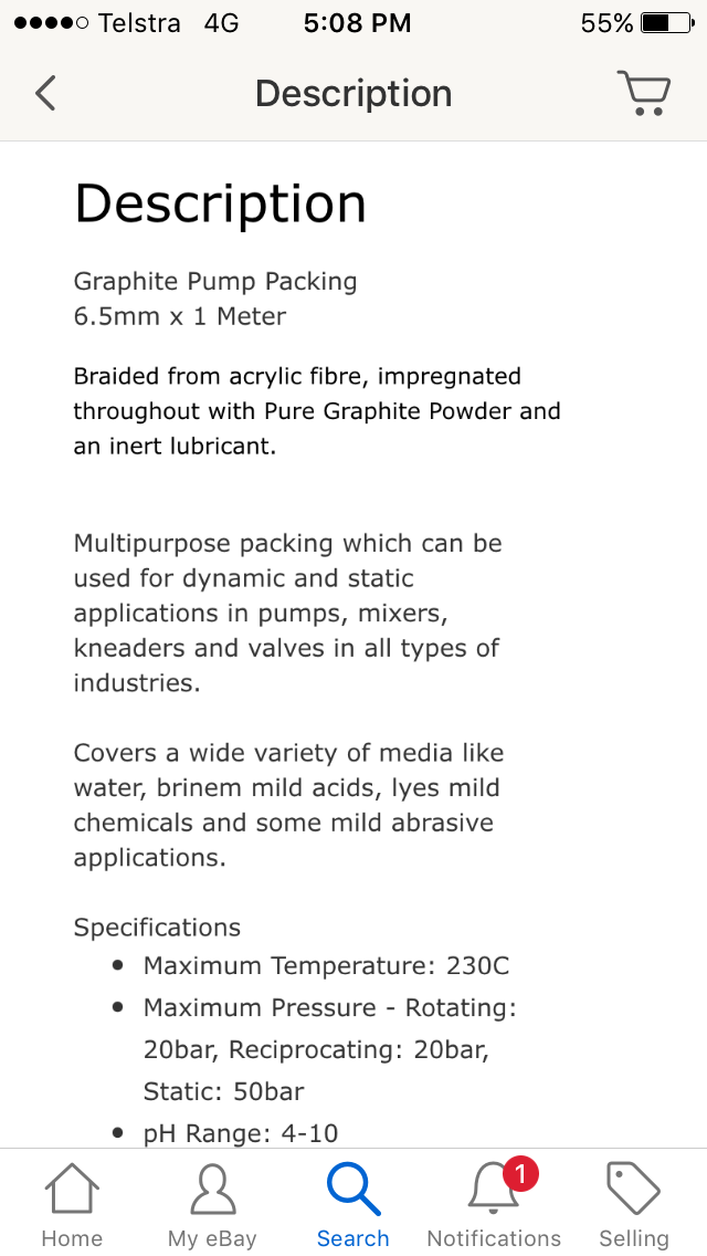

Hi All
For those looking for mains rope seals this may be of interest

Yep, bought both
- graphite $28
- tractor $6
Haven't installed but both look good
I used. Graphite one when I rebuilt my most recent G161......
