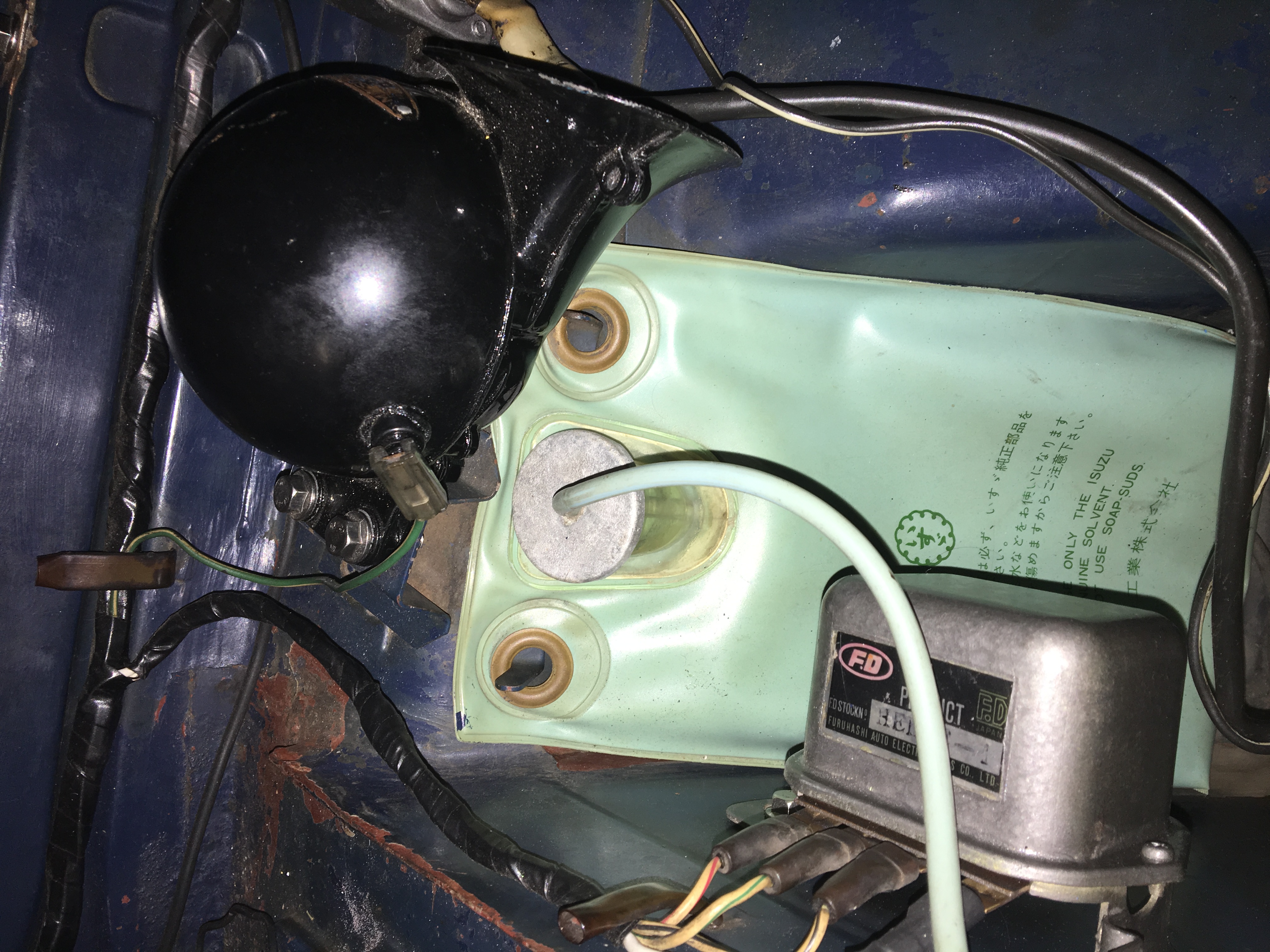

Author:  BULLITT [ Mon Oct 16, 2017 11:25 pm ]
Post subject:  Re: 1966 Bellet Sedan Rear lights Wanted
The plastic bag sits on the right side hooks into 2 angle hooks on the body. Maybe yours is on the left under the horn
