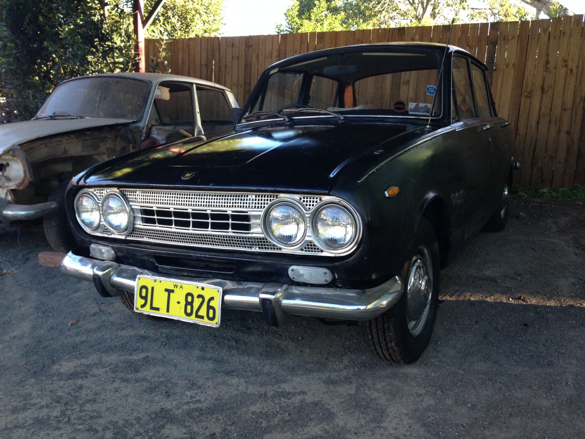

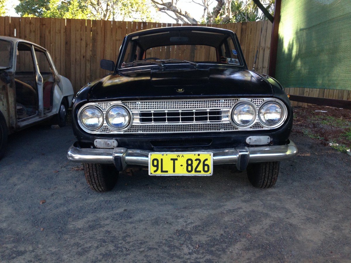

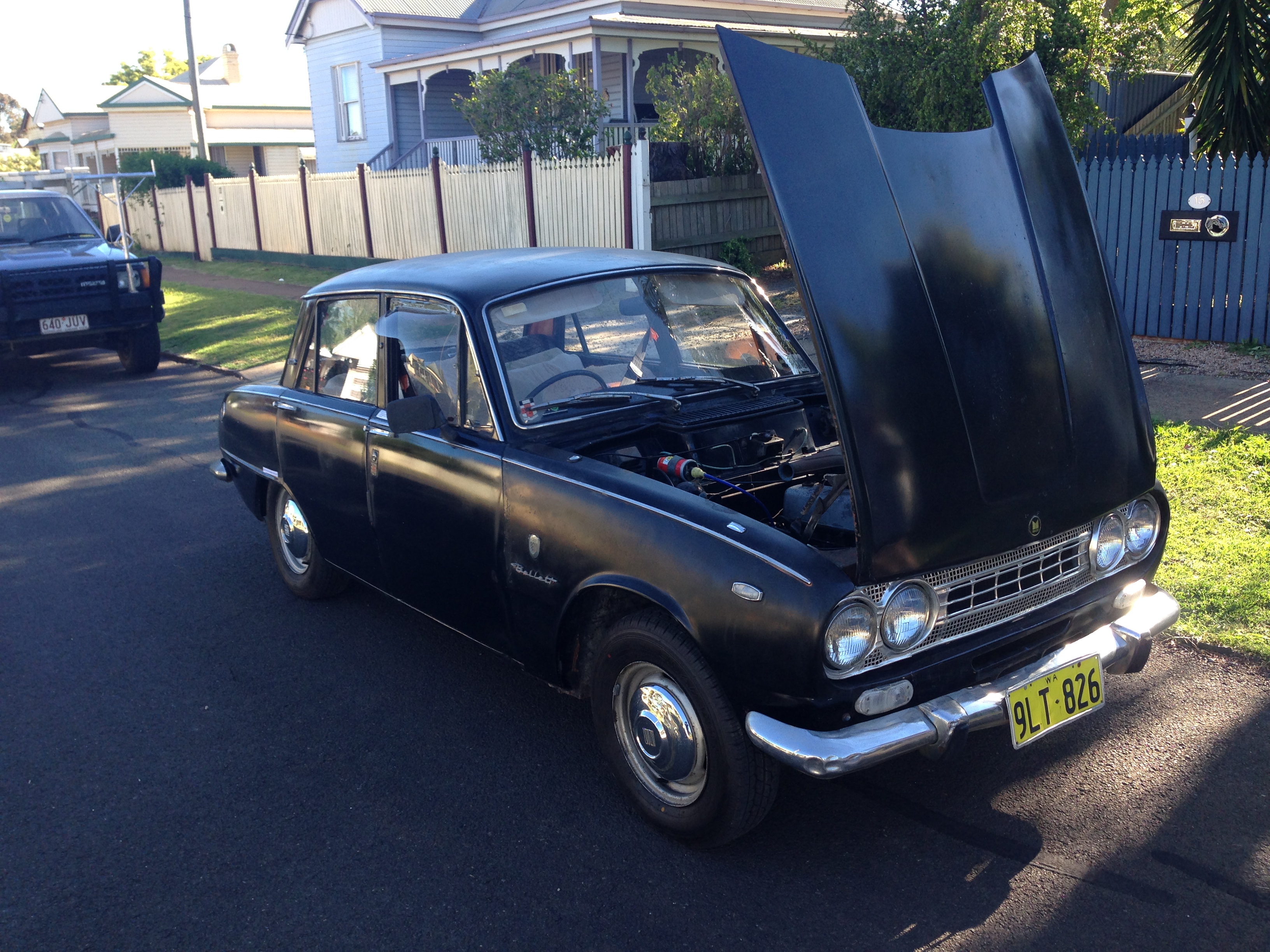

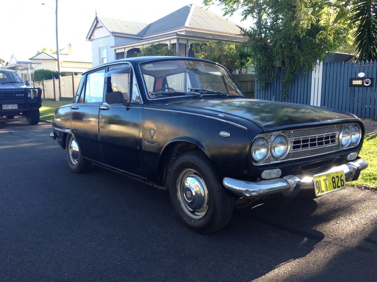

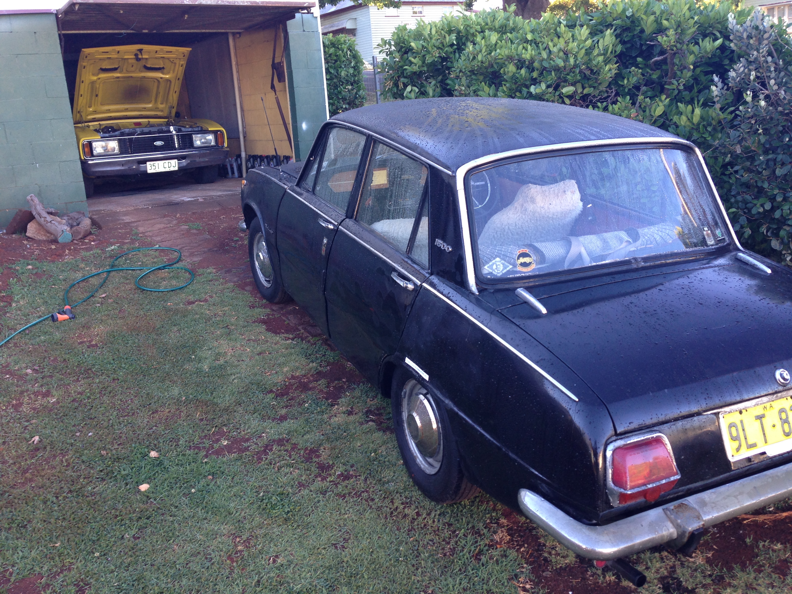

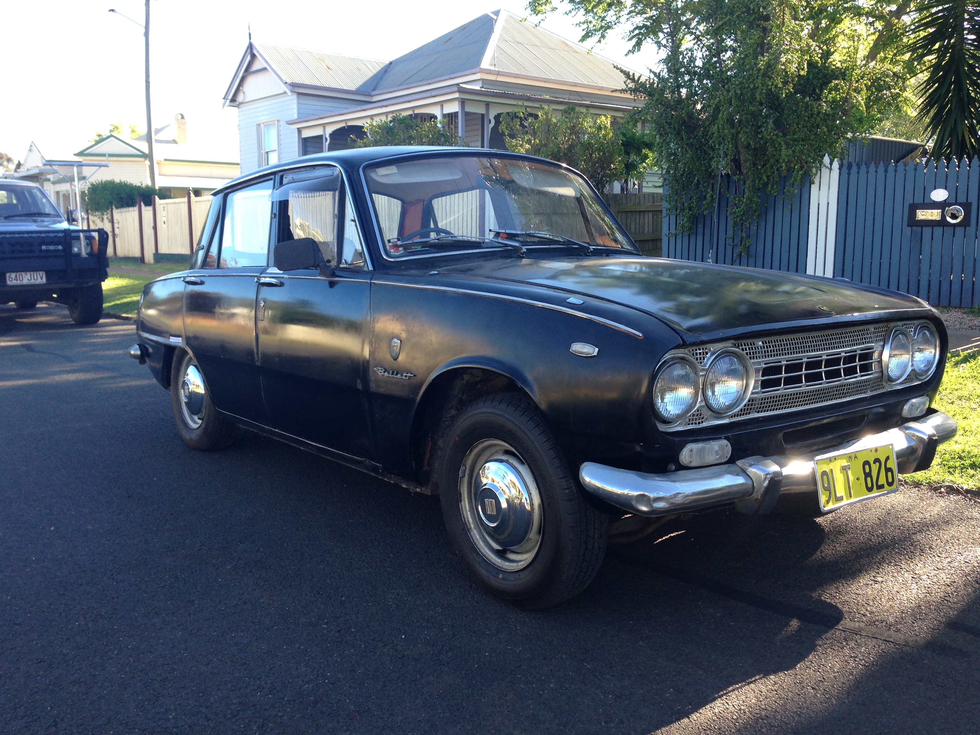

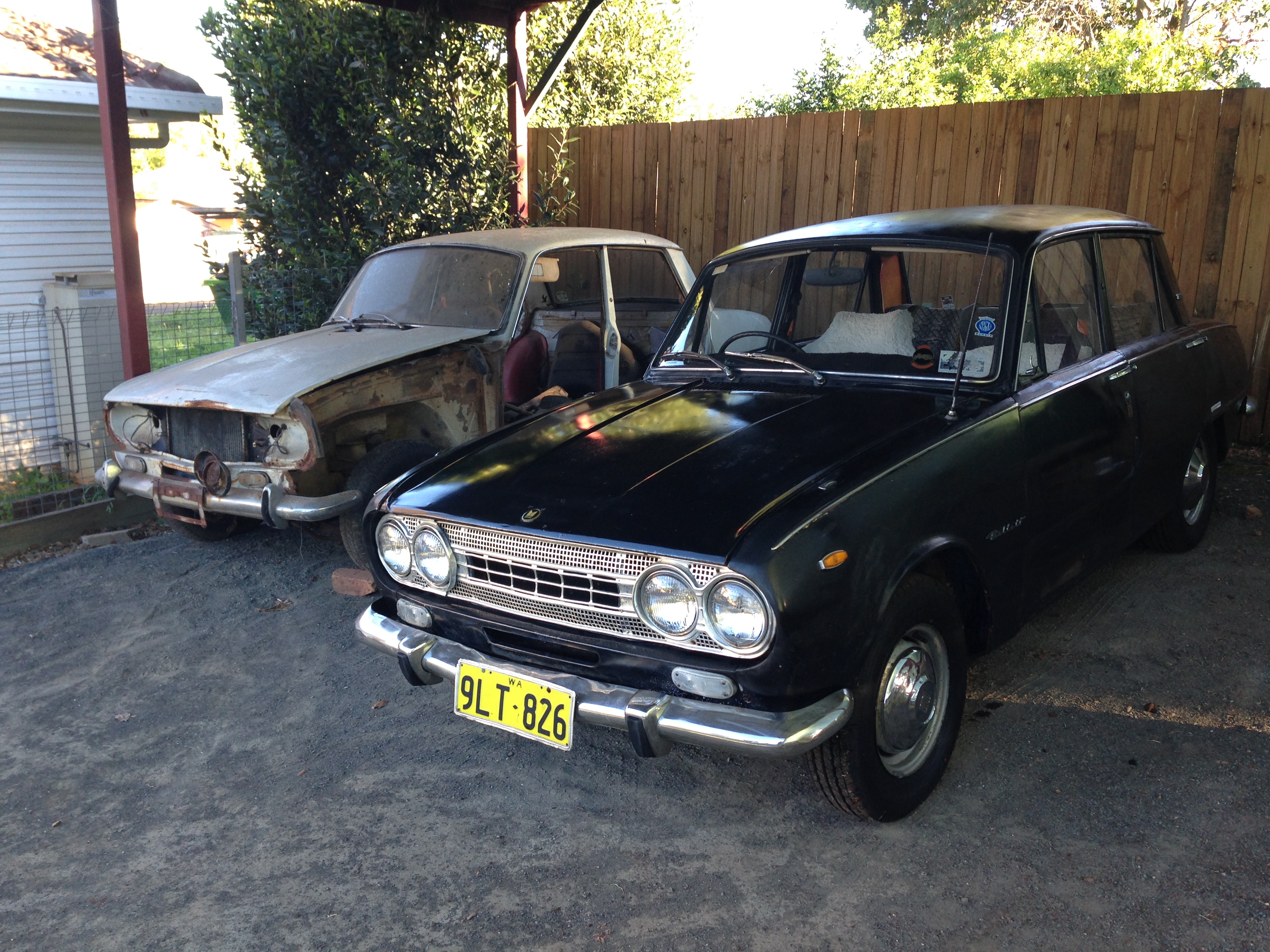

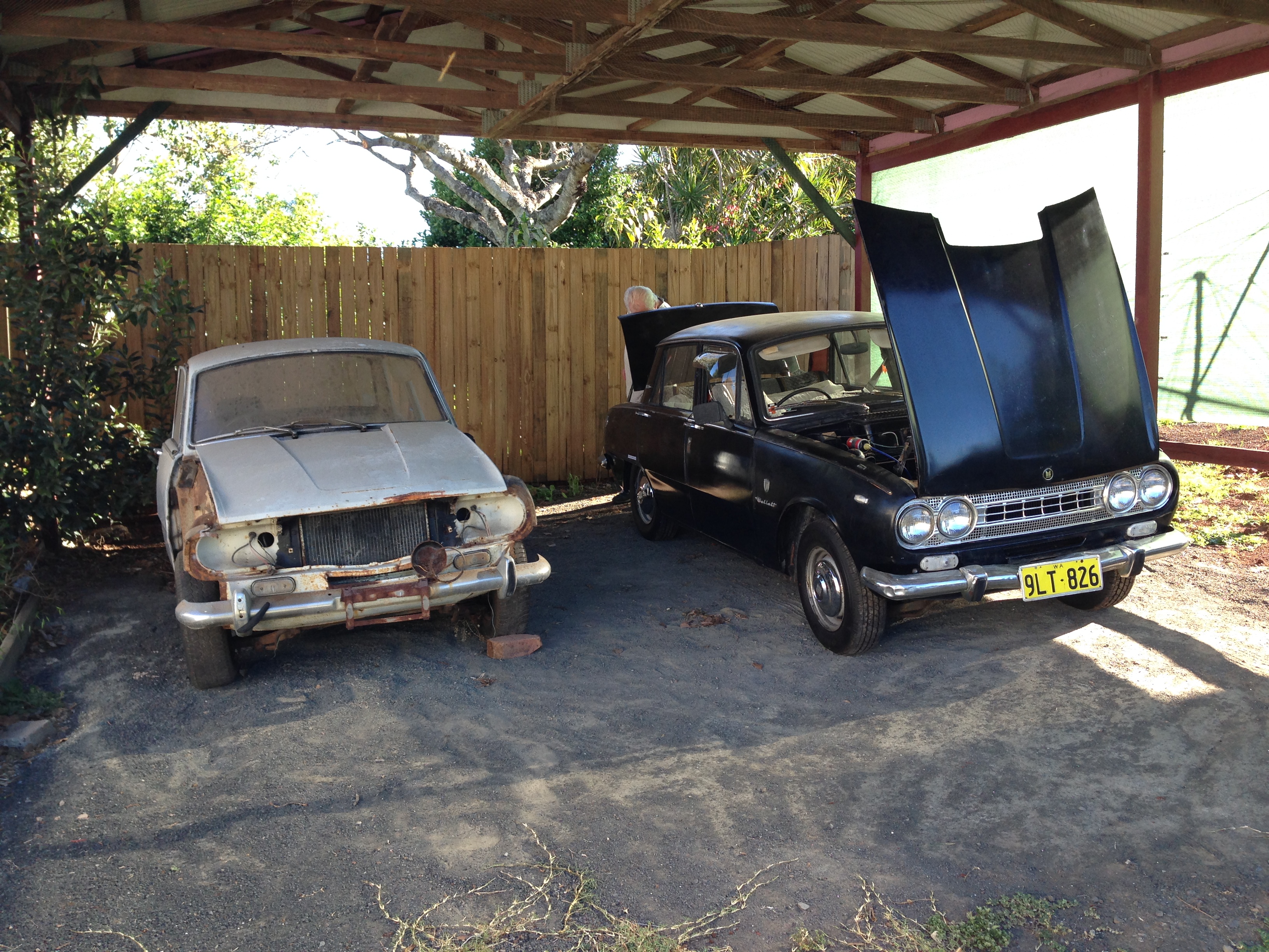

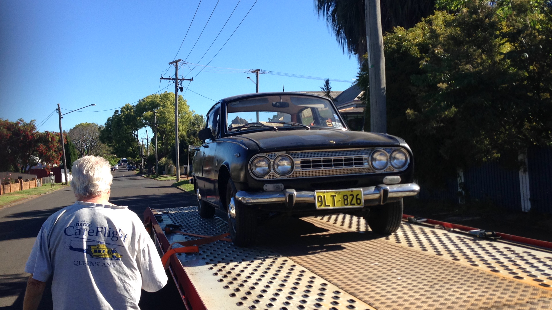

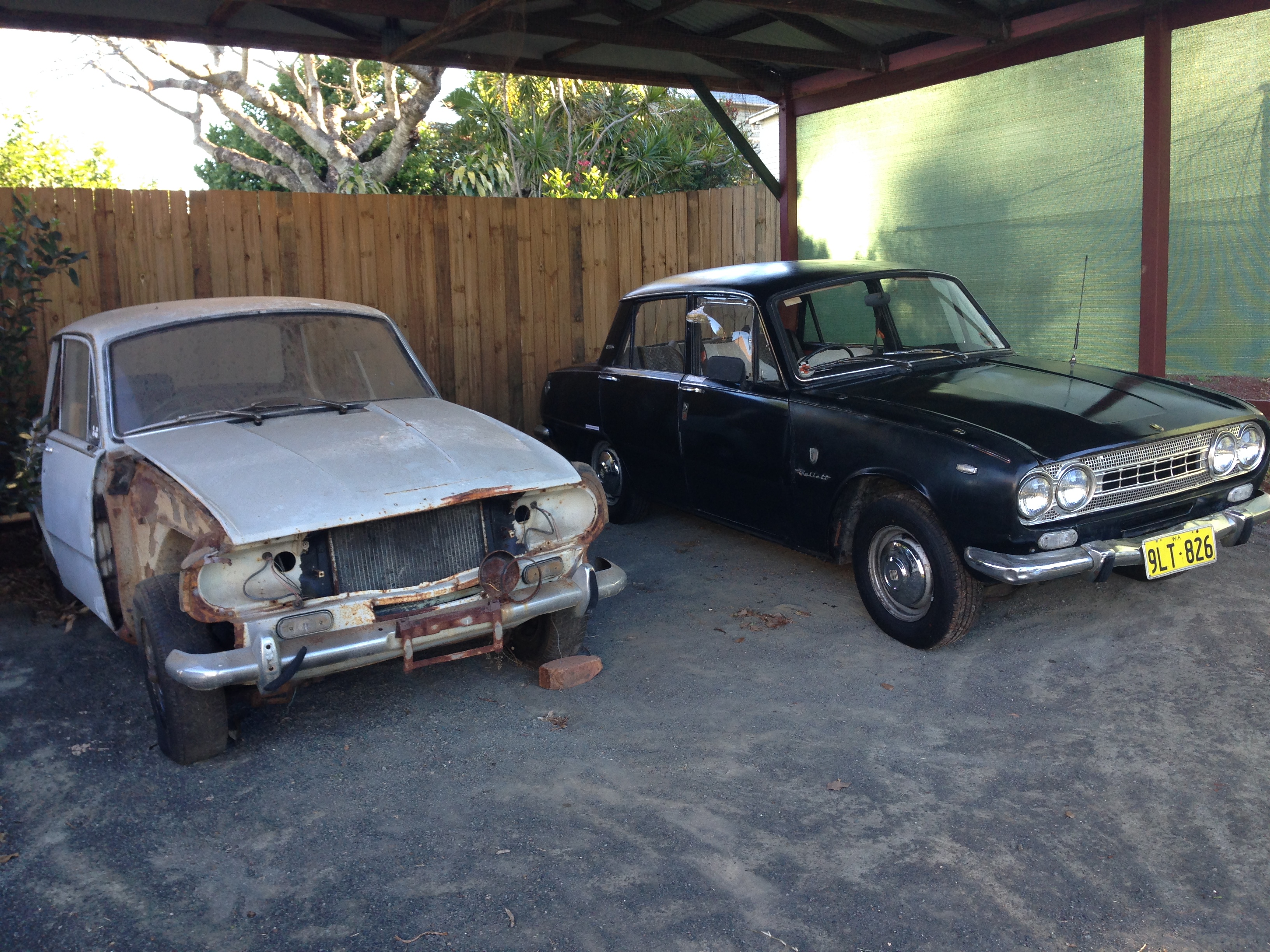

Sorry Gunna, couldn't help myself, someone from Toowoomba did get quotes, it arrived today and it now resides in my carport, some TLC is required, but it is a running vehicle and very presentable, some photos attached.
It's my son Michael's birthday tomorrow (19th), so it has arrived at a very appreciated time.
My apologies, looks like I got the photos out of order.

Excellent!!!
Tue Oct 18, 2016 8:55 am
FANTASTIC!
What a great idea! Now you will have one each!
That is a really good thing to do for him Ted, good on you. And it is a nice looking car. Factory black is very rare too.
Can't wait to see you guys cruising it.

This is GREAT NEWS, another saved. Well done Ted, would be GREAT if we can see it at next years National meet in Mudgee NSW, 13th to 16th October 2017. Details under Events, Bellett National 2017, on this forum.
Thu Oct 20, 2016 3:08 am
Posts: 368
That is a plan Dave, just have to get through a few formalities and make sure we get it registered here in QLD, we are driving it and it drives nice, body is a bit rough,but hey! we have a mobile Bellett, Michael is stoked as it arrived for his Birthday, so far, I haven't driven it, but been passenger several times, creating a lot of attention in Toowoomba Town, we even had a young lady follow us to a shopping centre to have a look at it and the Falcon when we were in convoy with each other, she said it brought back memories of one her father had.

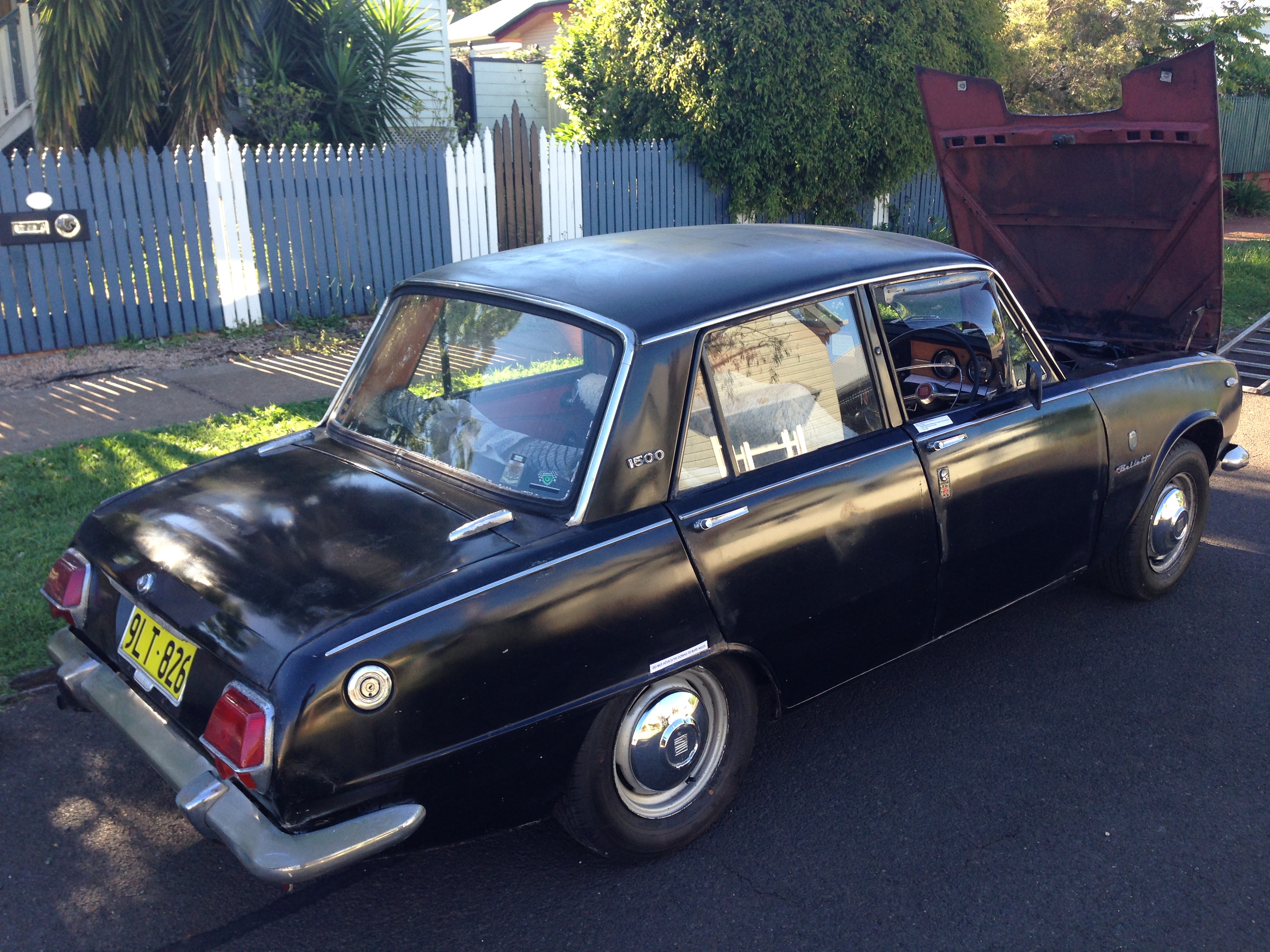

I drove the car for the first time today, I had forgotten how small the Bellett is after driving the XC Falcon for so long.
Steering and ride is quite good, clutch needs adjusting, it comes into play very high in the pedal movement.
Brakes, from 4-wheel Power Assisted Discs in the Falcon to 4-wheel non-assisted drums in the Bellett, no comparison, Discs on the front are going to have to appear, especially for modern day driving.
And to think I used to race these cars with Drums all round.

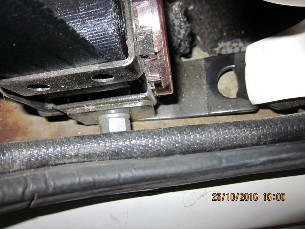

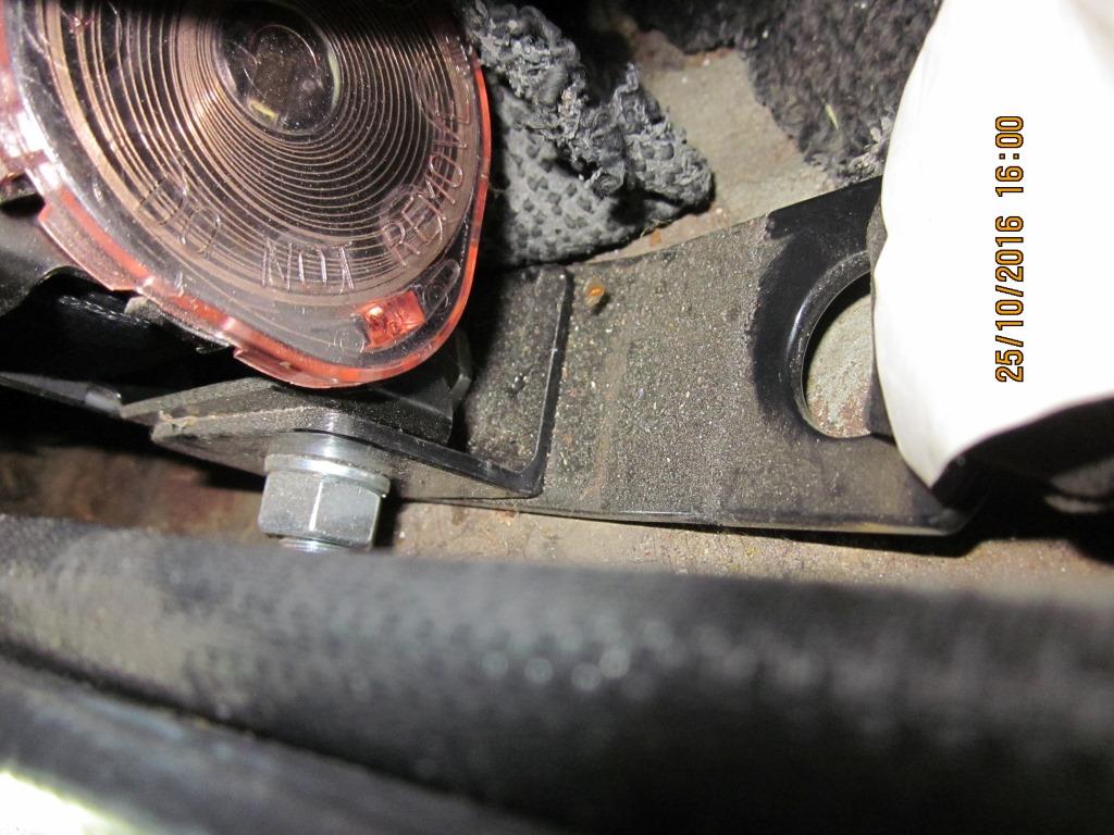

Ted,
others may have done it differently, but in my Sport, I used the standard holes for the three points.
For the intertia reel part, I cut a piece of 50x50x3mm angle iron, rounded of the corners, painted it black, drilled two holes in each section and sandwiched it between the reel and the right side lap mounting. I assume all belts are made same as mine. Use the correct seat belt bolts though.
The usual seat belt kit won't have enough bolts for this mount so you will need to find a bolt bar shop with the correct bolts. You need 2 nuts and lock washers also. Make sure the bolt hole in the vertical section is up high enough so that the reel clears the bolt that goes down into the floor.
Its best to get the reel level as possible or they will tend to lock when trying to put them on sometimes.

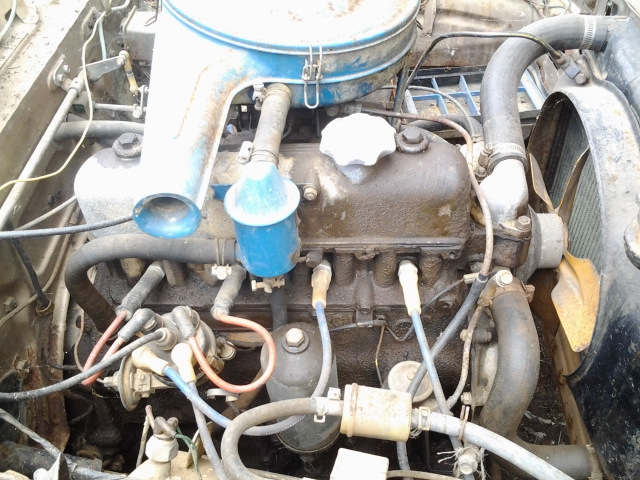

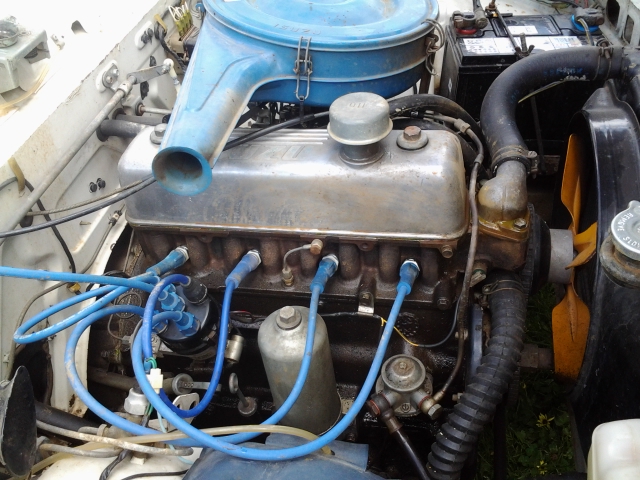

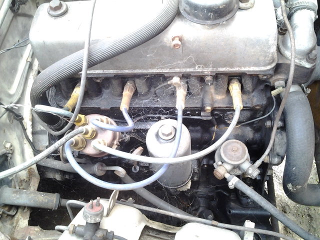

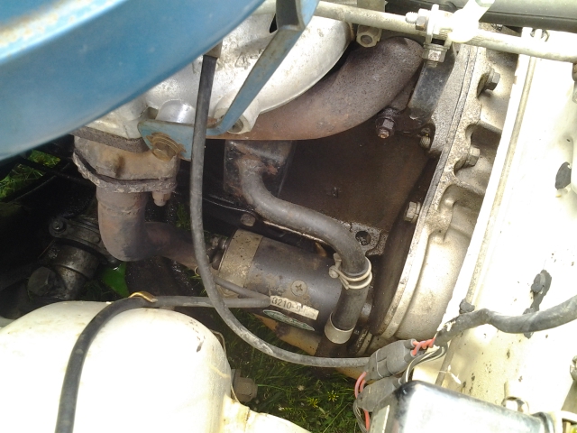

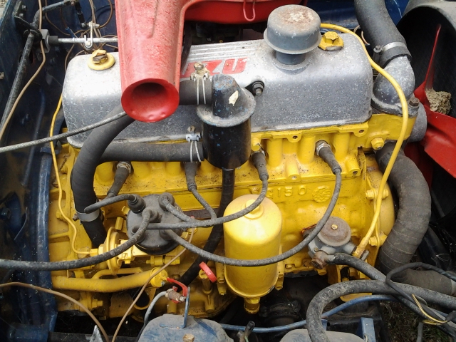

Your chassis number tells me its a 66 1/2 model, and I reckon you have a 3 bearing. Perhaps the breather fitting has been added? Here are some engine bays that illistrat what I believe was original for each model. (Sorry they are so dirty, some are 'spare' cars!)
First is 66 model. (Last of the teardrops.) This is Doris, so is an original auto with 3 bearing. (Rare model) They are same spec as 66 1/2, with alloy tappet cover with push in cap, late long point dizzy, small black separator box with breather pipe on the passenger side, and low starter motor. And rubber mounted steering rack.
Next is 67, with 5 bearing, alloy cover with spin in cap and separator that vents into the air cleaner.
Next is 68. They went back to push in oil cap, and the separator vents to the open, via a hose aimed at the road.
(This is an auto....and I didn't do the yellow!)
Just for interest, here is a 66 1/2 auto. It scored the 5 bearing, while the manuals had 3 bearings!
This is as I understand it, from looking over the years. As many components can be swapped from model to model, and peaple did this for convenience or preference, many combinations are possible.
