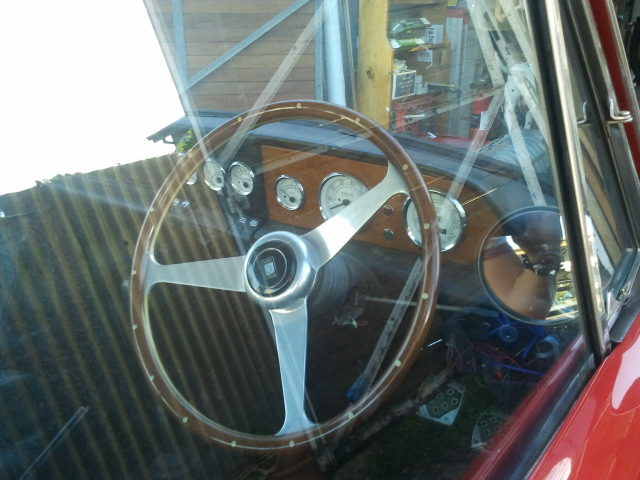

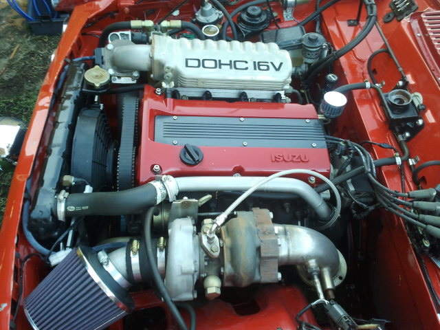

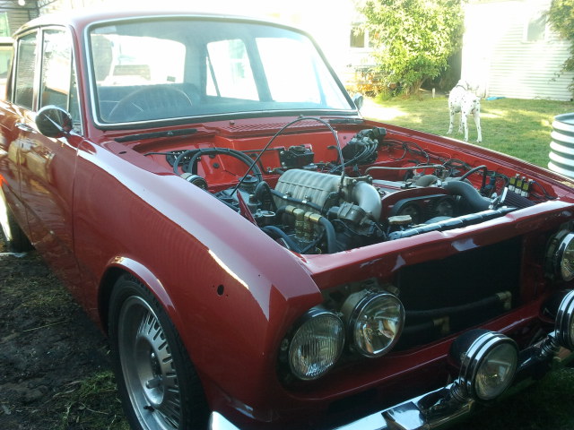

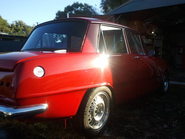

Here's my pride an joy, its been about 20yrs of on and off work on the car, mostly its in the garage but i get it out every now and then to give it a tubs and think about the good old days when life was a bit simpler.
Engine - 4XE1-WT
Gearbox - Nissan FJ20 Turbo
Wheels - Sigma Turbo
Brakes - Mazda RX7 - Series 4 (4 Spot)
- 11" Ford Discs
Guages - Classic VDO
Steering Wheel - Nardi
Seats - Cobra Classic
Chris

oh thats very nice, bet it goes well too!
I like the dash treatment and the steering wheel looks good too, Is the paint the origional colour?
be good to see some more pics of the beast or even see it out and about sometime!

Every little step there was a modification to be done.. from the Throttle Body swap to the Waste Spark ignition, it only just fit in, no intercooler though I have routed the pipes down so i could mount one in front of the car at some point but i think it would ruin the look.

I have an oil cooler mounted in front of the radiator where the three air holes are, it would still be a bit messy with the pipe work for an intercooler. Amzing how time flys one miniute your going to the Nationals the next Married with a couple of mortgages.. I googled Bellet and came up with this site.. very cool, I remember sending a picture to a bloke in the Netherlands when i frist started putting the engine in.. but i think its gone now. a mate got me enthused again when he bought an RX2 a few weeks back in bits, i read that someone thought the car was photoshop myth so i joined up.. its great to see there is so much intrest in the cars out there.

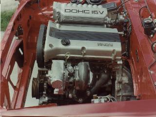

Here's a picture you sent me years ago.........
Sun Apr 29, 2012 11:50 pm
Posts: 234
Car(s): 65 and 66 sedan
That looks fantastic. Did you get the motor out of the U.S?

The Motor is out of a JT AWD Gemini, its the same as the Lotus Elan S2, Isuzu Built it to for the Elan but ended up putting it into the AWD Gemini, I had one of those for a few years but sold when i bought the Hilux, best thing ive ever bought.
I need to pickup a new battery to get it out of the garage, that's in the boot now, running a Commodore VT Battery, a couple of fuel pumps and a small surge tank.
