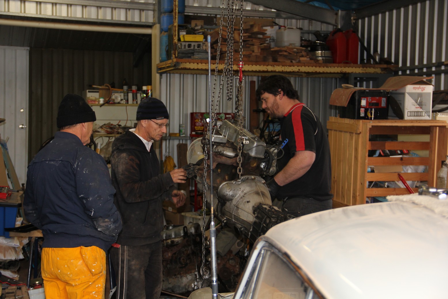

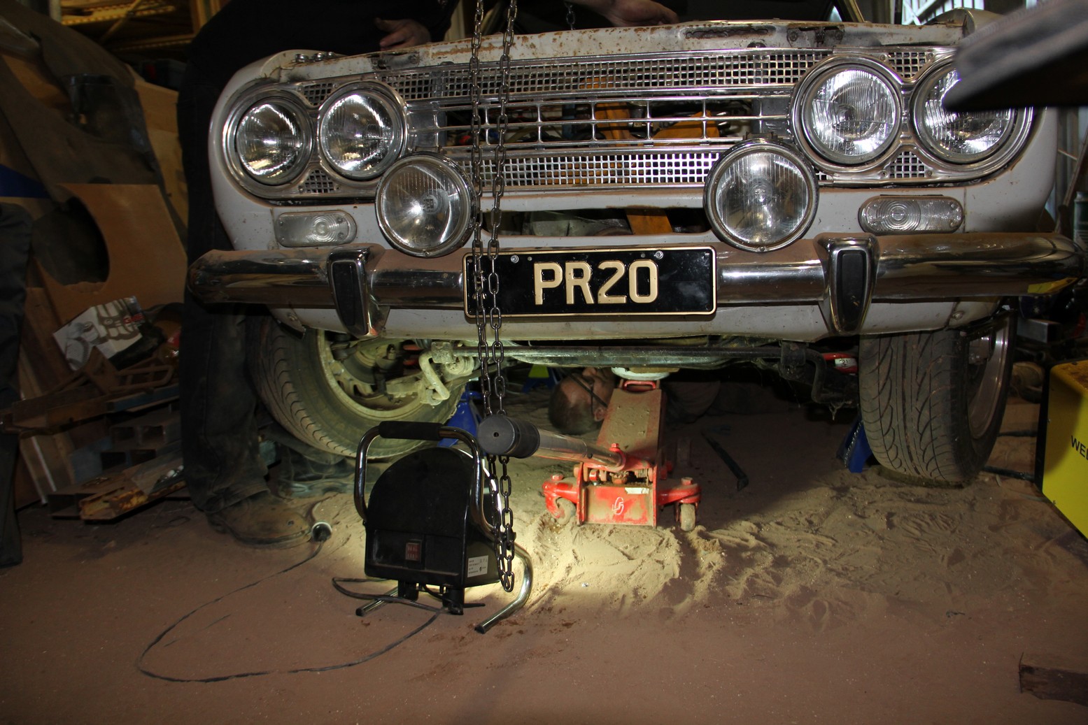

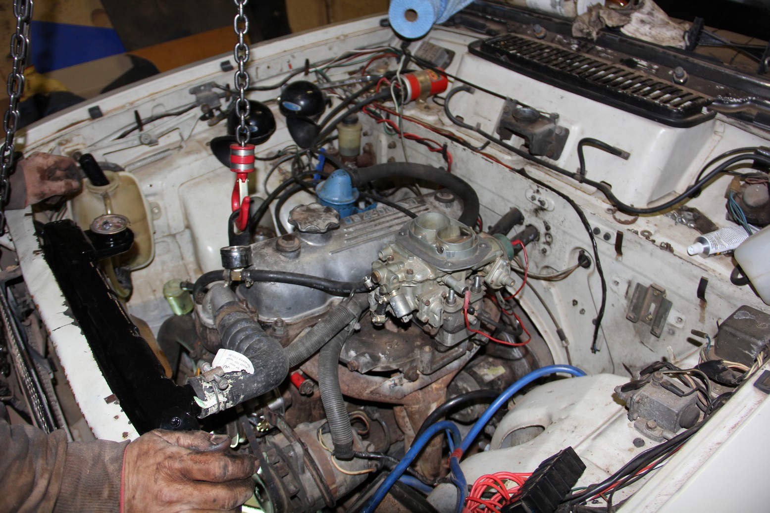

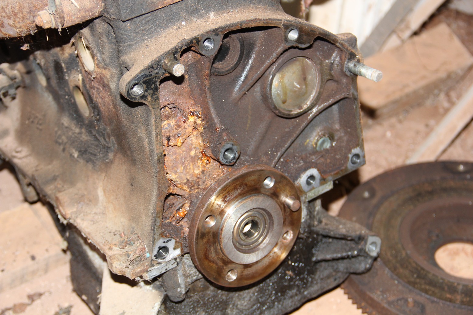

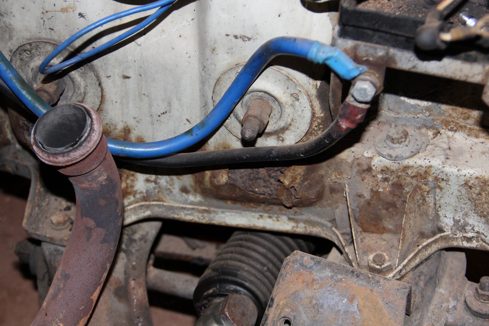

We all had a great day, if not pretty busy :)
but i did manage to get a few pics...
The Donor Car with easy engine removal access kit as factory fitted

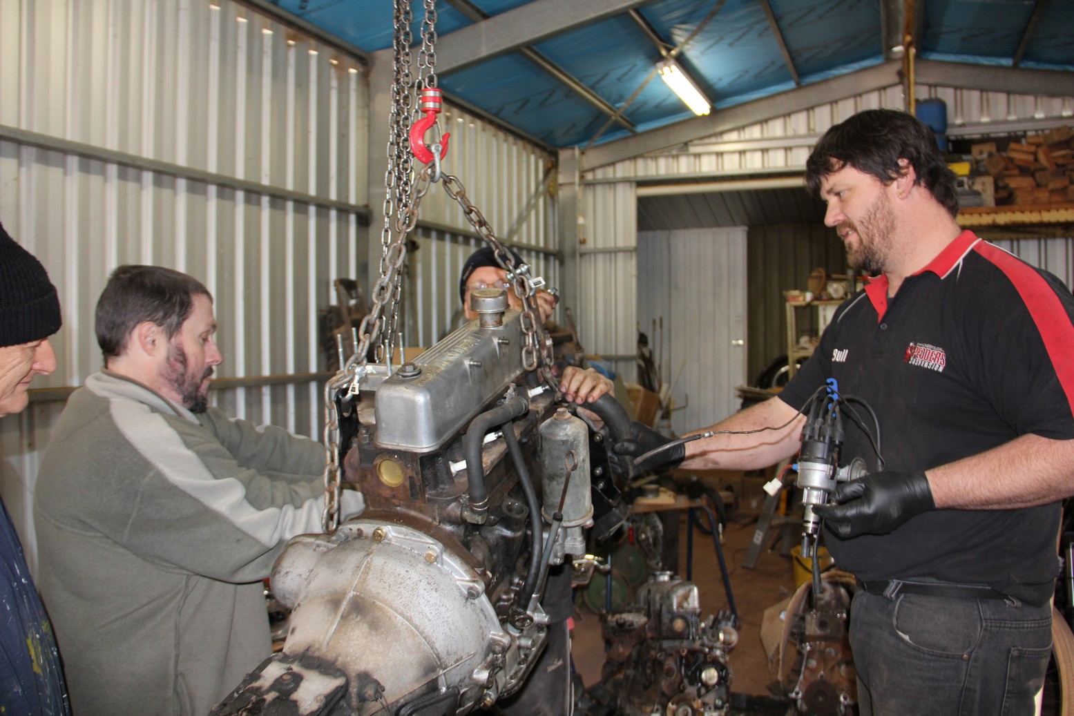

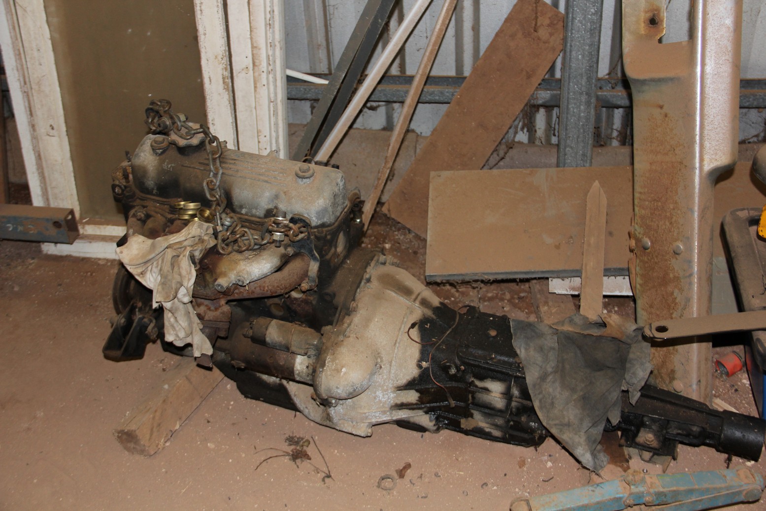

Engine and gearbox awaits
Whats going on here???
Nothing wrong with that Welsh Plug!

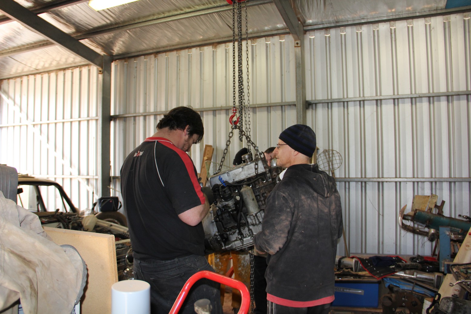

Who is doing all the work..
some rust repairs

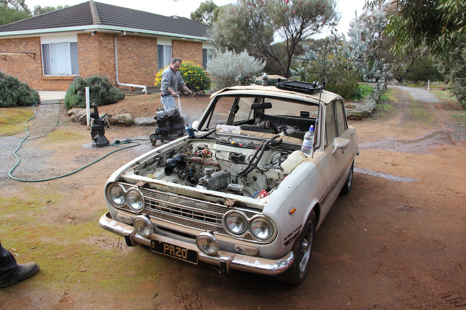

Sun Jul 15, 2012 12:17 pm
and the last for the day
Motley crew 1
Motlye crew 2
nearly ready to fire her up
