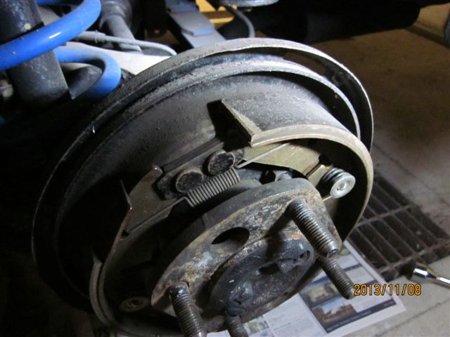

I think i might have tracked down the clunking noise just after moving away in my Sport. The top section of the rear shoe appears to be 'catching' somehow. You can see the lighter triangular area thats worn. At first i thought i had the shoe upside down but thats the way the manual shows it also.
It might also be the case of the vibration occuring at about 80kph ???
Anybody got any ideas on this ? The shoes are brand new and were radiused to the drums by BGT brakes here.
The only variation i have is that the 2 springs are fitted on the outside of the shoes not the inside that the book shows. (too damm hard to fit them inside !) I don't think that would be the problem though. Both springs are fitted in the outermost of the holes (there are two holes close together)

Glenn, You mentioned earlier the leaking of oil at the diff / propshaft seal. Think the rumble is coming from there too; unbalance of the prop shaft at the rear. Turn it 180 degrees to see if it makes a change.

I don't think thats the problem. Its a broad range of speeds that it occurs at, from 75kph to 100 or so. I can hear a clunking "noise" emanating from the left rear of the car which suggests the brakes are the problem. And the wear on the shoe suggests this is the area. I can hear a noise also after i apply and release the brakes, pointing again to the issue i have found in the picture. This car has the rubber donut rear and not a uni so i don't think phasing is a problem with this setup?

My sedan rh rear cyl. has been leaking. Have changed cylinders and brake tube twice and still a problem. I've re -assembled the brakes 3 times and every time I do it I put the springs on the inside of the shoes.
Bottom spring. Turn axle flange around untill flat side is to bottom. Join the shoes together and present both to backing plate with spring going up between flange and cylinder. Mount shoes onto cylinder. Don't worry about adjuster at this time.
Top spring. Pull shoes towards you at top and fit spring into 1 of them. Using needle nose pliers grip spring on the spring coil or the wire and feed end into back of other shoe hole. Note. The longest holes apart are the holes to use. You will find by trial and error that you have selected the correct ones as the tension is a guide. Insert the top of the shoes into the pivot bracket at the top of the backing plate by pulling the shoes away from each other to go around the flats.
Check that flat bracket too see that it's not too loose or too tight. This may be the cause of the wear problem or the shoe retaining spring may have lost tension or the pin and washer may be worn.
Put the adjuster onto the cyl. and shoe. Assemble the springs/pin & washer. Put drum on. Adjust brakes as per manual.
You said you had the shoes radius ground. Did you have the drum machined. :?: Or is that what you meant that you had both done at the same time. :?:

Thanks for info Dave. Will try again asap. For now i have backed off the adjustment slightly and today i will take it out and try it again. ( I have to run an errand with the trailer this morning)
