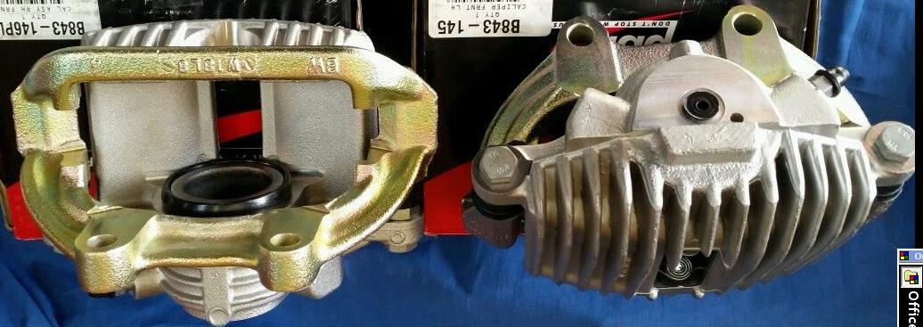

PR91 wrote: New caliper looks Commodore. GT rotors and hubs are clear drilled. They use bolts and nuts. VL turbo and early V8 models had an alloy finned caliper but that's not it. I have a set here on my hotrod. They have much deeper fins on top..... what's interesting is that the earlier Commodores used a 22mm thick disk, the TP Magna uses 24mm.

My Gt convertible has girling brake calipers fitted. Another modification done by previous owner/owners. I had them overhauled about 4 years ago and the brake specialist told me they were off of an Avanti. He was probably going by the kit that he used as Avanti is front wheel drive and are mounted forward of the axle and have 12mm threaded holes. I picked up a set of calipers from a wrecker from a XT130 Corona. Hole centers are the same only are 12mm drilled. !0mm on GT. Have been trawling through all the Nissan & Hyundai parts listings for a 12/10mm hollow dowel. No luck. 14mm has been closest. Still looking. Dave.
