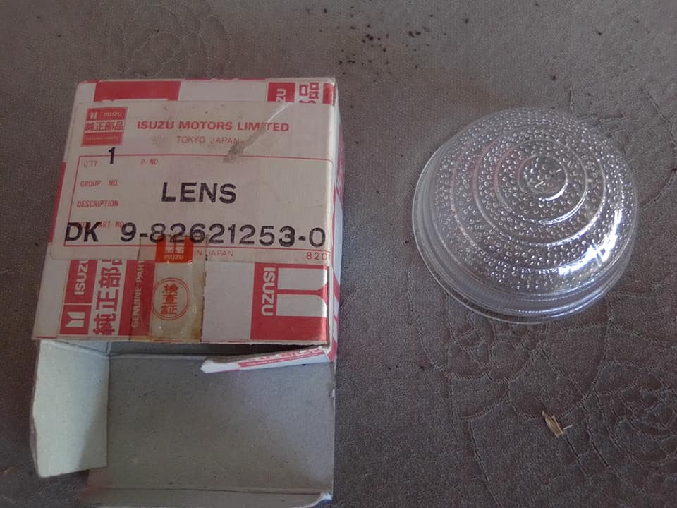

Hi
I have clear copies of the beehive lens but not the metal surroud
As Glenn has said the headlight surrounds are very scarce
Flying

I have a set of the beehive (GT) lenses for sale. PM me or go to classic isuzu on Facebook.

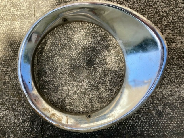

Fri Jun 12, 2020 11:36 pm
I have both types, the Bellett ones are pressed alloy and tend to get banged up a bit but the Austin ones are cast then chromed. The Austin ones ar a bit deeper too and in my opinion look better, much better quality but totally different mounting.
I am actually using the Austin ones on my GT instead of the original Isuzu ones (which are a bit beat up anyway)
