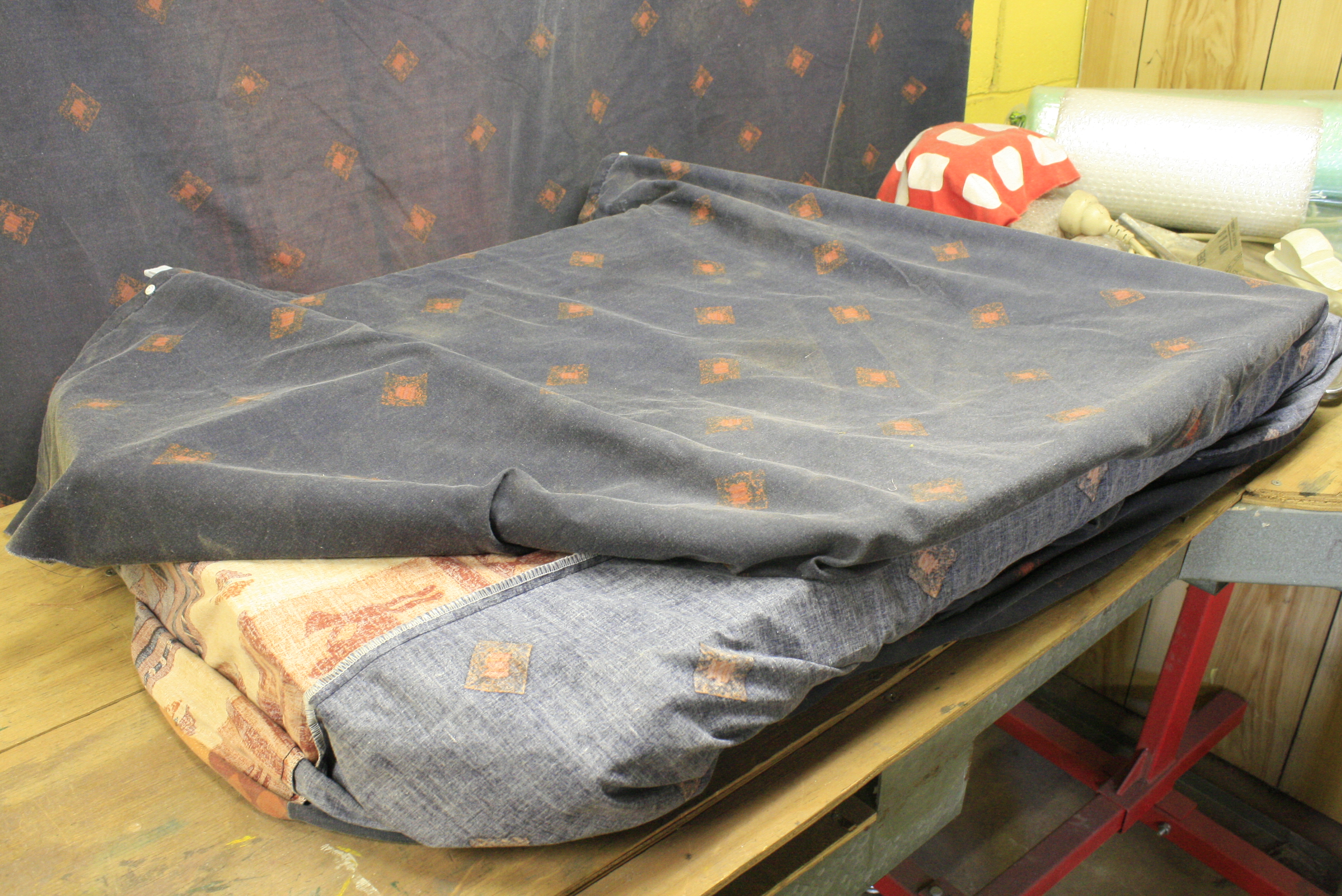

...........Tucked Away So The Next Item Can Be Started & Prepped...........
