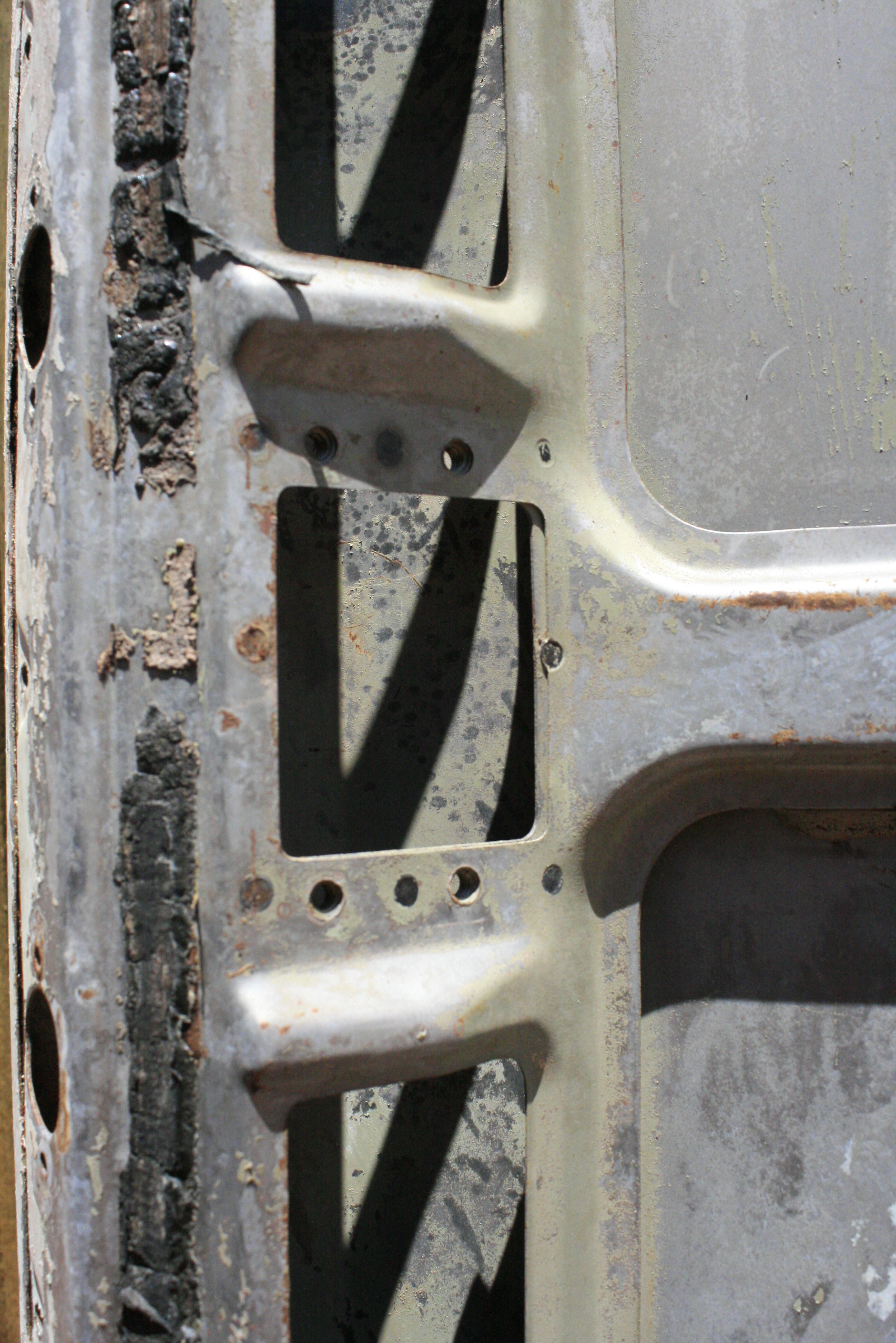

..After One Good Coat Of Stripper..

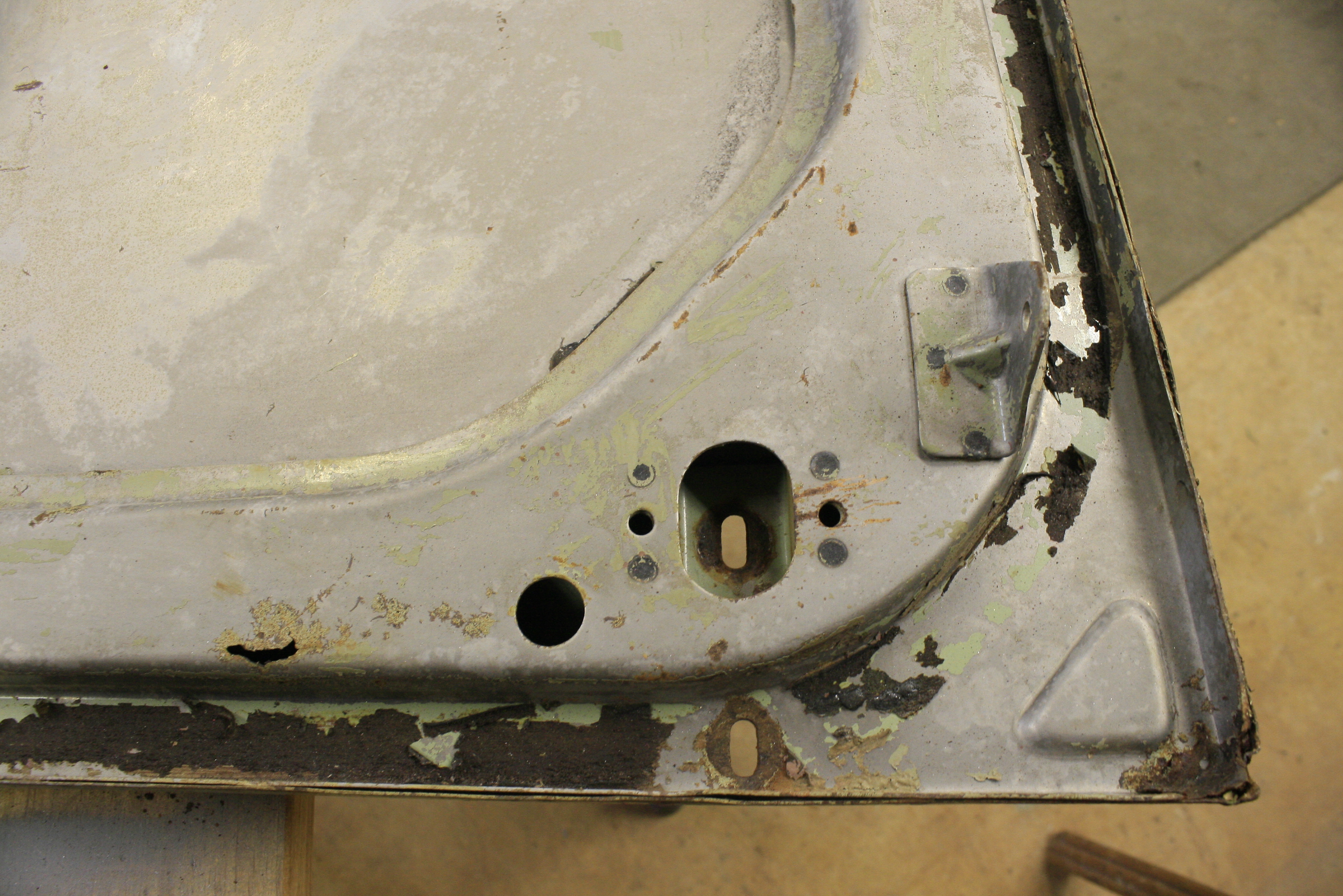

........After The Paint Stripper I Will Go Over All Of The Insides With Various Types Of Abrasives To Achieve The Bare Metal Result I Desire, Then & Only Then Will I Start Etch Priming & So Forth........

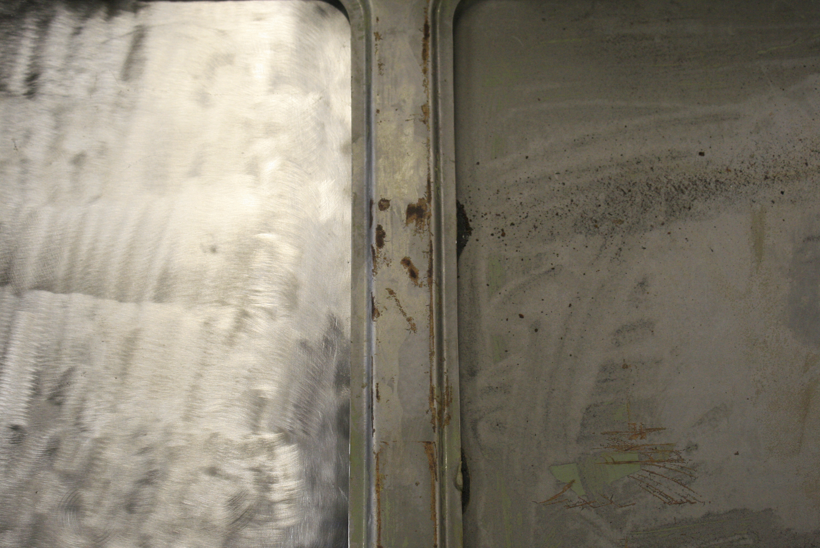

.The Various Ways Of Achieving The Desired Bare-Metal Results, I Now Opt For Paint-Stripper First Then The Rapid Strip Wheel & The Carpet Strip Discs For The Tight Spots, These Three Methods As I Have Found From Personal Experience Will Get The Results Desired & Then Some But Not Saying That This Is The Only Way, But A Way That Works For This Particular Application,
In The Picture Provided One Can See The Different Effects From The Various Products..
