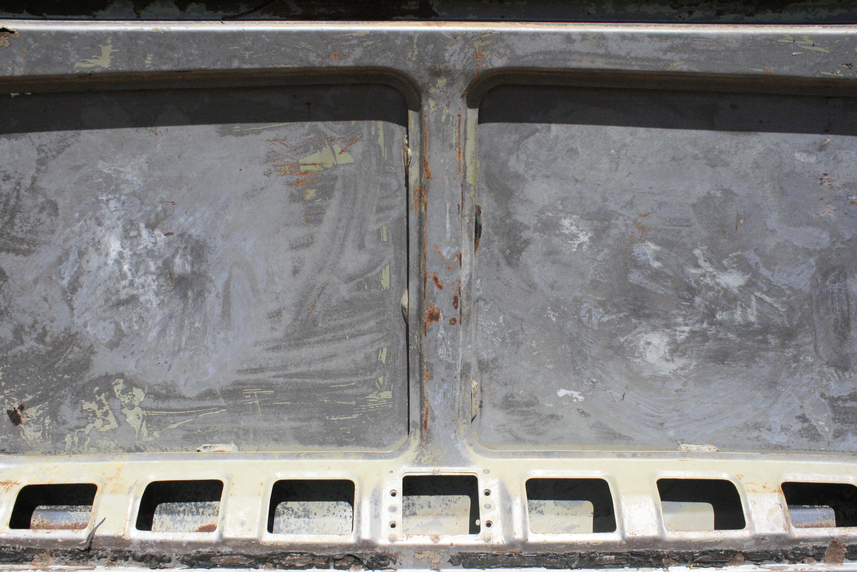

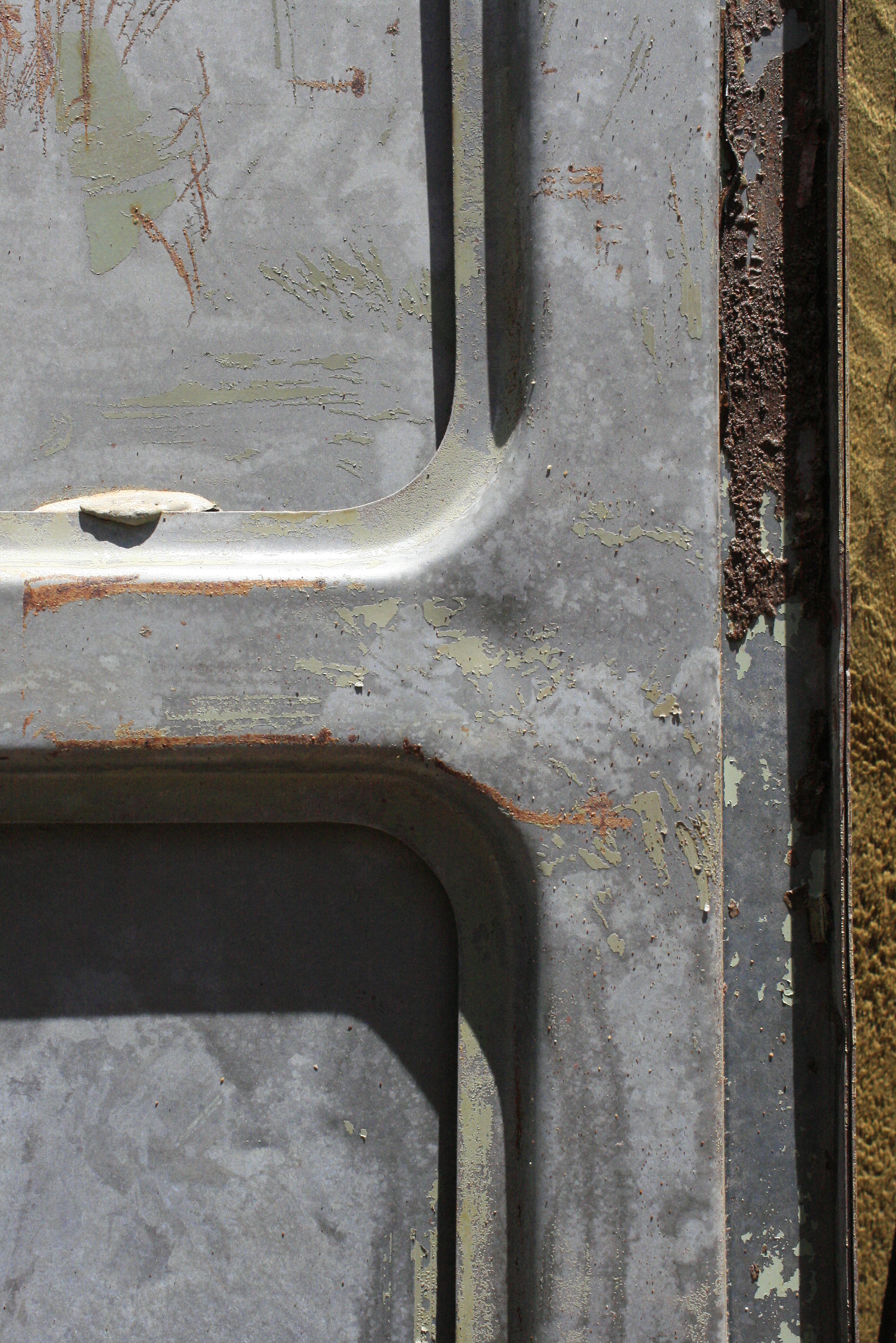

..After One Good Coat Of Stripper..
Ted Freeman
Sun Jan 24, 2016 3:51 am

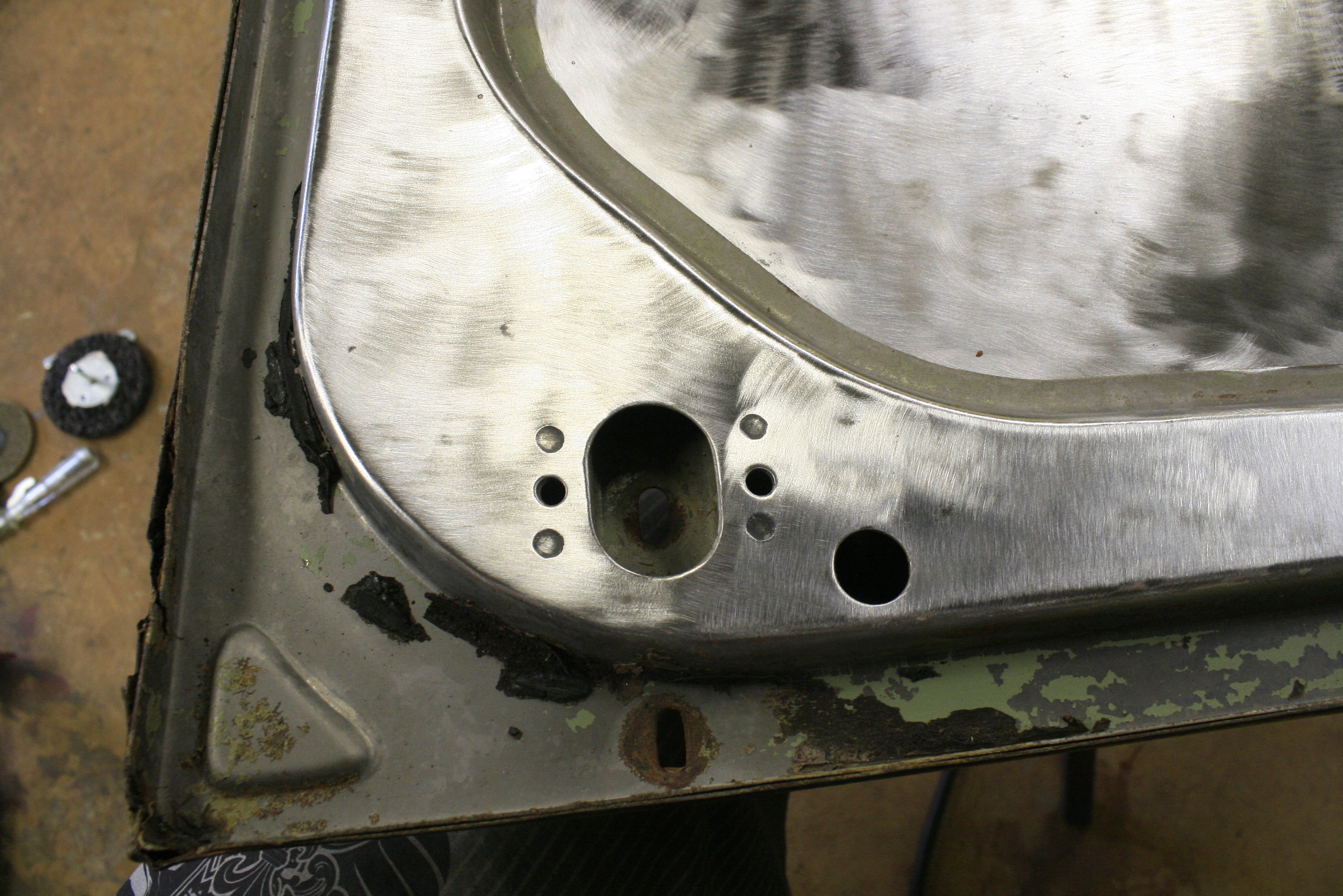

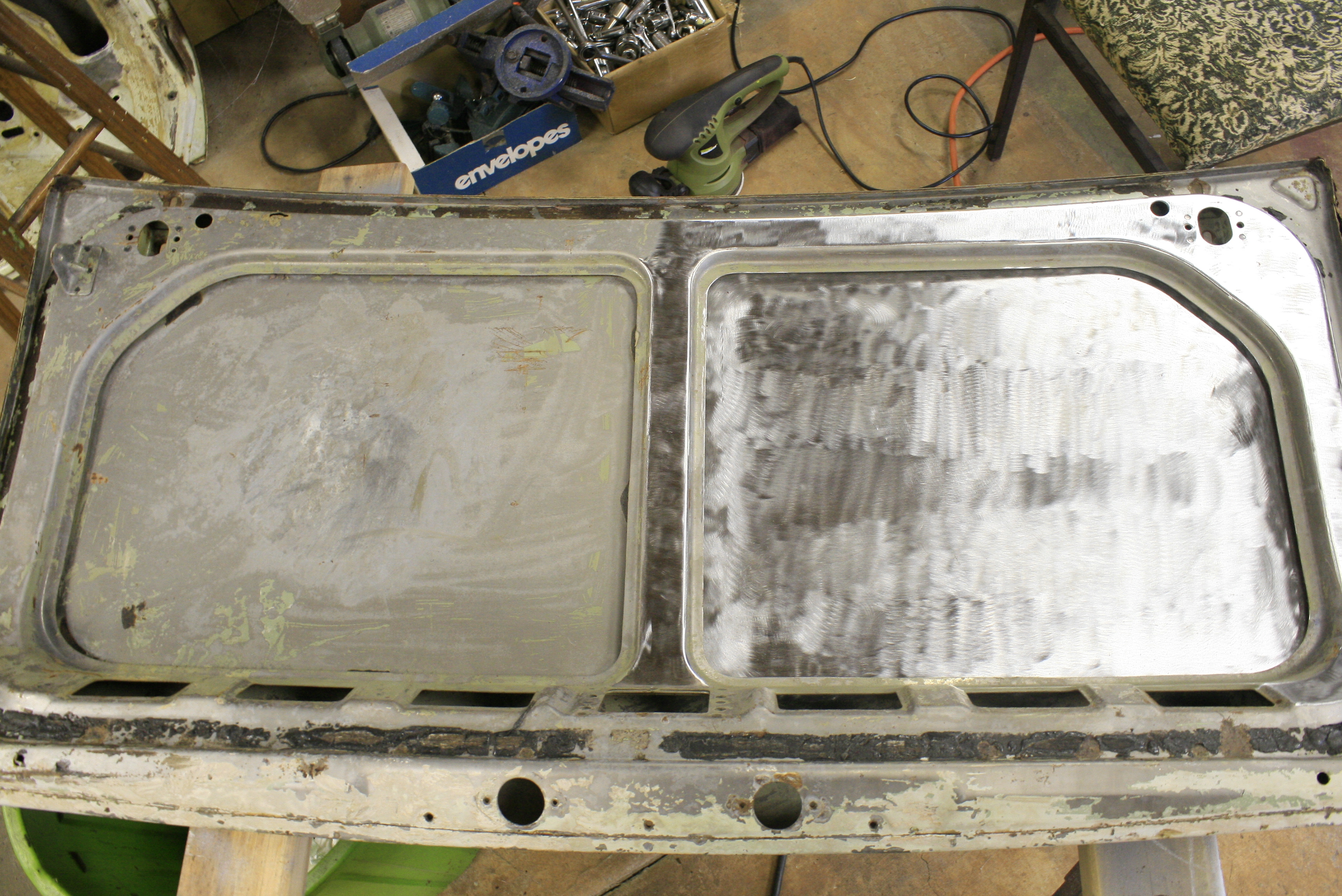

........After The Paint Stripper I Will Go Over All Of The Insides With Various Types Of Abrasives To Achieve The Bare Metal Result I Desire, Then & Only Then Will I Start Etch Priming & So Forth........
Ted Freeman
Sun Jan 24, 2016 4:07 am

.........After The Paint Stripping Most Of The Final Bare Metalin' Will Be With The Air Dremmal, I Have A Small Wire Brush Wheel Displayed Here, Others Such As What I Call (Carpet Disc's) Will Give A Far Better Result, Initially I Used The Wire Brush Wheel To Get The Inner Left Door To Bare-Metal Without Using Paint Stripper, So Methods Are Constantly Evolving.........

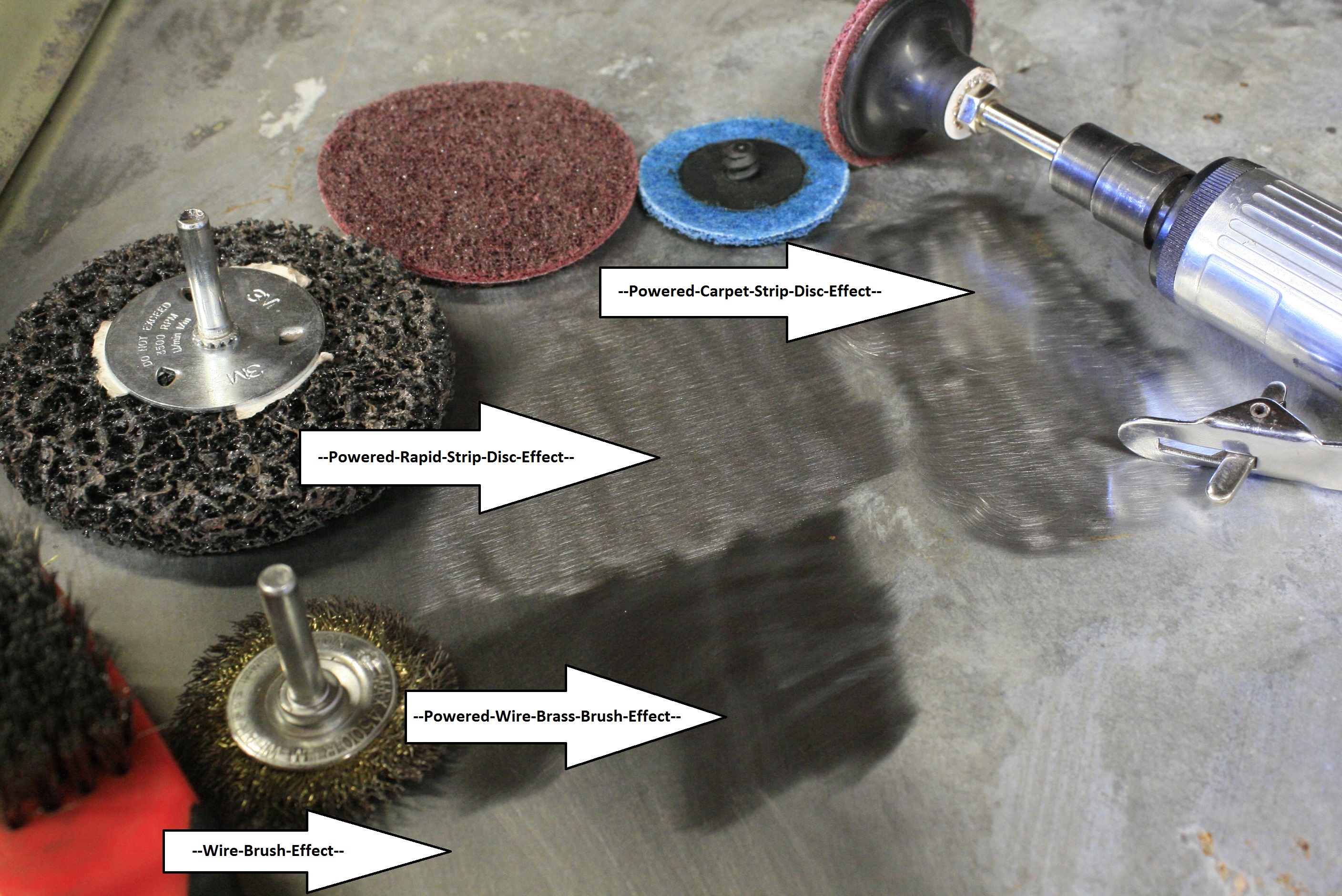

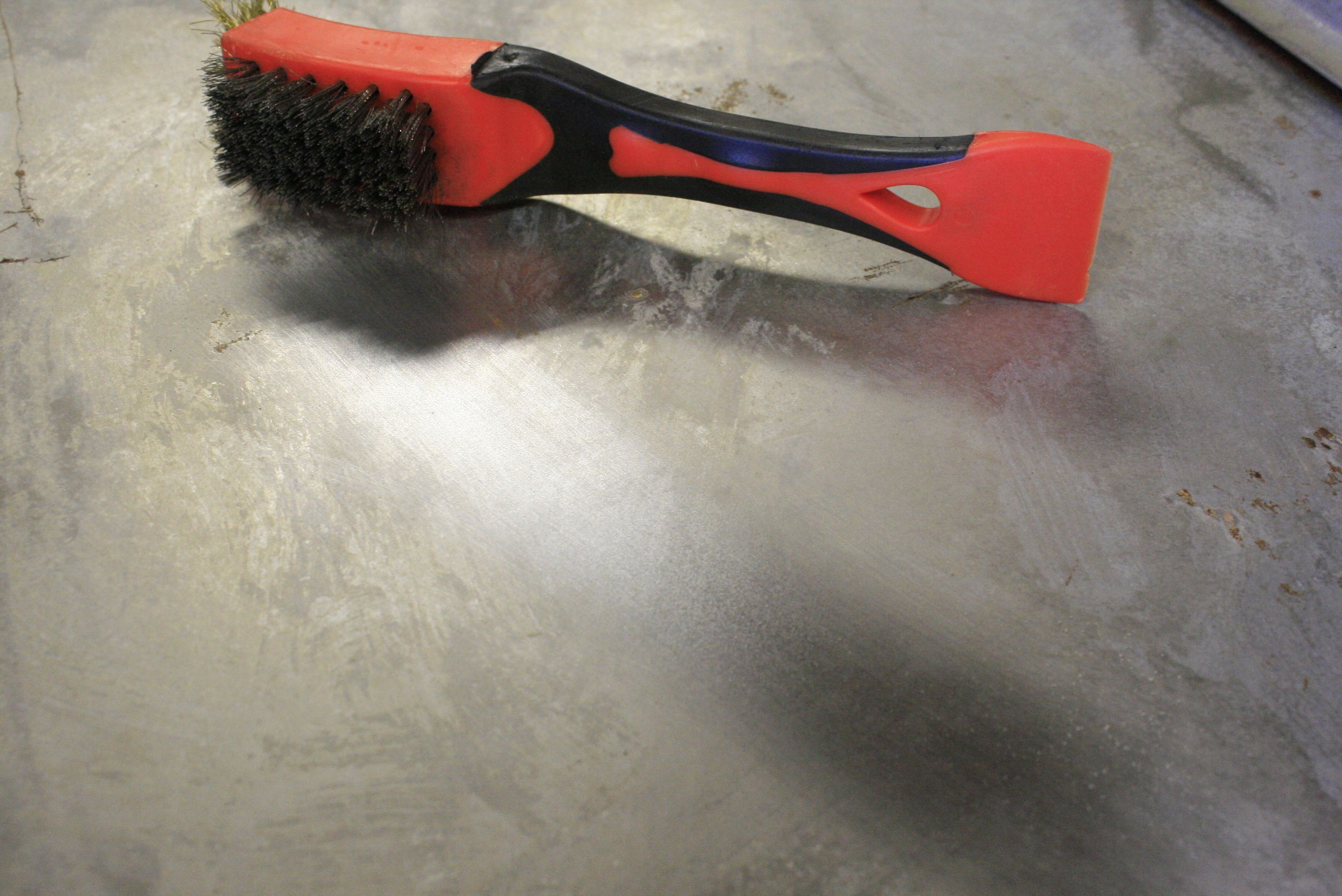

.The Various Ways Of Achieving The Desired Bare-Metal Results, I Now Opt For Paint-Stripper First Then The Rapid Strip Wheel & The Carpet Strip Discs For The Tight Spots, These Three Methods As I Have Found From Personal Experience Will Get The Results Desired & Then Some But Not Saying That This Is The Only Way, But A Way That Works For This Particular Application,
In The Picture Provided One Can See The Different Effects From The Various Products..
Ted Freeman
Mon Jan 25, 2016 12:44 am

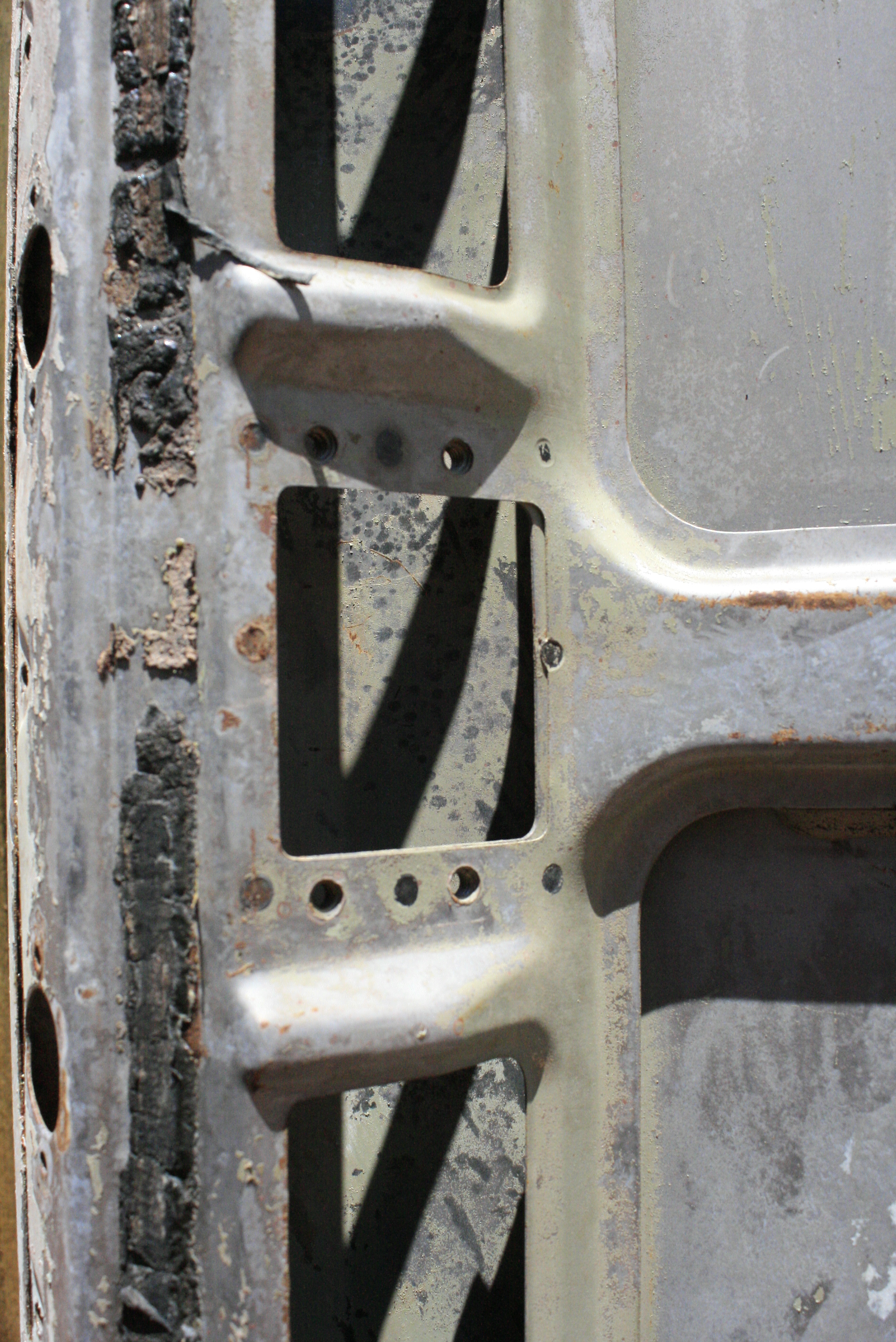

.Inner Boot Preparation.
Ted Freeman
Mon Jan 25, 2016 5:10 am
