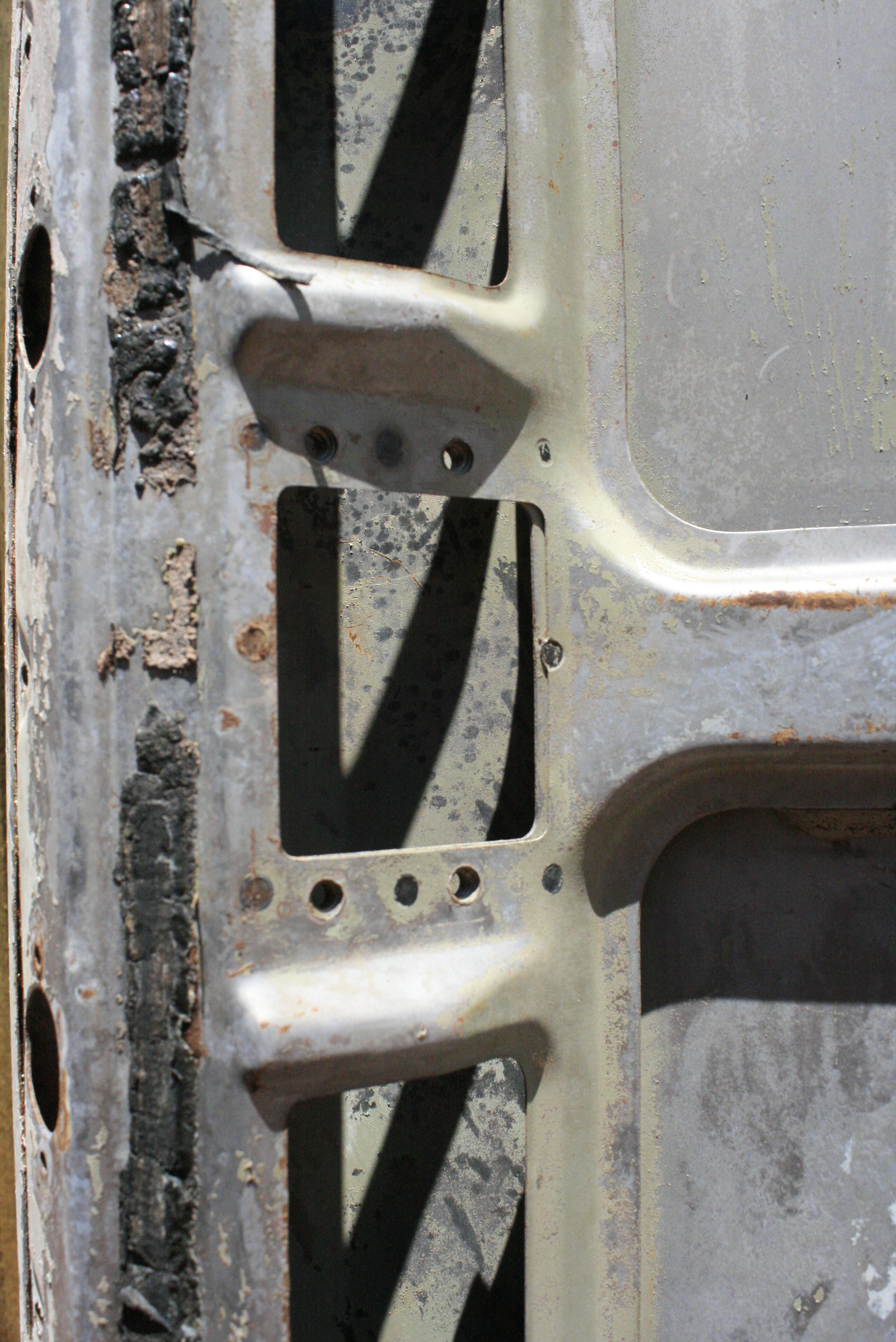

Screamin' Squirrel II
Posts: 368
..After One Good Coat Of Stripper..
Ted Freeman
Sun Jan 24, 2016 3:51 am
