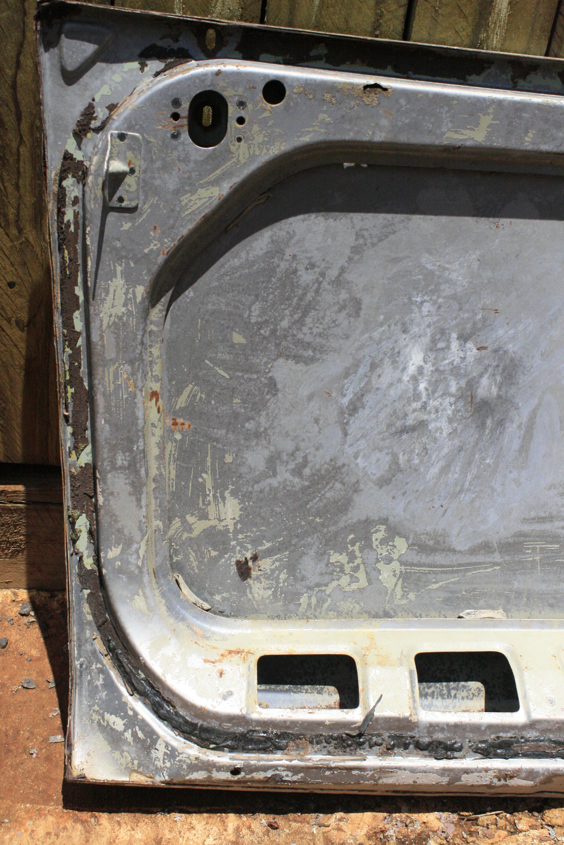

Screamin' Squirrel II
Posts: 368
..After One Good Coat Of Stripper..
Ted Freeman
Sun Jan 24, 2016 3:51 am

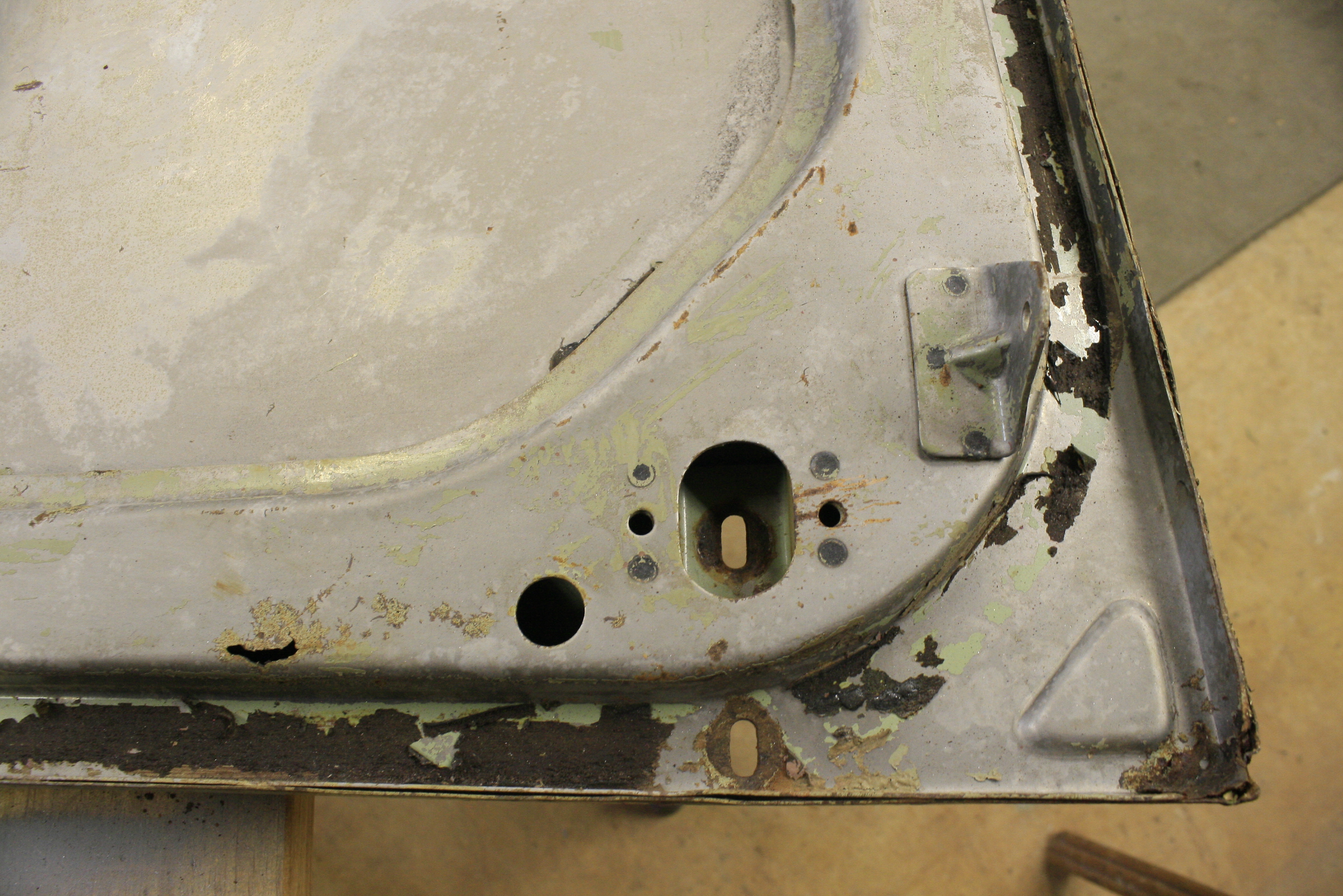

........After The Paint Stripper I Will Go Over All Of The Insides With Various Types Of Abrasives To Achieve The Bare Metal Result I Desire, Then & Only Then Will I Start Etch Priming & So Forth........
Ted Freeman
