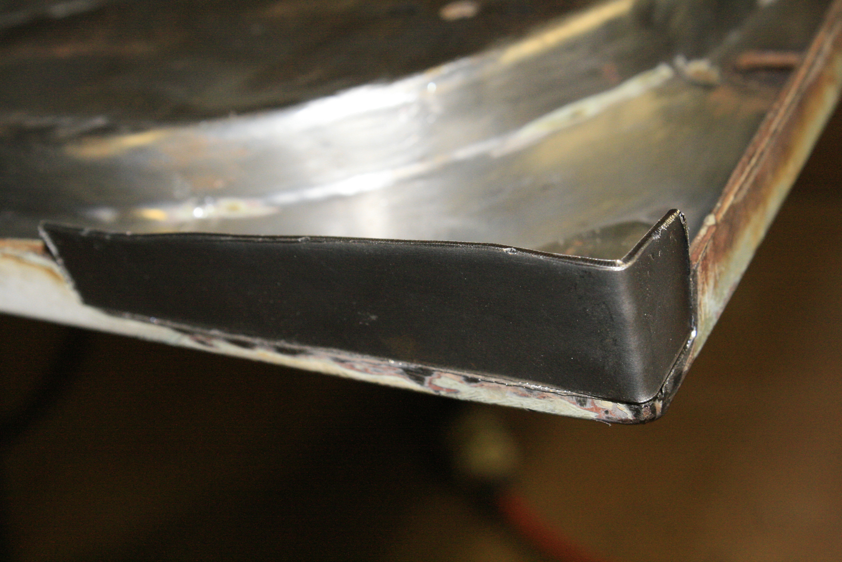

Posts: 368
..The New Section Welded In..
Ted Freeman
Sun Feb 07, 2016 3:22 am
Posts: 368
...Dad & I Bought A Nibbler That Goes With Any Drill, The Metal Will Bend While Being Cut With The Nibbler & Also When Welding, So Alignment Is Needed, A Simple Metal Working Dolly & Hammer Will Tap Things Straight Again...
Ted Freeman
Sun Feb 07, 2016 3:29 am

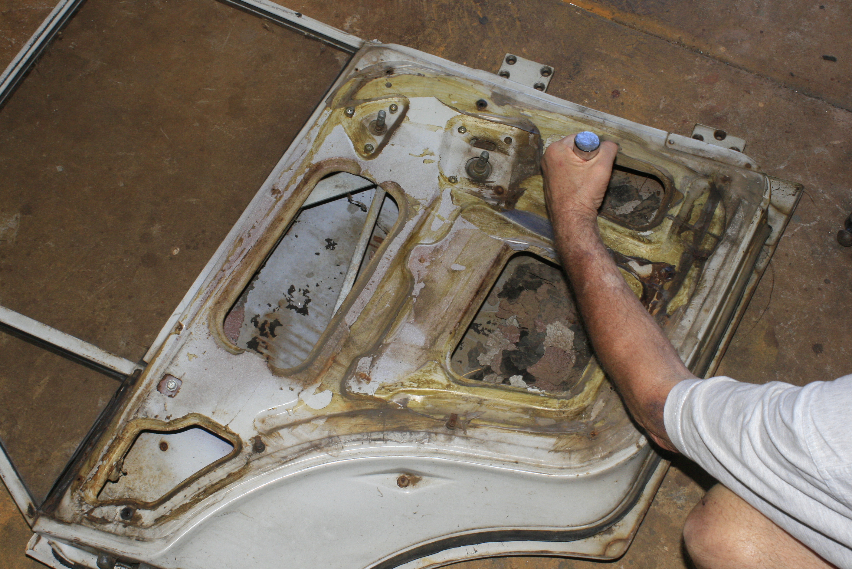

Posts: 368
..Dad Is Working On The Back Left Door As It Will Be Next In-Line For Restoration..
Ted Freeman
Sun Feb 14, 2016 4:02 am
Posts: 368
...There Is So Much Crap Within, But Justice Will Be Done...
Ted Freeman
Sun Feb 14, 2016 4:05 am

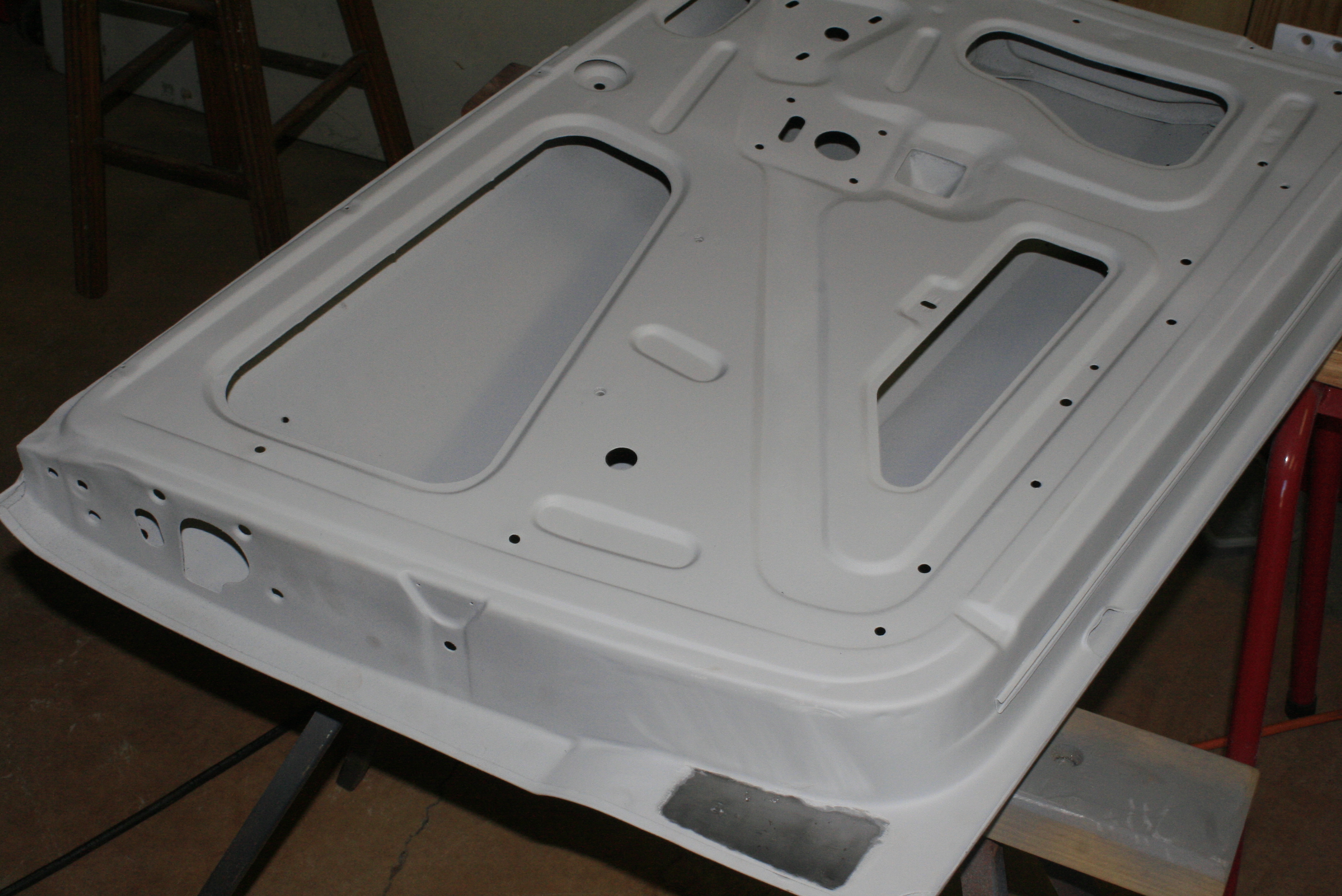

Posts: 368
.....Not Much Rust Here.....
Ted Freeman
Sun Feb 14, 2016 4:12 am
Posts: 368
......The Other Side......
Ted Freeman
Sun Feb 14, 2016 4:14 am

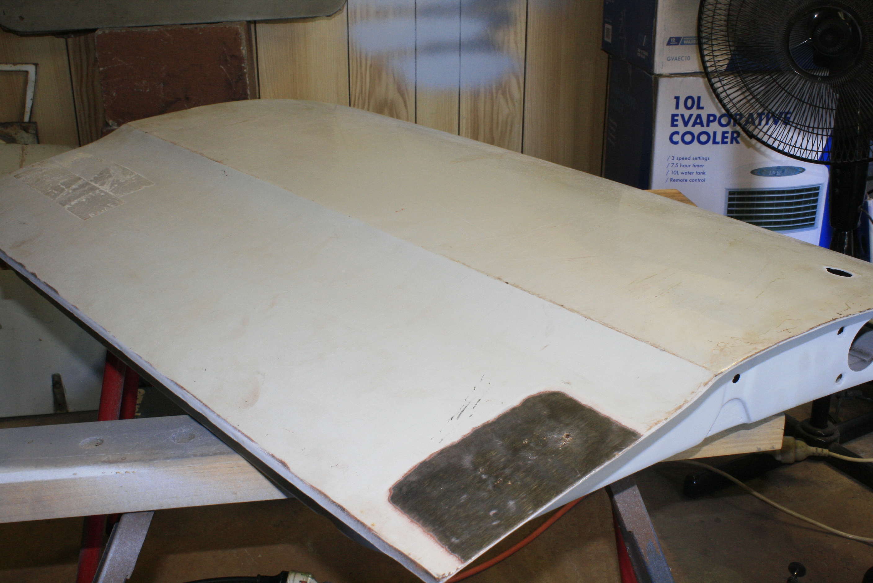

Posts: 368
.......Nor' Much Rust Here Either Yet There Is A Bulge Between The Inner Skin & The Outer Skin Where The Rust Is, The Rust Is Minor On The Visible Sides Of The Skin Yet The Two Inner Hidden Sides Will Be Whats Badly Rusted Thus The Bulge From Within, So I Am Thinking About Cutting The Lot Out & Replacing It With 2x 1mm Replacement Sections About The Size Of My Palm.......
Ted Freeman
Sun Feb 14, 2016 4:27 am

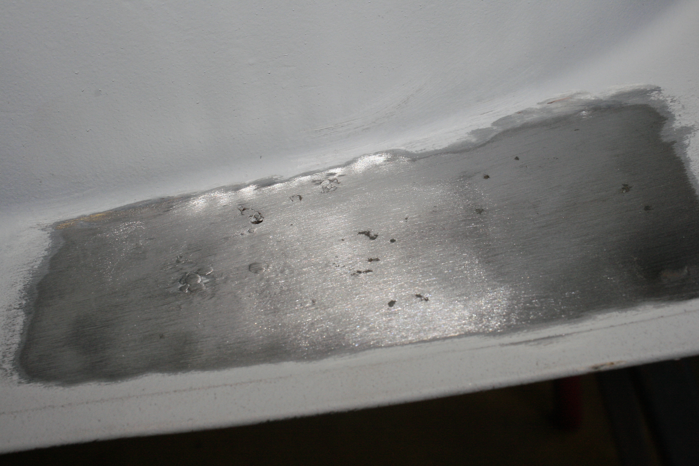

Posts: 368
.I Mark Out Where To Cut & I Also Stick Within The Line When Cutting.
Ted Freeman
Sun Feb 14, 2016 8:47 am
