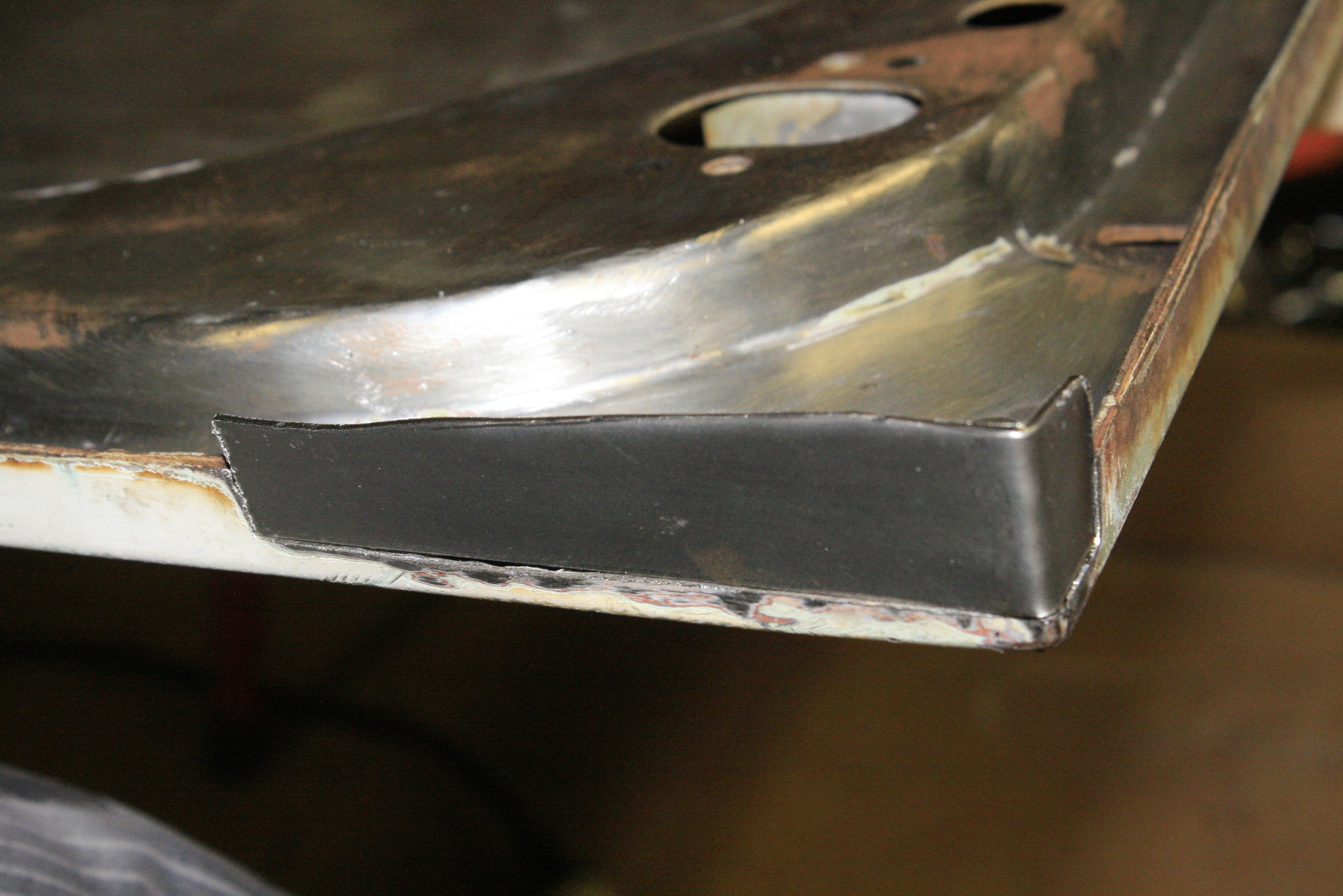

you might consider treating the inside of the panels to 'kill' or Neutralize that rust.
In the past I have used a Mollasses bath but a good auto paint shop might advise what to use.

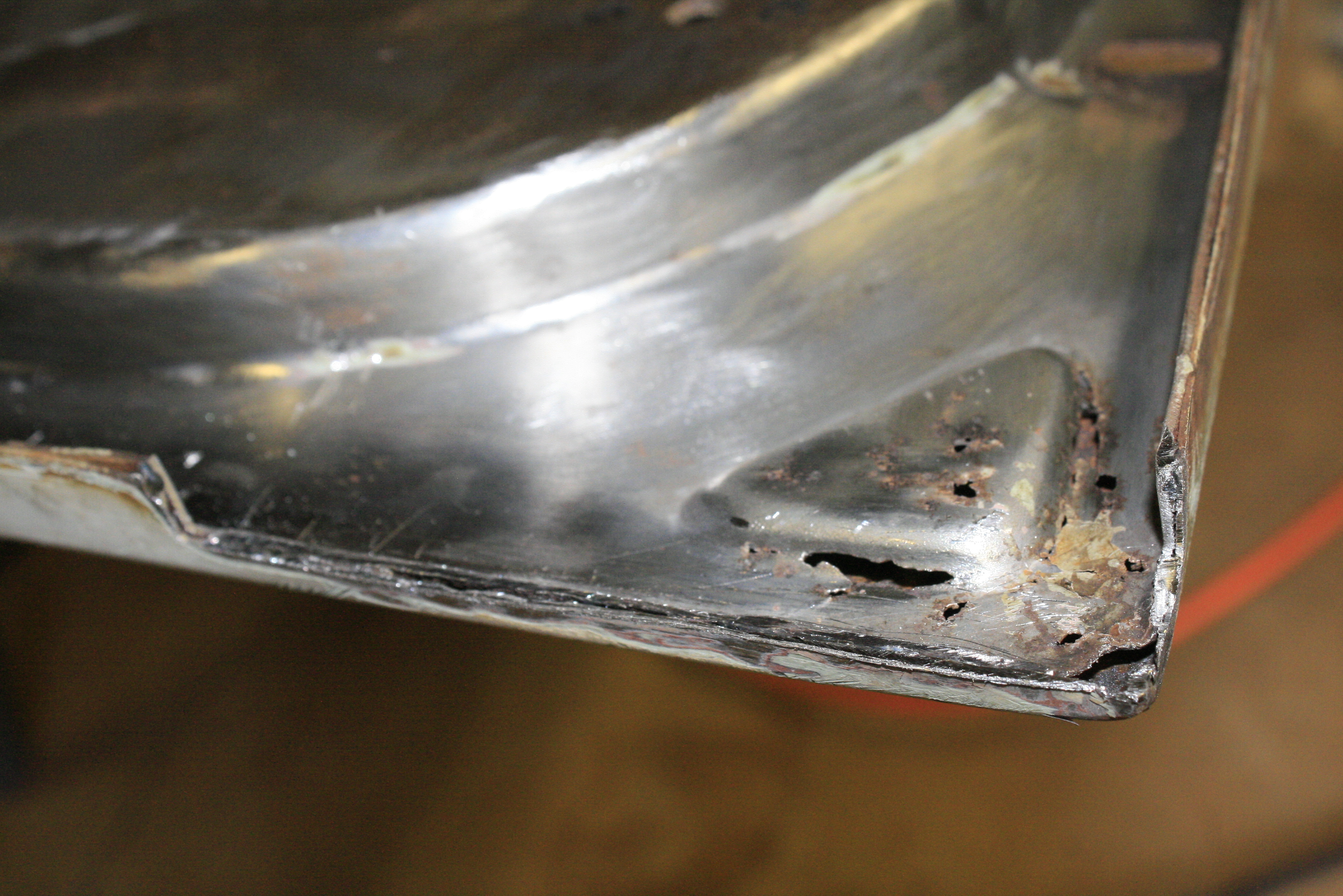

.Before Welding In The Replacement Section I Had To Clean Things Up Within (Not Easy) I Seem To Cause More Damage Then Original Burning Out The Wafer Rust Sections Until The Metals Fuse & By The Time It's Painted I Hope To Have No Sign Of Any Rust Repair's.
Ted Freeman
Sun Feb 07, 2016 3:20 am

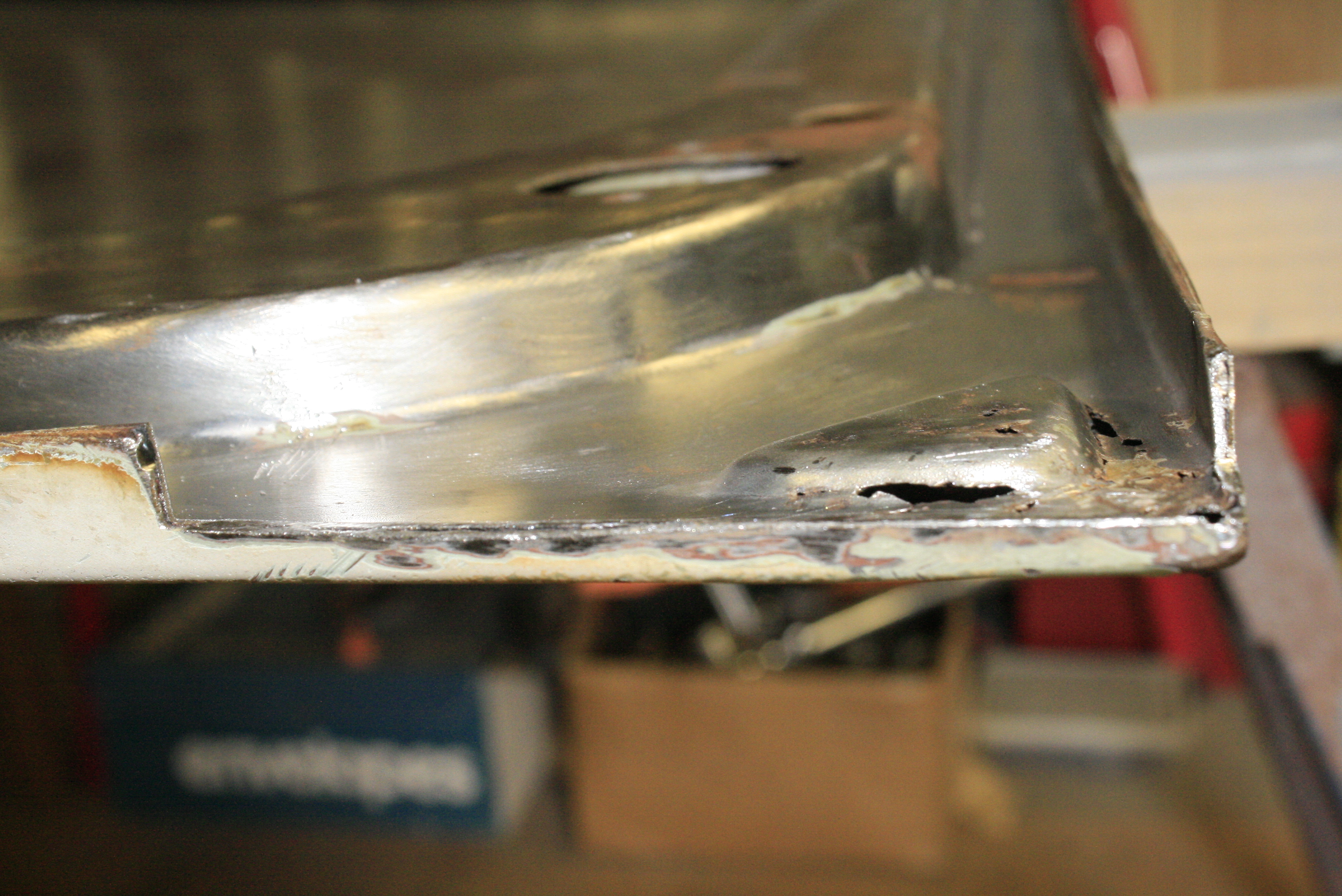

Posts: 368
..The New Section Welded In..
Ted Freeman
Sun Feb 07, 2016 3:22 am

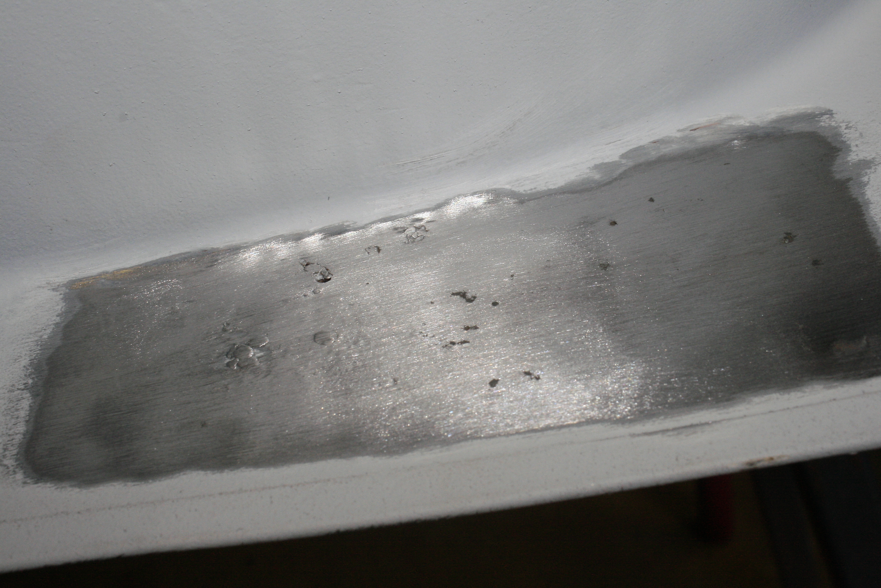

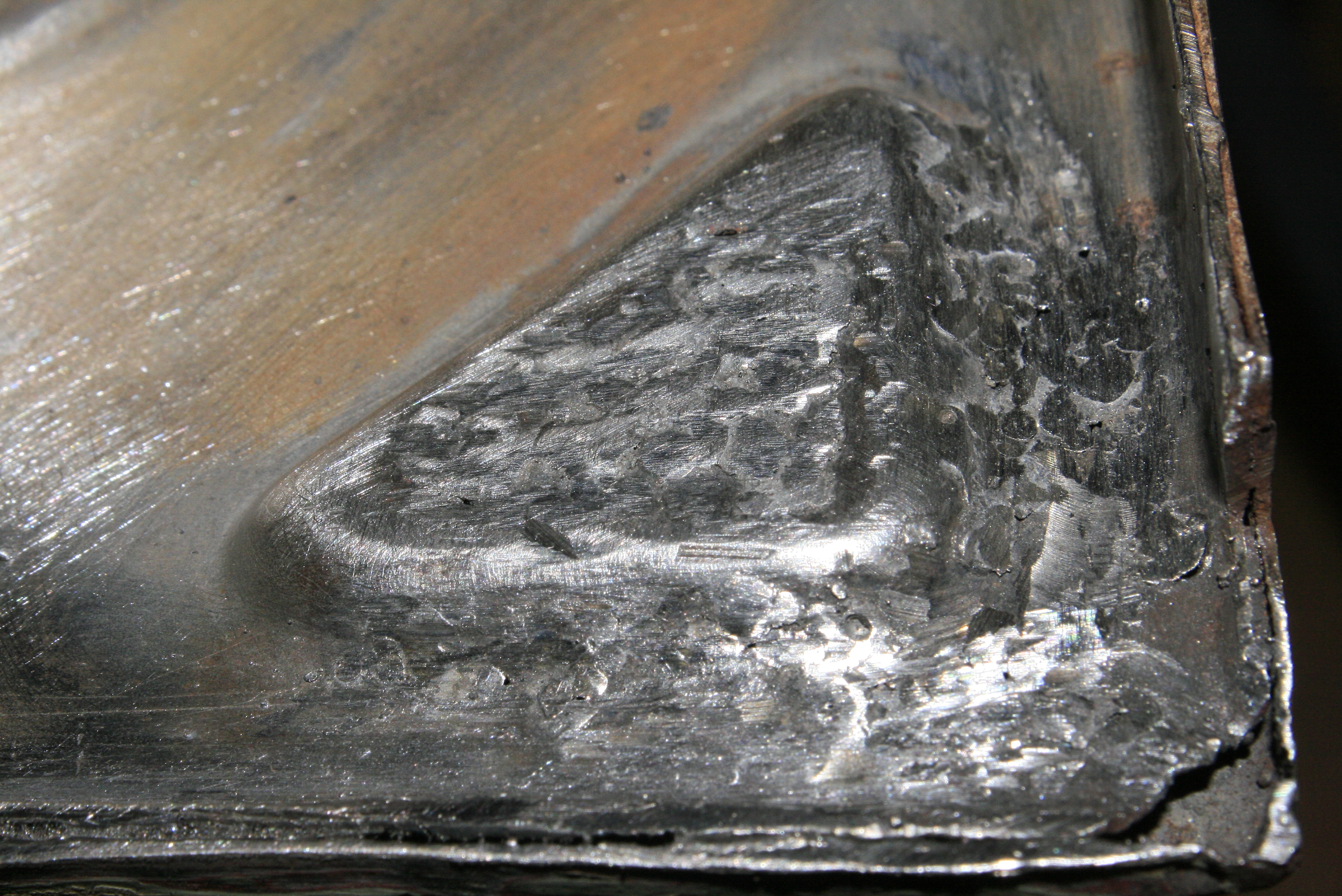

...Dad & I Bought A Nibbler That Goes With Any Drill, The Metal Will Bend While Being Cut With The Nibbler & Also When Welding, So Alignment Is Needed, A Simple Metal Working Dolly & Hammer Will Tap Things Straight Again...
Ted Freeman
Sun Feb 07, 2016 3:29 am
Posts: 368
....Grind It All Back & Hay Presto, Instant Panel Replacement....
Ted Freeman
Sun Feb 07, 2016 3:31 am
That is pretty sweet, fellas. A lot if work, but a nice result.
Enjoying the updates, thanks.

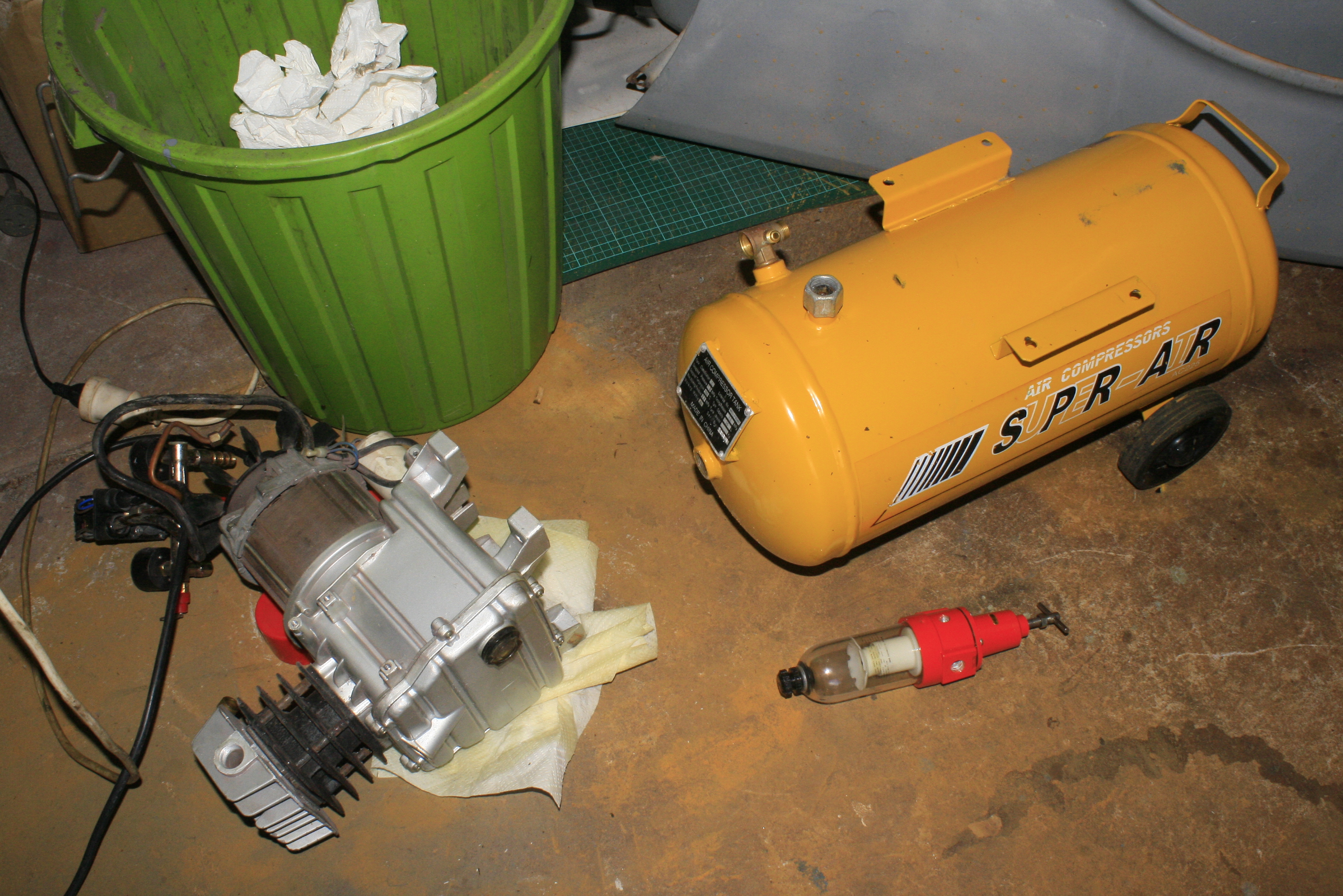

.Dad & I Needed To Clean Out The Air-Compressor As I Put The Wrong Oil In It & Dad Had Not Released The Valve On The Bottom Of The Tank In 15 Years (It Was Quite Interesting To Say The Least).

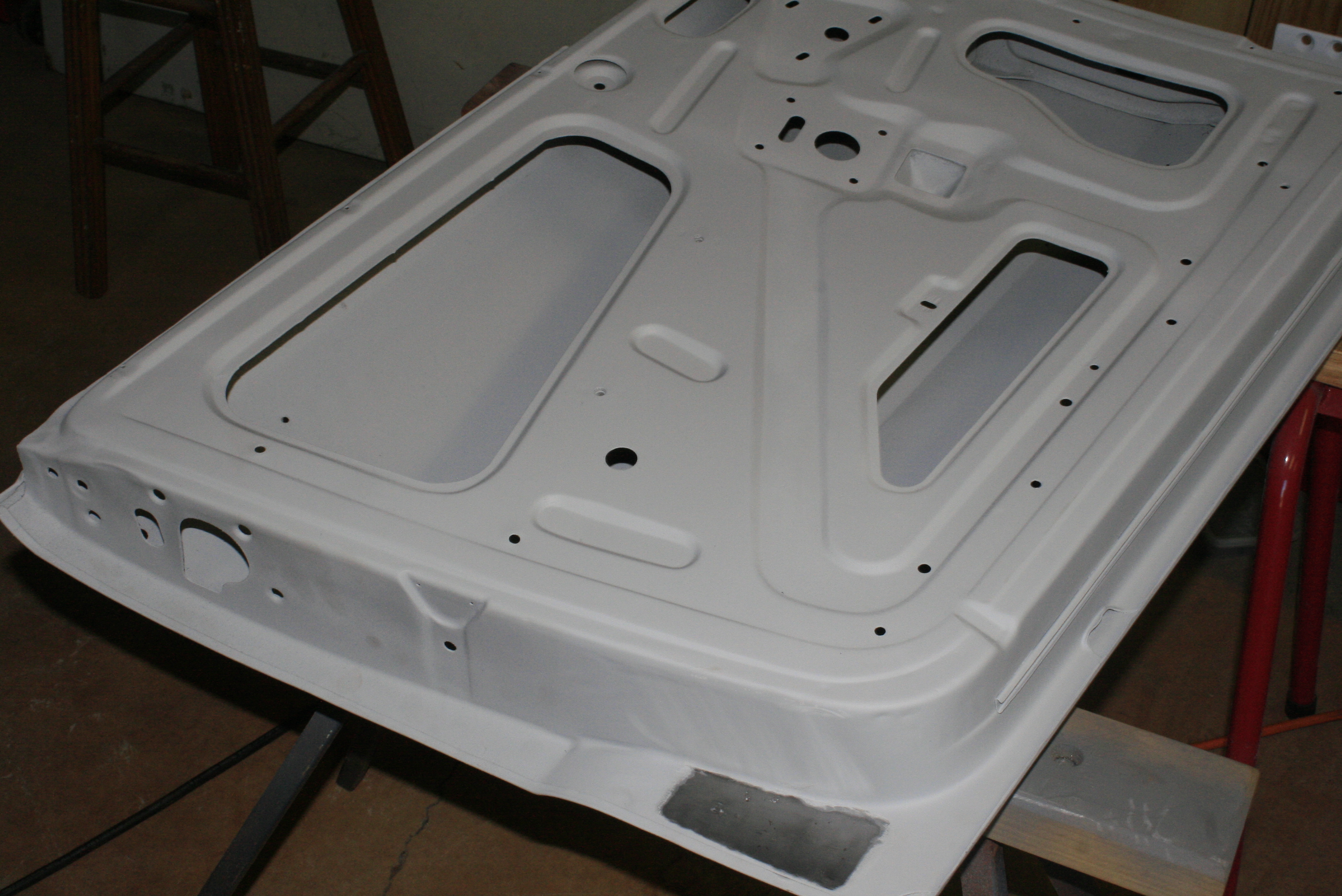

..Dad Is Working On The Back Left Door As It Will Be Next In-Line For Restoration..

....Some Back-Trackin' Here As I Aim To Fix The Rust....

.....Not Much Rust Here.....

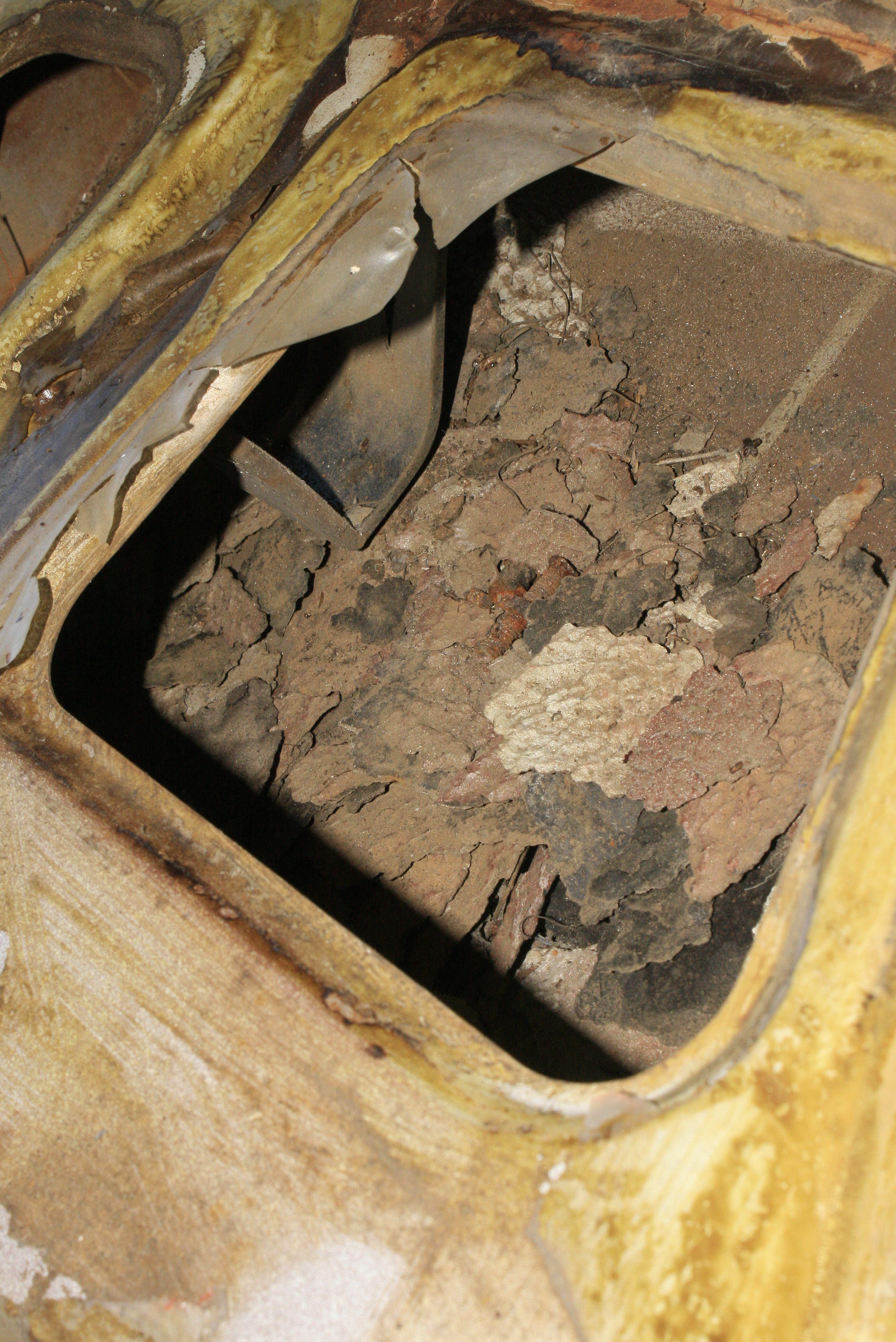

.......Nor' Much Rust Here Either Yet There Is A Bulge Between The Inner Skin & The Outer Skin Where The Rust Is, The Rust Is Minor On The Visible Sides Of The Skin Yet The Two Inner Hidden Sides Will Be Whats Badly Rusted Thus The Bulge From Within, So I Am Thinking About Cutting The Lot Out & Replacing It With 2x 1mm Replacement Sections About The Size Of My Palm.......

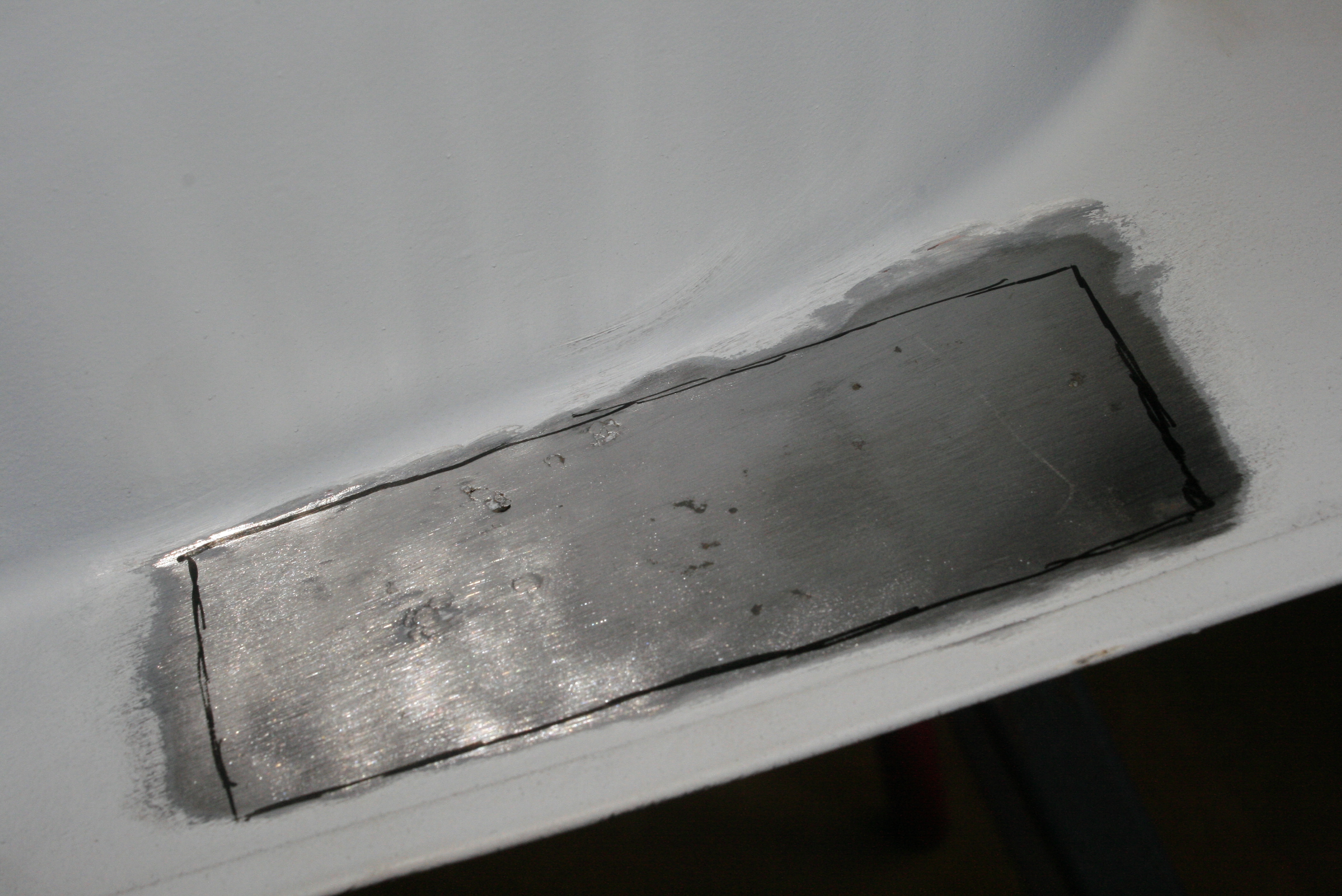

Posts: 368

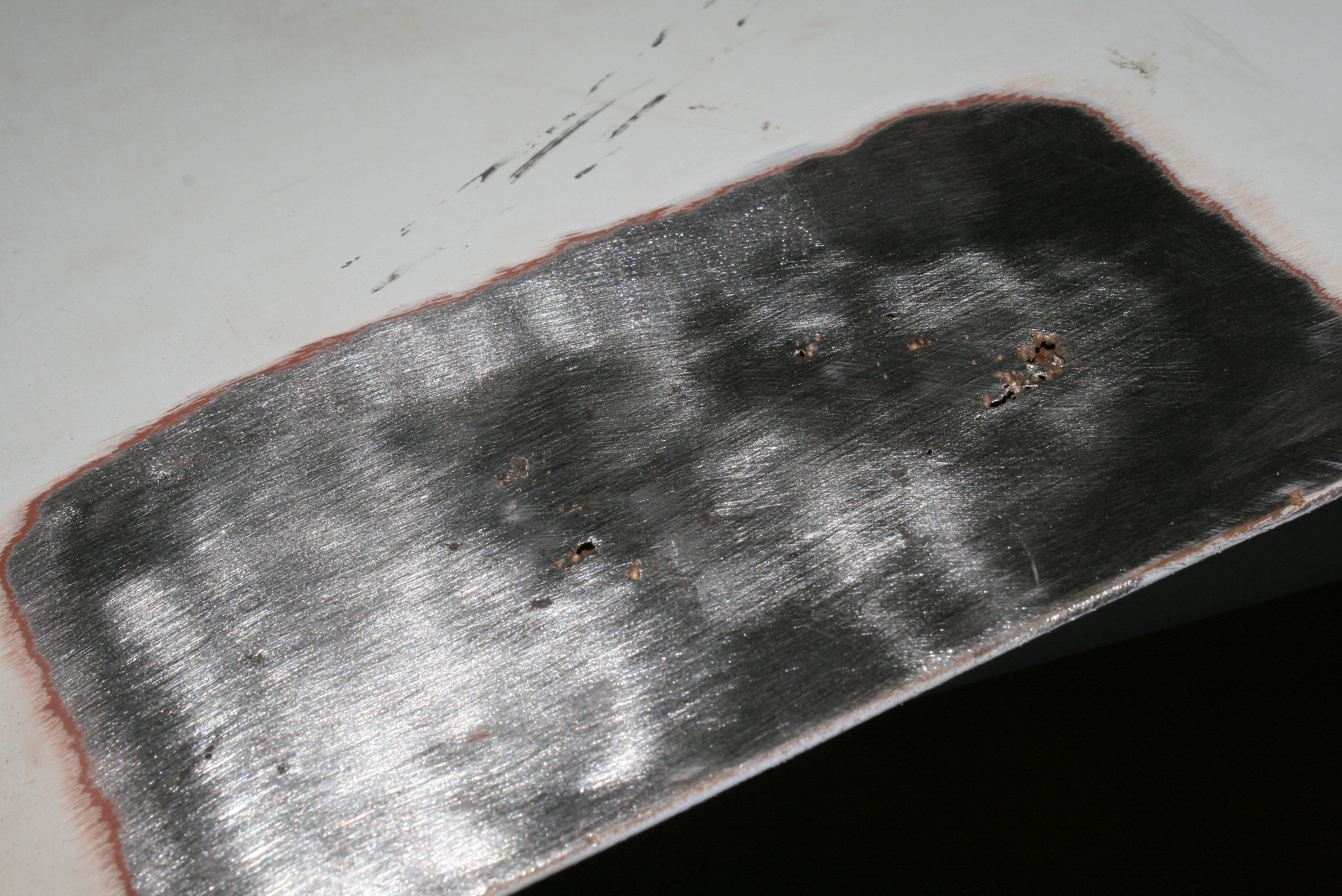

.I Mark Out Where To Cut & I Also Stick Within The Line When Cutting.
