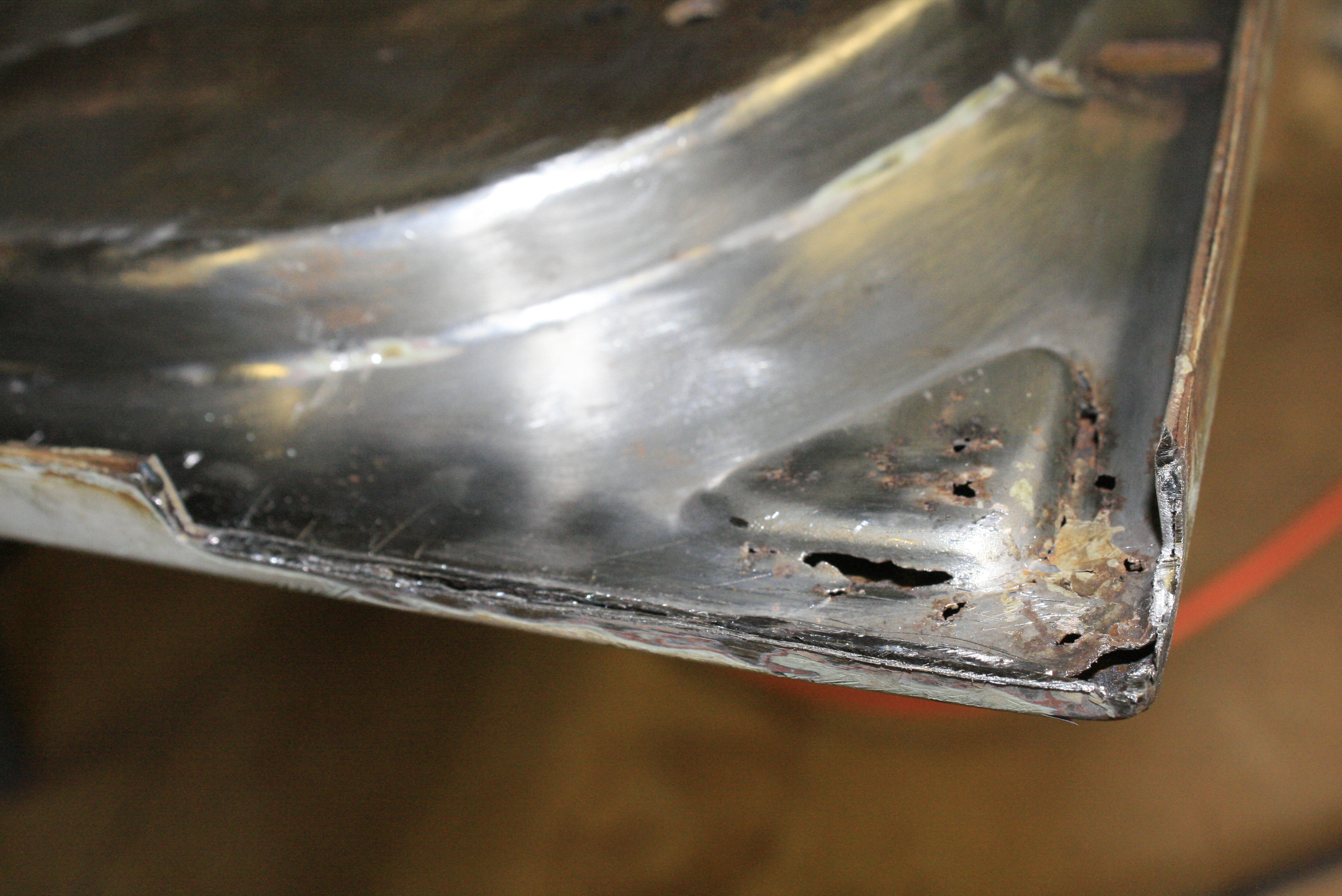

.Before Welding In The Replacement Section I Had To Clean Things Up Within (Not Easy) I Seem To Cause More Damage Then Original Burning Out The Wafer Rust Sections Until The Metals Fuse & By The Time It's Painted I Hope To Have No Sign Of Any Rust Repair's.

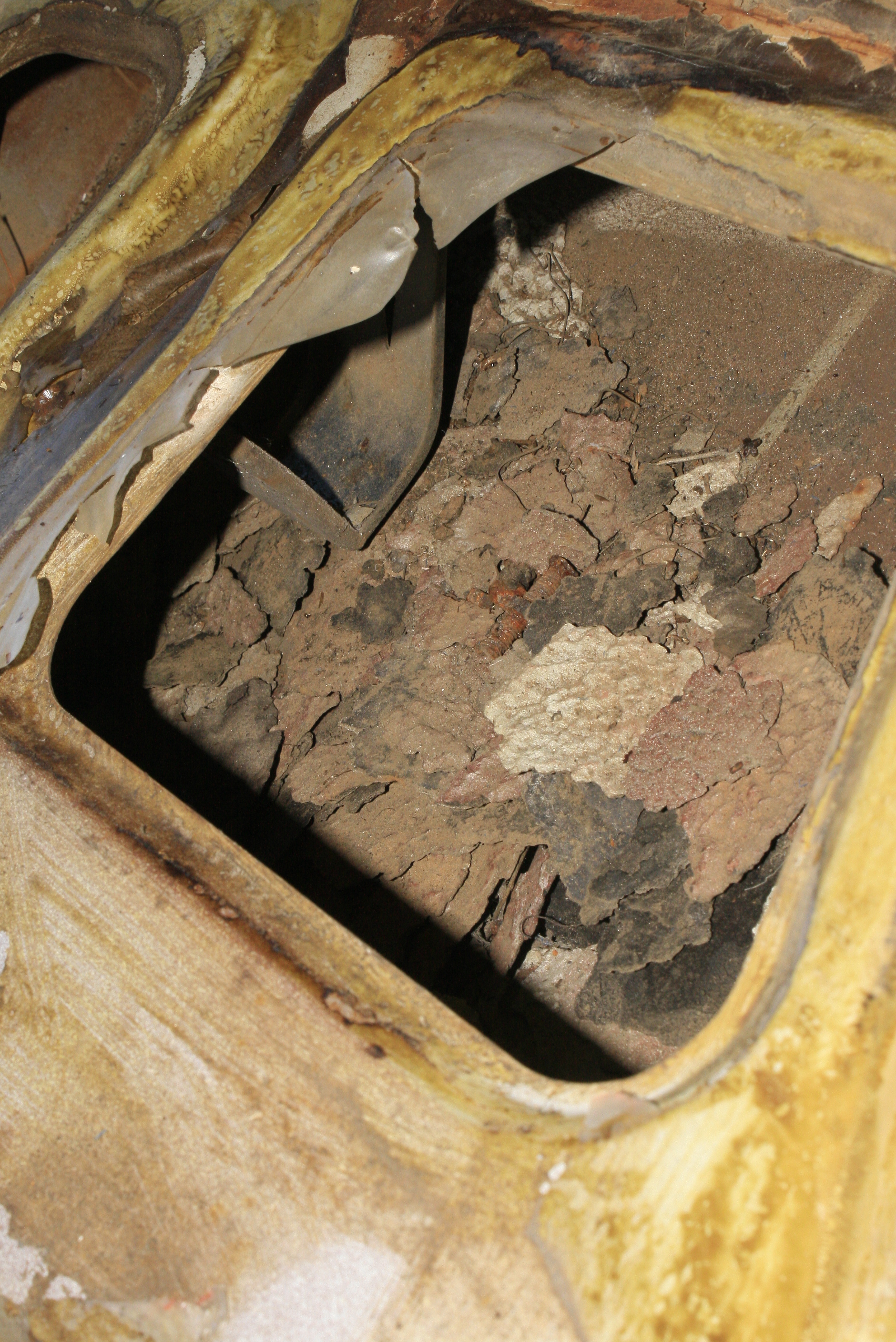

...There Is So Much Crap Within, But Justice Will Be Done...
