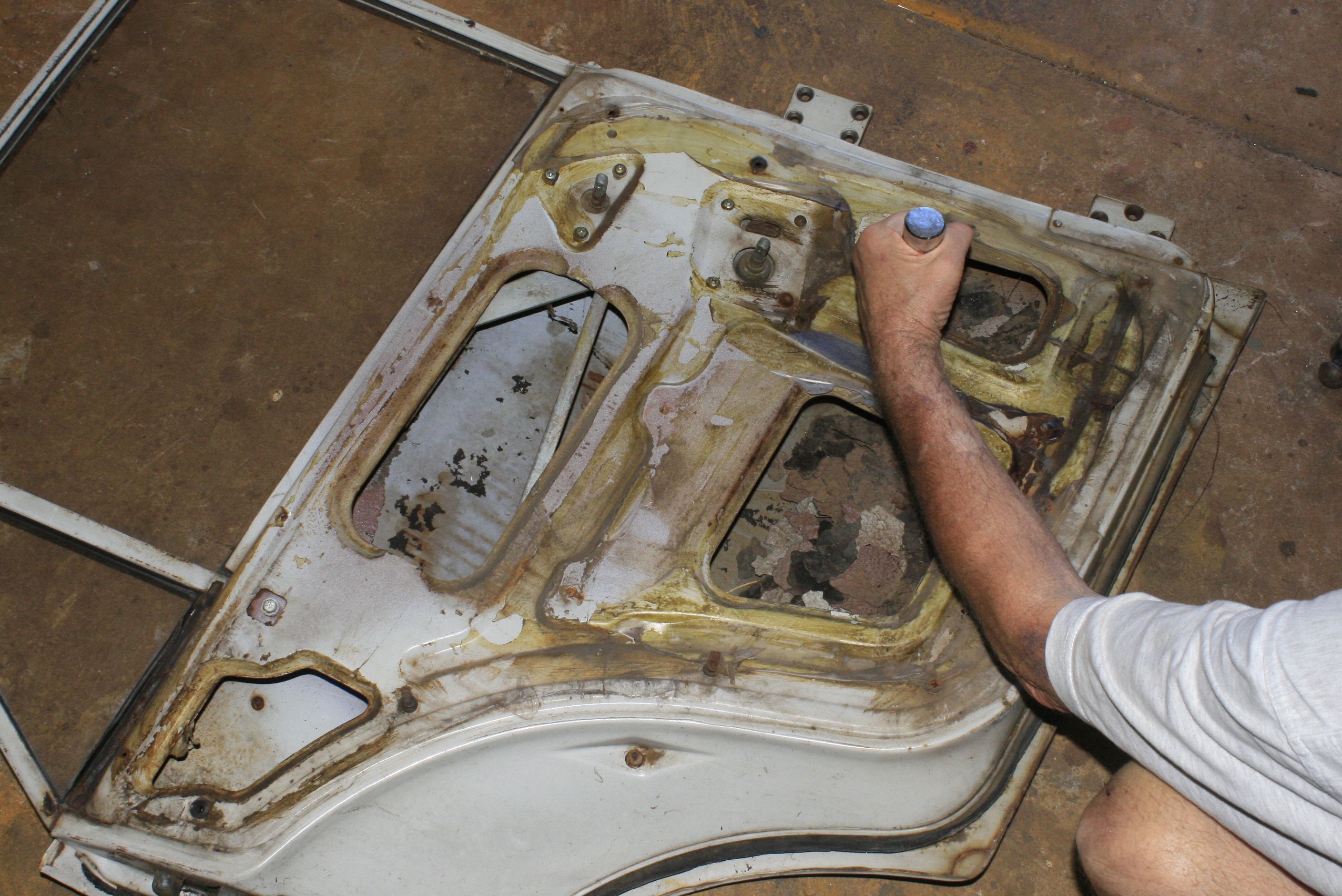

Posts: 368
..Dad Is Working On The Back Left Door As It Will Be Next In-Line For Restoration..
Ted Freeman
Sun Feb 14, 2016 4:02 am
Posts: 368
...There Is So Much Crap Within, But Justice Will Be Done...

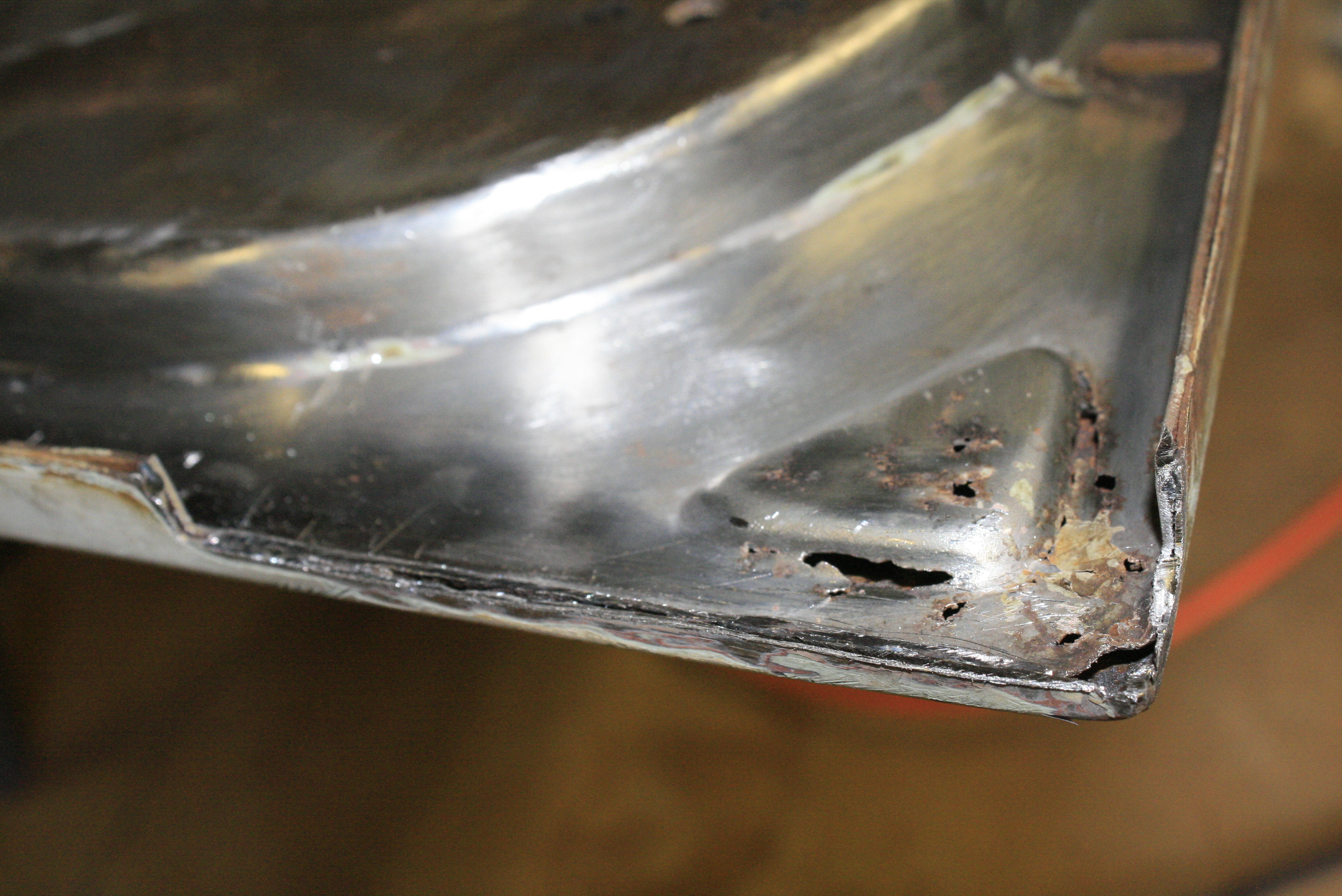

Posts: 368
.......Nor' Much Rust Here Either Yet There Is A Bulge Between The Inner Skin & The Outer Skin Where The Rust Is, The Rust Is Minor On The Visible Sides Of The Skin Yet The Two Inner Hidden Sides Will Be Whats Badly Rusted Thus The Bulge From Within, So I Am Thinking About Cutting The Lot Out & Replacing It With 2x 1mm Replacement Sections About The Size Of My Palm.......
