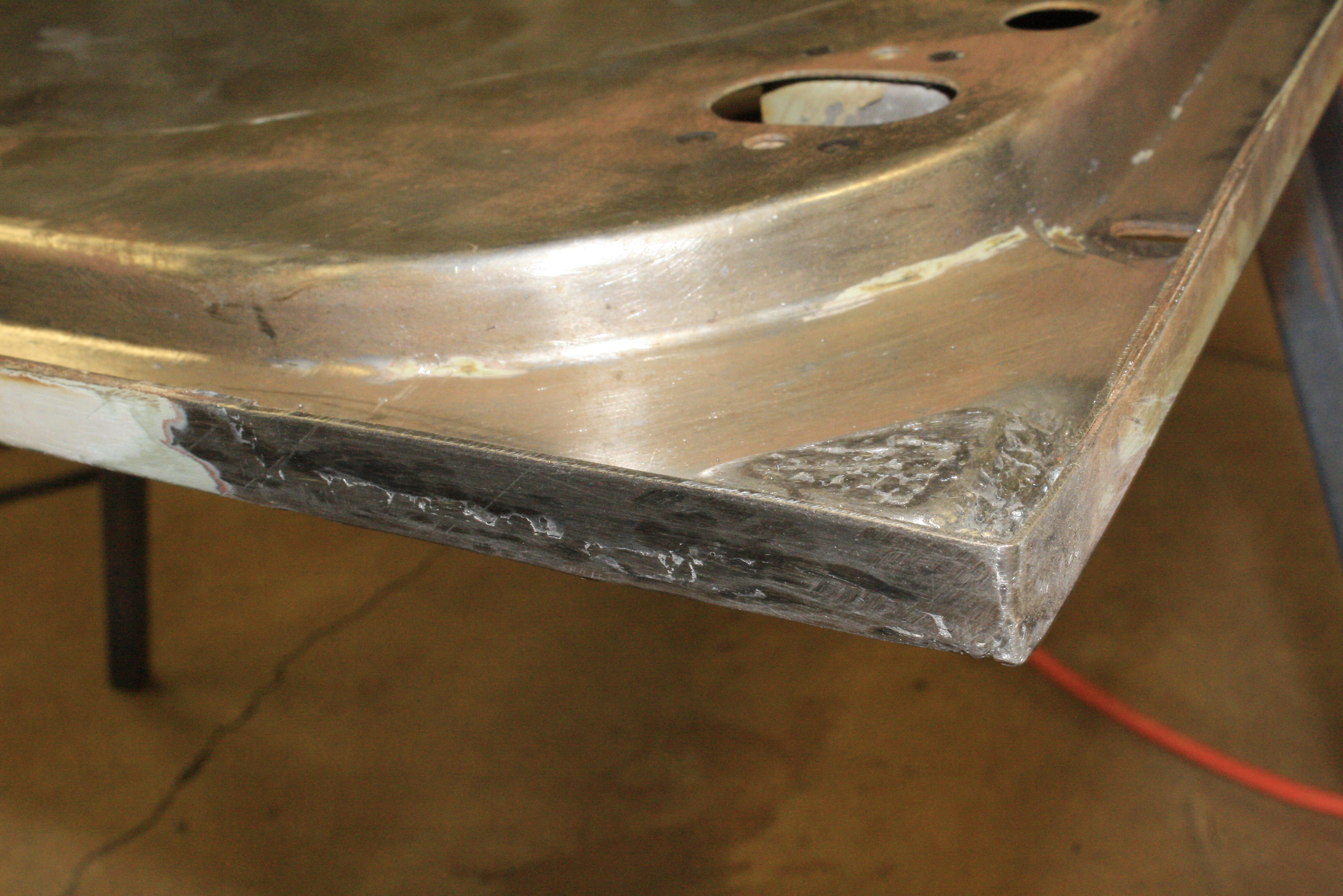

Posts: 368
..The New Section Welded In..
Ted Freeman
Sun Feb 07, 2016 3:22 am
Posts: 368
...Dad & I Bought A Nibbler That Goes With Any Drill, The Metal Will Bend While Being Cut With The Nibbler & Also When Welding, So Alignment Is Needed, A Simple Metal Working Dolly & Hammer Will Tap Things Straight Again...
Ted Freeman
Sun Feb 07, 2016 3:29 am
Posts: 368
....Grind It All Back & Hay Presto, Instant Panel Replacement....
Ted Freeman
Sun Feb 07, 2016 3:31 am

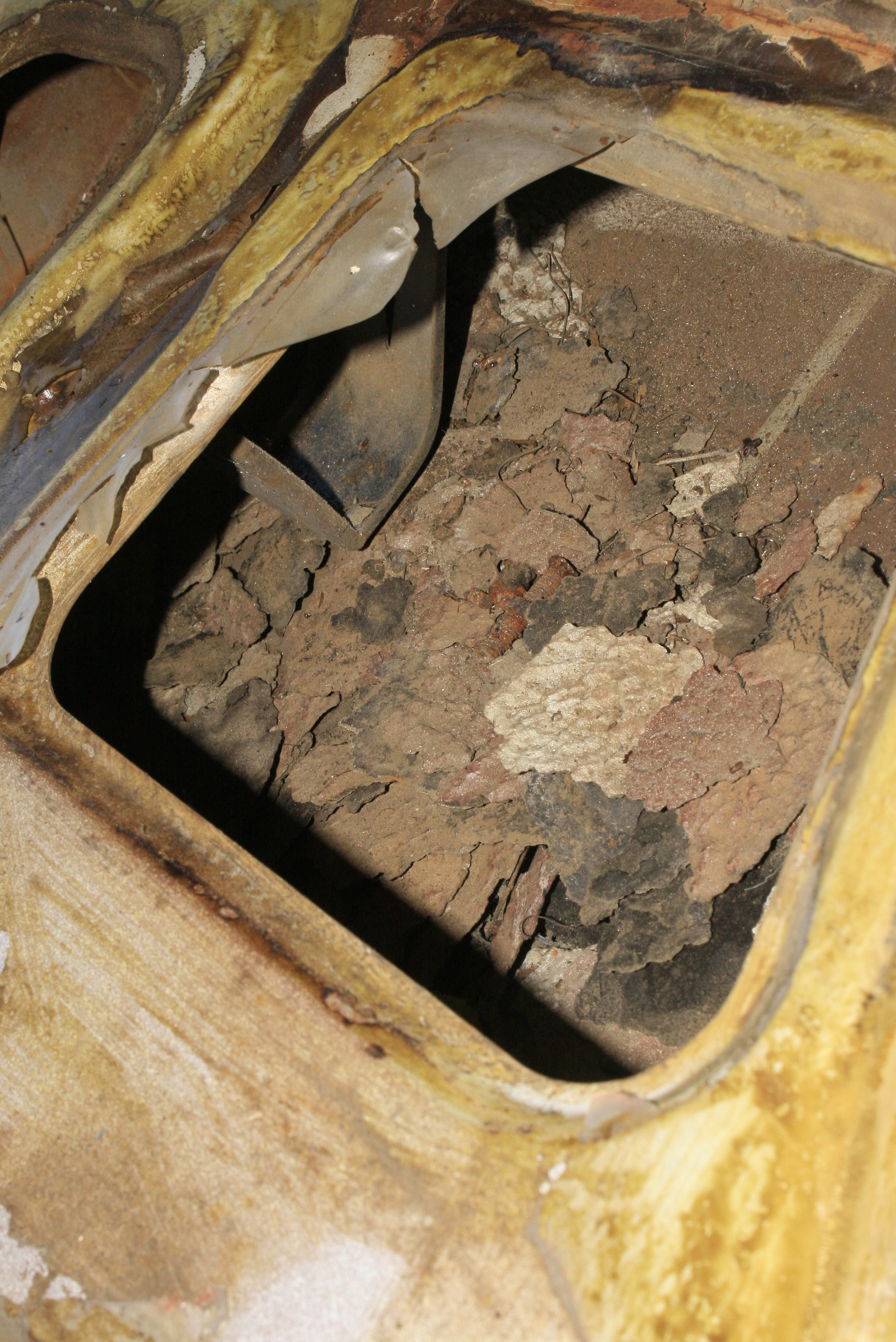

Posts: 368
...There Is So Much Crap Within, But Justice Will Be Done...
Ted Freeman
Sun Feb 14, 2016 4:05 am

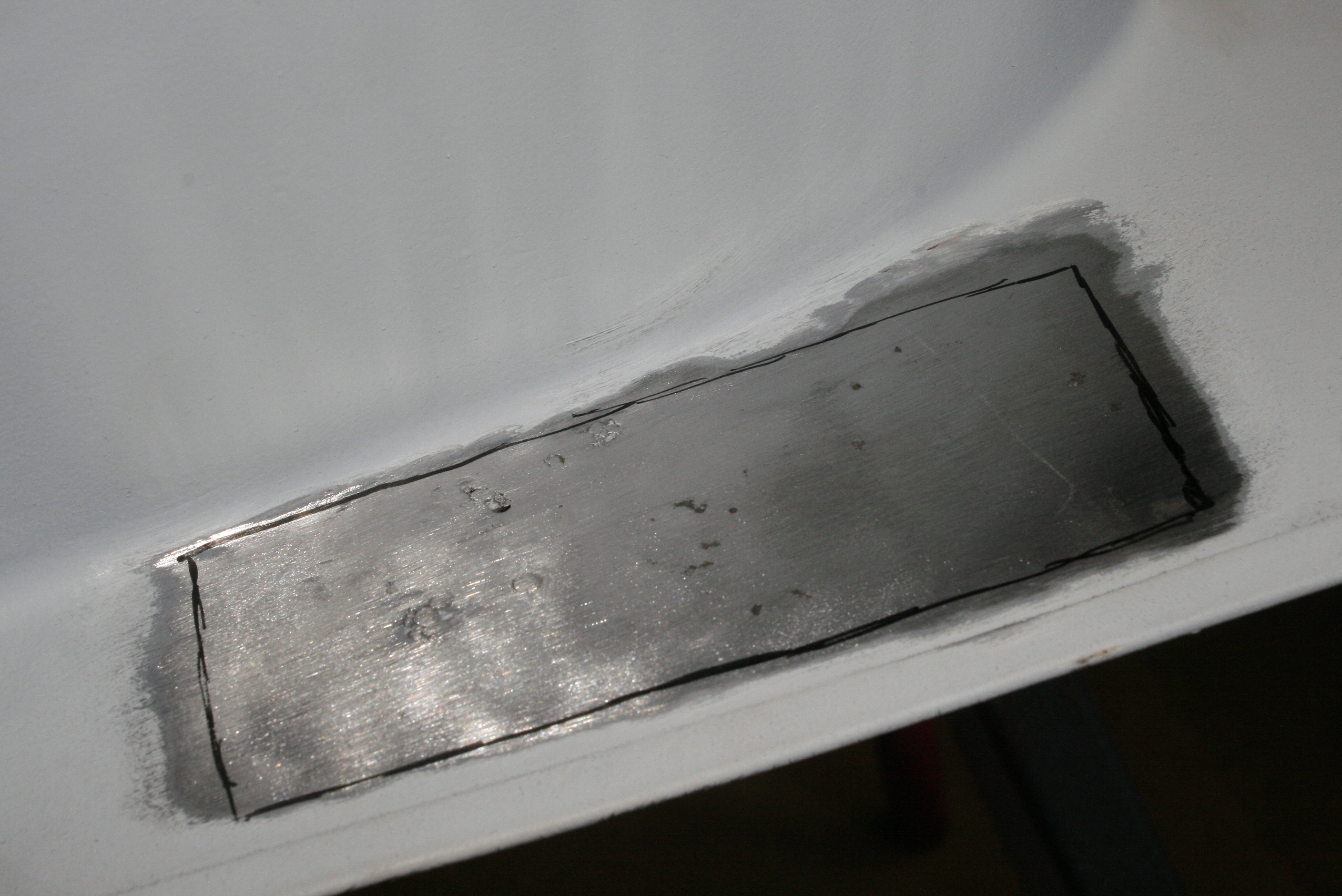

Posts: 368
.I Mark Out Where To Cut & I Also Stick Within The Line When Cutting.
Ted Freeman
Sun Feb 14, 2016 8:47 am
