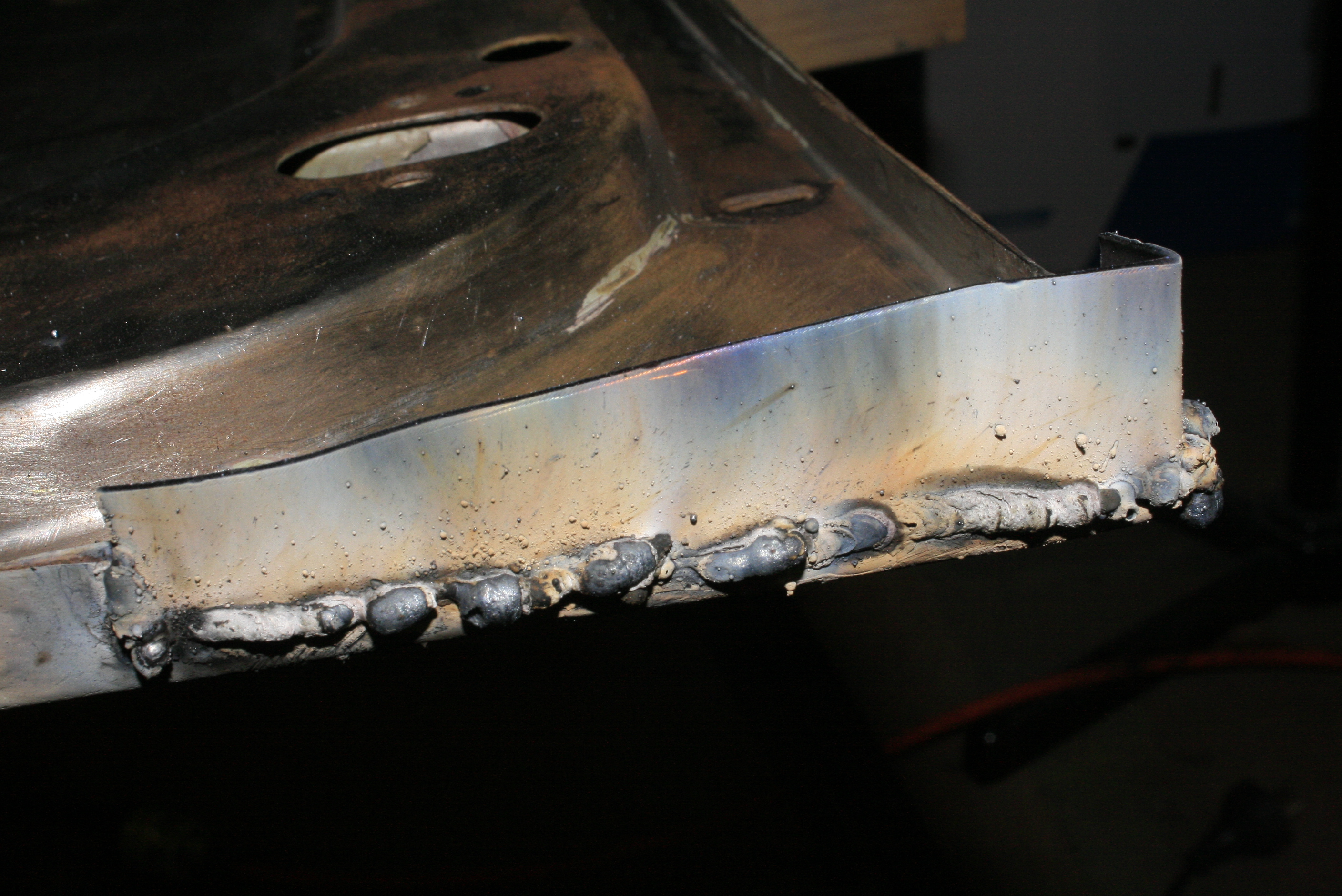

Posts: 368
..The New Section Welded In..

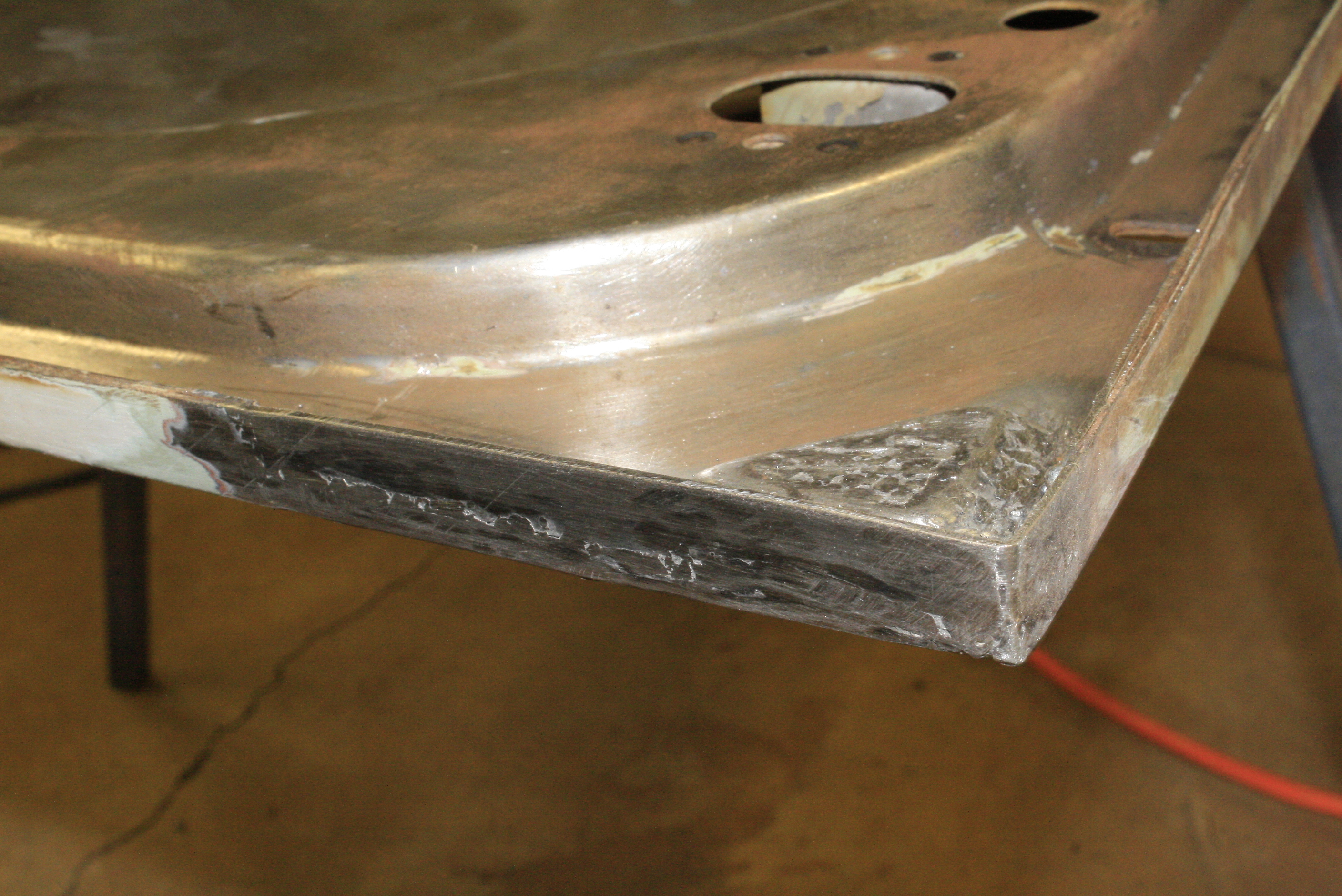

Posts: 368
...Dad & I Bought A Nibbler That Goes With Any Drill, The Metal Will Bend While Being Cut With The Nibbler & Also When Welding, So Alignment Is Needed, A Simple Metal Working Dolly & Hammer Will Tap Things Straight Again...

Posts: 368
....Grind It All Back & Hay Presto, Instant Panel Replacement....

That is pretty sweet, fellas. A lot if work, but a nice result.
Enjoying the updates, thanks.

Posts: 368
I'm getting it easy, my main involvement has been dismantling the car, Michael is doing all the body work, self teaching as he goes, not bad for someone who had never held a welder up to about two weeks ago, ambition and determination will get the project done, hope to eventually get involved in some of the club events.
Ted.

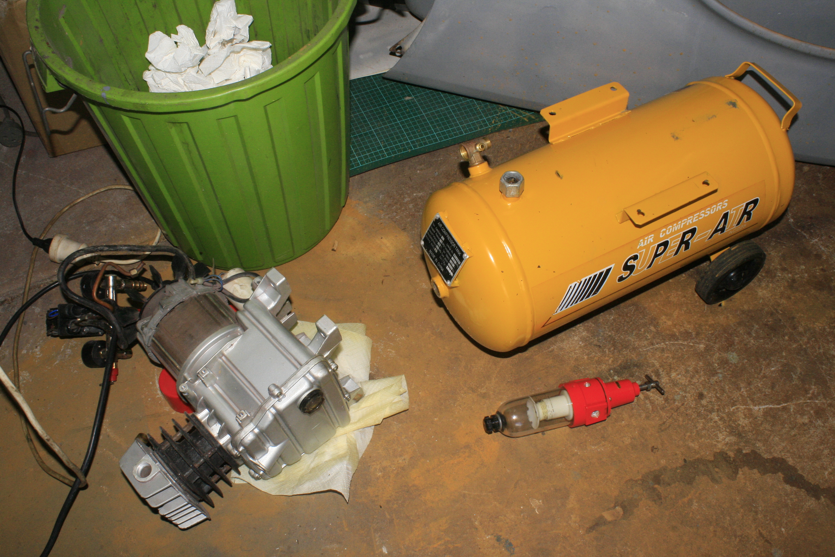

Posts: 368
.Dad & I Needed To Clean Out The Air-Compressor As I Put The Wrong Oil In It & Dad Had Not Released The Valve On The Bottom Of The Tank In 15 Years (It Was Quite Interesting To Say The Least).

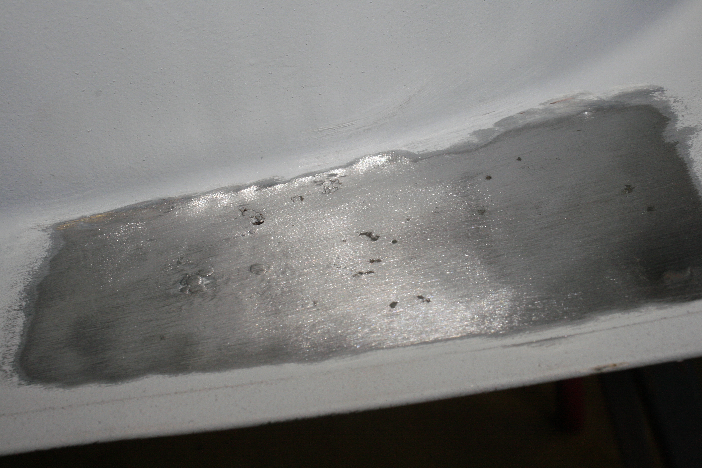

Posts: 368
.I Mark Out Where To Cut & I Also Stick Within The Line When Cutting.
