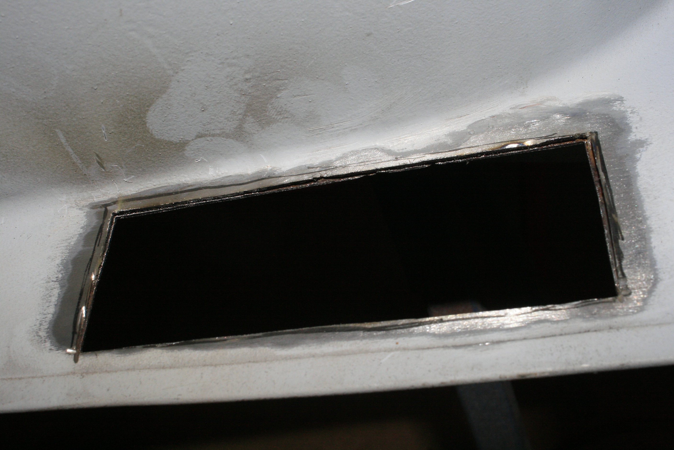

Posts: 368
..I Paid Close Attention To The Depth I Was Cutting As I Was Unsure If The Outer/Inner Skin Was Good Or Not..

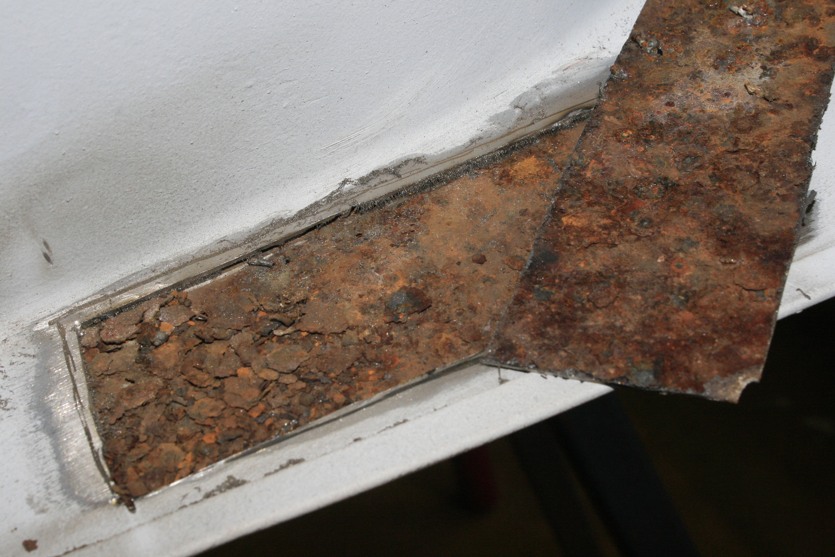

Posts: 368
...Once Cut & Pried Apart I Was Able To See Why The Bulge Was There, Plenty Of Rust Within As I Expected...
