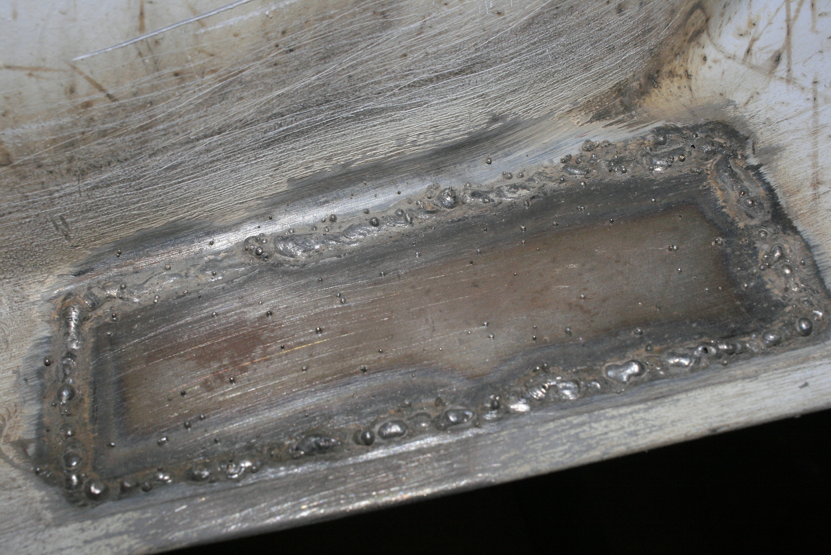

Posts: 368
......Not The Best Job I Know, It's Quite Hard To Weld & Work With Half Rusted Sheet Metal (That Being All The Bellett's Metal) But Dad's Step Idea Helped Dissipate A-Lot Of The Heat & Most Of The Welds Were Fused Correct From What I Can See But I Can Also See A-Lot Of Bad Welds (More So After The Clean Up) & A Need To Go Back Over It Again Haunts My Mind......

Posts: 368
.......After The Welds Are Sanded Back Is When I Get To Check & See If Its All Fused In Or Not, (?).......

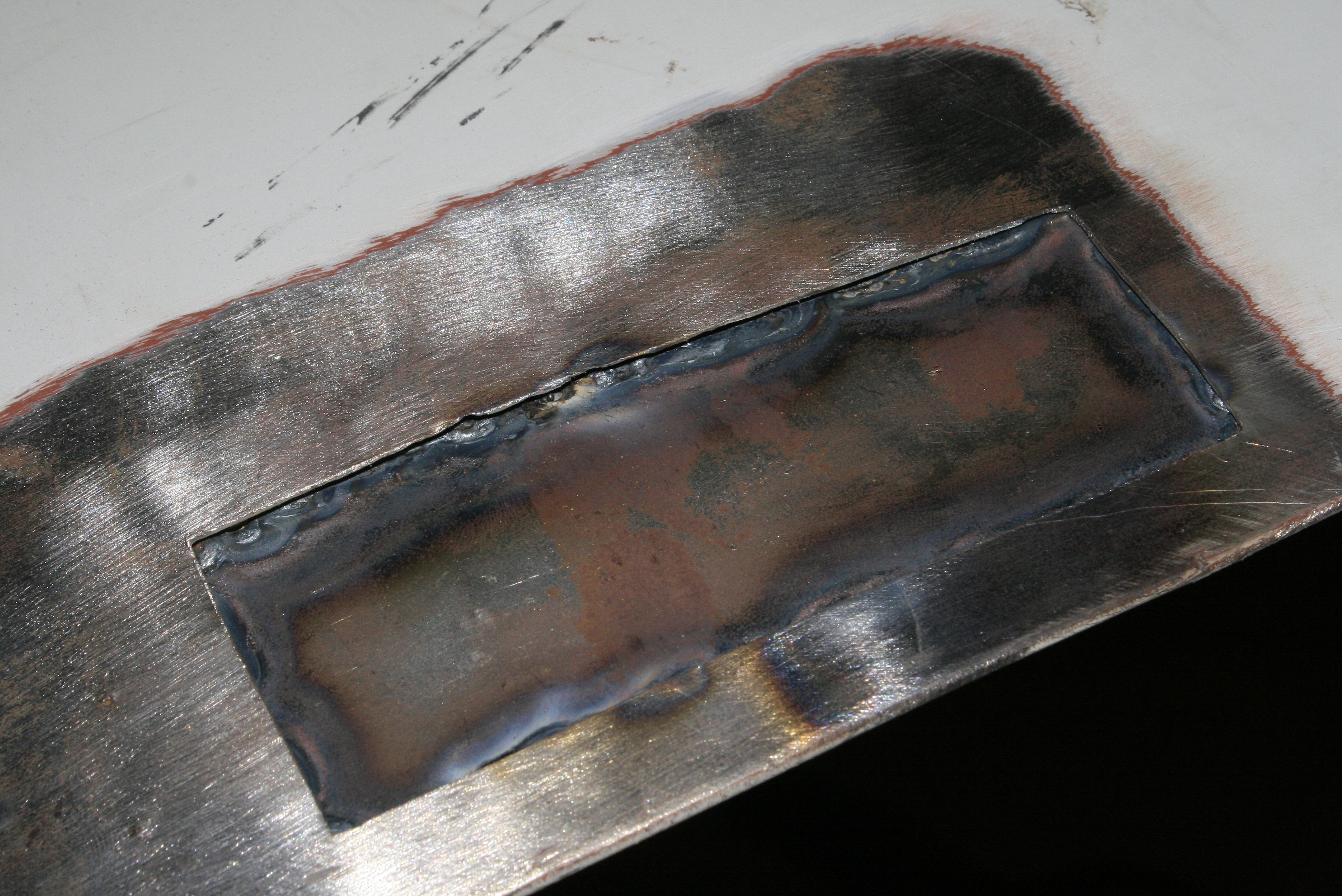

Posts: 368
........From The Other Side........

Posts: 368
.........Sizing Up The Next Bit.
I forgot To Say That On The Inside I Should Have Stripped The Paint Back Further As It Got Burnt.........
..In-Put--Techniques--Methods..Knowledge.. All Welcome ..
