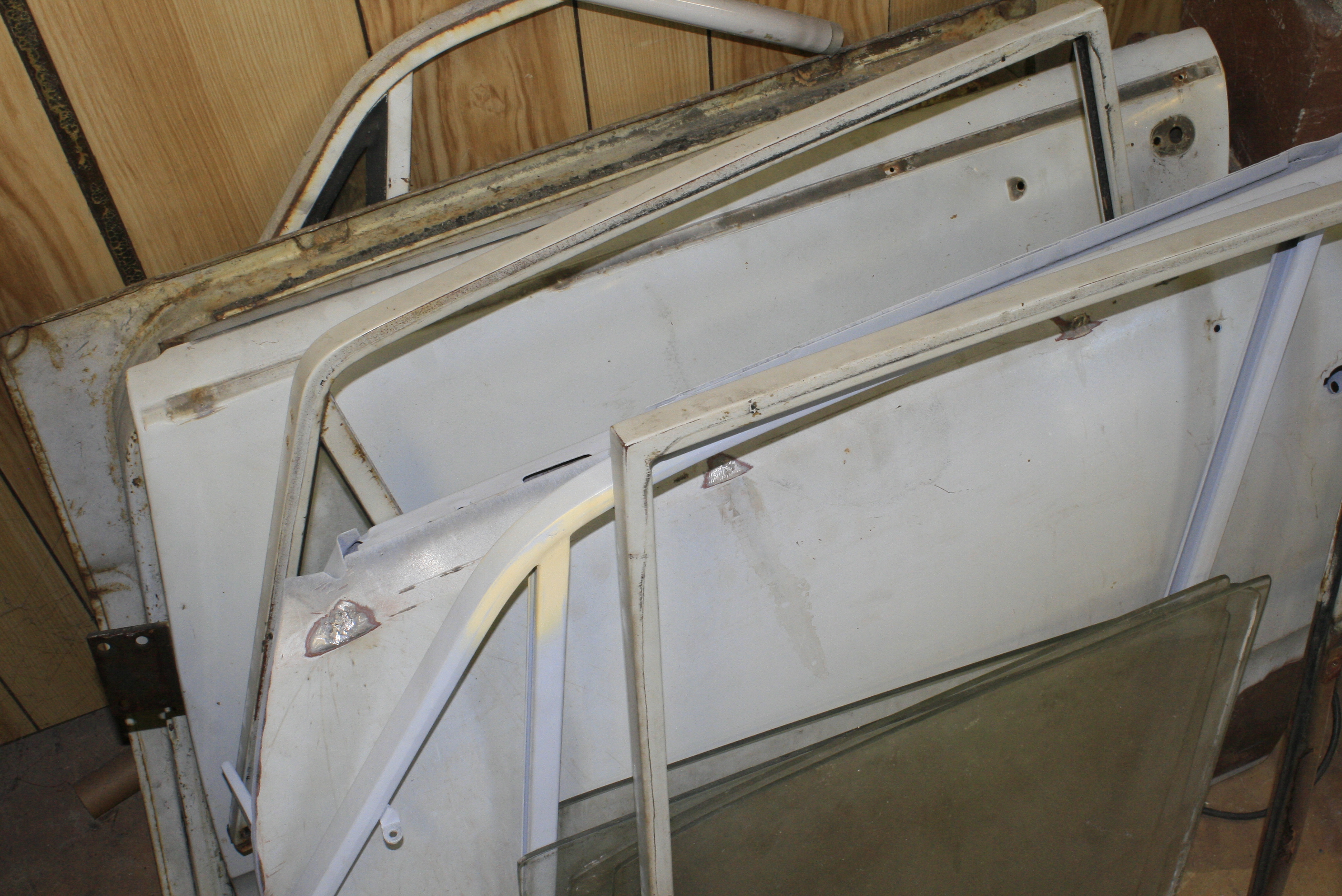

........The To Do List........

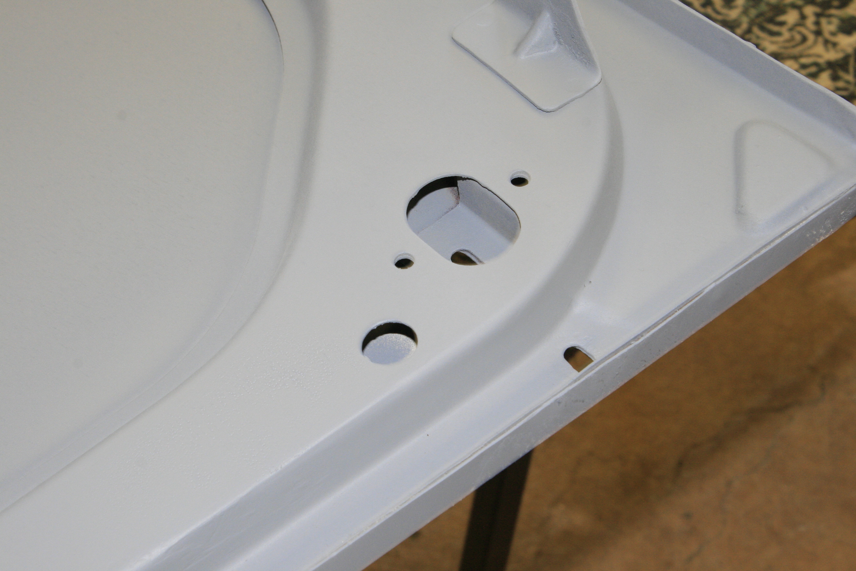

.I Did The Etch Primer With The Small Gun & Despite Looking Good On Closer Inspection I Could Still See Sparkling Of The Bare Metal Through The Etch Primer So A Thicker Coat Was Needed & A Step Up In Gun Size Was Also Needed.

..The Bigger Spray Gun Was An Absolute Delight As Up Until Now I Have Only Used The Touch-Up Gun, It Was Much Easier To Control & Set-Up..

...The Big Gun Was Easy To Dial In & The 50/50 Overlap Was A Lot More Achievable With It Compared To The Touch-Up Gun...

....So From Now On I Will Continue To Use The Small Gun For The First Coat As It Is Pretty Good With The Tight Spots & Then I Will Let That Dry & Use The Big Primer Gun For A Thicker Wetter Coat....

......I Really Enjoyed Using The Large Spray Gun, The Results Are Far More Rewarding......
