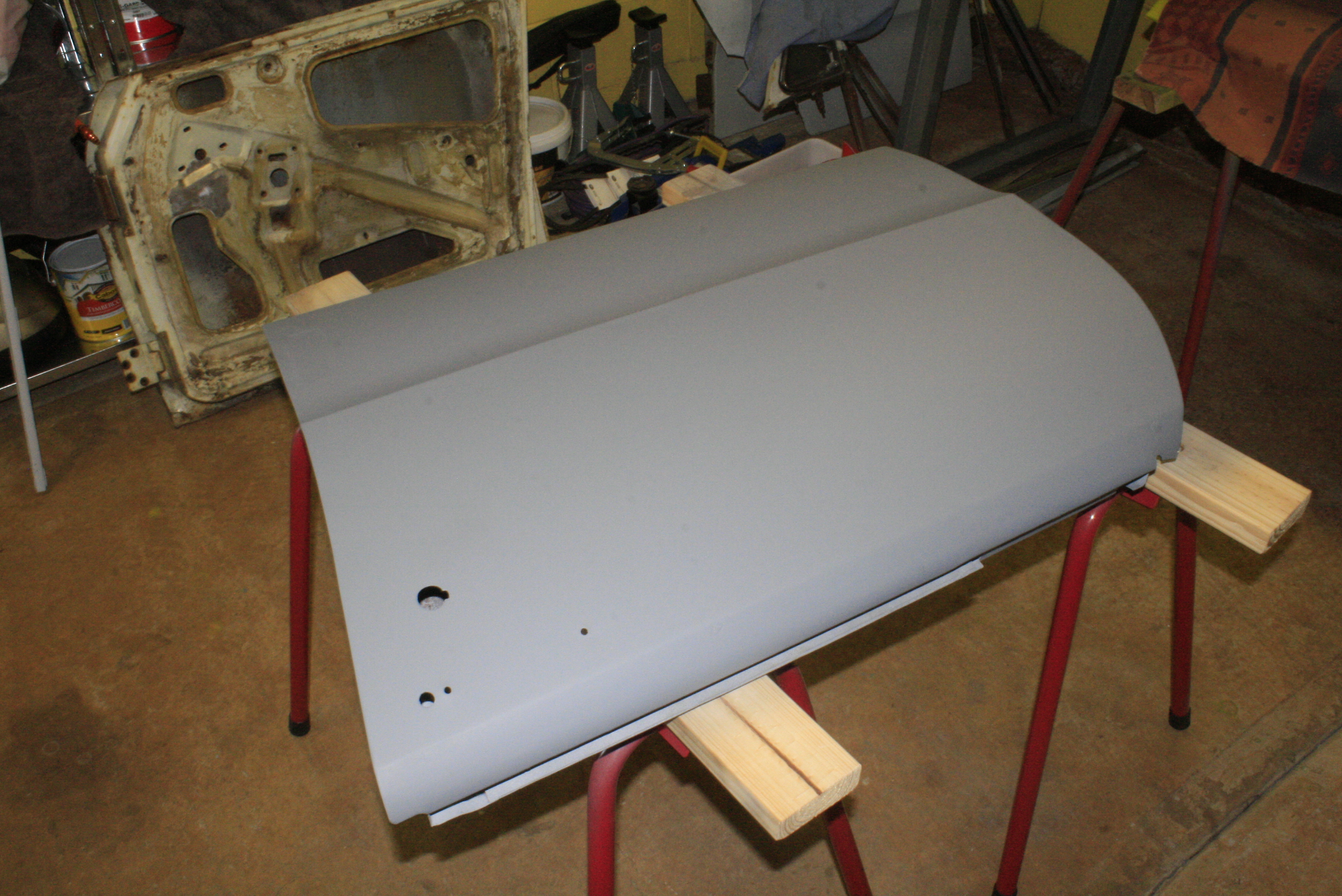

......Time For Etch-Primer, Now Despite The Advise Of Applying The Etch-Primer In A Mist Coat Dad & I Have Opted For The Wet Coat Method As It Allow Us More Room To Play When Wet & Dryin' The High N' Low Spots Out & Once It's All Smoothed Out We Will Touch Up The Etch-Primer So To Cover The Bare Metal & Move To The Priming From There With Peace Of Mind That We Should Have A Smooth As Surface Well That's The Plan Which Is Working Thuss Far......

.......Dad'Z Been Doing All The Wet & Dry Sanding To Get All The High & Low Spots Out As He Has More Of An Eye For That Sort Of Thing - It's Been A Repeat Process Over & Over Again Very Methodical Approach Dad Has Towards It Which Is Bringing Out A Lovely Surface To Paint On.......

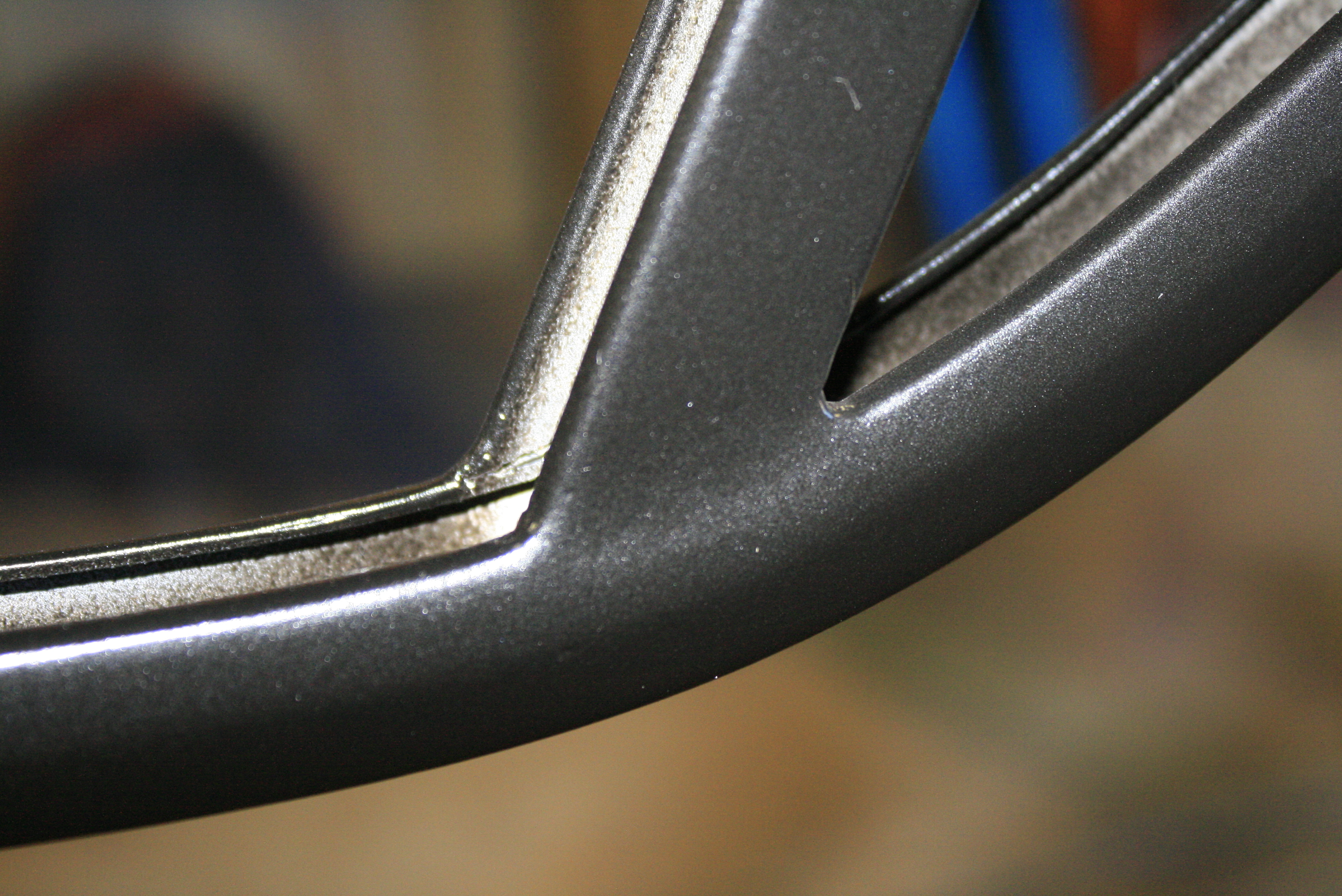

...It Was Hard To Get The Paint Over All The Surfaces Inside The Door, So Some Touching Up Will Be Done Before The Clear Coat Goes On...

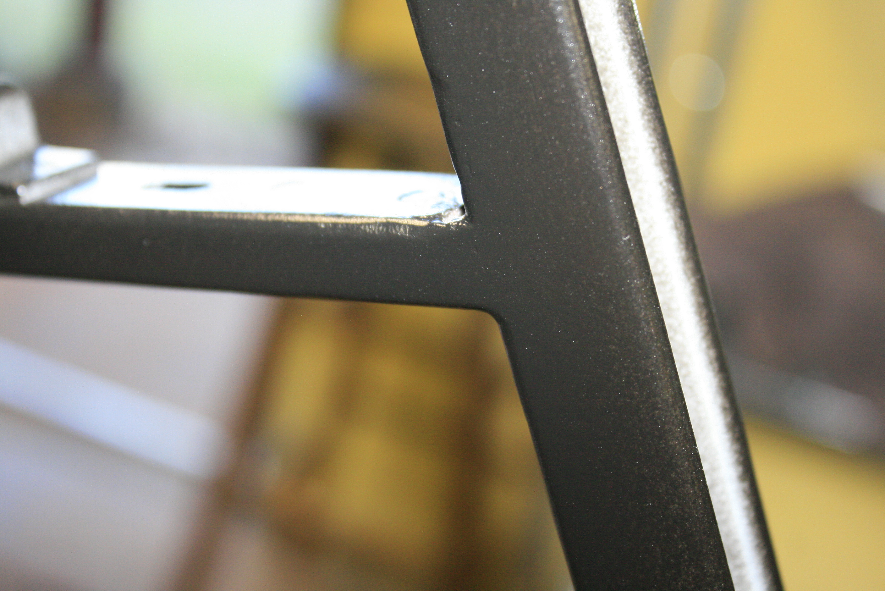

....This Angle Shows Much More Of The Lack Of Proper Application Of Black Inside The Door, I Will Be Talking To Dad As We Were Going To Sound Proof It With Tar & I Don't Know If It's Something That Can Still Be Applied Even With The Black????....
