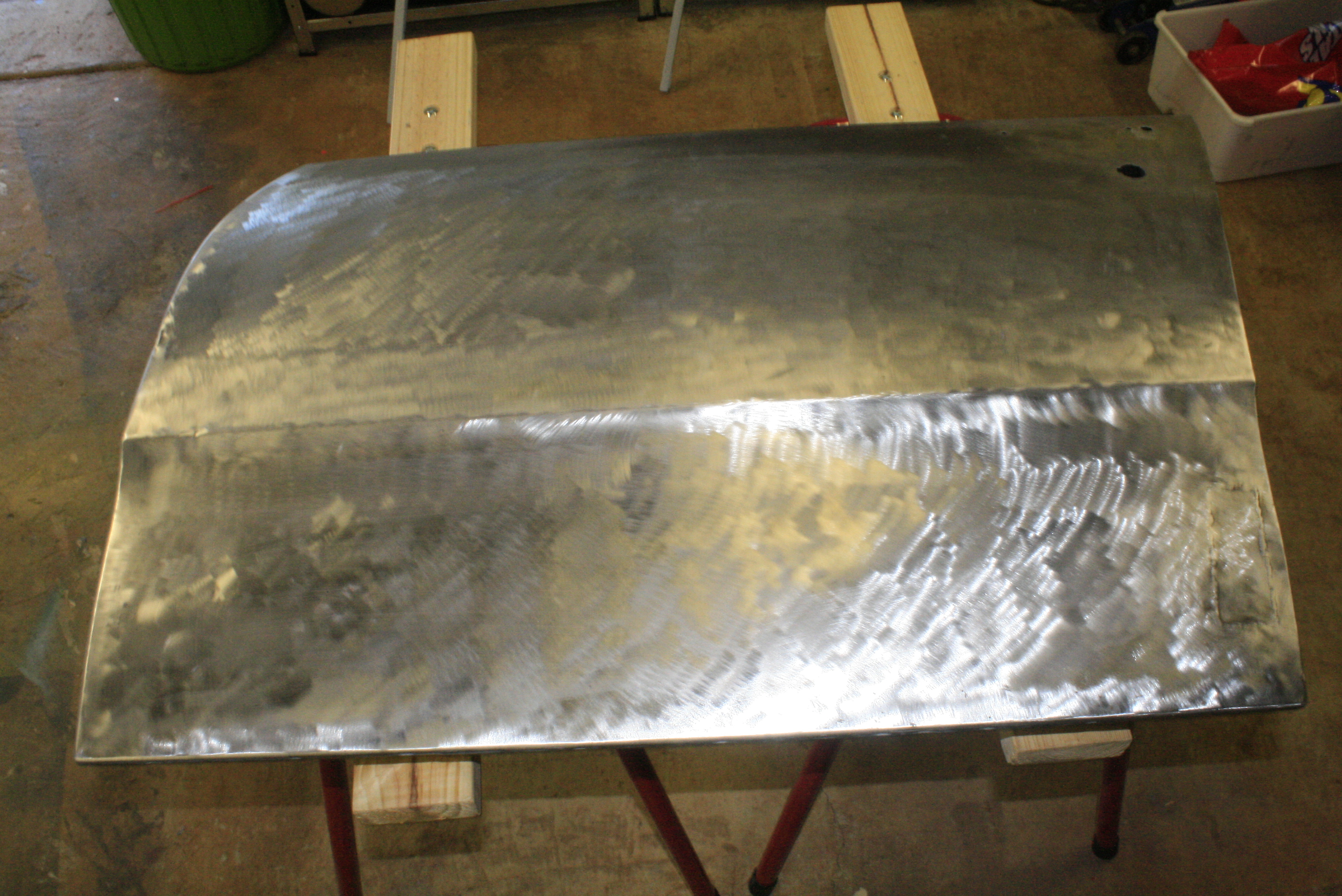

.Slow Going But Getting There.
Ted Freeman
Tue May 03, 2016 12:57 pm

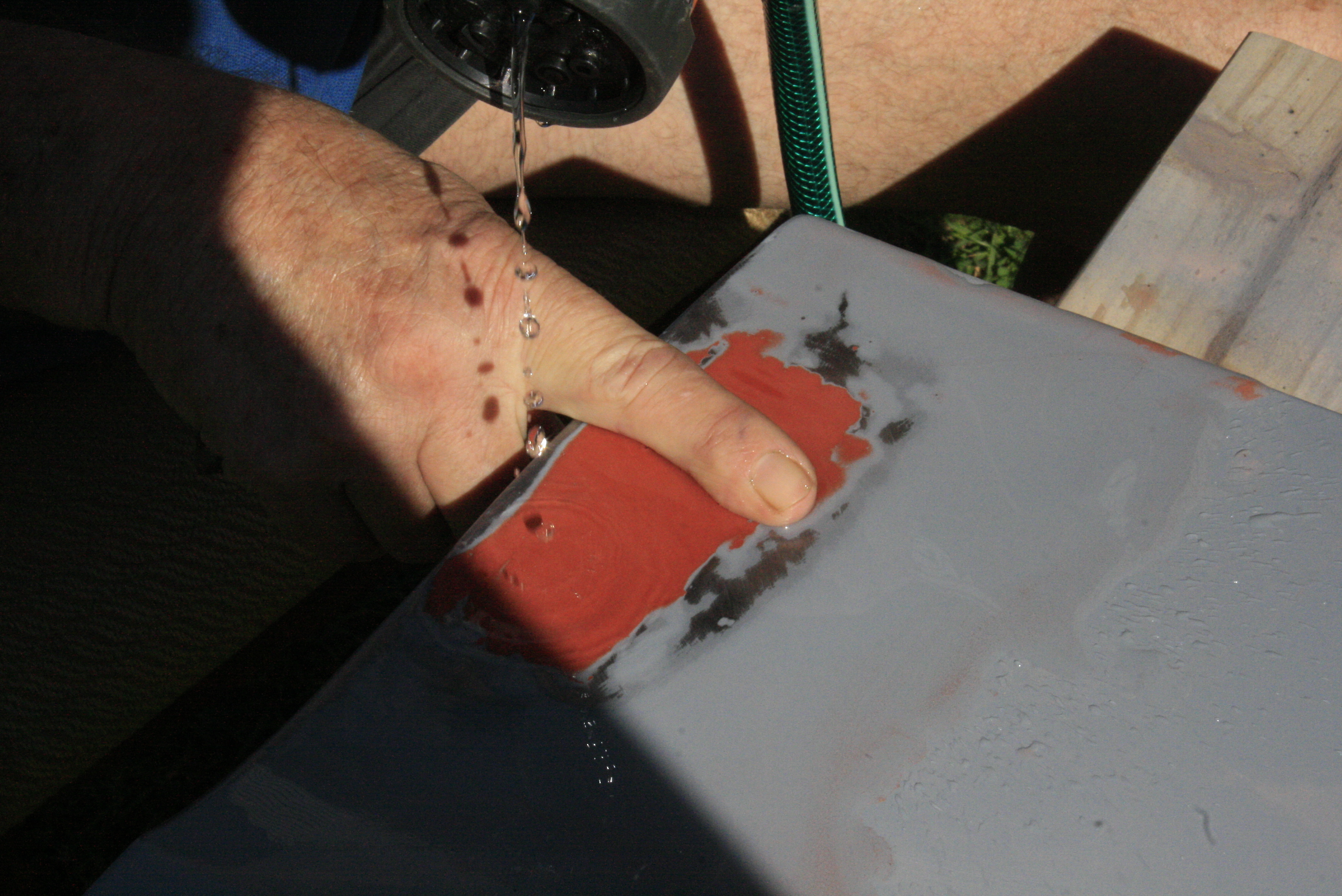

......Time For Etch-Primer, Now Despite The Advise Of Applying The Etch-Primer In A Mist Coat Dad & I Have Opted For The Wet Coat Method As It Allow Us More Room To Play When Wet & Dryin' The High N' Low Spots Out & Once It's All Smoothed Out We Will Touch Up The Etch-Primer So To Cover The Bare Metal & Move To The Priming From There With Peace Of Mind That We Should Have A Smooth As Surface Well That's The Plan Which Is Working Thuss Far......
Ted Freeman
Tue May 03, 2016 1:15 pm

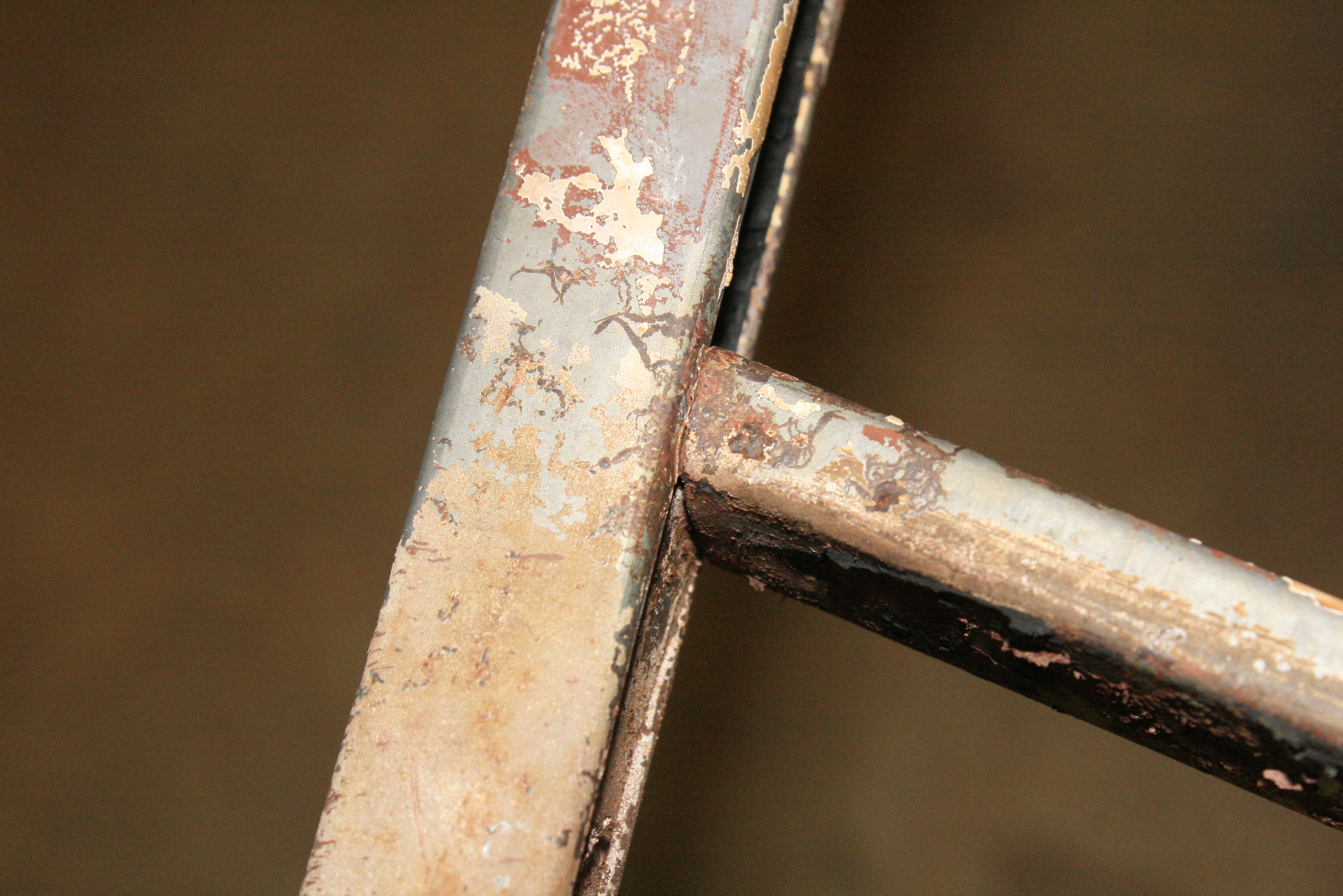

.........A Bit Of Pillar Work.........
Ted Freeman
Tue May 03, 2016 1:25 pm

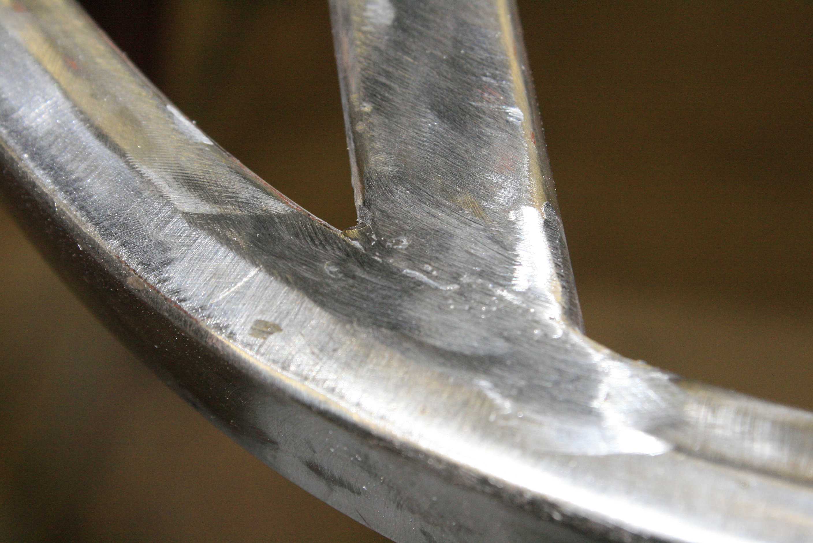

..........Before Welding..........
Ted Freeman
Tue May 03, 2016 1:28 pm

...........Not The Best Welds But As Can Be Seen In The Next-Last Picture They Smooth Out Quite Nicely...........
Ted Freeman
Tue May 03, 2016 1:30 pm
