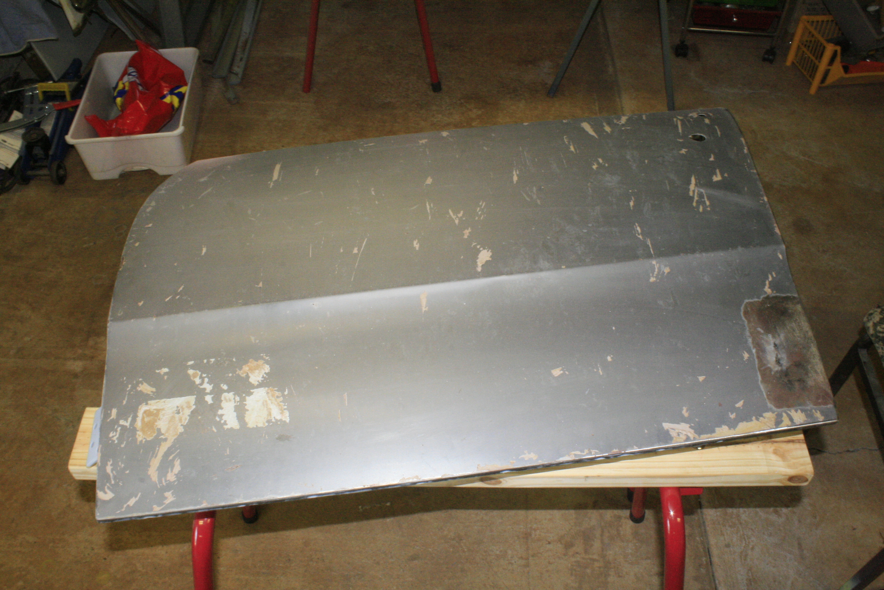

.Slow Going But Getting There.
Ted Freeman
