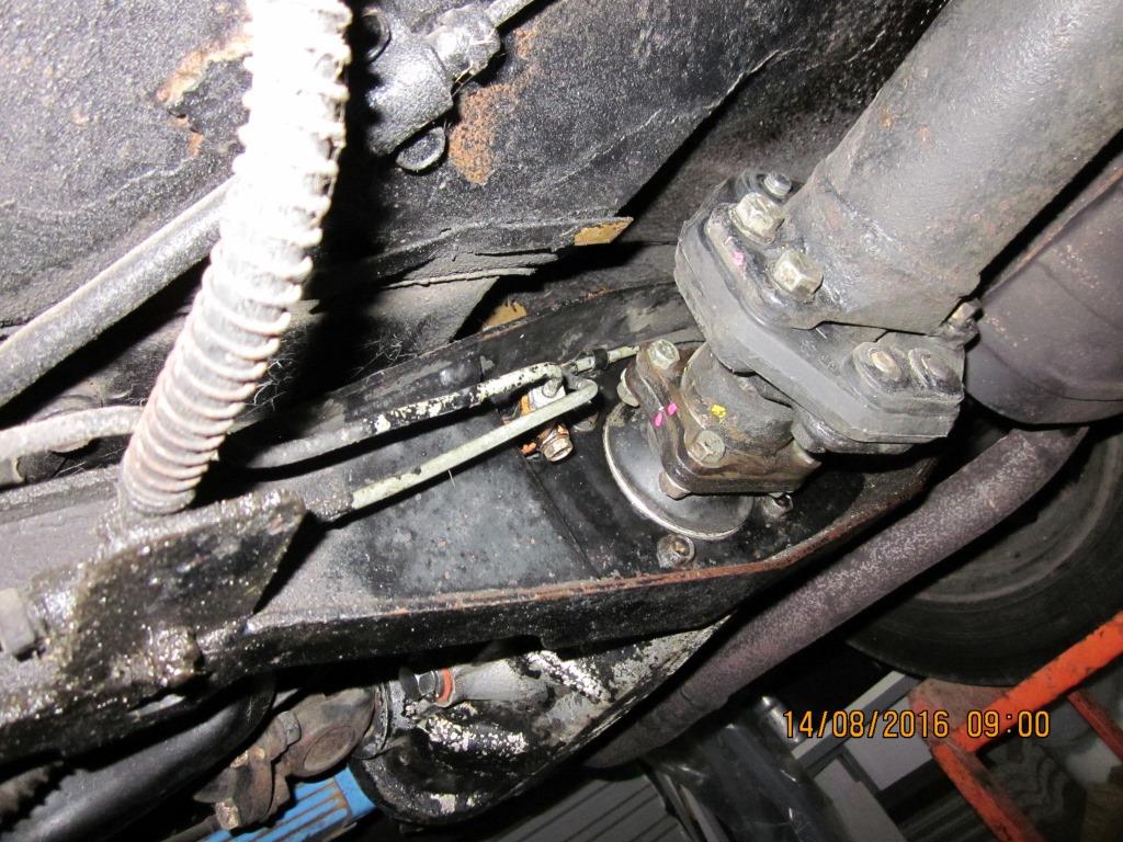

I just finished degreasing and pressure washing the whole area to make it cleaner to work on.

Brett, been under the car and it appears that i need to leave the diff front cross member in place as there are brake lines going thru it. So, i need to remove 4 bolts in behind the rear uni/rubber and pull the diff and yoke through the big hole in X member? Which means i think there is little room at the back to do it so i have to remove the spring also.?
edit, looks like the yoke won't pass through that hole so will have to be removed first....... i think there's a big nut holding it on
I jacked up the car on left side and turning the wheel you can hear lots of terrible noises like a gear with a tooth missing, feel to it

Well that's a totally different set up to normal as u don't need to a touch the brake lines in earlier cars....
I would strongly suggest against removing the yoke on the pinion shaft. It needs to be done up to some crazy amount of tension, but is also critical its done right for the pinion bearing and meshing on the crown wheel.
I'd be just undoing the brake pipes and rebleed them afterwards so u can remove it all as an assembly without stuffing something up.... And remember that if u removed all of the front of the diff, it then has to be reassembled in the car itself later.
Sun Aug 14, 2016 6:58 am
BTW the actual yoke on the front of the diff itself is the same as a normal one.
Its just the tailshaft that is different.
