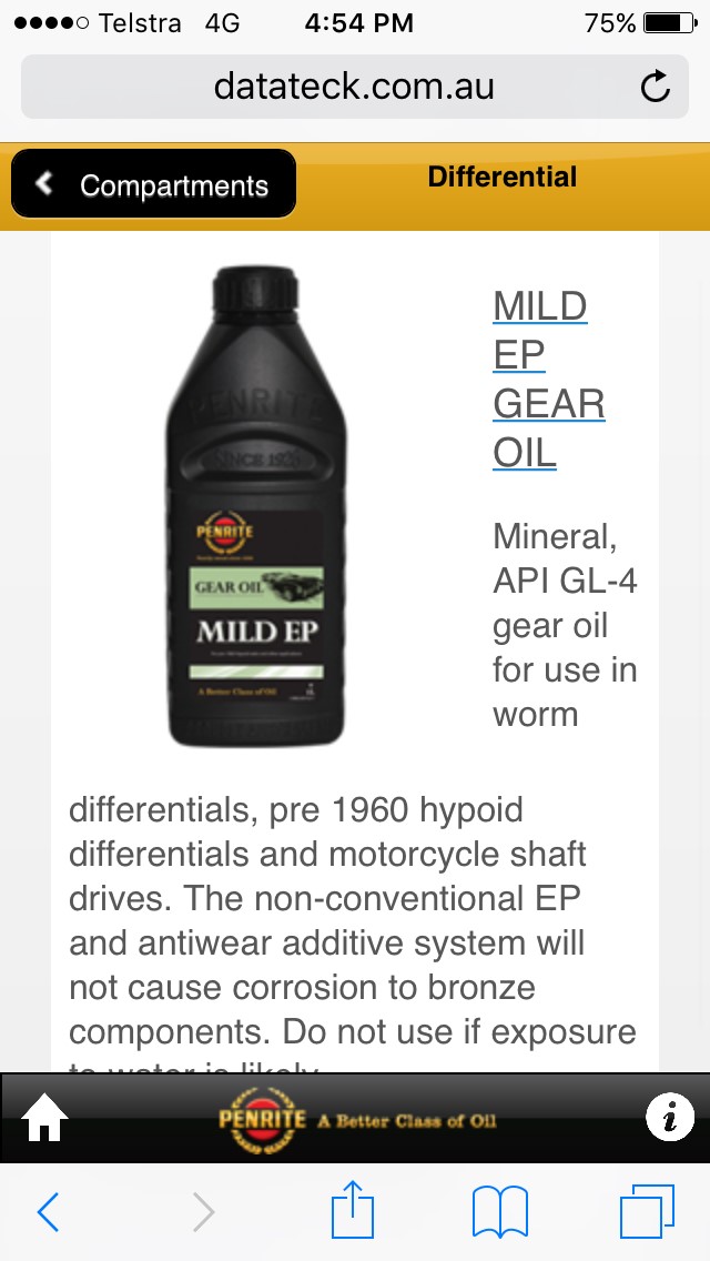

whats the best oil to use in the diff
My handbook just says "API-MP class Hypoid oil"
Fri Sep 09, 2016 3:02 am
Penrite
Fri Sep 09, 2016 3:32 am
I use the Penrite full syn. Think its 85/100 or something like that, but near enough to what James posted.
Fri Sep 09, 2016 7:50 am
Yea B
I run the lighter grade synthetic as my diffs are low mileage and it's colder here across the ditch
The mineral listed is according to Penrite sight
Fri Sep 09, 2016 8:13 am
Asroc66 wrote:
Yea B
The mineral listed is according to Penrite web site
Fri Sep 09, 2016 8:17 am
my older book says 90 for our temperature extremes. A trip to the store is in order. Thanks for the inputs

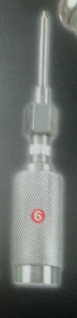

unfortunately the new uni joints are the grease-able type
this is a problem though, my grease gun will not fit the tight space of the Uni
Is there a special fitting for doing uni joint greasing or another way?
edit
the answer, although hard to find in shops, eventually Total Tools had one. An adapter. Not this one but similar.

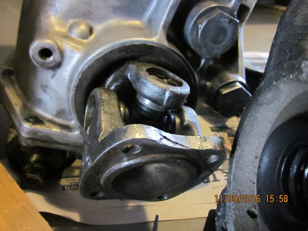

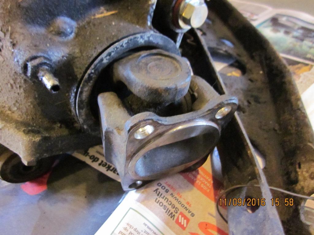

Mmmm, nothing ever easy
With the fantastic help from Stephen today, we pulled out the diff.
But it's not a straight swap over at all. The late model uni joint and flange is a different size to the earlier model I am putting in. Bolt spacing is different plus the raised section is a different diameter. And the late shafts don't fit properly into the early diff housing either. So, more work needed..... and more delays.

sure does. Can't imagine why they change things like that. Even the input shaft does not have a castellated nut on it like the earlies and i think maybe the issue as the shaft is very loose in the housing, can mode it side to side. I had the seal changed by a garage and its looking like they didn't tighten it up correctly. Bit late now of course.
I need to source a new bigger uni of unknown part number which might be fun. We are hoping that the shafts can be modified to swap over. The tin hat on the diff side is different on each shaft and perhaps can be pressed off and onto the other ones......
Sun Sep 11, 2016 10:59 pm
and there's more, the tin splash piece that buts up to the Diff, is also different. Late model is welded on, early is pressed on. They are also different in the centre hole diameter and shape where they press onto the seal. Not interchangeable at all. So, the splash piece has now been removed for good.
The whole area is much larger and beefed up in flange size and Uni' size.
For those late models among us (not many) the uni joint is a larger type from a Rodeo 4WD '79-'88- Rear.
