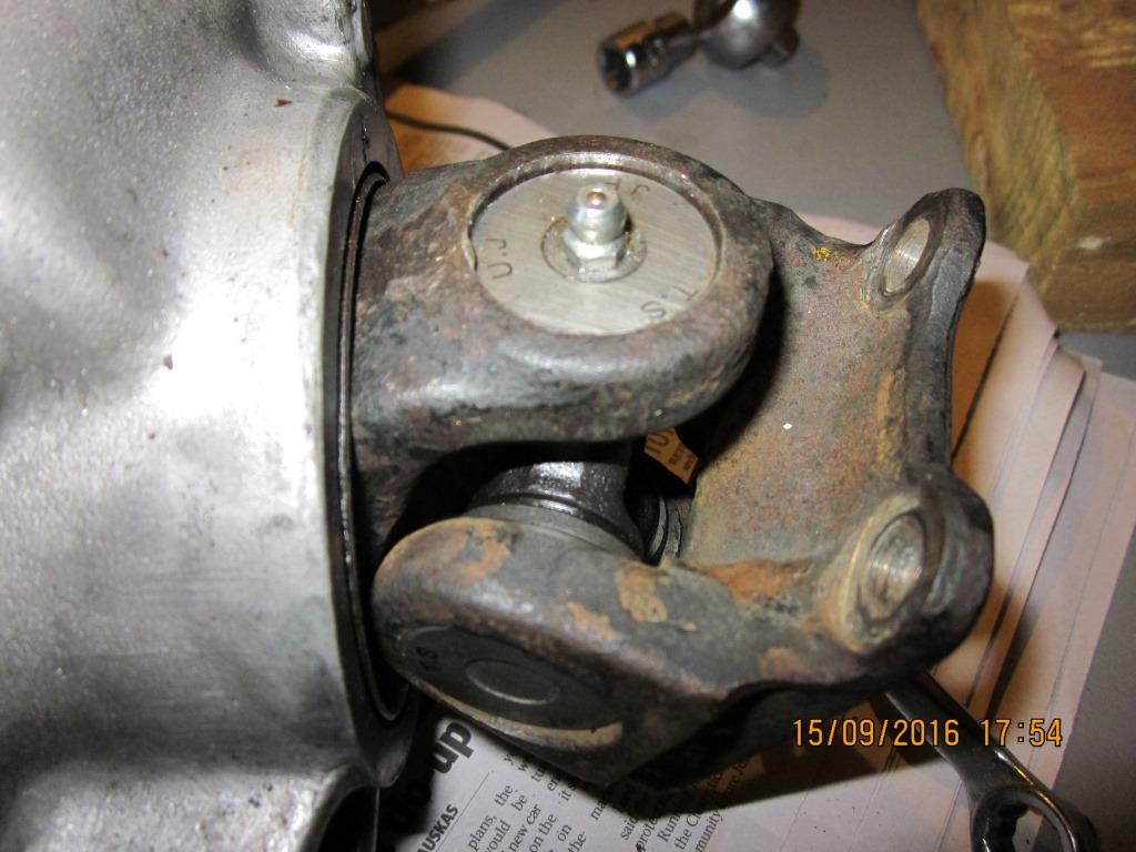

Gunna wrote: So your out of trouble now?  Got the reco'd diff back today, fitted with the late model shafts and new Uni joints. Much bigger Uni than early cars and grease nipple easy to get at also!

So the sport had gtr wheels, gtr sized unijoints. Does it come with a gtr limited slip diff? Glen< did old mate diff repairer look inside the old diff? How can you find out (other than a burnout on a gravel road  ) ?
| Fri Sep 16, 2016 10:05 am |
Gunna wrote: So the sport had gtr wheels, gtr sized unijoints. Does it come with a gtr limited slip diff? Glen< did old mate diff repairer look inside the old diff? How can you find out (other than a burnout on a gravel road  ) ? HI Dean, the diff out of the car is currently in pieces for a quick look see and put back together, sorry no LSD but I was hoping there would be !! Notice there is no castellated nut on the the shaft, the cause of all the problems.
