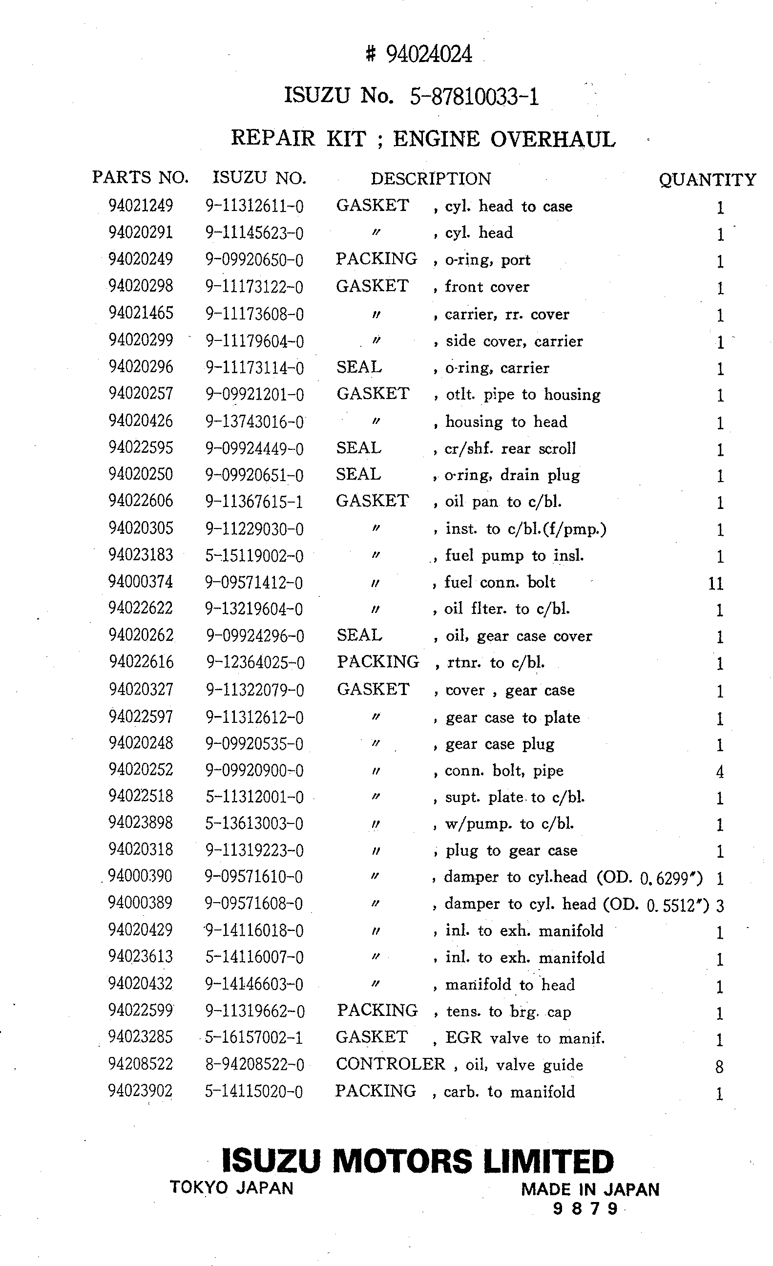

ebay item 170815288633 Not a full set but might give you an idea what to look for.
A full set for 1800 SOHC, see the part numbers below. You might be able to get a full set out of Japan.

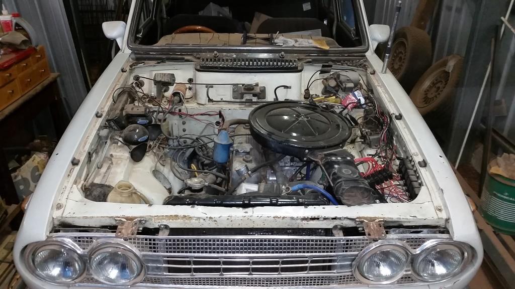

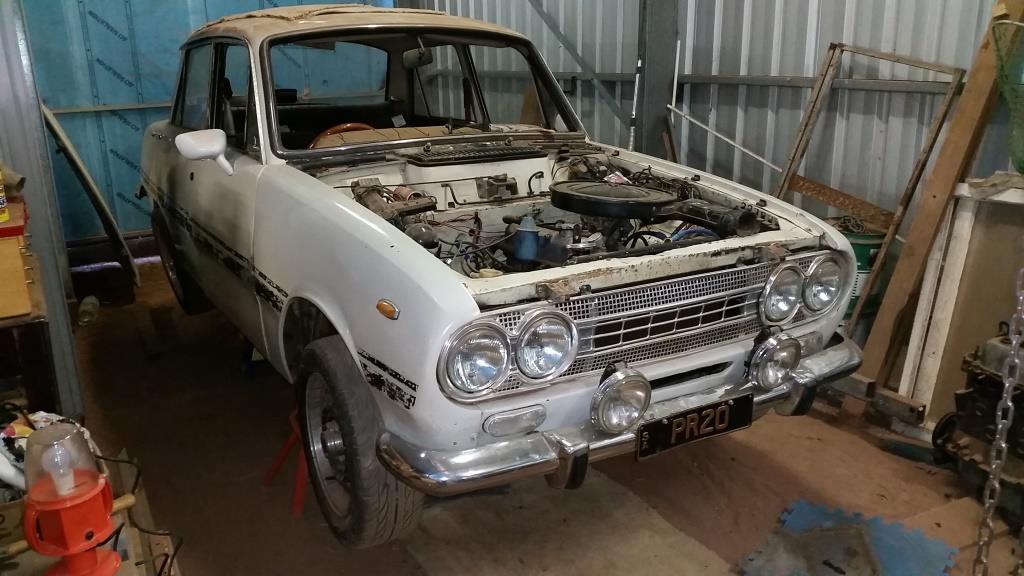

Well here we are again.
You may have seen the for sale section.
Two things have happened which has meant Bella needs to find a new home.

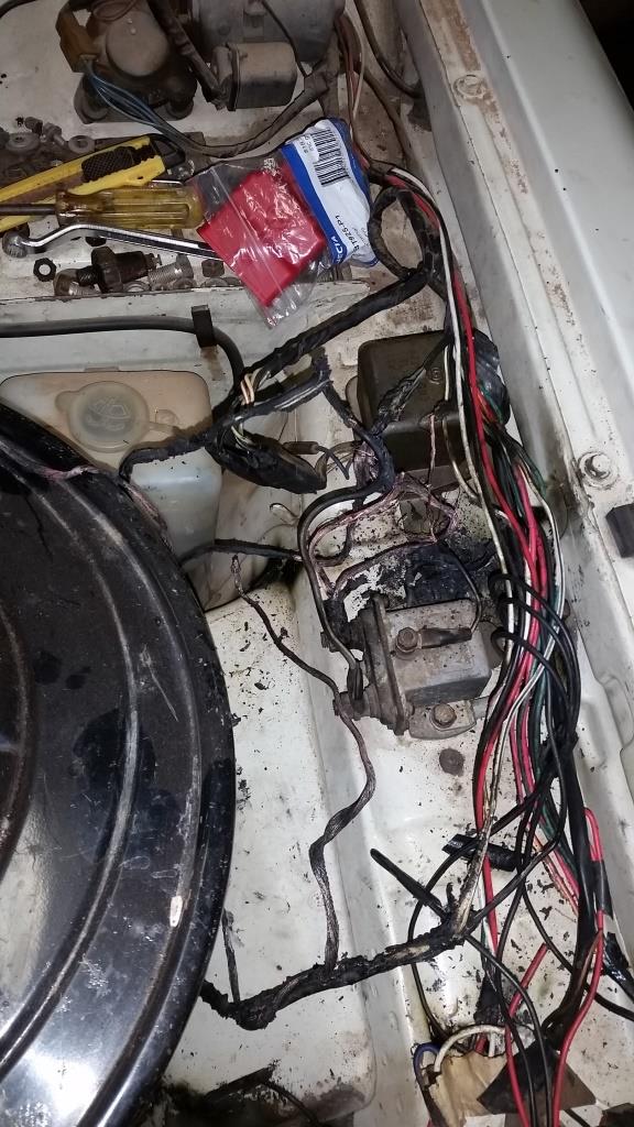

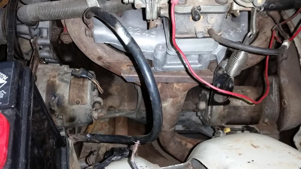

After months of getting everything together I finally had the chance to get Bella running.
New Supercharge battery :D
Petrol :D
Aerostart or in this case "start ya bastard" :D
She did, glorious to here the new sound. I fitted extractors and a hot dog muffler to quieten the bark which was slightly on the inappropriate side.
Unfortunately ....... the alternator lead wasn't connected properly and it contacted the bodywork resulting in lots of smoke, flames and several fried wires. Thankfully I got the battery disconnected before the flames took any sort of hold as the aerostart was sitting on the cowl hidden by the smoke :O
After all this time I'm just over the struggle.
I want to build another less difficult Bellett, simpler if you like.

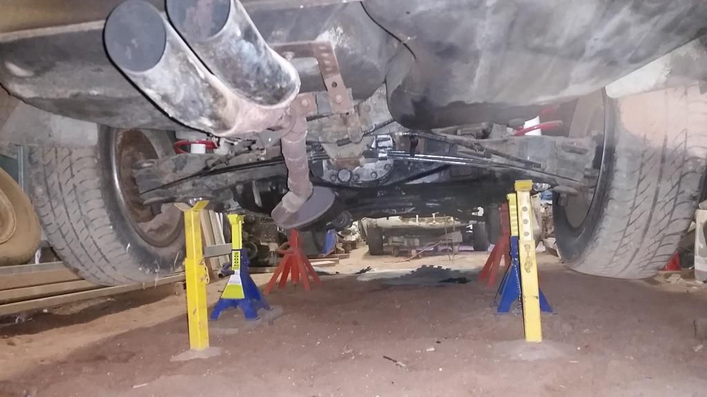

So here are some pictures of Bella awaiting some loving.

Mon Jun 22, 2015 9:11 am
Well, oh well.
Looks like I might have found some wiring off one of my wrecks to replace the fried stuff.
Just got to get to and fit it all in.

So with only a couple of weeks until we all meet up in Albury I thought I'd post an update.
Bella is coming, barring any really weird shit :)
The windscreen fitting was really not as scary as I'd imagined. The new engine runs a treat, just got one final vacuum leak to sort out and it's all apples so to speak.
The exhaust is much nicer than the bark Bella used to have, a set of extractors and an extra hotdog muffler makes the world of difference. Some of you may also be aware that the lights all 6 of them are now putting out the candelas they should have if i hadn't ended up with a cold solder joint.
I'm really looking forward to getting to drive her after 6 years up on stands in the shed.
However Bella is still for sale, sad but true.
Still see youall in Albury :D

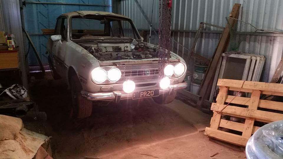

For those that might not have seen the blazing lights in all their glory.
I present the H4/H3 eyeball fryers.
Cheers Rob
